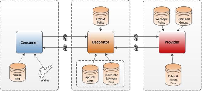

The RSB is an enterprise infrastructure for service oriented communication. RSB provides an architectural approach which involves Oracle Retail applications being exposed as ”Service Providers”, and OSB core components called ”Decorator Services” wrap the edge-app-services to provide virtualized and operational visibility to Oracle Retail services infrastructure. Lastly, the decorator services expose proxy WSDL's that are called by ”Service Consumers” which could be Retail applications or third party applications capable of making a SOAP invocation.
Surrounding text describes image006.jpg.
The RSB key components can be loosely coupled across platform, technology, and physical topologies. In order to establish an end-to-end security in RSB system, one has to secure all the intermediary layers that are part of a communication channel through RSB. As discussed earlier, there are three main layers, Service Provider, Decorator and the Service Consumer. Each of these must participate in configuring security in order to achieve effective security while making Web service calls.
Security decisions are mostly Service Provider driven; Decorators and Consumers will need to adhere to the chosen security mechanism by the provider in an integrated system. RSB provides numerous tools to ease the security configuration and automate the process which otherwise is quite cumbersome.

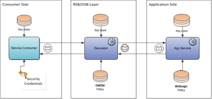

Securing an RSB system involves following components. Each of these components is a layer in the RSB security architecture.
  1. Edge App Services
  2. Decorator Business Services
  3. Decorator Proxy Services
Edge App Services
These services are deployed as part of ear files on the WebLogic server and it is not required to have Fusion Middleware components in that environment. In such environments, OWSM is not available to secure Web services. Therefore, these services are secured using the WebLogic Web service policies.
Decorator Services
The decorator proxy and business services are deployed in an OSB server where OWSM components can be used for Web service policies. Therefore, decorator proxy and business services use those OWSM policies which are compatible with the WebLogic policies applied to edge app services.
The policy files for business and proxy services depend on which policy has been attached to the corresponding edge app service. Business service needs to be configured with an OWSM client policy file which is corresponding to the policy file attached to the edge app service. The proxy services need to be configured with an OWSM service policy file that should have configuration matching with edge app policy file. The client of the proxy service needs to use a client policy file which matches the service policy for OSB proxy service.

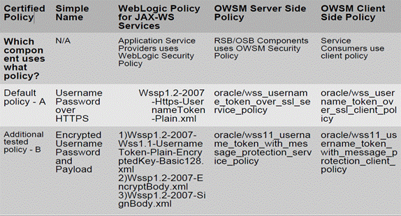

There are two types of security configurations certified for RSB by Oracle Retail. For ease of use these are classified and referred in this document as Policy A and Policy B.
Each of these certified approaches involve a set of security policies. The following table describes the required set of policies for Policy A and B.
Surrounding text describes image008.gif.
Service providers are the endpoint services which are invoked by the decorator proxy and business services; therefore edge app services must be secured first and based on the message-level and transport-level authentication required by them, the proxy and business services are secured with similar configurations.

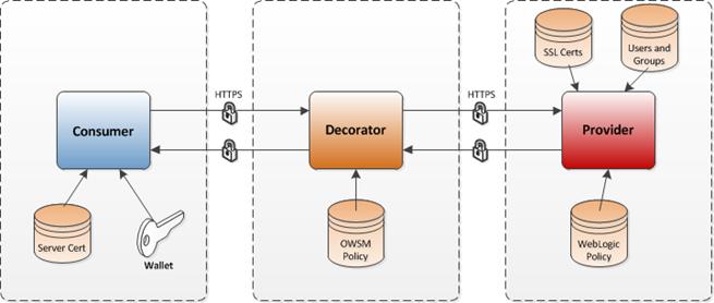

Policy A (Default Policy)
Policy A is a Username Token over HTTPS. This security configuration is referred to as Policy A in this document.
  • Wssp1.2-2007-Https-UsernameToken-Plain.xml
    Surrounding text describes image010.jpg.
Policy A is selected as the default policy for the following reasons:
  • Most widely (SSL) used policy
  • Easy to configure and setup
  • Data going over the wire is encrypted and is secure
  • Interoperable between WebLogic and OWSM policy
  • Good performance for the level of security provided
  • Good support from all programming languages
