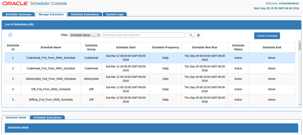

Verify that the list of schedules (created from seed data) is displayed in 'Manage Schedules' page of the app.
Ensure that all the schedules are in 'Active' status.
