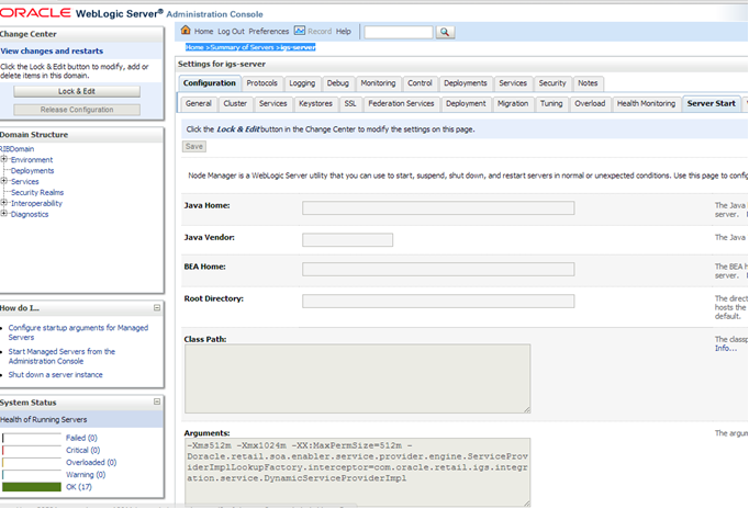

  3. Add the server start argument for IGS managed server. This can be done from the WLS console, or in the startWebLogic.sh and startManagedWebLogic.sh scripts.
    1. To edit the scripts, add the following to startWeblogic.sh and startManagedWebLogic.sh under $DOMAIN_HOME/bin:
      JAVA_OPTIONS="-Doracle.retail.soa.enabler.service.provider.engine.ServiceProviderImplLookupFactory.interceptor=com.oracle.retail.igs.integration.service.DynamicServiceProviderImpl ${JAVA_OPTIONS}"
    2. To edit the server start arguments in the WebLogic console, click igs-server -> Server start as below:
      Surrounding text describes weblogic-server.png.

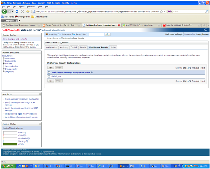

Secure IGS Web Services Using the Administration Console
IGS Web services can be secured in two ways. One approach is simple user name and password authentication. For the other approach, passwords are encrypted with certificates.
The following describes both approaches for server-side and client-side setup.
The various policy files that can be used to secure Web services are listed in the ws-policy tab of the Web service in the WebLogic Server Administration Console.
Server-side Setup for User Name and Password Authentication
This section describes the two-step process required for securing Web services on the server side. These steps are performed using the Oracle WebLogic Server Administration Console.

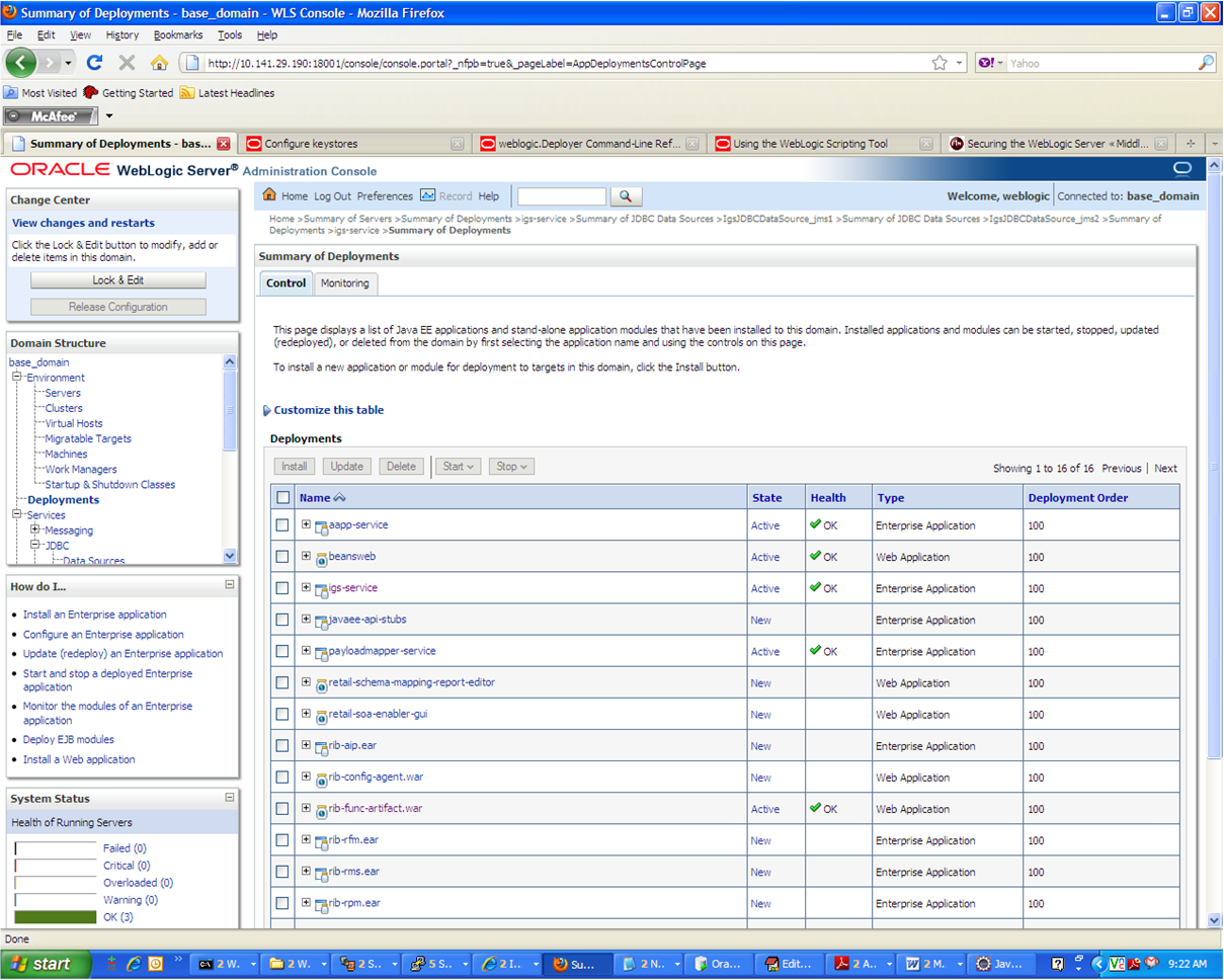

  1. In the Summary of Deployments screen, click the application. In the illustration below, the application is igs-service.
    Surrounding text describes 6-1.png.

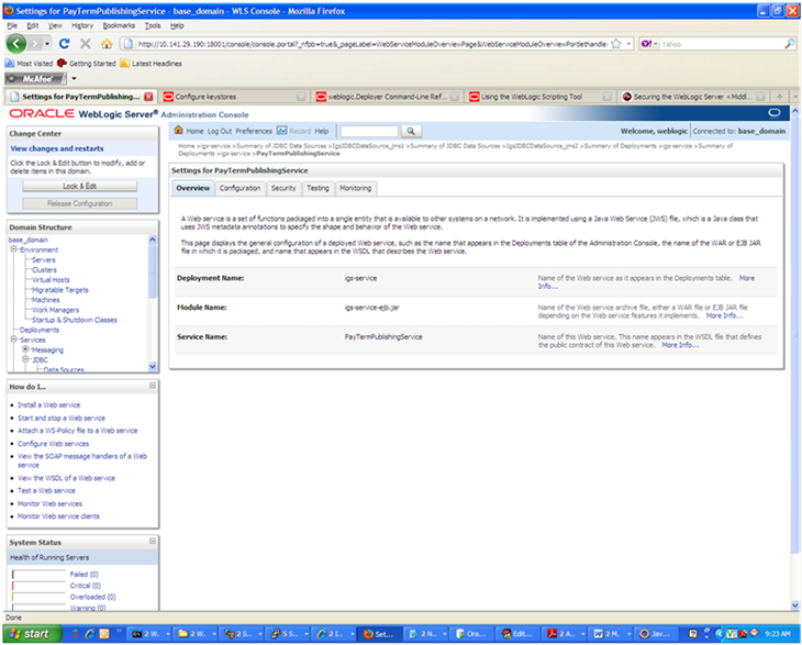

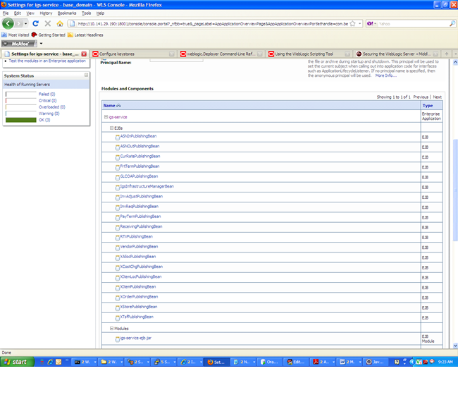

  2. An overview page is displayed, including a list of modules and components installed as part of the application.
    Surrounding text describes 6-2.png.

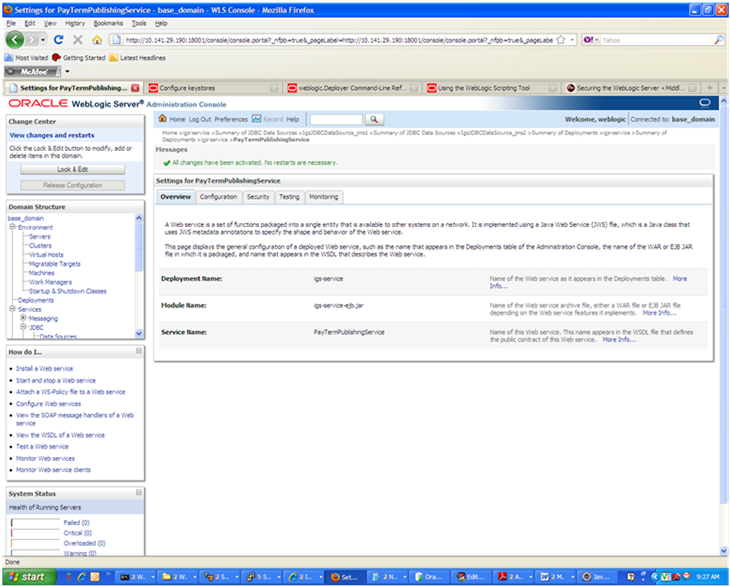

  3. In the Web service list, click the service for which you want to enable security. The following screen is displayed to provide an overview of the Web service.
    Surrounding text describes 6-3.png.

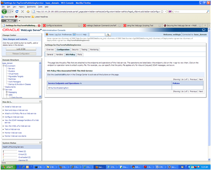

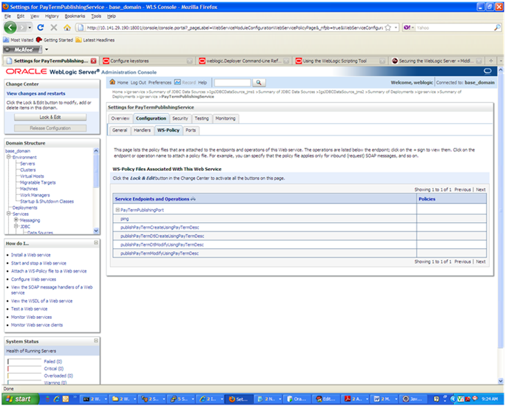

  4. On this overview screen, click the Configuration tab. Click the WS-Policy tab. The Web service port is shown under Service Endpoints and Operations.
    Surrounding text describes 6-4.png.
  5. Click the plus sign next to the port name. The Web service operations are displayed.
    Surrounding text describes 6-5.png.

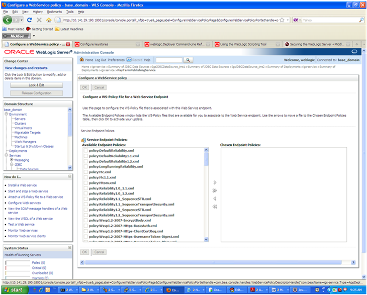

  6. You can secure all the Web service operations at once or select only the operations you want to secure. Click the name of the port. On the Configure a Web Service policy screen, you can attach the policy file to the Web service. Select WebLogic and click the Next button.
    Surrounding text describes 6-6.png.
  7. From the Available Endpoint Policies list, select policy:usernametoken.xml. Click the right arrow to move it to the drop down list below Chosen Endpoint Policies. Click OK. The Save Deployment Plan Assistant screen is displayed.
    Surrounding text describes 6-7.png.

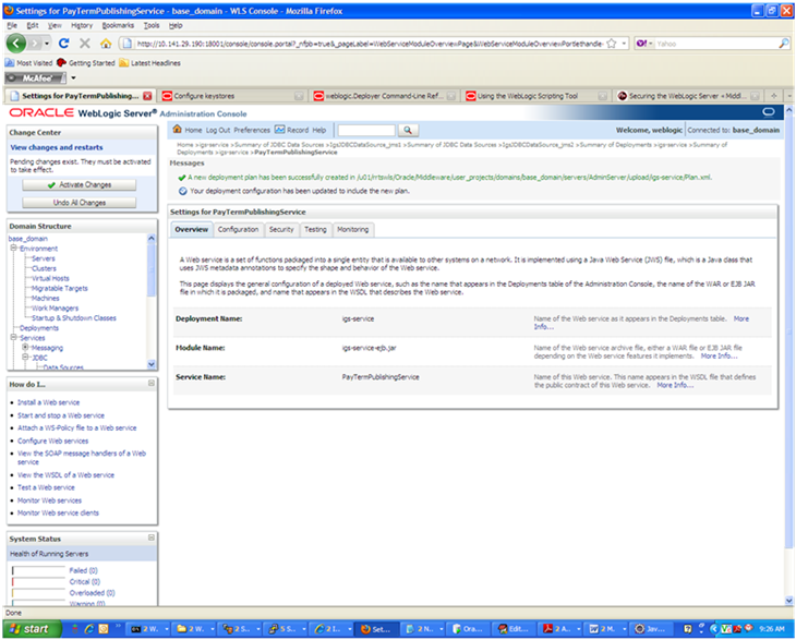

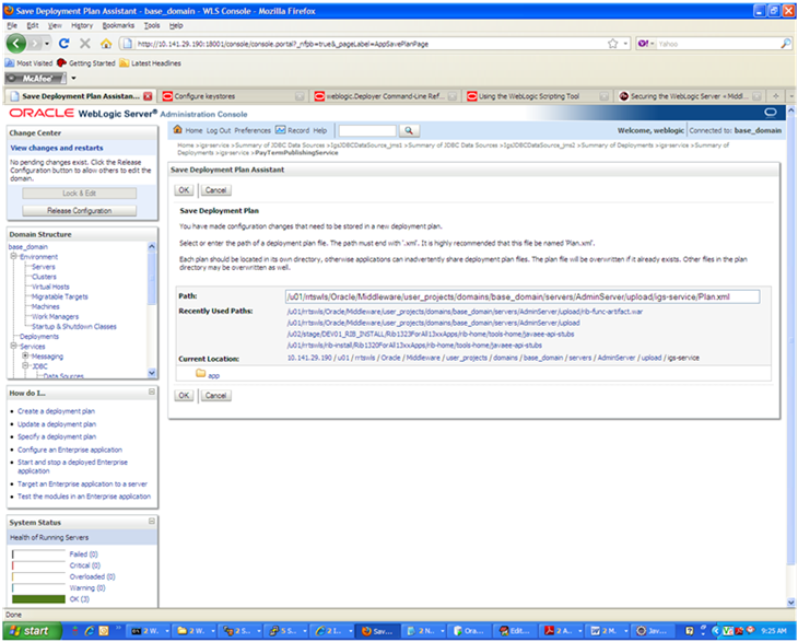

  8. At the bottom of the Save Deployment Plan Assistant screen, click OK. The following screen is displayed, including status messages near the top.
    Surrounding text describes 6-8.png.
  9. Click Activate Changes. The following screen is displayed.
    Surrounding text describes 6-9.png.
  10. Under the Testing tab, on the Web Service page, click the WSDL to view the details of the policy just added to the Web service. The WSDL contains information similar to the following.

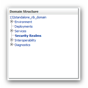

  1. In the Domain Structure window of the Oracle WebLogic Services Administration Console, click the Security Realms link.
    Surrounding text describes 6-28.png.

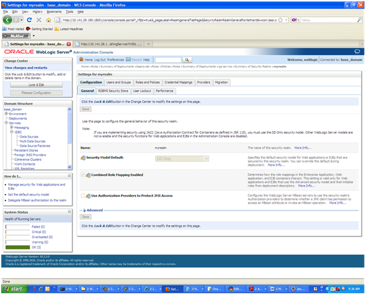

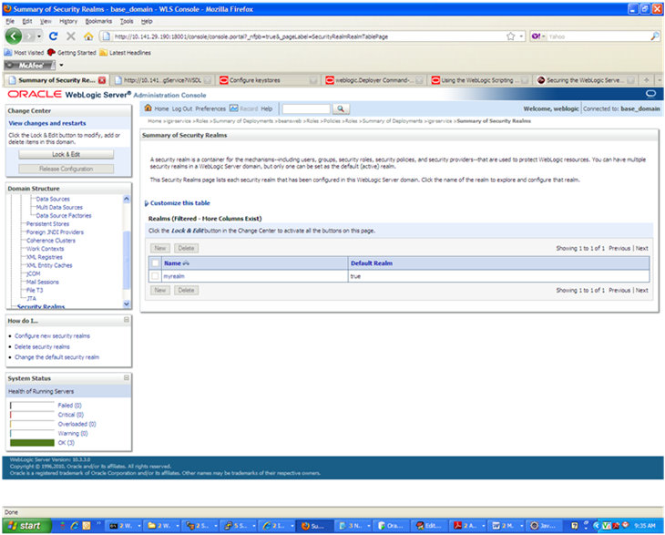

  2. The Summary of Security Realms screen is displayed, including the name of the default realm.
    Surrounding text describes 6-11.png.
  3. Click the name of the default realm. The settings for the realm are displayed.
    Surrounding text describes 6-12.png.

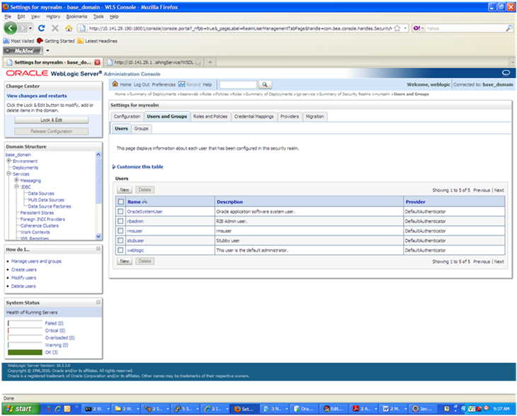

  4. On the Settings screen, click the Users and Groups tab.
    Surrounding text describes 6-13.png.

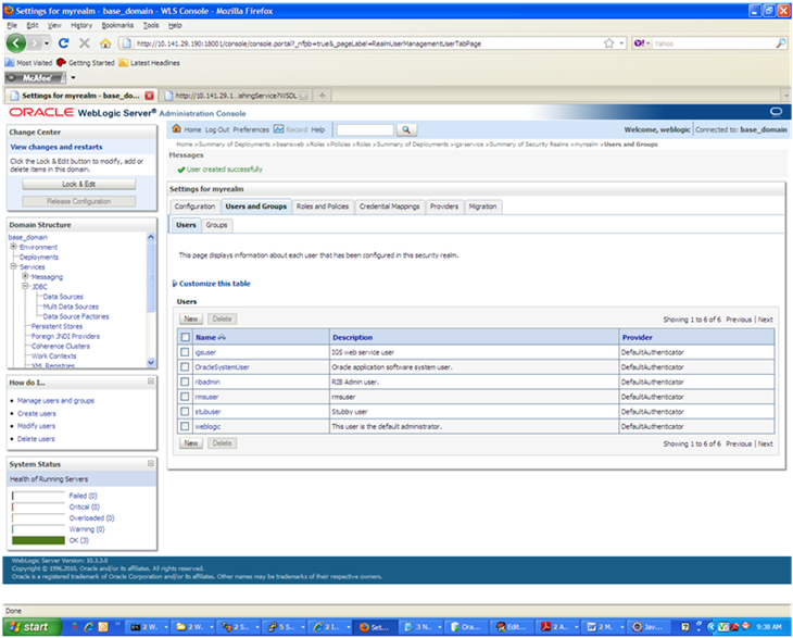

  5. In the Users and Groups tab, click the Users tab. At the bottom of the Users tab, click New. The Create a New User screen is displayed.
    Surrounding text describes 6-14.png.

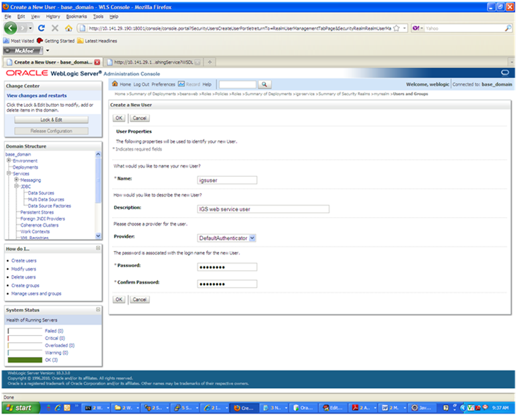

  6. In the Create a New User screen, enter a user name and password. Leave the default value for Provider. Click OK to save the information. The new user is added to the list of users.
    Surrounding text describes 6-15.png.

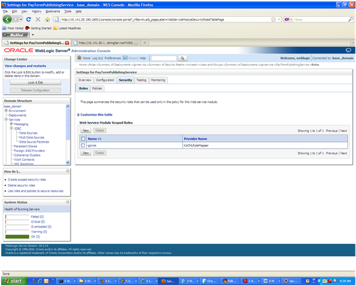

    You can add roles from the Roles and Policies tab of the security realm or through the Security tab of the Web service. The following instructions are for creating a role through the Security tab of the Web service.

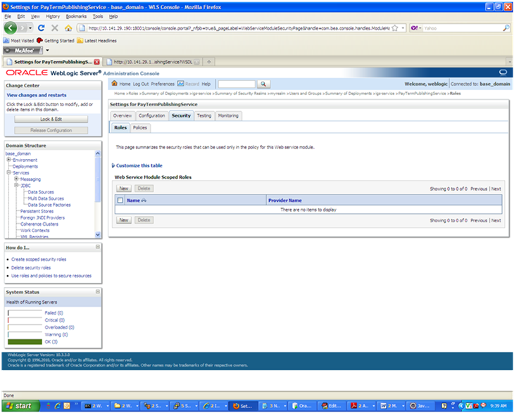

  7. Navigate to the Security tab of the Web service. Click the Roles tab.
    Surrounding text describes 6-16.png.

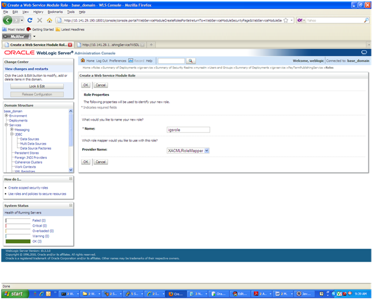

  8. In the Roles tab, click New. The Create a Web Service Module role screen is displayed.
    Surrounding text describes 6-17.png.
  9. In the Create a Web Service Module Role screen, enter the role name in the Name field (for example, rmsrole). Leave the default value in the Provider Name field. Click OK. The new role is displayed in the Roles tab of the Web service.
    Surrounding text describes 6-18.png.

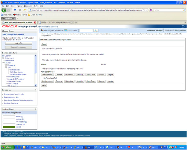

  10. To add the user to the role, click the name of the new role in the Roles tab. The Edit Web Service Module Scoped Roles screen is displayed.
    Surrounding text describes 6-19.png.

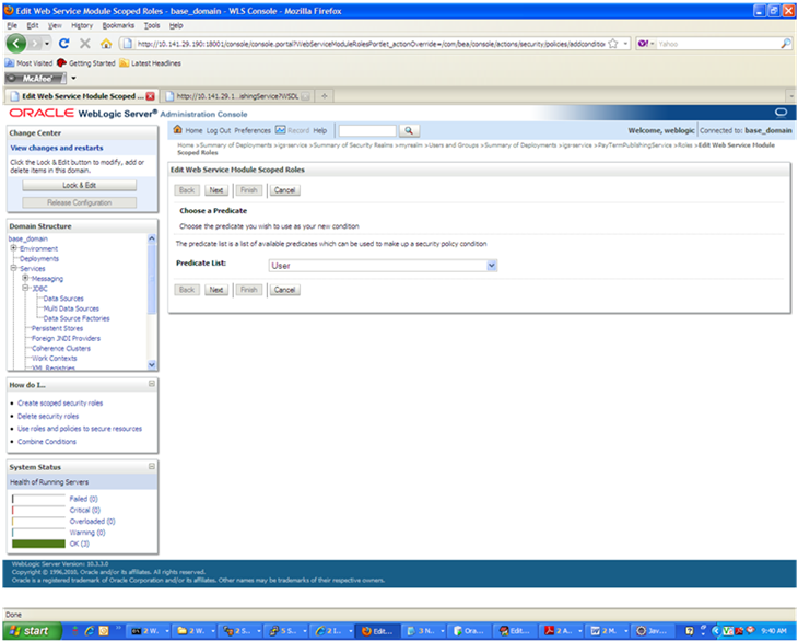

  11. In the Edit Web Service Module Scoped Roles screen, click Add Conditions. The "Choose a Predicate" option is displayed.
    Surrounding text describes 6-20.png.
  12. From the Predicate List, select User. Click Next. The Edit Arguments argument is displayed.
    Surrounding text describes 6-21.png.

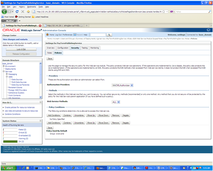

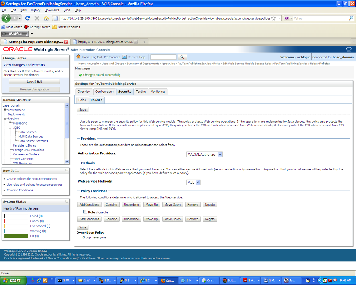

  15. Return the Security tab of the Web service and click the Policies tab.
    Surrounding text describes 6-23.png.

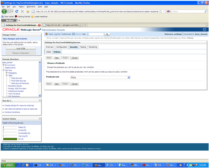

  16. On the Policies tab, click Add Conditions. The "Choose a Predicate" option is displayed.
    Surrounding text describes 6-24.png.

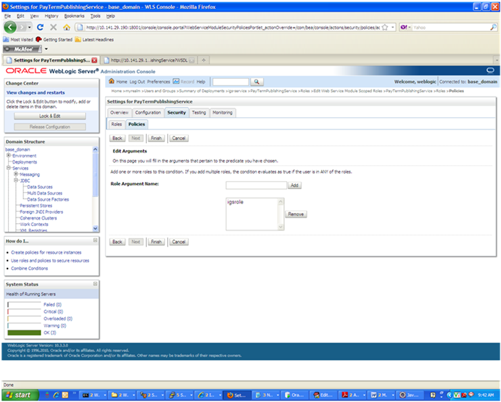

  17. From the Predicate List, select Role. Click Next. The Edit Arguments option is displayed.
    Surrounding text describes 6-25.png.
  18. In the Role Argument Name field, enter the role name created earlier. Click Add. The role name will move down to the box below the Add button. Click Finish to return to the Policy Conditions screen.
  19. Click Save. The Policy Conditions screen is displayed with this message near the top: "Changes saved successfully."
    Surrounding text describes 6-26.png.

Server-side Setup for Encrypted User Name and Password Token Authentication
WebLogic provides predefined policy files for securing Web services. This section describes the process required to secure a Web service where user name and password are encrypted and signed. Below are the steps to secure the Web service.
  1. Follow the steps to attach the policy file to the Web service described in the section, "Attach Policy File to the Web Service," with this exception: In Step 7, select "policy:Wssp1.2-2007-Wss1.1-UsernameToken-Plain-X509-Basic256.xml" (instead of policy:usernametoken.xml). Follow the remaining steps as shown.
    After attaching the policy file, the header for the WSDL of the Web service contains the following.

  8. In the WebLogic logic console, check the Web Service Security tab to verify that the command ran properly. Note that the default_ww configuration is used for all Web services unless otherwise indicated.
    Surrounding text describes 6-27.png.
