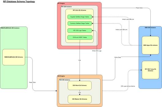

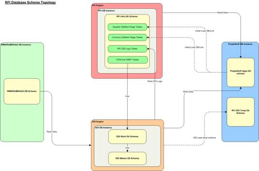

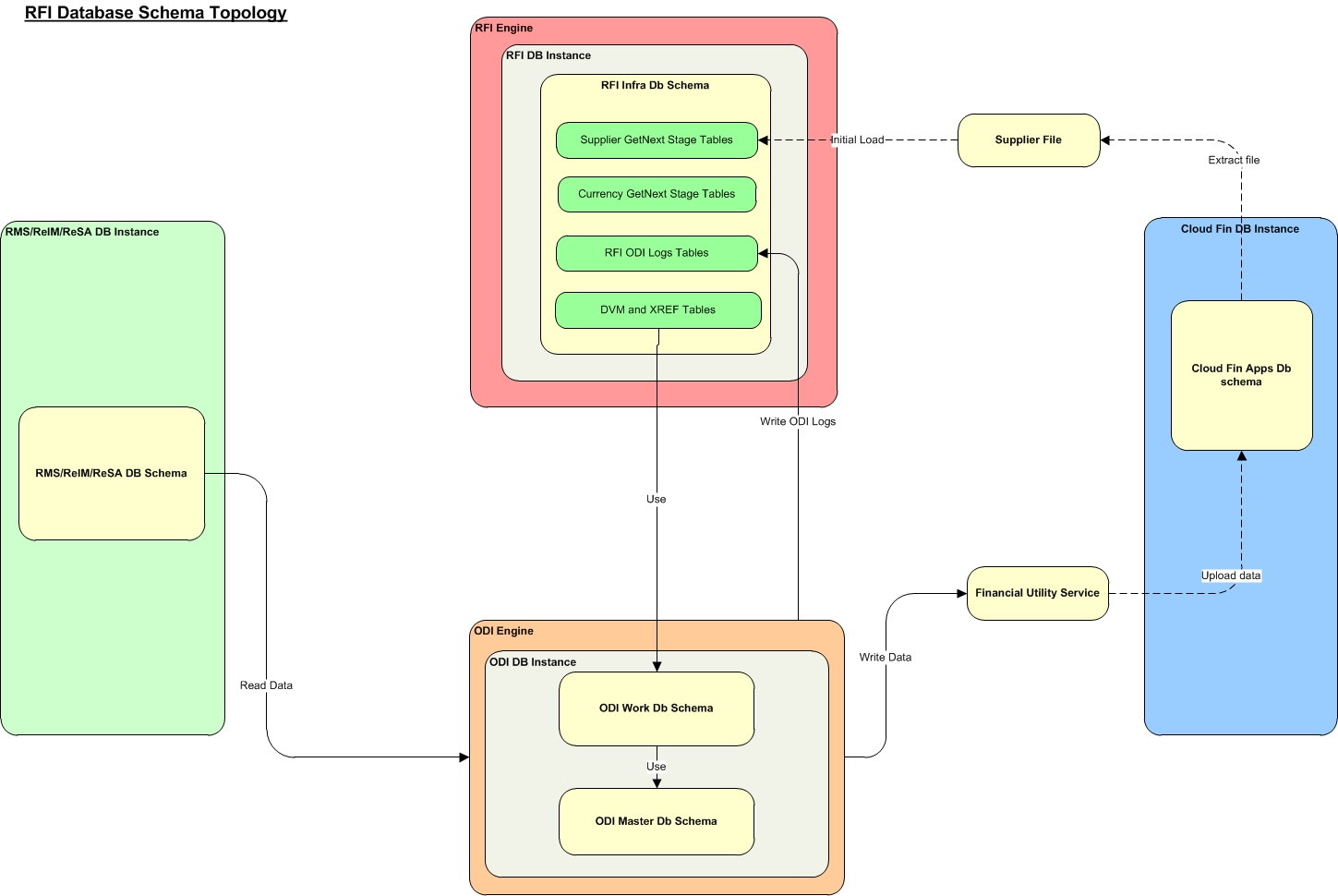

Database Schema Topology
This topology diagram shows how different schemas are integrated with each other. There are two diagrams one with EBS as integrating financial system and other Oracle PeopleSoft, or Cloud Financials as integrating financial system
Figure 3-1 RFI Database Schema Topology (EBS)
Surrounding text describes Figure 3-1 .
Figure 3-2 RFI Database Schema Topology (PeopleSoft)
Surrounding text describes Figure 3-2 .
Figure 3-3 RFI Database Schema Topology (CFIN)
