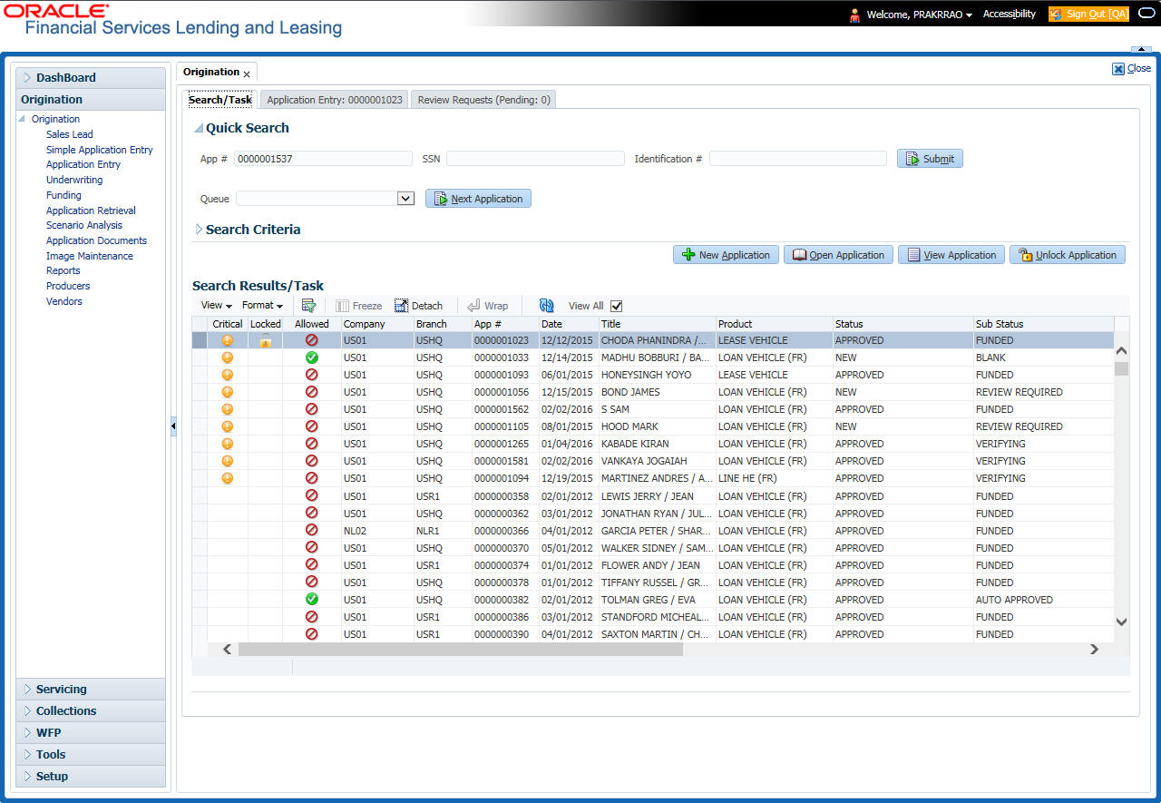

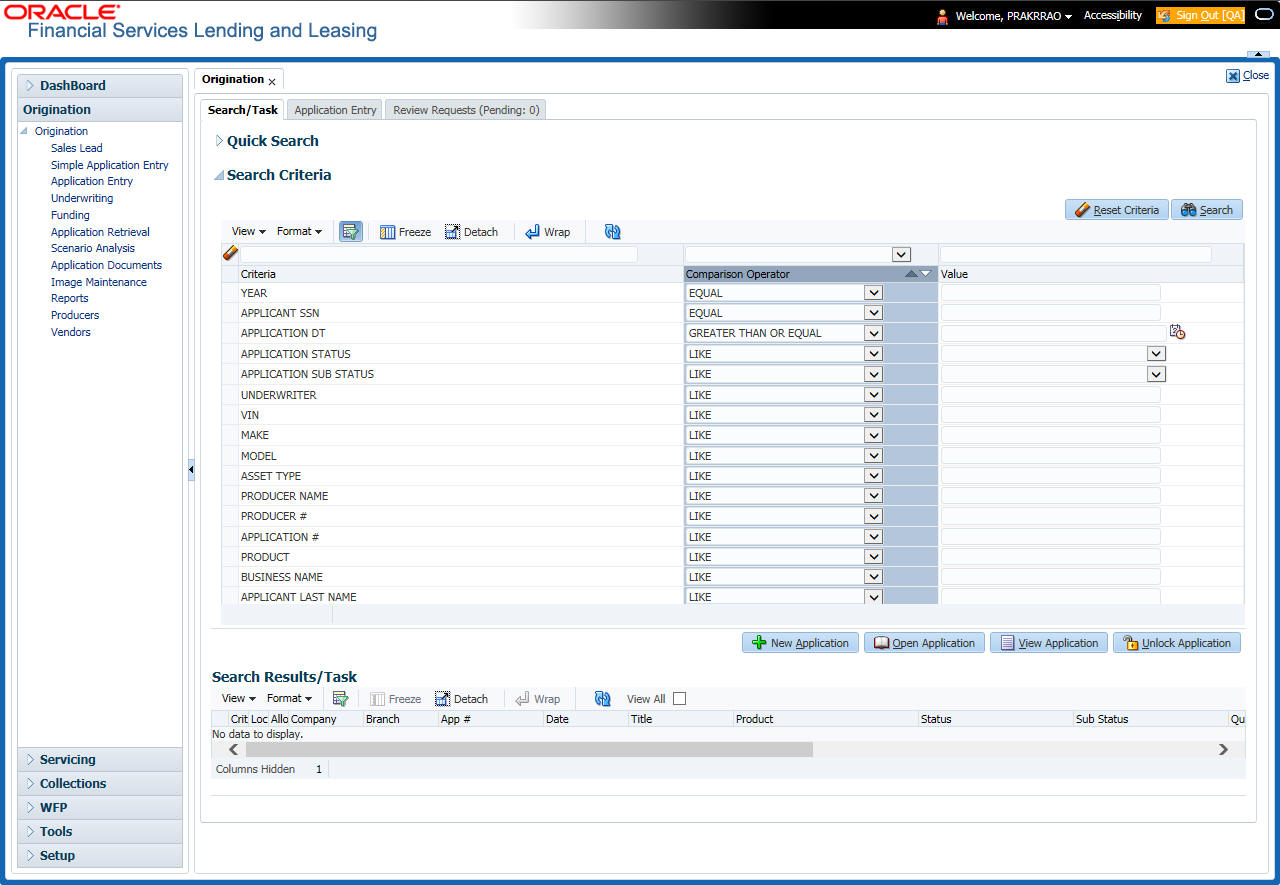

2.2.1 Search/Task tab
To view the Search/Task screen during Lease origination
  1. On the Oracle Financial Services Lending and Leasing Application home screen, click the Origination master tab.
Depending on the task to be performed and the link clicked, the respective screen opens in the Search Results/Task screen.
  1. Click the Search Criteria tab.
The search tab enables you to locate an application using a broad range of search criteria.
The Search Results/Task screen.
  1. On the Results screen, select the application you want to load and click Open Application.
The system loads the application on the respective screen.
You are now ready to begin work on the application.
2.2.2 Quick Search section
Quick Search enables to search for an application using any one of the following values - Application Number, SSN, Identification Number or Queue.
To load an application using the Quick Search section:
  2. In the Quick Search section’s App # field, specify the application number you want to load and click Submit.
You can also load the application by specifying the last 4 digits of the SSN Number. System retrieves only those applications where the searched SSN is of the Primary Applicant. If multiple matches are found, system displays an error message as ‘Multiple Matches found for the SSN, Please use normal Search’.
Note
Search cannot be performed using wild card characters in the Quick Search section.
The system loads the selected application.
To load an application from a queue during application entry
  2. In the Quick Search section’s Queue field, select the queue you want to work with and click Next Application.

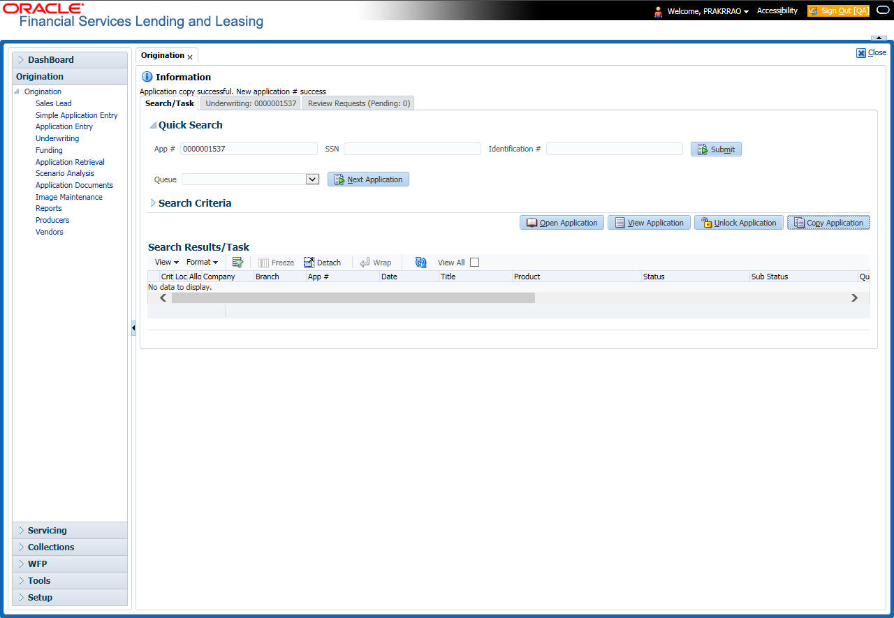

2.2.2.2 Copying an Application
Once the application clears the pre-qualification edits successfully, it moves to the underwriting queue. In the Underwriting/Funding screen, you can copy the information of an existing application into a new application. using Results screen. The new application will contain duplicated data of application information, the requested Lease information, credit bureau data, and collateral information. The new application will have status/sub status as New - Review Required.
To copy an application
  1. Open the Underwriting/Funding screen and use Quick Search screen to locate the application you want to copy.
  2. Select the application you want to copy on the Search Results/Task screen.
  3. Click Copy Application.
An Information message is displayed as “Application copy successful. New application # (new application number).”
System creates a new application with details of the copied application with status New - Review Required. The new application can be accessed from the underwriting screen irrespective of whether it is copied in Underwriting/Funding screen. The system also notes that this is a copied application with a system generated comment.

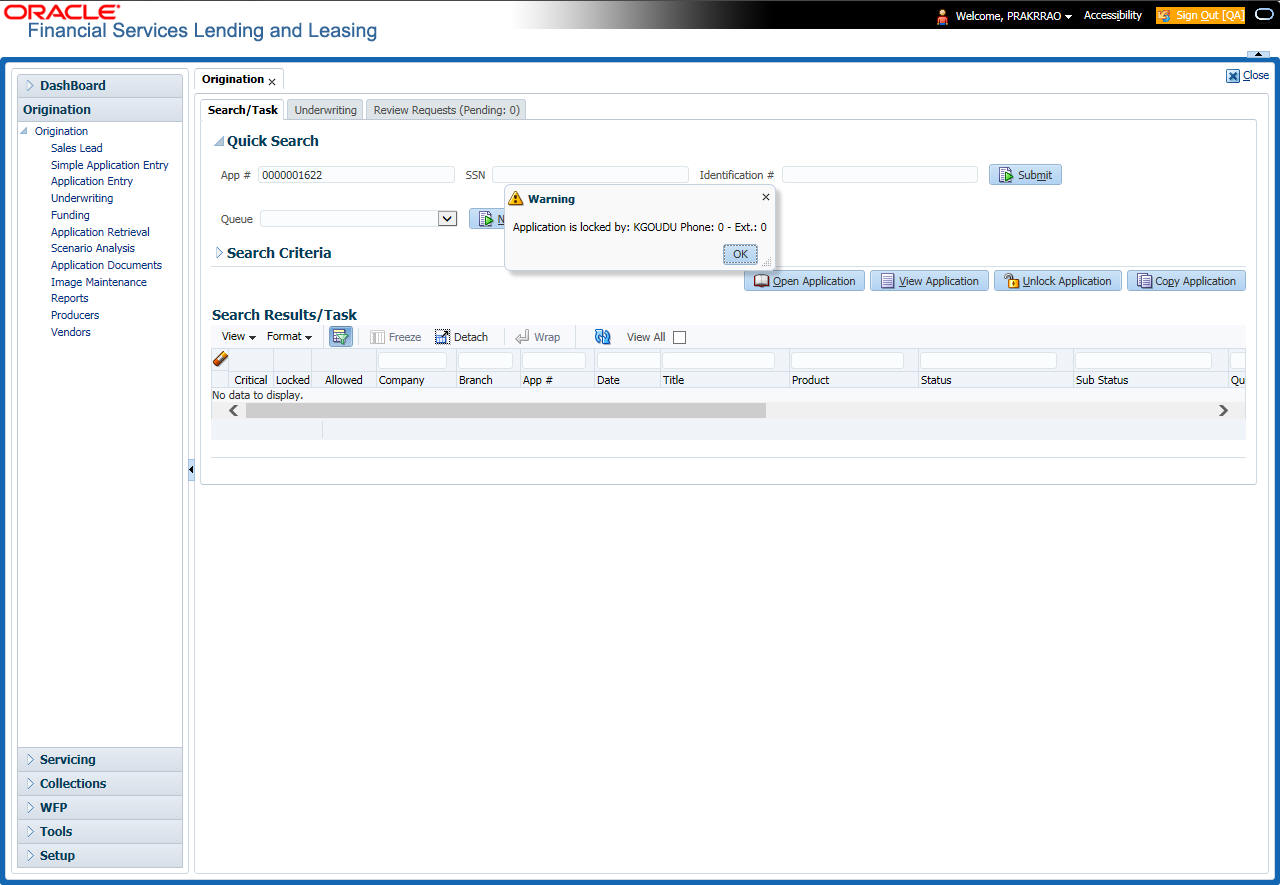

2.2.2.3 Unlocking an Application
When an application is opened by a user, the same would be locked for other users. Using Results screen in the Applications screen user can unlock the application.
To unlock an application
  1. Open Applications Entry screen and use Quick Search screen to locate the application you want to work with.
  2. On Search Results/Task screen, select the application you want to load and click Submit.
An Information message appears with the message: “An application is locked by another user.”
  1. Click Unlock Application.
  2. Click Open Application. The system loads application on the Underwriting screen.

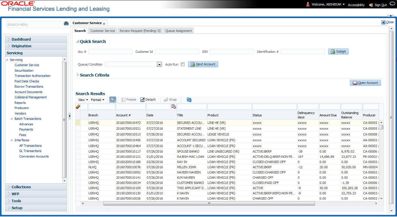

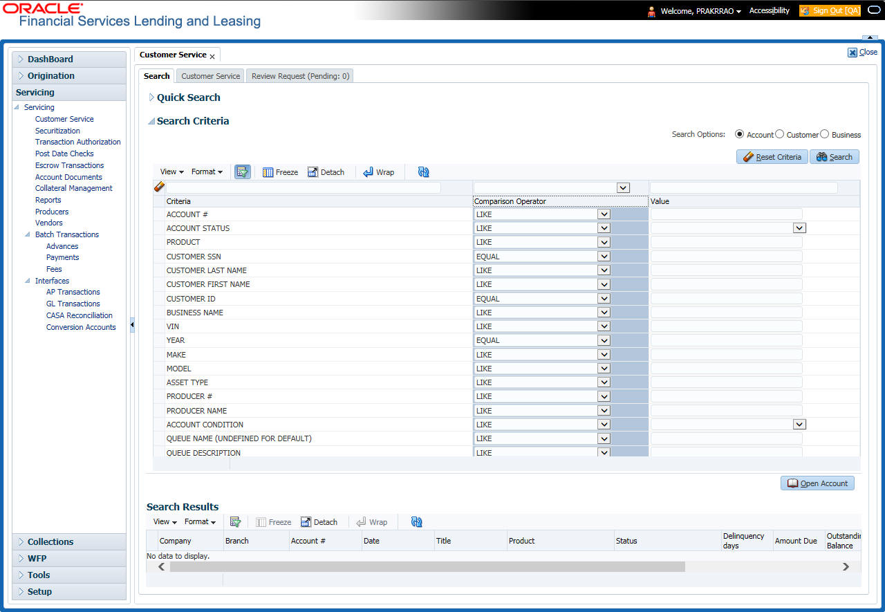

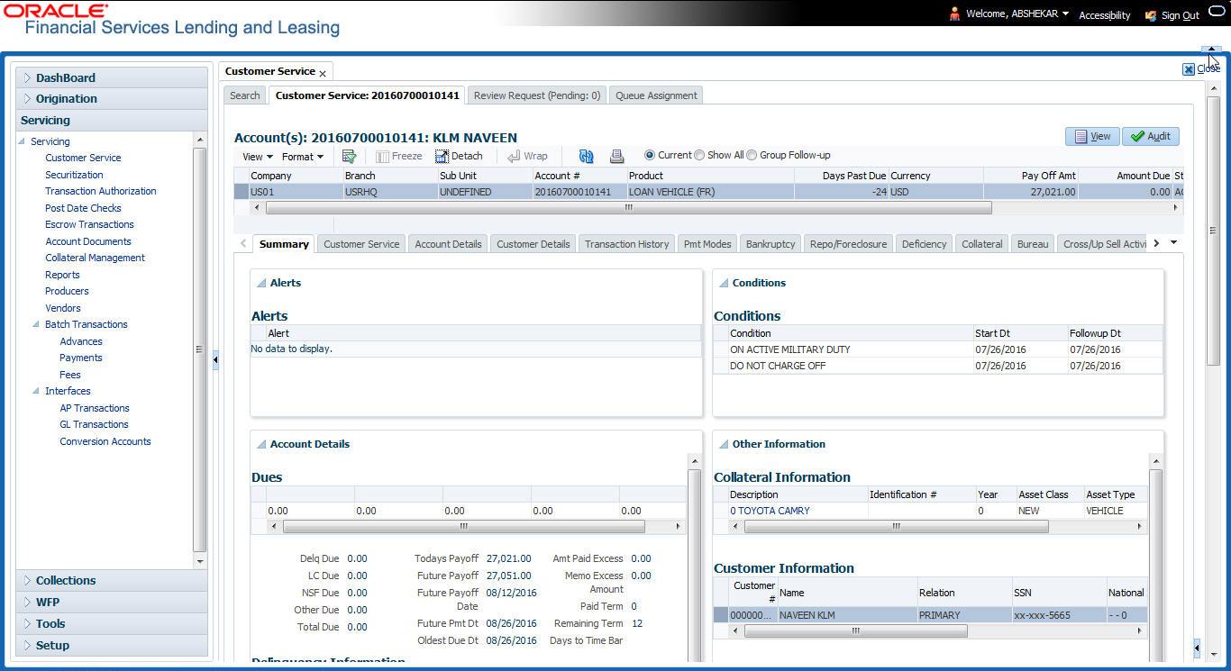

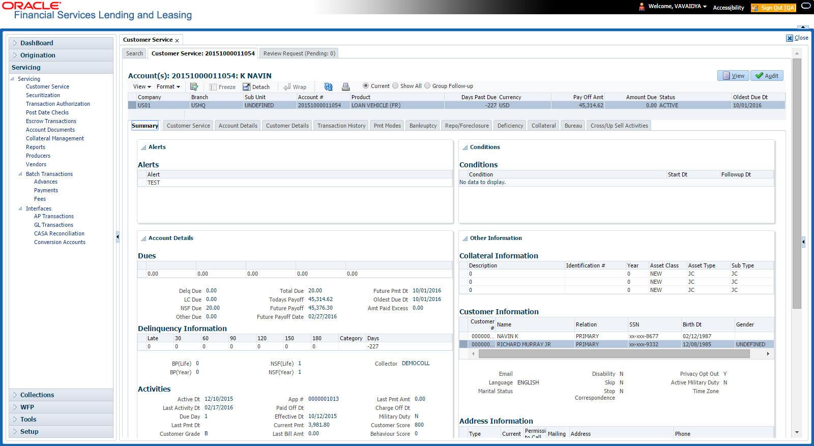

2.3 Searching for an Account and Customer
You can search or retrieve a particular account or customer through Customer Service screen. The search tab available in the screen enables you to locate an account or customer using a broad range of search criteria.
To view the Search screen during Lease servicing
  1. On the Oracle Financial Services Lending and Leasing Application home screen, click the Servicing master tab.
  2. If you want to perform a customer service task on the application, click Customer Service link.
Depending on the link clicked, Customer Service screen appears, opening at Results screen.
Note
Oracle Financial Services Lending and Leasing does not display the financial details of se­cured accounts if the logged-in user is not authorized. Though the search display the re­sults, the fields such as Status, Delinquency Days, Amount Due, and Outstanding Balance are masked with ‘xxxxx’ and clicking on the same displays an error message indicating ‘Cannot open secured account’.

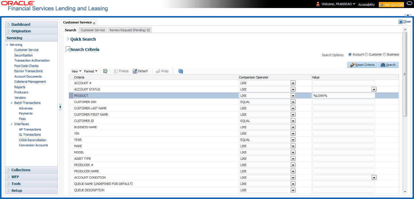

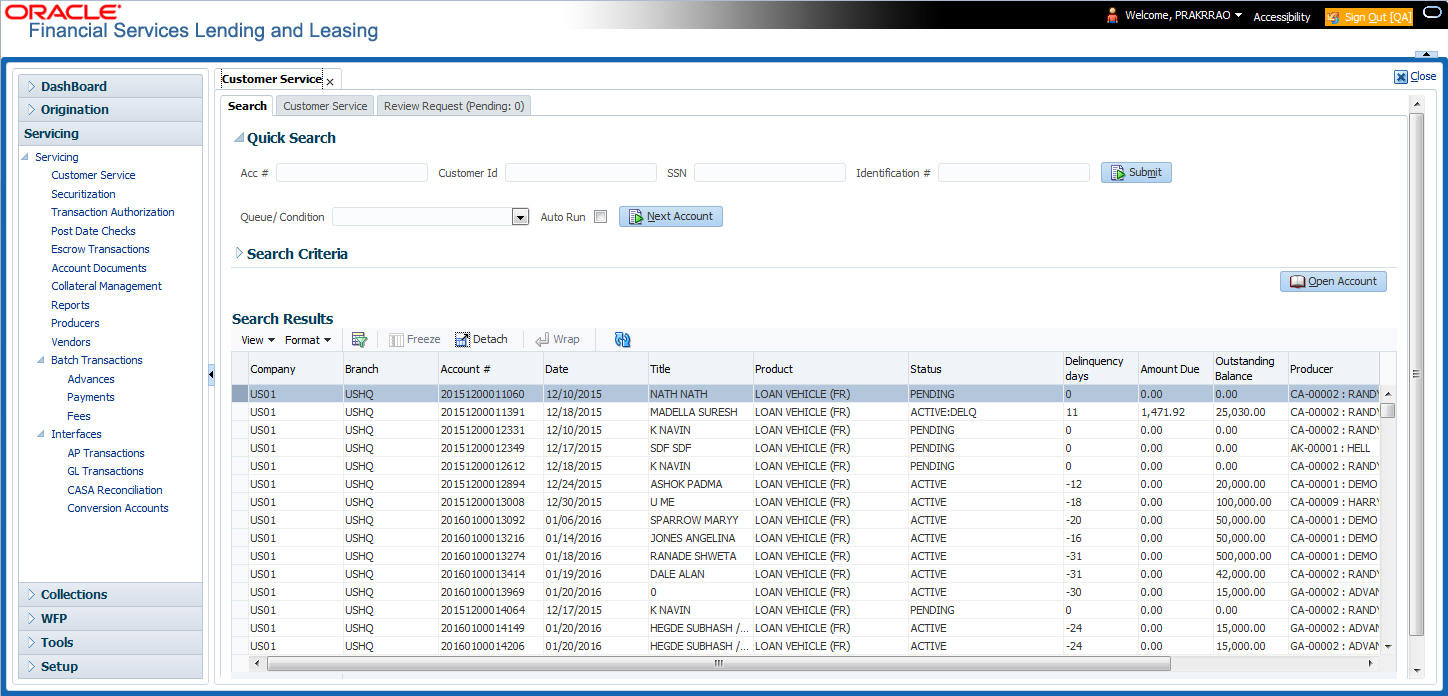

Using the Search tab
  1. Create a search criteria by specifying the required details in Comparison Operator and Value columns.
  2. Click Search. System displays all accounts that meet the search criteria in the Results tab.
  3. On the Search Results/Task screen, select the account you want to load and click Open Account.
The system loads account on Customer Service screen.

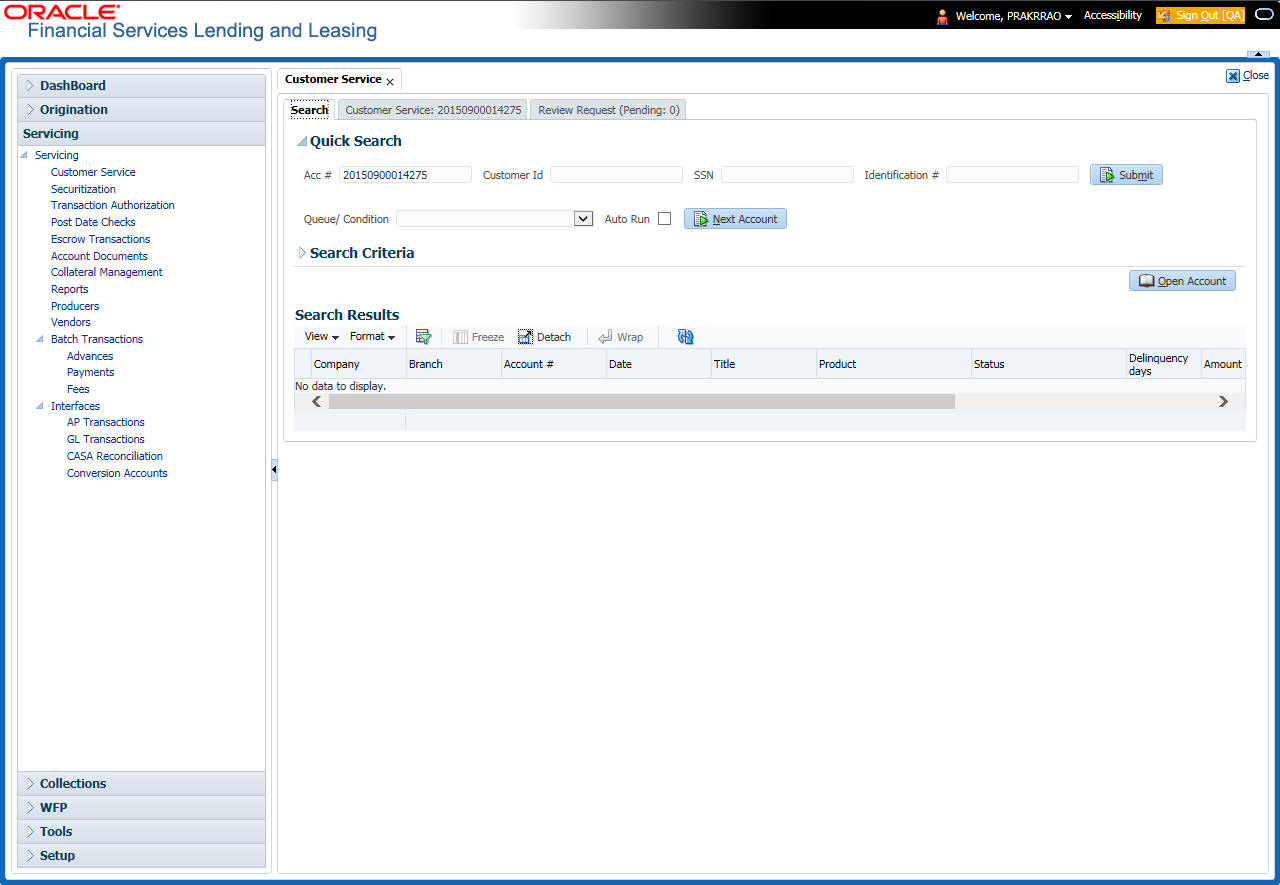

2.3.1 Quick Search section
The Quick Search section in Customer Service screen enables you to load accounts using any one of the fields Account Number, Customer Id, SSN, Identification #, or Queue/Condition.
To load an account using the Quick Search section
  2. If you want to perform customer service task on the application, click Customer Service.
  3. In the Quick Search section’s Acc#/Customer Id/SSN/Identification # fields, specify the corresponding Account number, or Customer Id, or last four digits of SSN or complete SSN in the respective fields and click Submit.
  4. When the request to access an application comes from an external system, user needs to check ‘Auto Run’ and click ‘Next’ button. System displays the customer service screen for the respective Account.
To load an account from a queue
In the Quick Search section’s Queue field, select the queue you want to work with and click Next Account.

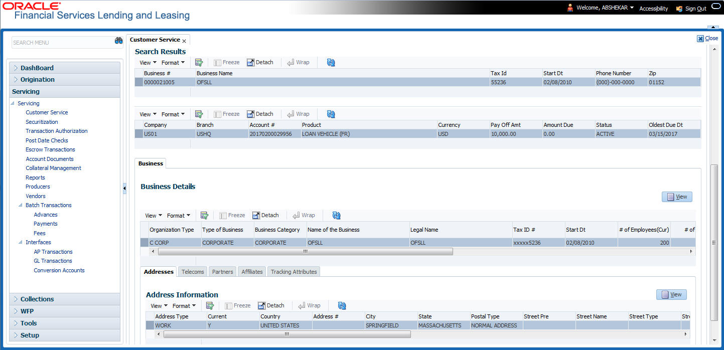

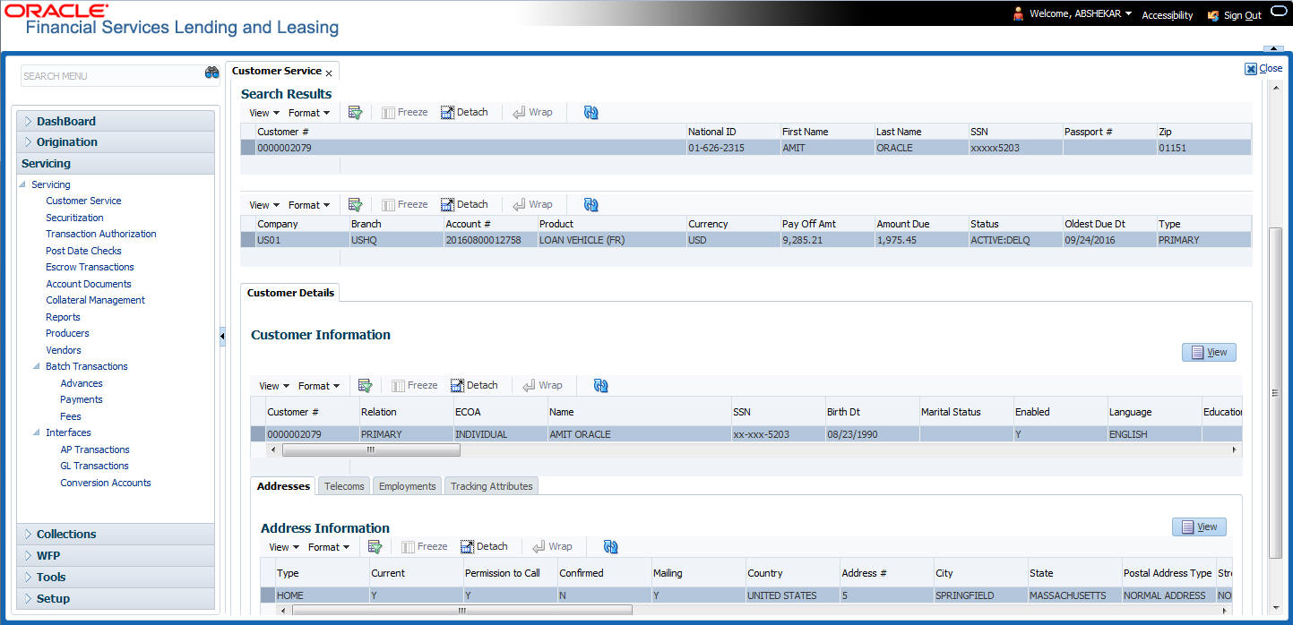

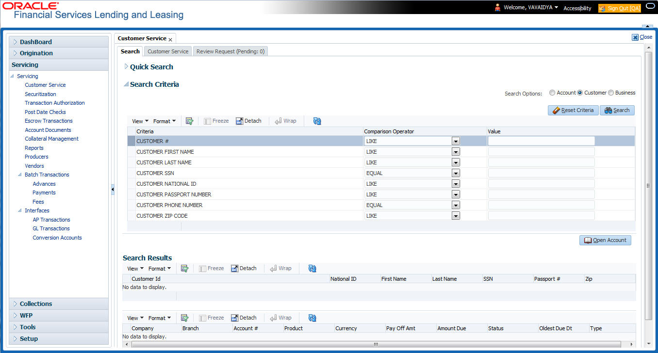

2.3.2 Search Using Customer Details
There are different ways to search a customer account using the customer details.
To search for and load the customer details with the Search screen
On the Oracle Financial Services Lending and Leasing home screen, click Servicing > Servicing > Customer Service > Search Criteria
Select Customer as a search option.
  1. On Search Criteria screen, use Comparison Operator and Value columns to create a search criteria to find the account using customer details. You can click Reset Criteria at any time to clear the Comparison Operator and Value columns.
  2. Click Search.
The system locates and displays all the accounts that meet your search criteria on Search Results screen.
  1. On the Search Results screen, view the following information for each account:
    In this field:
    View this:
    Company
    The company of the account.
    Branch
    The branch of the account
    Account #
    The account number
    Product
    The Lease product of the account.
    Currency
    The currency in which the account is operated.
    Pay Off Amt
    The total pay off amount on the account.

Also the ‘Customer Details’ section below displays the Customer Information along with Addresses, Telecoms, Employments, and Tracking Attributes. You can click ‘View’ to display the details in each section.
  1. On the Search Results screen, select the customer you want to retrieve. The system displays all the accounts pertaining to that customer Id. Select an account and click Open Account.
The system displays the account details on Customer Service tab.
2.3.3 Search Using Account Details
To search for and load an account using the Search screen
  1. Select Account as a search option.
  2. On the Criteria screen, use the Comparison Operator and Value columns to create a search criteria to find an account. You can click Reset Criteria at any time to clear the Comparison Operator and Value columns.
  3. Click Search. The system locates and displays all the accounts that meet your search criteria on Results screen.
  4. On the Search Results screen, view the following information for each account:
    In this field:
    View this:
    Company
    Branch
    Account #
    The account number
    Date
    The date the account was created.
    Title
    The primary and other applicant(s) attached to the account.
    Product
    Status
    The status of the account.
    Delinquency days
    The number of days the account has been delinquent.
    Amount Due
    The total amount due for the account.
    Outstanding Balance
    The total outstanding balance for the account.
    Producer
    The producer of the account.
    Secured
    If selected, indicates the account is secured and may only be loaded by authorized users.
  5. On the Results screen, select the application you want to retrieve and click Open Account.
The system loads the account under the tab
You are now ready to begin work on the account.

2.3.4 Search Using Business Details
To search and load an account with specific business using the Search screen
  1. Select Business as the search option.
  2. On the Criteria screen, use the Comparison Operator and Value columns to create a search criteria to find the business type. You can click Reset Criteria at any time to clear the Comparison Operator and Value columns.
  3. Click Search. The system locates and displays all the records that meet your search criteria on ‘Search Results’ section.
You can view the view the following information for each business record:
In this field:
View this:
Business #
The registered business number of the company.
Business Name
The name of the business.
Tax ID
The taxation identity number of the business.
Start Dt
The date when the business was initiated.
Phone Number
The contact number of the business.
Zip
The zip code where the business is established.
  1. On the Results screen, select the business type of your interest. The sub section displays the accounts associated with the selected business with the following details:
    In this field:
    View this:
    Company
    Branch
    Account #
    The account number
    Product
    Currency
    Pay Off Amt
    Amount Due
    The total amount due on the account.
    Status
    Oldest Due Dt
    The oldest payment due date on the account.
Also the ‘Business’ section below displays the Business Details along with Addresses, Telecoms, Partners, Affiliates and Tracking Attributes. You can click ‘View’ to display the details in each section.
  1. Select the required account and click Open Account. The system loads the account associated with the business type in the tab
