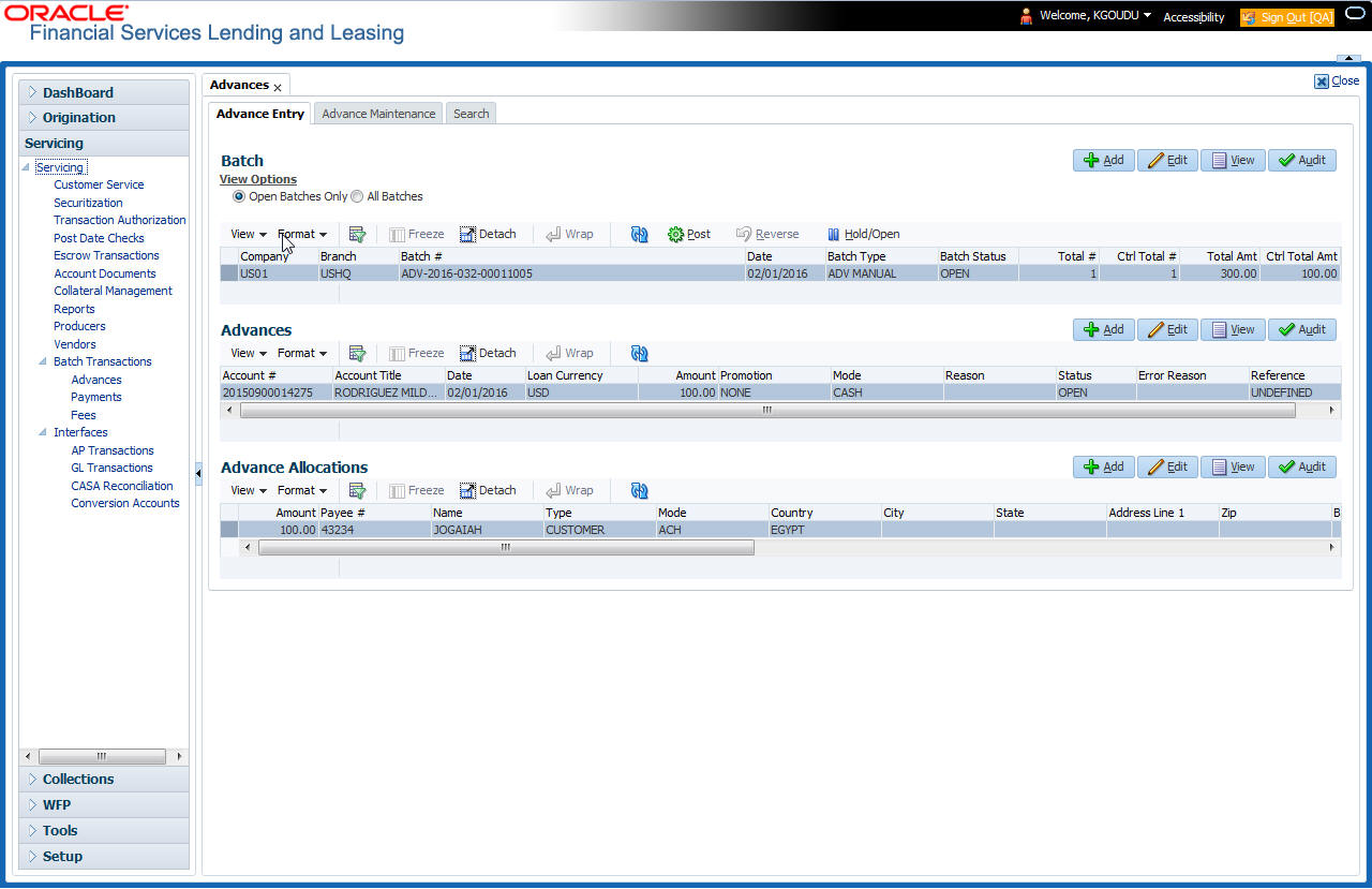

Using the Advance Entry screen, you can enter and view a batch of advance transactions. You can then complete the following tasks:
The Advance Entry tab enables you to view either all batches or only open batches. You can choose which batch you want to view using the View Options section. Viewing all batches enables you to locate batches with a status of open, reverse, hold, error, or posted.
To view open batches
To view all batches
If a batch contains a payment with an error status, the Error Reason field displays the cause.
The Advance Entry screen enables you to manually post batches of advances. A batch can consist of one or more accounts.
To enter and post a batch for advance transactions
A brief description of the fields is given below:

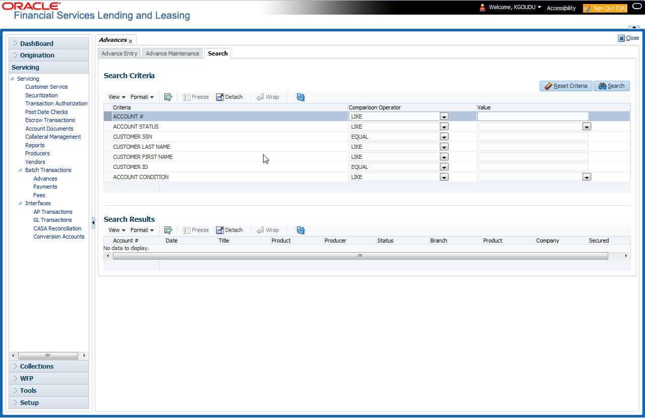

A Search link is available on the Advances screen to help locate information such as an account’s number, company and branch. This is information that is used on the Advance Entry and Advance Maintenance screens.
To search for an account
System displays result of the search in Results section at the bottom of the screen.
You can click Reset Criteria at any time to clear Comparison Operator and Values columns on the Search Criteria section.

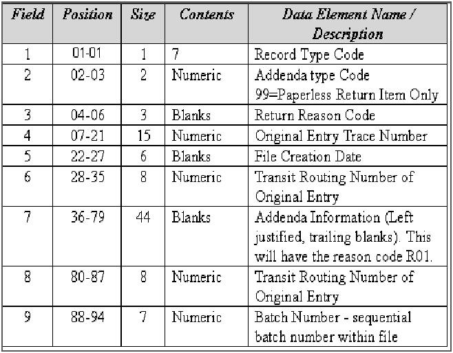

OFSLL supports bulk upload of payment transactions into the system in addition to the option of manually creating the records in the Payment Entry tab.
During the bulk upload process, a set of payment transactions can be grouped together into a single file, in a specific file format and uploaded into the system using the Process File interface. The upload file is then processed through a batch and after successful validation, individual records are created automatically in ‘Payment Entry’ tab with appropriate status.
While creating the upload file, it is necessary to maintain the details in specific format and to ensure that all the payment transactions are uploaded correctly without any issues during validation. The bulk upload file format supports One Header and Multiple Detail records and the currency defined in the header is applicable for all the records. Example of header record is indicated in the following table:
Company |
Currency |
Mode |
Reason |
Total # |
Total Amt |
US01 |
USD |
CASH |
PAYMENT MANUAL |
3 |
3000 |
In the header record, all the fields are mandatory except ‘Reason’. Each field information is validated with the data maintained in the system and in case of any discrepancies, the entire payment upload batch is rejected. For example, when the specified company code or currency code is not maintained, or if ‘Total Amount’ contains a non numeric data, the entire batch is rejected from processing.
The details of each transaction need to be maintained in the following format as indicated with system defined validations:

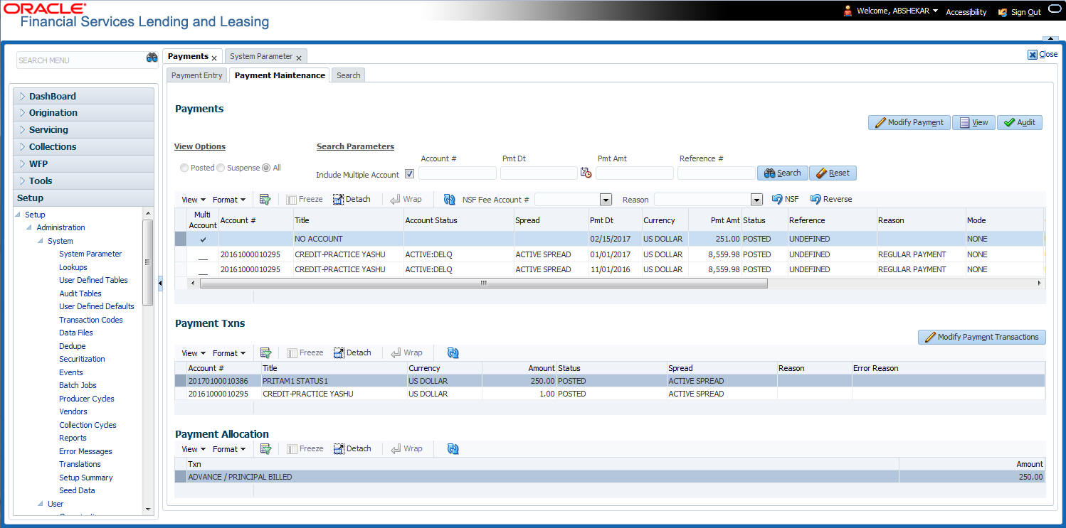

The Payment Maintenance screen enables you to perform the following maintenance functions on payments that have been posted:
The common functions are as follows:
Function: |
Purpose: |
Modify Payment |
Enables you to change one or more of the payment attributes, such as the Account number, Spread, Payment Date, Currency, Payment Amount, and Reason. For Single Account Payments, these details are editable in ‘Payments’ section itself and for ‘Multi Account Payments’, only Payment Date, Currency, Payment Amount, and Reason are editable in ‘Payments’ section and other details are editable in ‘New Payment Txns’ section below. |
Multi Account (check box) |
Selecting the check box allows to change the payment account type from Single Account Payment to Multi Account Payment and vice versa. However, doing so will reset the Payment level Account Information and need to be selected carefully. |
Non Sufficient Funds |
Notifies Oracle Financial Services Lending and Leasing that the customer did not have sufficient funds in the account and will post a NSF fee (based on setup). |
Reverse |
Enables you to simply reverse a payment. |
In all cases, system performs a ‘true backdating’ to post the transaction based upon transaction date. Interest recalculations are automatic and all necessary transactions can be sent to the general ledger for automatic reconciliation.

The Payment Allocation section details how the selected payment was applied against the account. This is useful in determining whether the payment was posted correctly or whether the spread or transaction date needs to be modified.
In some cases, a payment may be valid, but how it was posted was incorrect; for example, payment was posted to the wrong account, with the wrong date, or with incorrect spread data. The Payment Maintenance screen enables you to correct such errors.
Consider the following scenarios during payment maintenance:
To modify/correct an individual payment transaction
Field: |
Do this: |
Pmt Dt |
Select the payment date from the adjoining calendar. |
Currency |
Select the currency from the drop-down list. |
Pmt Amt |
Specify the payment amount. |
Reason |
(Optional) Select any of the relevant reason for the payment from the drop-down list. |
Field: |
Do this: |
Account # |
Select account number from the drop-down list. |
Amount |
Specify the transaction amount. |
Spread |
Upon account selection, system defaults the spread (payment allocation strategy) based on the matching details defined in Spread Matrix screen (Setup > Products > Spreads > Spread Matrix). If there are no matching details found or spread matrix is not defined, system defaults the spread defined at the contract. However you can also select the required spread for the payment from the drop-down list. |
Reason |
(Optional) Select any of the relevant reason for the payment transaction from the drop-down list. |
to add additional
payment transactions. System inserts a new record and allows you to specify
the above details. When new records are added for single account in payment
Txns section, system automatically changes the record to 'Multi Account'
and displays in 'Payments' section.
The system modifies the original payment and posts new payment. The modified payment can be viewed on the Customer Service screen’s Transaction screen.

An outbound customer extract file can be generated and sent to multiple payment vendors like Money gram, Quick Collect, Speed Pay from Western Union, Lockbox etc. Sharing this extract enables various outlets of these payment agencies to verify account’s existence in FI and proceed with payment processing.
After receiving the payment extract file, the vendor validates customer details and sends a notification confirmation of Payment in NACHA format.
Processing
The system generates customer extract of customers from which payment is expected, everyday. This process is configured as ‘Outbound Customer Extracts To Payment Agencies Batch’ batch job which is run daily. The batch generated an extract in text format containing all Accounts relevant details.
Accounts with payment mode ACH or Lockbox can be excluded. The system facilitates setting-up options to pick up payment modes that needs to be included in extract generation.
This file is stored in a configurable shared path from which it is shared to required outlets as discussed earlier.

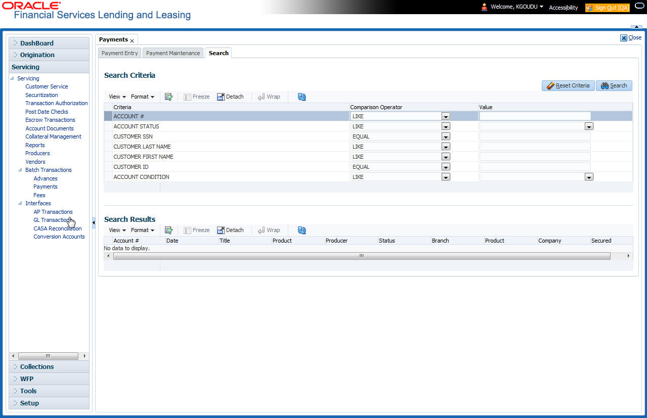

System displays result of the search in Results section at the bottom of the screen. You can click Reset Criteria at any time to clear the Comparison Operator and Values columns on the Search Criteria section.

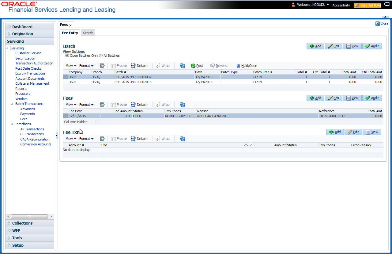

The Fee Entry screen enables you to manually post batches of fees. A batch can consist of one or more accounts.
To enter and post a batch for a fees processing
A brief description of the fields is given below.

The Fees section records itemized information of the fees batch processing. It enables you to make one payment to one account, or more than one payment to more than one account.
Field: |
Do this: |
Fee Date |
Select the fee effective date. This date must be less than or equal to the date recorded in the Batch section. |
Fee Amount |
Specify the fee amount. |
Status |
View the payment status. |
Txn Codes |
Select the transaction code. |
Reason |
Select the reason for the payment. |
Reference |
Specify any reference information (such as check number). |
Total Amount |
View the total amount of the batch. |
Account # |
Select the account number to which this payment applies. |
System updates Ctrl Total # and Ctrl Total Amt fields in Batch section to record the contents of the Fees section.

To open (or remove hold) on the batch of fee processing
The system changes the batch status from Hold to Open.
Only the batches with a status of posted can be reversed.
To reverse the batch of fee processing
System changes batch status from posted to Processing and submits batch to the job service. After the batch has been processed, system changes the batch status to Reversed.
A Search screen is available on the Fees screen to help locate information such as an account’s number, customer name and company. This is information that is used on the Fees Entry screen.
