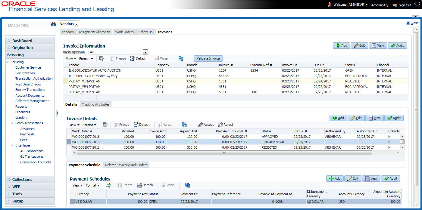

Once an invoice has been presented for a service performed by a vendor, you can enter information on Vendor Management form and create a monetary transaction. You can then choose if the customer should pay any particular expense or not.

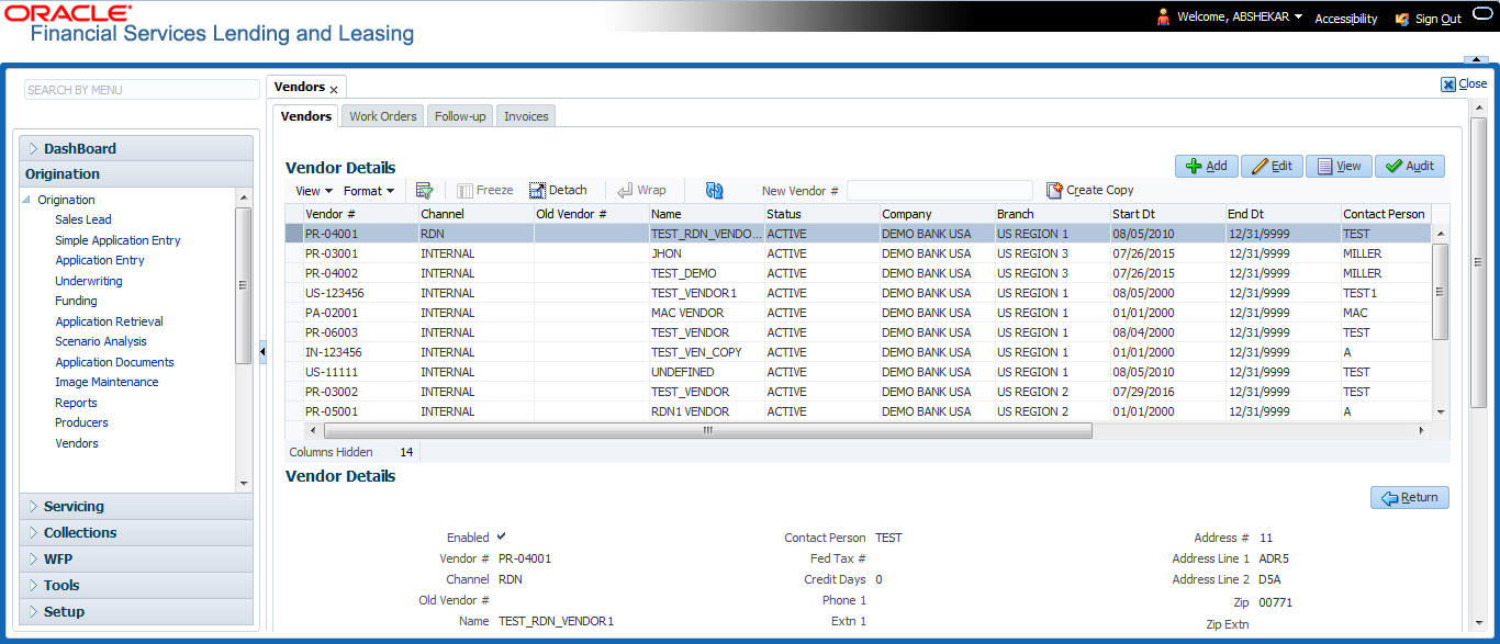

The Vendors screen allows you to set up vendor information. You can also use the copy feature to quickly create new vendors with the existing details. By default it will show current address but if the vendor receives escrow disbursement at an address which is different from current business address the information can be entered in Payment Details sub screen. Also, the Payment Details sub screen allows you to enter number of days prior to the due date by which payment to vendor must be processed.
Navigating to Vendor Detail Screen
A brief description of the fields is given below:
Field: |
Do this: |
Enabled |
Check this box to enable the vendor. |
Vendor # |
The vendor number is either editable (default) or auto generated depending on the system parameter defined at setup screen. System auto generates the vendor number when the following system parameter is set to ‘Yes’ in Setup > Administration > System > System Parameter screen. - Parameter: UVN_VEN_NBR_SYS_GENERATED - Description: VENDOR NUMBER IS SYSTEM GENERATED |
Channel |
Select the vendor channel from the drop-down list. |
Old Vendor # |
Displays the old vendor number if exists. |
Name |
Specify the vendor name. |
Status |
Select the vendor status from the drop-down list. |
Company |
Select the vendor portfolio company from the drop-down list. |
Branch |
Select the vendor portfolio branch from the drop-down list. |
Start Dt |
Specify the vendor start date. You can select data even from the adjacent Calendar icon. |
End Dt |
Specify the vendor end date. You can select data even from the adjacent Calendar icon. |
Contact Person |
Specify the vendor contact name. |
Fed Tax # |
If available, enter the vendor federal tax identification number. If the organizational parameter UIX_HIDE_RESTRICTED_DATA is set to Y, this appears as a masked number; for example, XXXXX1234. |
Credit Days |
Specify the credit days for the vendor invoice. This number is used to check that Invoice Due Date is not more than the credit days from Invoice Date. |
Phone 1 |
Specify primary phone number. |
Extn 1 |
Specify the primary phone extension. |
Phone 2 |
Specify alternate phone number. |
Extn 2 |
Specify the alternate phone’s extension. |
Fax |
Specify the fax number. |
Fax 2 |
Specify the fax number 2. |
Country |
Select the country code from the drop-down list. |
Address # |
Specify the vendor address. |
Address Line 1 |
Specify address line 1. |
Address Line 2 |
Specify address line 2. |
Zip |
Select the zip code from the drop-down list. |
Zip Extn |
Specify the extension of the Zip code. |
City |
Specify the city. |
State |
Select the state from the drop-down list. |
Specify the email address. |

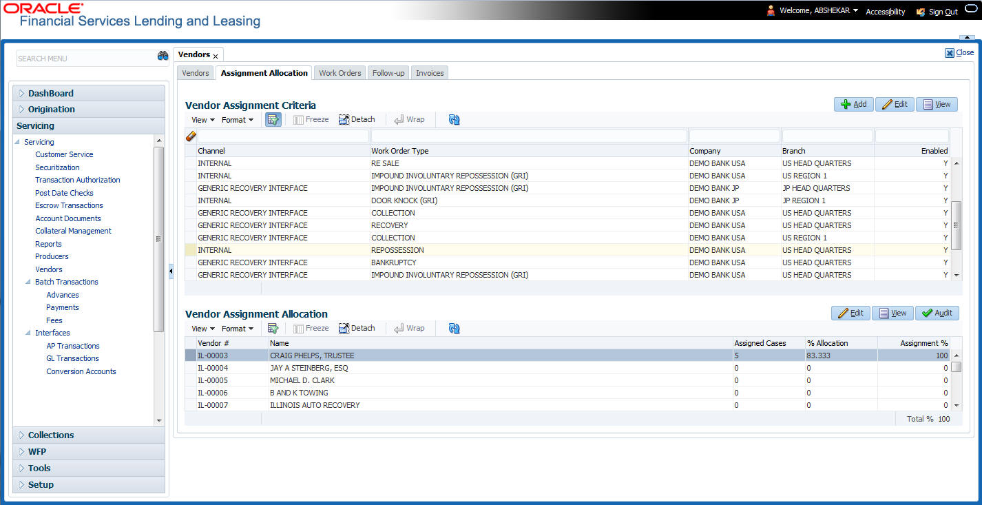

The Assignment Allocation tab allows you to define criteria for selecting a specific vendor to execute a work order. A criteria here refers to a combination of a Channel, Work Order Type, Company and Branch associated to a vendor. If the same combination or criteria is selected during work order creation, system selects a specific vendor or highest weighted vendor in the list by default for the work order.
Click Servicing > Servicing > Vendors > Assignment Allocation. The details are grouped under two sections:
In the Vendor Assignment Criteria section, you can define the criteria used for vendor selection.
Field: |
Do this: |
Channel |
Select the OFSLL interfaced channel from the drop-down list. If the channel is selected as ‘GENERIC RECOVERY INTERFACE’, the work order is processed through an external system. For more information, refer to Appendix chapter - ‘Generic Recovery Interface (GRI)’. |
Work Order Type |
Select the work order type from the drop-down list. |
Company |
Select the Company from the drop-down list. |
Branch |
Select the company’s Branch from the drop-down list. |
Enabled |
Check this box to enable the vendor assignment criteria. |
In the Vendor Assignment Allocation section, system fetches the list of vendors qualifying the combination of channel, work order, company and branch selected and allows you to define the weightage for each vendor in percentage.
By default, the allocated assignment percentage for each vendor is ‘0’. During subsequent update, the total of assignment percentage allocation for all vendors should be equal to ‘100’. A vendor with the highest weightage is selected by default during work order creation.
Field: |
Do this: |
Vendor # |
View the Vendor number. The same is either specified manually or system generated in the Vendors tab. |
Name |
View the name of the vendor. |
Assigned Cases |
View the total number of cases assigned to the vendor. |
% Allocation |
View the percentage of total cases assigned to the vendor. |
Assignment % |
Specify the percentage allocation value (out of 100) for each vendor. However, ensure that the total of all assignment % is equal to ‘100’. |

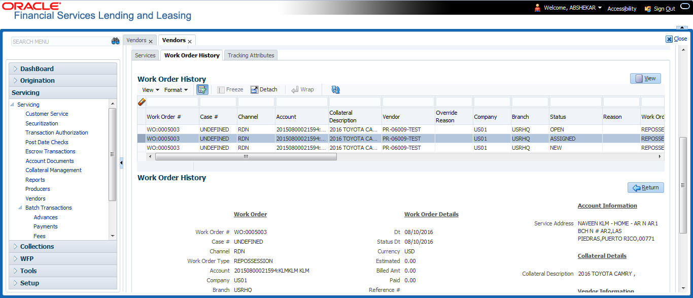

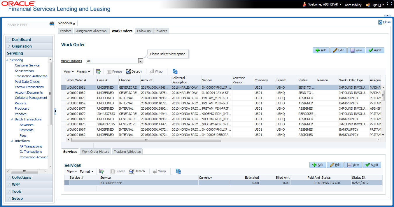

The Work Orders link allows you to assign an account to a vendor for a service that the vendor provides, view the history of work order changes and define tracking attributes.
Field: |
Do this: |
Work Order # |
Displays the work order number. |
Case # |
Displays the case number received from third party vendor interface. |
Channel |
Work Order Type |
Account |
Select account number for the work order from the drop-down list. |
Company |
Displays the company name based on the account selected. |
Branch |
Displays the branch based on the account selected. |
Vendor |
Select vendor who will service the work order from the drop-down list. The list of vendors are displayed based on the selected Channel, Work Order Type, and Account. |
Override Reason |
In case of vendor re-assignment, select the appropriate override reason for the selected Vendor. |
Status |
Select the work order status from the drop-down list. If the status is selected as ‘SEND TO GRI’, the work order is processed through an external system. For more information, refer to Appendix chapter - ‘Generic Recovery Interface (GRI)’. |
Reason |
This field is enabled only if the status of work order is selected as PENDING ON HOLD, RL RELEASED , or PENDING CLOSE. You can select the appropriate reason from the drop-down list. |
Collector |
Select the Collector from the drop-down list. The list displays all the users defined with ‘Collector’ responsibility. |
Work Order Details section |
Dt |
Displays the date when work order was created. |
Status Dt |
Displays the last work order status-change date. |
Currency |
Displays the vendor company currency based on the vendor selected. |
Estimated |
Displays the estimated amount, which is the sum of all the services added to the work order. |
Billed |
Displays amount billed by the vendor for the work order. |
Paid |
Displays amount paid to the vendor for the work order. |
Reference # |
Specify vendor reference details if any. |
Assigned By |
Displays the user who created/assigned the work order to vendor. |
Followup Dt |
Select the subsequent follow-up date from adjoining calendar. |
Account Information section - System displays the following information depending on the account selected for the work order in ‘Work Order’ section. |
Account Status |
Displays the status of the account. |
Charged off Dt |
Displays the date when the account was charged off. |
Due Amt |
Displays the due amount to be paid to the account. |
Total Outstanding Balance |
Displays either ‘Account outstanding principal balance’ for active accounts, or ‘Deficiency balance’ for charge-off accounts. |
Total Due |
Displays the total of all dues pending on the account. |
Due Dt |
Displays the last elapsed due date on the account. |
Days Past Due |
Displays the total number of days elapsed past due date. |
Service Address |
Displays the combined details of Customer, Address Type and Address based on the account selected. You can also select the required service address from the drop-down list only while creating work order details (i.e. when status = New). Note: When selecting the service address for an external interfaced channel (i.e. changing primary address), ensure to select the secondary address only. Else, system displays an error message. |
Collateral Details section - This section displays the asset details associated with the work order. |
Collateral Description |
System displays the primary collateral associated with the account by default. You can also select the collateral from the drop-down list. The list displays all the assets associated with the account. |
Identification # |
Displays the identification number of the asset. |
Year |
Displays the manufacturing year of the asset. |
Make |
Displays the asset’s manufacturing company. |
Model |
Displays the asset’s model. |
Vendor Information section |
Contact |
Specify the vendor contact for the work order. |
Phone |
Specify the vendor contact phone for the work order. |
Extn |
Specify the vendor contact phone extension for the work order. |
Fax |
Specify the vendor contact fax for the work order. |
Comment |
Specify any comments regarding the work order. |
Vendor Messages section - This section is displayed only when the selected channel is ‘GENERIC RECOVERY INTERFACE’ and allows you to add specific communication or instructions as a message to the vendor. |
Vendor Msg Type |
Select the type of vendor message from the drop-down list. |
Vendor Msg |
Specify additional information that is to be communicated to the external interface. |
In the Servicing > Servicing > Vendors > Work Order > Services, perform any of the Basic Operations mentioned in Navigation chapter.
Click ‘Load Services’ button in the Services section header to load all the services associated with the selected combination of ‘Work Order Type’ and ‘vendor (Vendor Group)’.
Field: |
Do this: |
Service # |
Specify an unique service number for the work order. |
Service |
Select the service type from the drop-down list (required). |
Currency |
System defaults the currency defined in work order which is the vendor currency. |
Estimated |
System defaults the Estimated cost of the service offered by the vendor as defined in vendor administration setup screen (Setup > Administration > System > Vendors > Vendor Fees > Vendor Service Fee Definition). However, you can also modify the estimated value to the required amount. |
Billed Amt |
Displays amount billed by the vendor for the service. |
Paid Amt |
Displays amount paid to the vendor for the service. |
Status |
Select the status from the drop-down list. |
Status Dt |
Displays the last service status change date. |
Perform any of the Basic Actions mentioned in Navigation chapter.
The Work Order History sub tab displays the details of the selected work orders in the sequence of the changes done i.e. last change details appear as the first record.
In the Work Order History section, select the required work order and click View.
Click Servicing > Servicing > Vendors > Work Order > Tracking Attributes. The Tracking Attributes allows you to load tracking attributes and define the parameter value for various parameters listed.
On the Tracking Attributes sub tab, perform any of the Basic Operations mentioned in Navigation chapter.

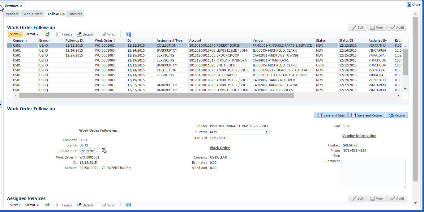

The Work Orders link lists the work orders that are not complete and hence require follow-up.
Field: |
Do this: |
Company |
Displays the vendor company. |
Branch |
Displays the vendor branch. |
Followup Dt |
Specify the next follow-up date. You can even select the date from adjoining Calendar icon. |
Work Order # |
Dt |
Displays the work order date. |
Account |
Displays the account associated with the work order. |
Vendor |
Displays the vendor associated with the work order. |
Status |
Select the work order status from the drop-down list. |
Status Dt |
Displays the last work order status change date. |
Work Order section |
Currency |
Displays the currency for the work order. |
Estimated |
Billed Amt |
Paid |
Contact |
Displays the vendor contact name. |
Phone |
Displays the vendor contact phone number. |
Extn |
Displays the vendor contact phone number’s extension. |
Comment |
Specify a comment. |

In the invoice tab of vendors screen, you can define invoices and process them along with internally generated and externally received invoices. Invoice processing involves validating the invoice information either manually or through an automated process.
Manual validation involves verifying the invoice information, accepting or rejecting the details, updating the invoice status and indicating if the invoiced amount is Collectible.
Auto validation is supported for invoices which are in ‘OPEN’ status and generated internally (i.e. channel = Internal). During auto validation, the invoice details are verified against specific business rules defined in the system and corresponding status update and collectible indicator is updated accordingly.
However, other invoices received from externally interfaced channel would get auto validated with specific business rules when they are received and corresponding status is appended to the invoice while listing in the Invoice Information section.
Post the validation, invoices may still have difference in estimated and invoiced amount. Such invoices are marked with status ‘FOR APPROVAL” and requires to be manually approved.
Further in the Invoices tab, you can define Tracking Attributes, Payment Schedules and view the Related Invoice/Work Orders (if any) in the system.
Field: |
Do this: |
Vendor |
Select the vendor name for whom the invoice is to be created. |
Company |
Displays the vendor portfolio company. |
Branch |
Displays the vendor portfolio branch. |
Invoice # |
Specify the invoice number. The invoice number should be unique for every vendor. In case the Invoice # already exists for Vendor, system displays a warning message. |
External Ref # |
Specify the reference number which can be used for invoice tracking. For invoice received from external system, this field is auto populated with the reference number generated in external interfaced system. |
Invoice Dt |
Specify the invoice date. You can even select the date from the adjoining Calendar icon. |
Due Date |
Select the due date. You can even select the date from the adjoining Calendar icon. |
Status |
Select the invoice status from the drop-down list. |
Details section |
Status Dt |
Displays the last invoice status change date. |
Address |
Displays the vendor address. |
Currency |
Select the currency from the drop-down list. |
Estimated |
Displays the total estimated amount of all the invoices defined in ‘Invoice Details’ sub tab. |
Invoice Amt |
Displays the total invoice amount. |
Agreed Amt |
Displays the total agreed amount. |
Paid Amt |
Displays the total paid amount. |
Channel |
Displays the Channel as ‘Internal’ for manually defined or internally generated invoice and ‘Generic Recovery Interface (GRI)’ for externally generated invoice. |
You can auto validate the invoice details in the Invoice Information section for those invoice which are in ‘OPEN’ status. Auto validation with system defined business rules ensure that every approved invoice comply to required processing standards and helps to quickly proceed with further action.
The invoice details are validated and the status of the invoice is updated based on validation. For more information on validations, refer to ‘Business Rules’ section.
Field: |
Do this: |
Work Order |
Select the work order from the drop-down list. This list displays the generated work orders. Each work order name is defined in the format which consists of work order number, account number, service number and service name. |
Case # |
System displays the Case number only if there is a Case number is associated for the selected work order. |
Estimated |
Displays the estimated cost of selected work order as defined in Vendors > Work Order > Services section. |
Invoice Amt |
Specify the invoice amount. |
Agreed Amt |
Specify the agreed amount. |
Paid Amt |
Displays the paid amount. |
Txn Post Dt |
Specify transaction effective date. You can even select the date from the adjoining Calendar icon. |
Status |
Status Dt |
Displays the last status change date. On edit, system updates the current date by default. |
Authorized By |
Displays the name of the user who verified (accepted/rejected) the invoice details. |
Authorized Dt |
Displays the date when the invoice details were verified. |
Collectible |
Check this box to indicate if the agreed amount is collectible from the customer. When checked, the collectible amount is posted as an expense on the customer account. During auto invoice validation, this check box is automatically selected if the same combination of a service and work order status matches with the state specific rule defined in Setup > Administration > System > Vendors > Invoice Rules tab. |
In the Invoice Details sub section, you can accept or reject the details of those invoices which are in ‘FOR APPROVAL’ status. This status is updated during invoice processing and when there is difference in estimated and invoiced amount which needs manual approval.
Refresh button to
view the status update.
On Accepting or Rejecting the invoice details, the ‘Authorized By’ and ‘Authorized Dt’ fields are auto updated with user name and current date. Also the status of Invoice information and Payment Schedules are updated as either ‘CLOSE’ or ‘REJECTED’ respectively. However, auto update of status is controlled by the ‘Current/Next’ status defined in Cycle Setup screen.
If the status of a particular invoice is updated from ‘APPROVED’ to ‘CLOSE’, system generates a payment requisition record for payment processing.
