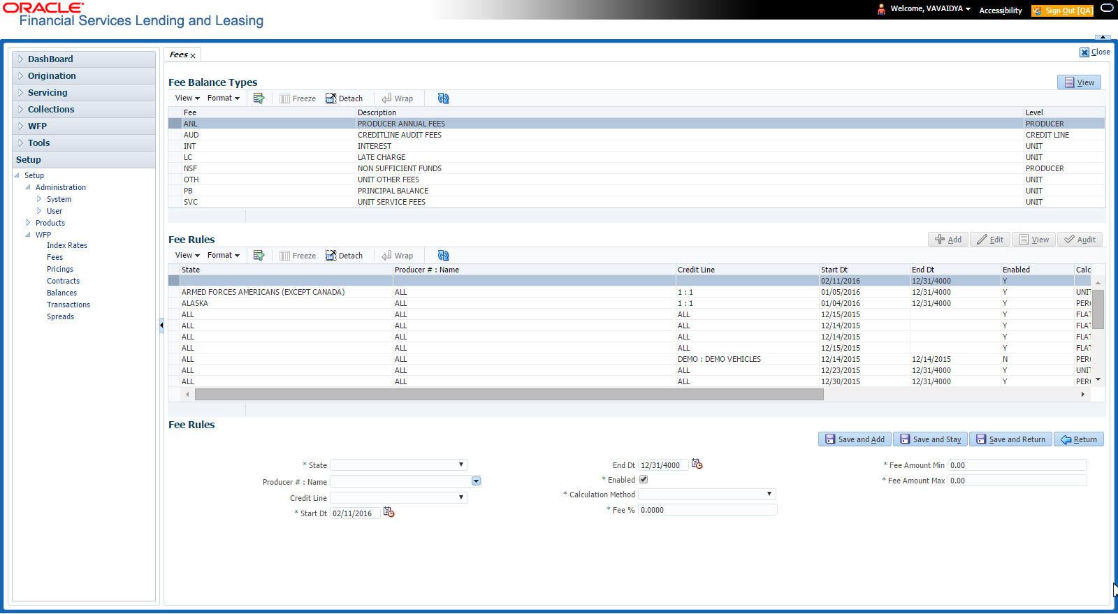

To use the Fees link
On the Oracle Financial Services Lending and Leasing home screen, click Setup > Setup > WFP > Fees.
  1. In the Fee Balances Types section, select the record you want to work with.
Note
If you choose, use Search Criteria to limit the display of instrument records.
  1. In the Fee Balances Types section, view the following information:
    In this field:
    View this:
    Fee
    The system defined fee types applicable for WFP (display only).
    Description
    The balance description of the fee type (display only).
    Level
    View the balance type level at which a fee is applicable: Producer, CreditLine, or Unit (display only).
  2. In the Fee Rules section, select the record you want to work and click Show in the Details column.
Note the following:
  1. In the Fee Rules section, enter, view, or edit the following information:
    In this field:
    Do this:
    State
    Select state initials (required).
    Producer #: Name
    Select the producer (optional).
    Credit Line
    Select the credit line (optional).
    Start Date
    Start the date from when the fee rule is applicable (required).
    End Date
    Start the date till which the fee rule is applicable.
    A blank field indicates no end date (optional).
    Enabled
    Select to enable this fee rule.
    Calculation Method
    Select the calculation method. If the calculation method is FLAT, then Fee% field should have the value 0.0 and the Fee Amount - Maximum field would have the same value as that in the Fee Amount - Minimum field. Oracle Financial Services Lending and Leasing uses the Fee Amount - Minimum field for fee calculation (required).
    Fee%
    Enter the fee percentage (required).
    Fee Amount Mini­mum
    Enter the minimum fee amount that would be charged to the pro­ducer (required).
    Fee Amount Maxi­mum
    Enter the maximum fee amount that would be charged to the pro­ducer (required).
  2. Click Save on the Fee Balance Types section.
