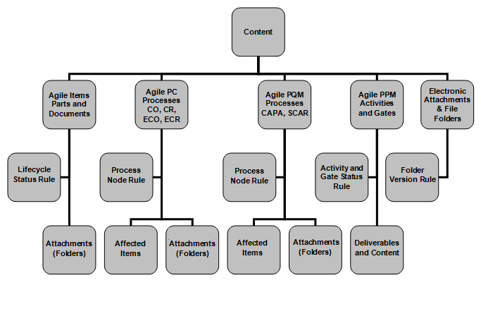

In PPM, 'content' refers to deliverables associated with the project. A deliverable can be any project or project object that has a lifecycle phase or a workflow assigned to it, or any file added as an attachment in the Content tab. Examples of content are programs, projects, phases, templates, files or URLs, or objects referenced from other applications.
The Content tab is not simply a list of deliverables, but a rule-based control system for project management. Any content can have a rule associated with it. Rules can be set to prevent tasks from starting or completing unless certain deliverables have reached specific states or status. The template will allow you to build out complex control mechanisms that alert users, automate many project processes, and prevent inappropriate tasks from starting or completing out of sequence or without the right information. The following picture outlines what the Content tab can contain, what rules can be applied and if the content itself can have attachments or content:
Important: As a best practice, it is recommended that the Attachments tab in Agile PPM activities and gates be disabled. Agile PPM provides a unique tab, the Content Tab, that must be used for all project content, including attachments, for projects. |
Discussions, Users, and User groups are the only objects that cannot be added as deliverables.
This section describes content objects and key functions such as adding new content, marking content as 'Mandatory', and working with the Content tab.
The ability to discover and view content on the Content tab of an object is dependent on the user's assigned privileges. File folders, however, are handled differently on the Content tab.
On the Content tab of an activity or gate object, any user with read privilege for that object's Content tab can view any file folder that was added by an authorized user. As long as the user has discovery and read privilege for the activity/gate object's Content tab, they do not need discovery privilege for the file folder object itself. All of the fields' values, however, will display No Privilege without appropriate privileges. The user must have Read privilege to the target File Folders and Enforce Field Level Read privilege to read and access the File Folder object.
You can add activities and gates as deliverables on other activities and gates. You can also set rules to ensure the completion of one activity before another. For example, to ensure the completion of an activity before a gate is opened, you can add that activity as a deliverable for the gate to open. You can even restrict one gate from opening before another gate is opened, by adding the prior gate as a deliverable to the subsequent gate.
For more information on defining rules, see "Defining Rules for Content."
When adding Projects as deliverables to other projects, they can be Proposed or Active.
Templates can also be deliverables. For a project that has its own copies of deliverables, a template can be a deliverable on tasks.
You cannot add an object that causes a circular relationship as a deliverable. For example, you cannot mandate that Task1 is a deliverable for Task2 to reach completion, and Task2 is a deliverable for Task1 to reach completion.
To add an object, you must have Create privilege for that object, and Modify privilege on the attribute for that object.

There are certain considerations you need to remember when you create a project from a Template as described in "Creating a Project." These are provided here for your reference.
While creating a Project from a Template, you can opt to duplicate or clone the Content objects from the template project. Select the Content check box in the Optional tab section of Create new > Project > From Template> Create New dialog.
If the Content check box is selected, copies are created for all deliverables in the template. The project and all its child activities will reference the newly created copies and not the original deliverables in the template. For example, a content object such as a Marketing Requirements Document that was available in the template is duplicated in the new project, with the file attached from the template.
If the Content check box is not selected, there are no copies of deliverables created, and no links are provided to any deliverables on the template.
If the Content object does not have a Rule, only the link is copied and this link will point to the same object as in the template. For example, a Content object such as a Standard Operating Procedure (SOP) document, where it is not necessary to create an object, and only a link to the controlled document is necessary.
In the template, if a task's workflow rule criteria has already been met, the content is copied over to the new project but not the rule.
For example - A task in the template has the following rule - When Complete, Set Active Gate to In Review. If the Active Gate is Open or Canceled, it is already past the In Review Status in the workflow progression, so the rule is not copied over.
In general, copies are not created for all objects that do not have a Save as functionality. All deliverable objects for which copies cannot be automatically created are listed in the error log window.
If multiple AutoNumbers exist on a content object and the system does not know which one to use, content is not created and an error is reported.
Within the template, ensure that an AutoNumber is set for each deliverable. Deliverable AutoNumbers for the created project are automatically selected based on the AutoNumber chosen for the original deliverable in the template.
The AutoNumbers attribute is not filled in Proposed or Active type projects. If such projects are saved as templates, you need to fill in the AutoNumber attribute in the template again.
Copies are not created for deliverables where the AutoNumber field is left blank. Templates use the AutoNumber attribute of a particular content to determine the name of the deliverable to be created.
For all classes, if the same object is a deliverable for multiple activities and gates in the template, the copy of the object is created for the first activity / gate for which it is a deliverable, and a link to this copy is provided for all other subsequent activities or gates for which the same object is a deliverable.
For example, let's say that a document DOC00341 is a deliverable that is referenced twice in a template, on Task1 and Task2. When a project is created from this template, a new copy of the original deliverable in the template is created - DOC00982 for Task. This document will be a deliverable for Task2 as well, following the same pattern as in the template that the project is created from.
All required fields are copied from the original deliverable to the newly created copy.
For all subclasses, Cover Page, Page Two, Page Three and Attachments tabs are copied.
For example, if an assembly is a deliverable on one of the tasks, the only tabs that are copied are Page One, Page Two, Page Three and Attachments. The BOM tab is not copied over.
When internal activities and gates in the template are used as deliverables, corresponding copies are created in the newly created project tree and referenced as deliverables in the other activities and gates as defined in the template.
When activities and gates within a template or source project are added as deliverables to later activities and gates in the template, the deliverables on a project created from the template will also reference corresponding activities on the newly created project.
For example, if Task1 is a deliverable of Task2 in the template, then for any project that is created from the template, Task1 in the project will be a deliverable of Task2 in the project. This is one approach of implementing hard exit on gates, that is, ensuring certain activities are completed or certain gates are opened before another specific activity is completed or gate is opened.
Only the root projects of Template type are allowed as deliverables for activities and gates within a template.
If an external root template is a deliverable on a task of a template, a new project deliverable is created as a copy of the original template deliverable. This copy of the original project deliverable has the project tree structure in place, but no deliverables. When creating copies of external root templates, only General Info, Page Two, Page Three, Attachments, Dependencies and Schedule tabs are copied.
Team and Content tabs are not copied.
External root templates, if used as deliverables multiple times, are cloned only once, similar to internal activities and gates.
If the user chooses to create a proposed project from a template, all templates that are deliverables of this template are created as proposed projects that are deliverables of the newly created proposed project. (The same applies if you choose to create an Active project from a template. For the copies, only the name of the root project is changed; the names of the activities and gates remain the same. The activities and gates numbers, however, are system-generated and unique.
Copies of external activity deliverables that are not root templates are not created because non-root activities cannot exist by themselves. In this case, the deliverables on the project created from the template will reference the original deliverables on the template for such objects.
