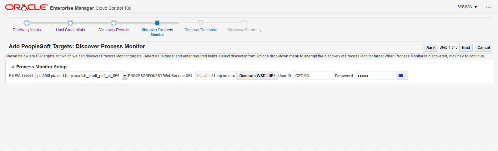

During the typical discovery process, you have the option to add and register PS Process Monitor targets. The Add PS Process Monitor page can be launched only if a PS PIA target has been discovered and selected.
Note: For discovering PS Process Monitor targets, the PeopleTools version for the PS PIA target must be at least PeopleTools 8.50.
During PS Process Monitor discovery, the EM Agent communicates with Integration Broker over HTTPS using the default SSL configuration setup.
The following process outlines the typical Process Monitor discovery workflow, which existed in previous releases, and is supported by default in the current release, as well.
Image: Discover Process Monitor
  1. Discover the PIA target.
  2. Use the PIA target in the All PeopleSoft Targets page, to discover the Process Monitor target.
  3. In the Process Monitor discovery page, enter the WSDL URL or click the Generate WSDL URL button to fetch the WSDL url.
  4. Discover the PS Process Monitor target.
