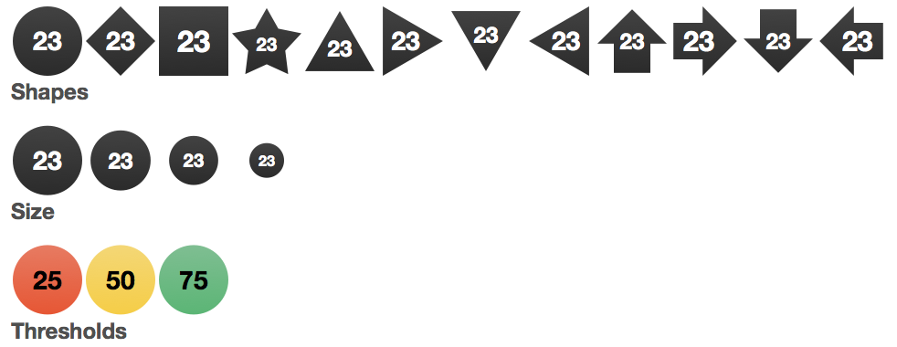

dvt:ledGauge ledGauge led gauge
UIComponent class: oracle.adf.view.faces.bi.component.gauge.UILedGauge
Component type: oracle.dss.adf.gauge.LedGauge
A gauge displaying a metric value using a shape and color.
<dvt:ledGauge value="23" minimum="0" maximum="100" type="circle"> <dvt:gaugeThreshold maximum="33"/> <dvt:gaugeThreshold maximum="67"/> <dvt:gaugeThreshold/> </dvt:ledGauge>
Animations can be enabled on data change or on initial display by adding af:transition as a child of this component. The following trigger types and transitions are supported:
dataChange: none (default), autodisplay: none (default), autoThe gauge metric label can be configured using dvt:gaugeMetricLabel. By default, the label color and size will be optimized to fit within the led shape.
Number formatting options are available through dvt:gaugeMetricLabel.
The size of the led shape within the allocated component space can be customized using the size attribute. This can be used to display an additional data dimension.
Thresholds can be added to the gauge using dvt:gaugeThreshold. The value of the last threshold is automatically specified to be the maximum value of the gauge.
Visual effects such as gradients and overlays can be disabled to achieve a flatter look using the visualEffects attribute.
Popups and context menus can be displayed using af:showPopupBehavior.
