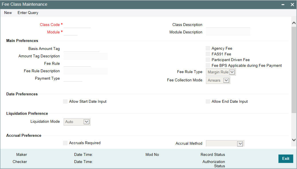

4.1 Defining a Fee Class
A class is a specific type of component that you can build with certain attributes. You can build a fee class, for instance, with the attributes of a specific type of fee, such as Loan processing fees, Amendment Fees.
When building a fee class, you define certain attributes such as:
You can define the attributes of a fee class in the ‘Fee Class Maintenance’ screen, You can invoke the ‘Fee Class Maintenance’ screen by typing ‘LFDFEECL’ in the field at the top right corner of the Application tool bar and clicking the adjoining arrow button.
Class Code
Before defining the attributes of a fee class, you should assign the class a unique identifier, called the Class Code and briefly describe the class. A description would help you easily identify the class.
Module
A fee class is built for use in a specific module. As a fee component would be applied on different basis amounts, in different modules.
Note
The Basis Amount Tags available would depend on the module for which you build the class.
Fee Type
The Rule Type identifies the type of component you are defining. The attributes applicable for a component depend on the Rule Type. Select the fee rule type as 'ICCF Rule' or 'Margin Rule'.
Fee Rule
If fee type is ‘ICCF Rule’, then you can get the fee rule details from 'ICCF Rule Maintenance' Screen. If type is ‘Margin Rule’ then you can get fee rule details from 'Fee Rule Maintenance' screen.
Allowing Rule Amendments
If you would like to allow the amendment of a rule for a fee component, indicate this by selecting the ‘Allow Rule Amendment’ option.
Consider as Discount
While defining a fee class for either the loans or the bills module, you can indicate whether the fee component is to be considered for discount accrual on a constant yield basis.
If you select this option the fee received for the component is used in the computation of the constant yield and subsequently amortized over the tenor of the associated contract.
Accrual Required
If you select this option, the fee received for the component is accrued based the constant yield and subsequently amortized over the tenor of the associated contract.
Propagation Required
Select this option to indicate that the fee collected from the borrower must be passed on to the participants of the contract.
Fee Mode
The fee mode can be any one of the following:

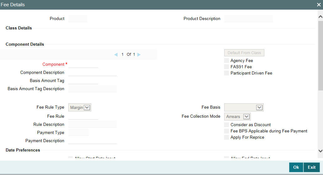

4.2 Defining fee components for a product
You can specify the fee components applicable to a product, in the fee Definition sub- screen of ‘Loans and Commitment Product Definition’ screen. Click ‘Fee’ from ‘Loans and Commitment Product Definition’ screen to invoke the ‘Fee Details’ sub-screen.
You should necessarily use a fee class to indicate the fee components applicable to a product. A fee class is a specific type of component that you can build with certain attributes.
4.2.1 Associating a fee with a product
To associate a fee class with a product, select the appropriate fee class from the list of classes defined specifically for the particular module of Oracle Lending. Click ‘Default From Class’ from the ‘Fee Details’ screen.
The attributes defined for the fee class are displayed. You have the option to change the attributes defined for the fee class to suit the requirement of the product you are creating.
4.2.2 Associating several fee classes with a product
You can associate several fee classes with a product. To add to the list of classes associated with the product click the ‘Add row’ button. Thereafter, select a class from the option list that is displayed and then click ‘Default From Class’.
To navigate between the fee classes associated with a product, you can use the icons provided for the same.
To disassociate a fee from the product, navigate to the class, and click the ‘Delete row’ button.
4.2.3 Stop Association
The fee component displayed in the Component field is not associated with the portfolios maintained under the product that you are defining.
Note
4.3 Specifying Fee details for a contract
From the Loan and Commitment - Contract Input (‘OLDTRONL’) screen, click ‘Fee’ to invoke the ’Fee Details’ sub-screen.
When the details of a contract are captured, the fee components defined for the product is automatically applied. However, while processing a contract, you can change certain attributes of the fee component.

4.3.2 Fee details
The fee components specified for the product to which you have linked the contract is displayed in tabular columns.
Component
The name given to the fee component is displayed here. The attributes defined for this component is displayed in the subsequent fields.
For a fee component the following details are displayed:
It is applicable for only Advance Fee type and for IRR computation.
Accrual Fee
In the Accrual Fee Class maintenance screen (LFDACFCL), you maintain accrual fee related details.
In the Product Definition screen, we can get these details and link it to the 'Accrual fee’.
The accrual fee will not be defaulted to the contract. You need to go to 'Amortization Fees' screen (LFDACFIN).
Note
If both the options ‘Consider as Discount’ and ‘Accrual Required’ are selected, the fee amount is considered for Internal Rate of Return calculation.
