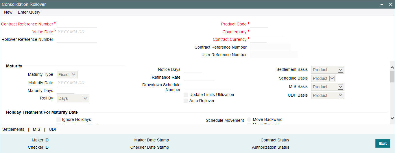

Instead of liquidating a loan on maturity date, you can renew it into a new contract. As part of rolling over a contract, the original contract should be liquidated and a new contract should be initiated. In Oracle Lending, these two processes are done in a single step.
To recall, when a loan is rolled-over (renewed), it is processed in the following manner, depending upon the rollover mechanism and rollover method specified:
The rollover method indicates:
The rollover method specified for the product used by the contract is defaulted, and you can change it when you enter the contract, if required.
If you have chosen the rollover method as “Normal”, then you must enter the corresponding details for the rollover, in the Rollover tab in the Loan and Commitment- Contract Input screen.
In the case of normal rollover, the system either creates a new draw down contract with a new contract reference number for the original one being rolled over (if the rollover mechanism specified is ‘New Contract’), or a new version of the original contract, with the same reference number (if the rollover mechanism specified is ‘New Version’).
You can rollover a loan in the ‘Loans and Commitment – Contract Input’ screen. In the ‘Loans and Commitment – Contract Input’ screen, click ‘Rollover’ from menu.
At the time of contract creation, you can maintain/change the rollover instructions. Click ‘Rollover’ tab to rollover a contract maintain/change the rollover instructions. You can specify the rollover instructions for the rolled over contract. After specifying the rollover details, you need to save the contract.
When you rollover the contract, the system completes the rollover process with the specified rollover instructions and a new version is created for the event ROLL.
To authorize the rolled over contract, both the versions created during rollover have to be authorized simultaneously.
By default, a contract is rolledover with all the terms of the original contract. However, you can change certain terms by specifying them in the Rollover Details screen while creating and modifying a contract.
The following are the features of the contract rollover screen:

If you have chosen the rollover method as “Consolidation”, then you must enter the corresponding details for the consolidation, in the Consolidation Rollover screen.
You can invoke ‘Consolidation Rollover’ screen by typing ‘OLDCOROL’ in the field at the top right corner of the Application tool bar and clicking on the adjoining arrow button.
In this screen, you must specify the reference number of the loan contract (commitment) which you want to consolidate with other loan contracts, as part of the rollover operation.
You can only consolidate loan contracts:
When you select the loan reference number, the product code for the loan is displayed. You can select the other loan contracts to be consolidated.
You must specify the following details for the consolidated rolled-over contract:
Maturity Details
You can indicate whether the consolidated contract has a fixed maturity date, or matures at call or notice. For contracts maturing at notice, you can indicate the applicable notice days.
For fixed maturity type contracts, you can specify the maturity date.
For fixed maturity type contracts, you can specify the number of days to be added to the value date to arrive at the maturity date.
Schedule Basis
You can indicate whether the repayment schedules for the consolidated contract must be defaulted from the loan product or from the driver contract.
The Mode of Rollover
You can indicate whether the rollover consolidation must be initiated automatically for the selected contracts. The mode of rollover also depends on whether the mode of liquidation of the loan is automatic or manual. This preference can be set just as you would do for a normal rollover, as explained in previous sections.
Updating Credit Limit Utilization
You can indicate whether the credit limit utilization is to be updated, when the consolidation operation is performed. That is, the interest that has been accrued on a loan is also considered, as a part of the utilized amount for the purpose of risk tracking.
Note
This option applies only if you want to rollover a loan with interest.
Settlement Basis
You can indicate whether settlement details for the consolidated contract must be defaulted from the loan product, or the driver contract
MIS Basis
You can indicate whether MIS details for the consolidated contract must be defaulted from the loan product, or the driver contract,
UDF Basis
You can indicate whether user-defined fields for the consolidated contract must be defaulted from the loan product, or the driver contract.
Refinance Rate
You must indicate the refinance rate for the consolidated contract.
Holiday Treatment
You can indicate whether the system must check for maturity dates of the consolidated contract falling on holidays.
If the holiday check is indicated, you can also specify whether maturity dates falling on holidays must be moved forward to the next working day, or backward to the previous working day. You can also indicate whether the moved maturity date is allowed to cross over months.
Interest Components for the Consolidated Contract
You can define the interest components to be applicable for the consolidated contract.
The interest rate can be defaulted from either the loan product, or the driver contract, or a special rate can be entered. If a special rate is to be entered, you can specify the required rate in the Rate field.
Consolidation Preferences for Driver Contracts
As part of the preferences for the consolidation contract, you can identify contracts from which information such as settlement details, schedules, MIS details and so on, can be defaulted. These contracts are called driver contracts. You can select the contracts to be used as driver contracts, in the Participant Ref No field.
You must specify the following details for the driver contracts:
