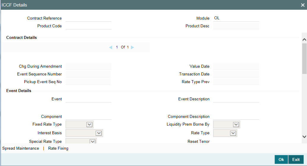

Through the Value Dated Amendment function, you can make changes to the maturity date, the principal and specify a new value date for the loan.
However, if you want to change the interest rate, the rate code, the
spread or the interest amount, you have to invoke the Contract ‘ICCF
Details ‘screen of the ICCF module through the ‘Loan and
Commitment Value Dated Amendments’ screen. Click the’Interest’ to invoke this screen.
You can make Value Dated Amendments only to the following components in the Contract ICCF screen.
Interest Rate

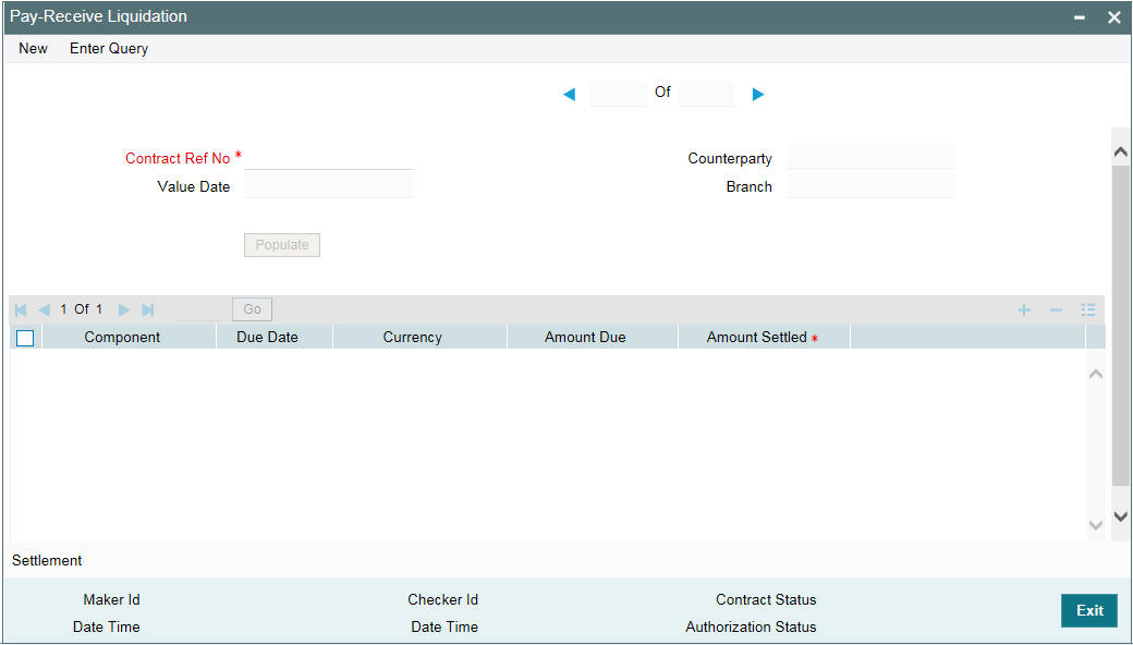

You can track and liquidate the differences in the settled amount using ‘Pay – Receive Liquidation’ screen.
You can invoke the ‘Pay - Receive Liquidation’ screen by typing ‘OLDPRLIQ’ in the field at the top right corner of the Application tool bar and clicking the adjoining arrow button.
Note
In case of any Pro Rata VAMI beyond any Payment, it may result in the change in the settlement amount for the settled schedules. These differences in the settled schedules (both positive and negative) you can track under the payable and receivables and can settle the differences to the Pay-Receive Liquidation option.
Contract Reference Number
Specify the contract reference number whose list of components you want to display in this screen.
The following fields are displayed
Value Date
Specify the value date of the payment for the selected component. The value date of the payment can be either backdated or current dated.
Amount Settled
Specify the amount to be liquidated for the selected component.
