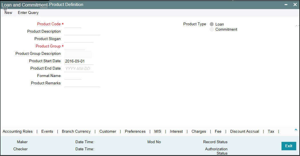

2.2 Creating a Product
In the Product Definition screen of every module, you can enter basic information about a product such as the Product Code, the Description, and so on. The Product Definition screens of the various modules of Oracle Lending are invoked from the Application Browser.
You can invoke the ‘Loans and Commitment Product Definition’ screen by typing ‘OLDPRMNT’ in the field at the top right corner of the Application tool bar and clicking the adjoining arrow button.
Note
Product Definition screen is specific to a module. To create an LD product, for an instance, invoke the ‘Loans and Commitment Product Definition’ screen from the Application Brows­er. Similarly, to create an LS product, invoke the LS Product Definition screen from the Ap­plication Browser.
In a Product Definition screen, you should specify the following details for the products you create:
2.2.1 Identifying a Product with a Code and Description
A ‘Product Code’ identifies a product throughout Oracle Lending. This code should be four characters in length.
When defining a new product, you should enter a code that is unique across the different modules of Oracle Lending. For instance, if you have used LC01 for a product in the Loans and Commitment module, you cannot use it as a product code in any other module.
It may be difficult to recognize a product just by its code. In the ‘Description’ field, therefore, suitably describe the product code so that it can be easily identified. This description is displayed along with the code throughout Oracle Lending.
2.2.2 Specifying the Product Type
Product categories are referred to as ‘Product Types.’ When you create a product, you must specify the type to which it belongs. For an instance, you should specify the product type as ‘Loan’ if you are defining a lending product and ‘Commitment’ if you are defining a Funds Transfer product.
2.2.3 Specifying the Product Group
Products can be categorized into groups based on the common elements that they share. You must associate a product with a group. This would facilitate retrieval of information of a class of products at one stroke.
Product Groups are maintained in the ‘Product Group Maintenance’ screen, You can invoke the ‘Product Group Maintenance’ screen by typing ‘OLDPRGRT’ in the field at the top right corner of the Application tool bar and clicking the adjoining arrow button.
2.2.4 Assigning a Slogan to a Product
You can enter a marketing slogan line for every product you create. This slogan is printed on all advices that are sent to customers who avail of the product.
For example, if you set up a Loans product , you can enter the slogan ‘Loans On Demand.’
2.2.5 Defining the Life Span of a Product
A product can be defined to be active over a specific period. When you create a product, you can specify a ‘Product Start Date’ and ‘Product End Date’ for it. The product can only be used within the specified period.That is, within the ‘Product Start Date’ and ‘Product End Date’.
If you do not specify the ‘Product Start Date’, the branch date is displayed as the ‘Product Start Date’.
If you do not specify an ‘Product End Date’ for a product, it can be used for an indefinite period.
2.2.6 Adding your Remarks
When creating a product, you can enter information about the product intended for your bank’s internal reference. This information is not to be printed on any correspondence with the customer.
2.2.7 Defining the Other Attributes of a Product
Once you have specified the basic details of a product, you can define the other attributes for it. From the ‘Loans and Commitment Product Definition’ main screen, you can move to the screen of your choice to define an attribute by clicking on the appropriate icon.
The other product attributes that you can define include:

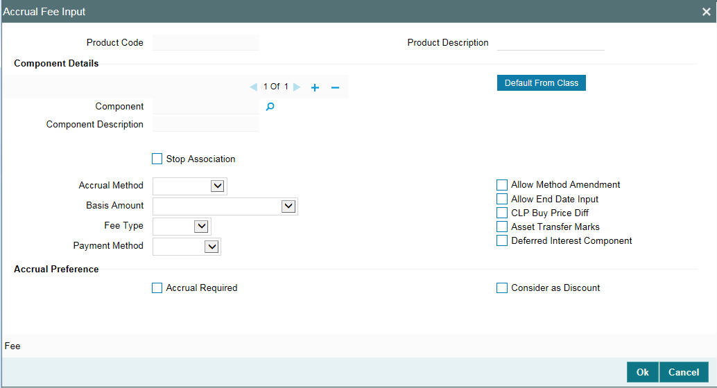

Discount accrual, Accrual fee details, Diary events for a product. The product attributes that you can define depends on the module in which you are creating the product. For instance, the attributes that you define for a product in the Oracle Lending (OL) module vary significantly from the product attributes that you define in the Funds Transfer module. For products you create in theOL module, you can define , interest, clause, and document details, whereas, these attributes cannot apply to products you create in the Funds Transfer module.
Note
There are some fields in the product definition screens in which a value must be entered. If you try to save a product without entering details in these fields, the product is not saved. You are prompted to enter all mandatory details before attempting to save the product.

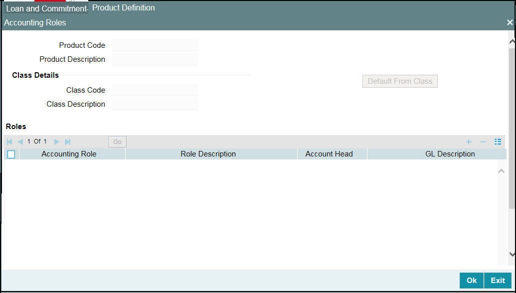

2.7.1 Identifying the Accounting Roles and Heads for a Product
Before you define the accounting details for a product, you should define the various components of the contracts involving the product such as interest, charges, tax, and so on.
In the ‘Accounting Roles’ screen, a list of accounting roles are automatically generated based on the components you define for the product. You should map all the accounting roles that are available with the appropriate accounting heads.
You can invoke the ‘Accounting Roles’ screen by clicking Accounting Roles in the ‘Loans and Commitment Product Definition’ screen.
Adopting either of the following procedures, you can specify the accounting roles and heads for a product:
Using a Class
Click Default From Class’ in the ‘Accounting Roles’ screen to associate the product you are maintaining with a class of mapped roles and heads. A list of the classes that you have defined specifically for the module is displayed. Choose a class with the requisite accounting heads and roles mapped.
The procedure for setting up an Accounting Roles to Head Mapping classes is similar to mapping accounting roles and accounting heads specifically for a product.
Mapping Accounting Roles to Heads specifically for a product
If you do not use a class to define accounting role and heads for a product, in this screen, you can define them specifically for the product you are creating.
  1. In the ‘Accounting Role’ column, click and then click to select an Accounting Role from the drop-down list .
  2. In the ‘Account Head’ column, clickand select an accounting head from the drop-down list that is displayed.
  3. Click ‘Ok’ to map the role with the corresponding head in the Accounting Head column.
Note
If you would like to delete a role to head mapping, click the button.

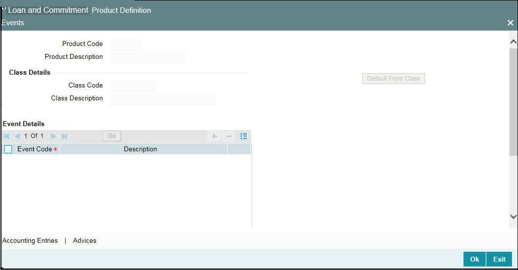

2.7.2 Specifying Events and Accounting Entries
A contract goes through different stages in its life cycle. In Oracle Lending, the different stages a contract passes through in its life cycle are referred to as “events”.
At an event, typically, if you want to post the accounting entries to the appropriate account heads and generate the required advices. When setting up a product, you can define the accounting entries that have to be posted and the advices that have to be generated at the various events in the life cycle of contracts involving the product. To do this, click ‘Events’ in the ‘Loans and Commitment Product Definition’ screen.
The ‘Events’ screen is displayed.
You can define the accounting entries and advices for events using either of the following methods:

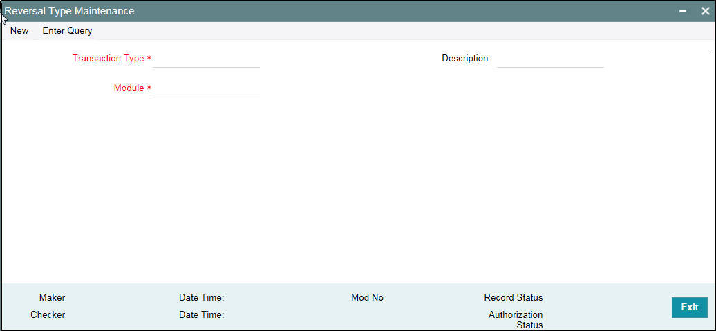

2.7.2.1 Defining transaction types for reversal
You can invoke the ‘Reversal Type Maintenance’ screen by typing ‘OLDREVTP‘ in the field at the top right corner of the Application tool bar and clicking the adjoining arrow button.
In this screen to capture the list of allowed transaction types for the product in case of a reversal.
After you invoke this screen, you can associate new transaction codes for each transaction type. During reversal of events, the system replaces the old transaction codes with the corresponding (new) transaction codes. In case no new transaction codes are associated for the old transaction code, the entries are passed with the old transaction code.
2.7.2.2 Using a class
Click ‘Default From Class’ in this screen to associate the product you are maintaining with an Events class. A list of the Events classes that you have defined specifically for the module is displayed. Choose a class with the requisite events and accounting details maintained. The product acquires the accounting entries and advices defined for the Events class you choose.
The procedure for setting up an Events class is similar to defining events and accounting details for a product.

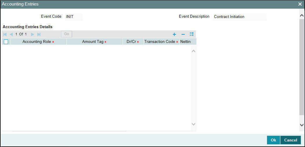

2.7.2.3 Defining Events and Accounting Details specifically for a Product
If you do not use an events class, you should define event details specifically for the product.
Click ‘Add row’ to invoke a list of events pertaining to the module. Select an event from the list by double-clicking on it.
For every event you select, you should specify the accounting entries that should be passed and the advices that should be generated.
Click ‘Accounting Entries’ in the ‘Events’ screen to specify the accounting applicable to the event.
For an each event, you have to maintain the following accounting entries information.
Specifying the Accounting Role
Specify the accounting role that should be used at the event. The drop-down list displays all the accounting roles specified for the product in the Accounting Role Definition screen.
Specifying the Amount Tag
Specify the tag, which identifies the component that has to be posted to the account head.
Indicating a debit or credit
Indicate whether the accounting role you specified is for the debit or credit leg of the contract event.
Indicating the Transaction Code
Every accounting entry in Oracle Lending is associated with a Transaction Code that describes the nature of the entry. Specify the transaction code that should be used to post the accounting entry to the account head.
Indicating if accounting entries can be netted
Specify whether accounting entries should be netted at an event. You can net the accounting entries that are generated at an event if the set of entries satisfy the following criteria:
If you want a particular leg of an accounting entry to be considered for netting (subject to the above criteria), select ‘Yes’ from the drop-down list in the Netting field against this leg.
You should define details for both the legs of an accounting entry. For each accounting entry, you should specify the details of the debit and the credit leg. Thus, the first two specifications are for one entry, the next two for another, and so on. The Transaction Code for the entry should be specified for both legs of the entries.
This netting of accounting entries is only for processing and not for message generation.
Netting outgoing payment instructions
You can net multiple entries posted into the same account for processing. Independent of this, you can net entries posted into the same account with a view to sending out netted payment instruction messages.
If you want a particular leg of an accounting entry to be considered for netting for messaging purpose, select ‘Yes’ from the drop-down list in the Msg Netting field against this leg.
For sending out payment instructions, the system identifies the netted amount based on entries in the Msg Netting field, and not based on entries in the Netting field. Therefore, you can specify an accounting entry to be considered for Msg Netting and not for Netting.
The validation criteria mentioned for the Netting field is same for the Msg Netting field also.

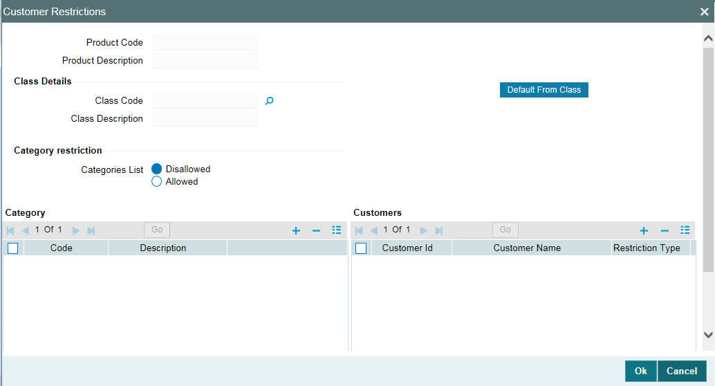

2.8 Specifying Branch, Currency, and Customer Restric­tions
From the head office of your bank, you may want to establish certain controls or standardize operations across the branches of your bank. For instance, you may want to restrict the products you offer to select branches and currencies, or allow specific branches to offer products only to a specific set of customers. You can achieve these controls by maintaining restriction lists when creating a product. When you create a product, you can specify the branches of your bank that can offer it, the currencies that are allowed or disallowed for it, and the customers who can avail it.
Note
When you create a product, it is, by default, available to all the branches of your bank, in all currencies, and for all customers.

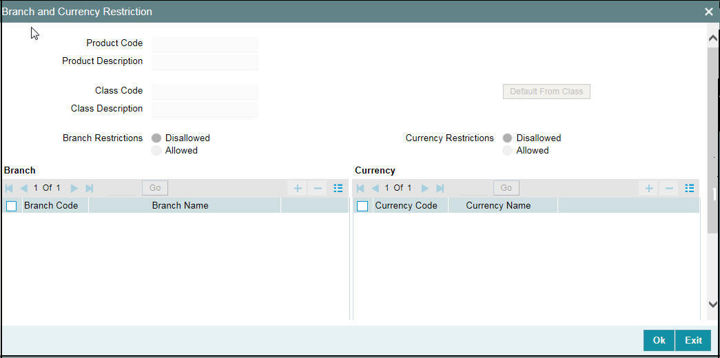

2.8.1 Maintaining a List of Branch and Currency Restrictions
To maintain a list of allowed/disallowed branches and currencies, click ‘Branch Currency’ in the ‘Loans and Commitment Product Definition’ screen. The Product Branch and Currency screen is displayed.
When defining a product, you can choose to specify Branch and Currency, and Customer Restrictions either by:
2.8.1.1 Using a Branch and Currency Restrictions Class
In Oracle Lending, you can define a set of branch and currency restrictions as a Branch and Currency Restrictions Class. You can maintain several restriction classes of branches and currencies.
When creating a product, you can associate it with a branch and currency restrictions class that best suits your requirement.
The manner of creating a branch and currency restrictions class is similar to defining Branch and Currency Restrictions specifically for a product.
If you want to associate a branch and currency restrictions class to a product, click ‘Default From Class’ in the ‘Branch and Currency Restriction’ screen. The product acquires the restrictions defined for the class.
2.8.1.2 Defining Branch and Currency Restrictions specifically for a product
If you do not use a class to indicate branch and currency restrictions, you should define these restrictions specifically for the product in the Product ‘Branch and Currency Restriction’ screen.
You can specify branch and currency restrictions in the form of allowed lists or disallowed lists.
If you create ‘Allowed’ lists of branches and currencies, the product can only be offered in those branches and currencies that are part of the respective allowed lists. On the other hand, if you maintain ‘Disallowed’ lists, the product cannot be offered by the branches and currencies on the respective disallowed lists.
You can indicate whether you are maintaining an allowed or a disallowed list type by choosing the appropriate option.
Example
You have a network of twenty branches. You want to exclude six branches from dealing in loans You want all other branches to deal in loans.
Since there are more branches that can offer the facility than those that cannot, you can choose to maintain a disallowed list, and include the six disallowed branches in it.
Moving a branch or currency to the Allowed/Disallowed column
Under Branch and Currency Restrictions respectively, two columns are displayed.
The allowed or disallowed column that is displayed would depend on the list type that you choose to maintain. For instance, if you choose to maintain an allowed list of branches, the column would display the branches that you opt to allow.
In the Available columns, the branch and currency codes of all the branches and currencies maintained at your bank is displayed. Using the arrow keys, you can move a branch or currency to the corresponding allowed/disallowed column that you have maintained.
Confirming your specifications
After you maintain branch and currency restrictions for a product, click ‘Ok’ to confirm your specifications. Click ‘Exit’ to delete your specifications.
2.8.2 Restricting Customers

You can maintain customer restrictions for a product in the Product Customer and Category Restrictions screen. To invoke this screen, click ‘Customer’ in the ‘Loans and Commitment Product Definition’ screen.
Using a Customers and Categories Restrictions Class
In Oracle Lending, you can define a set of customer restrictions as a Customer Restrictions Class. You can maintain several restrictions classes of customer categories.
When creating a product, you can associate it with a customer restrictions class that best suits your requirement. The procedure for creating a customer restrictions class is similar to setting up customer restrictions for a product, as explained below.
If you want to associate a customer restrictions class to a product, click ‘Default From Class’ in the ‘Customer Restrictions’ screen. The product acquires the restrictions defined for the class.
2.8.2.1 Defining Customer Restrictions specifically for a product
If you do not use a class to indicate customer restrictions, you should define these restrictions specifically for the product in the ‘Customer Restrictions’ screen.
Choosing Category Restriction
Under ‘Category restriction’, the following options are displayed:
The ‘Allowed’ or ’Disallowed’ depends on the list type that you choose to maintain. For instance, if you choose to maintain an allowed list, the column would display those customer categories that you choose to allow.
Specifying the Customer Category
You can restrict customers from availing a product by maintaining an ‘Allowed’ list or a ‘Disallowed’ list of customer categories.
Only customer categories that are a part of an allowed list maintained for a product can avail the product. Likewise, customer categories that are part of a disallowed list cannot avail the product or service.
Exempting specific customers
You can exempt customers, belonging to a particular allowed/disallowed category, from the allowed or disallowed list that you are maintaining for a product.
Example
You have maintained Financial Institutions as a customer category, and you do not want Financial Institutions to avail a service that you offer.
You can maintain a disallowed list in the Customers and Categories Restrictions screen, and include Financial Institutions in the list.
However, you want Cavillieri and Barrett Inc., a financial institution, to avail the product you are creating.
When you include Financial Institutions in your disallowed list, all customers belonging to this category is displayed in the Customer Access column. Move to Cavillieri and Barrett on the list, and specify the Restriction Type as allowed.

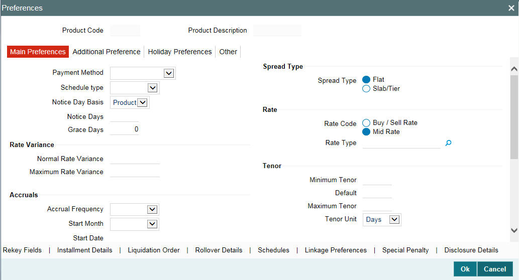

2.9 Specifying Product Preferences
‘Preferences’ are options that you can choose to give shape to a product. You can specify your preferences for the products you create in the Product Preferences screens of the respective modules. Click ‘Preferences’ in the ‘Loans and Commitment Product Definition’ screen to invoke the Product Preferences screen.
Note

2.13 Status control of a product
When setting up a product, you should identify all possible status that contracts involving the product would move into. You should also indicate the sequence of status changes for contracts.
For more information about status control of a product, refer to Bilateral Loans User Manual.
2.14 Specifying accrual fee details of a product
After defining a fee component, you need to link the fee component to a product in Oracle Lending. Click ‘Accrual Fee Details’ in the ‘Loans and Commitment Product Definition’ screen.
Click ‘Add Rows’to add fee components. Click ‘Default From Class’ to associate the required fee component with the product. System defaults the parameters of the selected fee component. However, you can change the parameters according to your requirements.
You need to specify the following details:
Accrual Method
Specify the accrual method from the adjoining drop-down list. This list displays the following values:
Basis Amount
Select the basis amount on which the fee component should be calculated from the adjoining drop-down list. This list displays the following values:
Fee Type
Specify the fee type from the adjoining drop-down list. This list displays the following values:
Payment Method
Allow Method Amendment
Select this box to indicate that the amendment method is allowed for the accrual fee component.
Allow End Date input
Select this box to indicate that the fee component (if applicable for the product involved in the contract) will cease to be associated with a contract on the contract ‘End Date.
CLP Buy Price Diff
Select this box to indicate that the difference between the PAR price (100%) and actual buy price is booked as fee against that component.

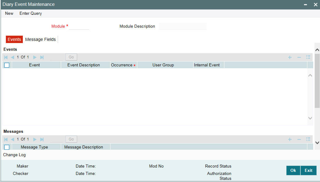

2.15 Associating diary events of a product
In the ‘Diary Event Maintenance’ screen, you can also specify the different diary events that would need to be processed for loan contracts using a product.
You can invoke the ‘Diary Event Maintenance’ screen by typing ‘OLDDIAEV’ in the field at the top right corner of the Application tool bar and clicking the adjoining arrow button.
In this screen, select the ‘Event’ of the diary event that you want to associate with the product, in the ‘Event Code’ field.
