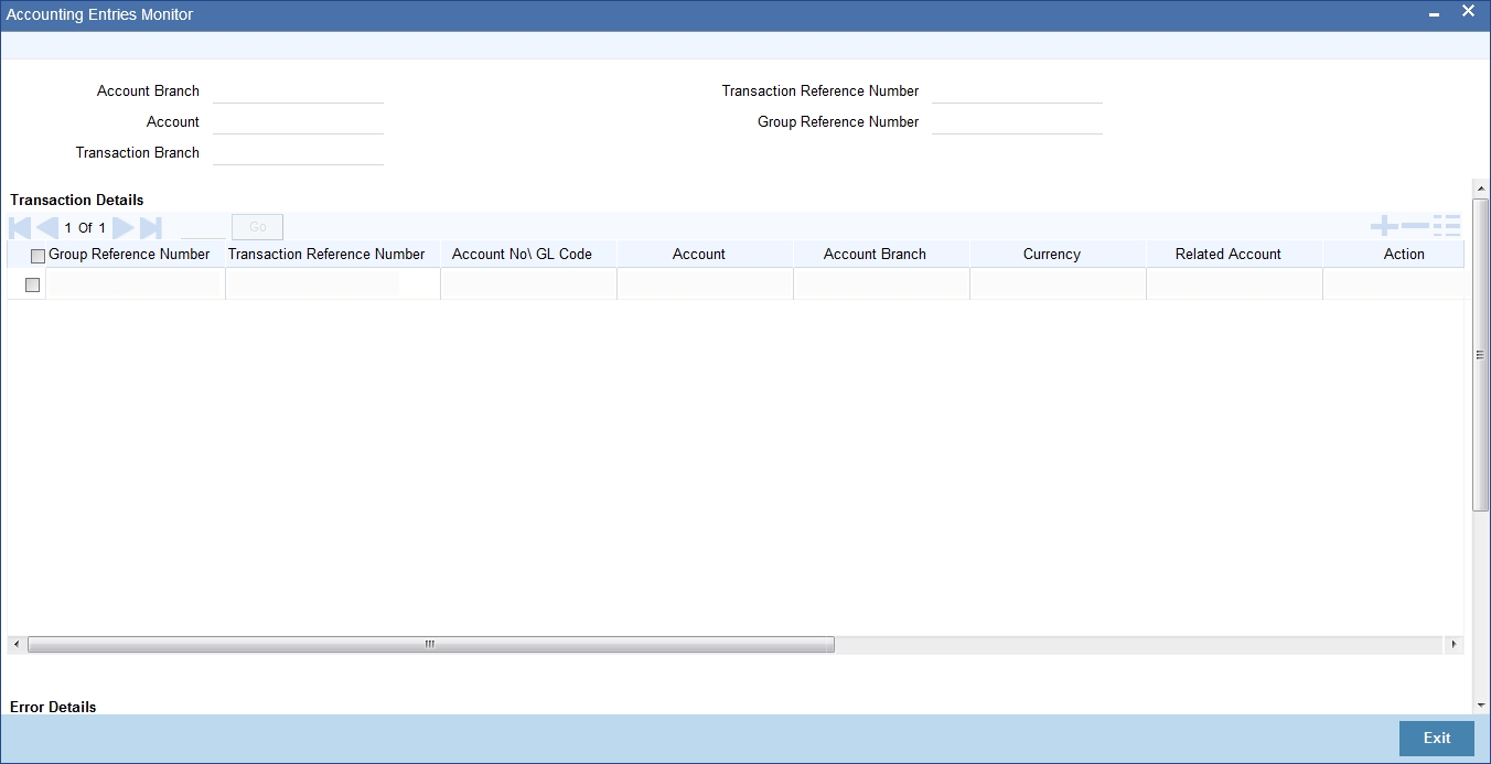

7.2 Accounting Entry Monitor
7.2.1 Re-submitting Failed Jobs
The failed posting due to some reason) entries can be retried/re-submitted after manual corrections using the 'Accounting Entry Monitor' screen. Re-submitted entries get picked up by the same Asynchronous/Intraday Job and are processed. "Process Online" posts the entries in synchronous mode.
The query criteria should be Group Reference Number, Transaction Reference Number, Account Number, Account Branch.
You can invoke the ‘Accounting Entry Monitor’ screen by typing ‘ACDENTRY’ in the field at the top right corner of the Application tool bar and clicking the adjoining arrow button.
You can specify the following query criteria in this screen:
Enter any or all of the above query criteria and click ”Execute Query”. The following details of matching records will be displayed:
Note
If the accounting entry process fails due to Insufficient IB maintenance, for example, then the same will be listed in ACDENTRY screen and you can make the required corrections and can Re-submit / Process Online. The retry count in the screen is updated based on the no. of times the process gets submitted for hand-off processing.

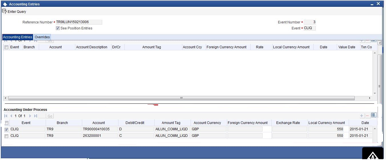

Once the accounting is processed, then accounting under Process is cleared and moved to accounting entries block of CSDACENT screen.
You can view the accounting entries maintained for an event in the ‘Accounting Entries’ screen by selecting an event and clicking on ‘Accounting Entries’ button in the’ Events’ screen.
Till the time accounting is in Unprocessed state, accounting entries under process can be viewed in ‘Accounting Under process’ block under ‘CSDACENT’ subsystem (Events -> Accounting Entries subsystem). This block is common for all screens which has the Accounting Entries (CSDACENT) subsystem.
To invoke the screen type ‘CSDACENT’ in the field at the top right corner of the Application tool bar and clicking on the adjoining arrow button.
