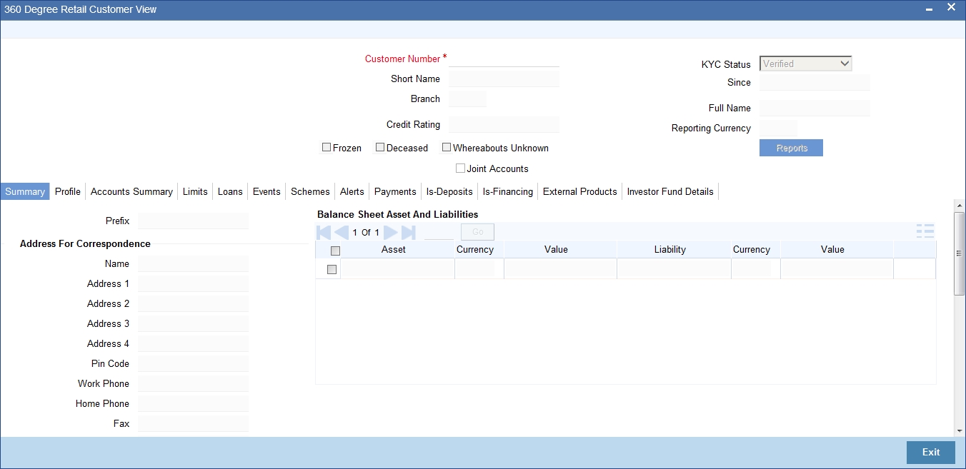

9.1.2 Viewing 360 Degree Retail Customer Details
You can invoke ‘360 Degree Retail Customer View’ screen if the customer is Retail by double clicking on the customer record in the ‘360Degree Customer View Entry Point’ screen or by typing ‘STDRETVW’ in the field at the top right corner of the Application tool bar and clicking on the adjoining arrow button.
The system displays the following details:

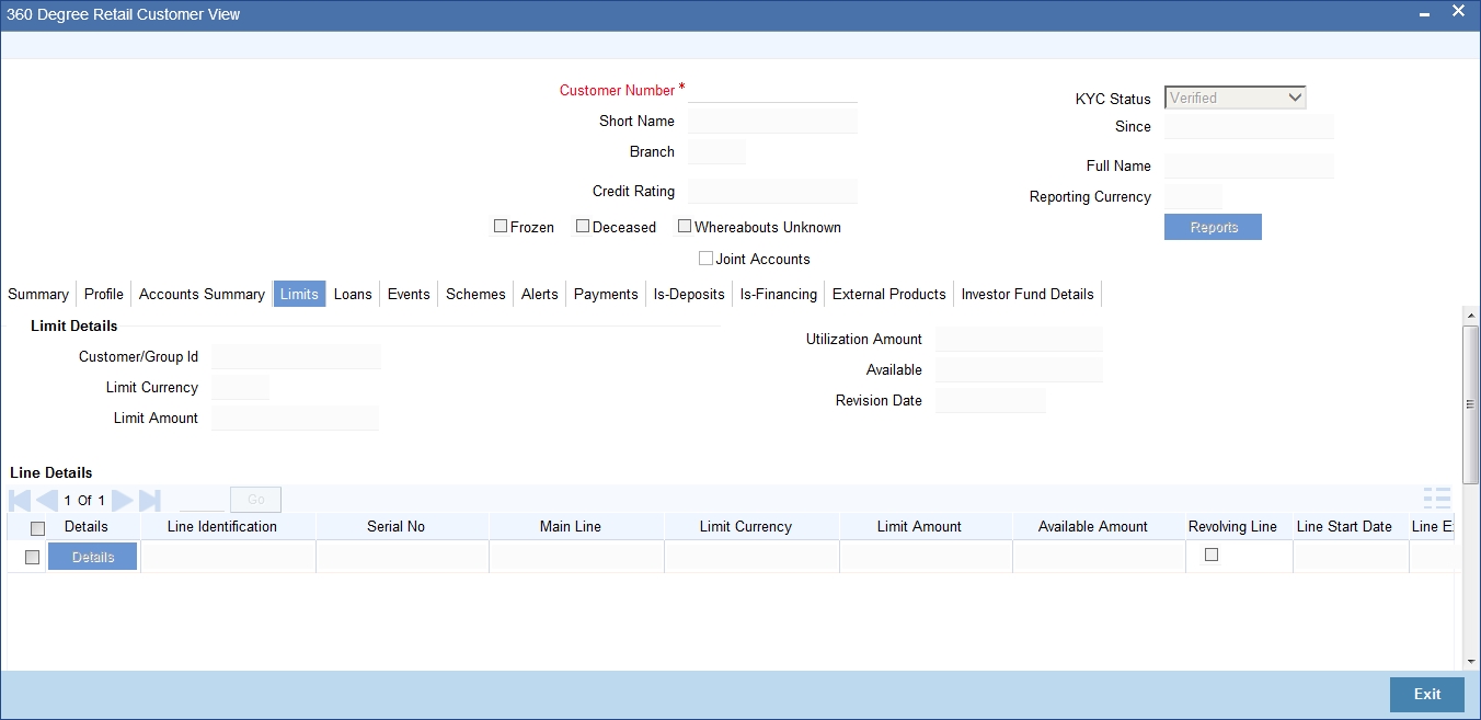

Limits
You can view the limits and collaterals of the customer.

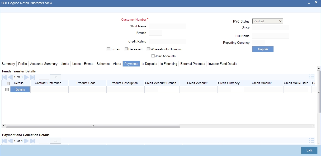

Payments
You can view the FT and PC contracts of the customer which is not liquidated.

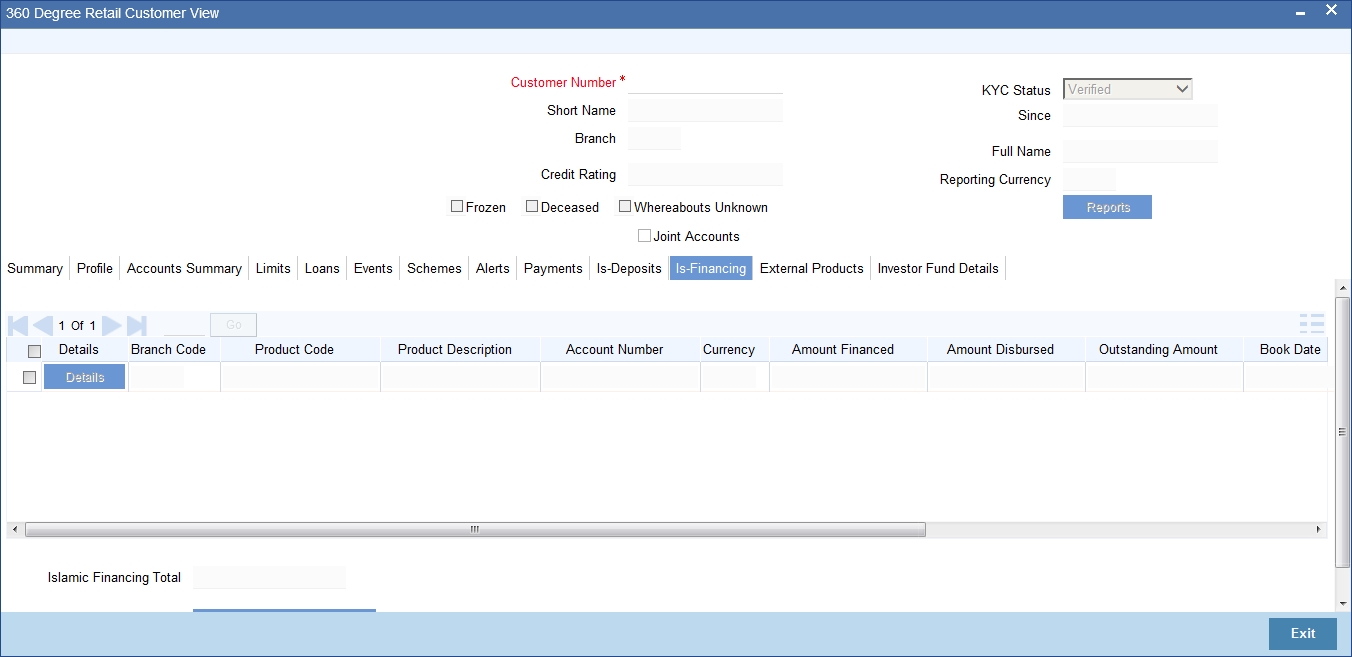

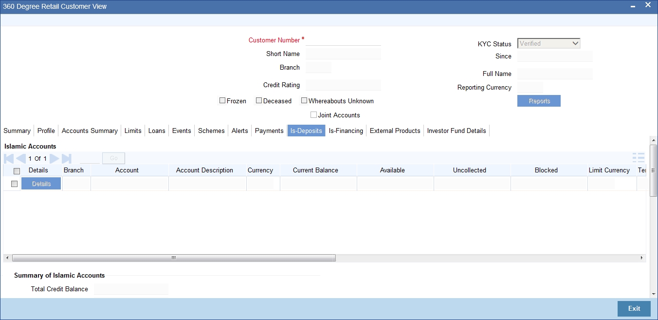

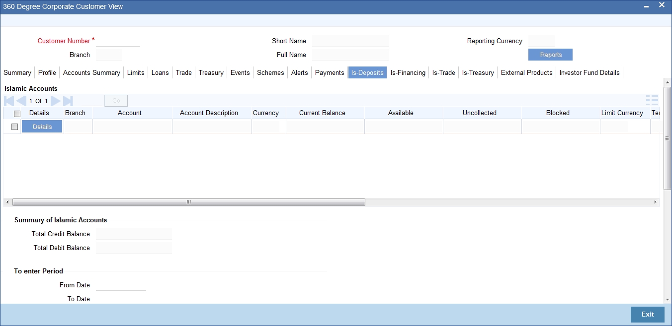

Is-Deposits
You can view details about active CASA account and Term Deposit.
Is-Financing
You can view details about Islamic Account and Islamic Term Deposit..

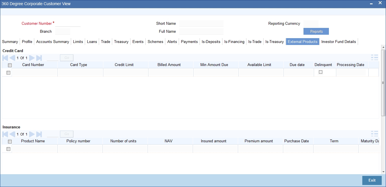

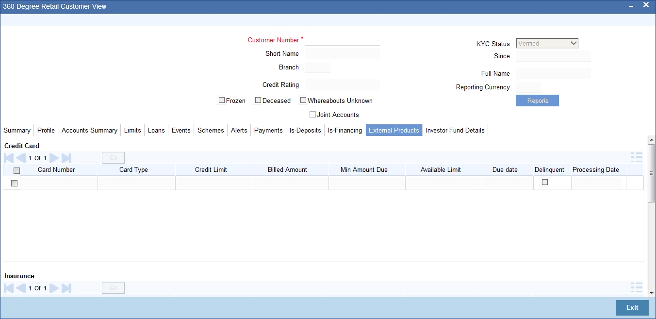

External Products
You can view external details about products like credit cards, insurance, and mutual fund.

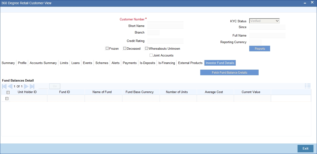

Investor Fund Details
You can view the mutual fund details in this screen.
9.1.4 Summary Tab
You can view the address, status. Balance sheet asset and liabilities and off balance sheet asset and liabilities under the summary tab. The following details are displayed here:
Address For Correspondence
Here you can view the following details:
Status
Balance Sheet Asset and Liabilities
Off Balance Sheet Asset and Liabilities

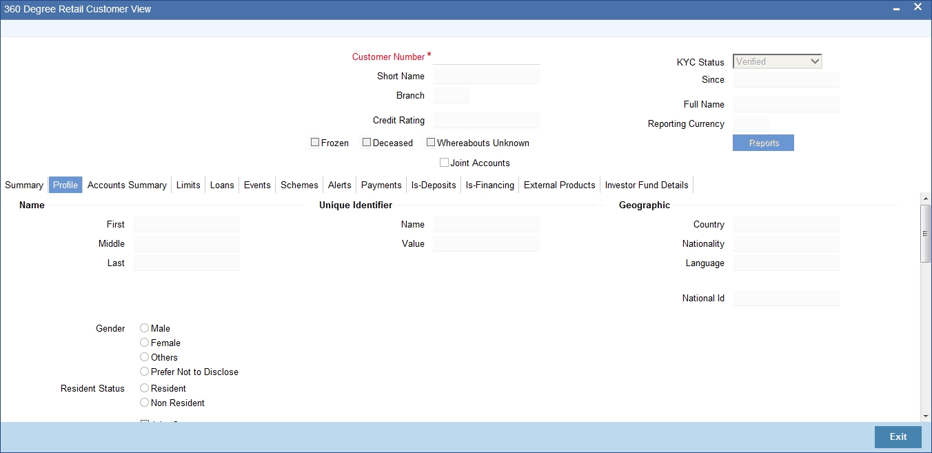

9.1.5 Profile Tab
Click ‘Profile’ tab in the ‘360 Degree Retail Customer View’ screen to view the details of the customer’s profile.

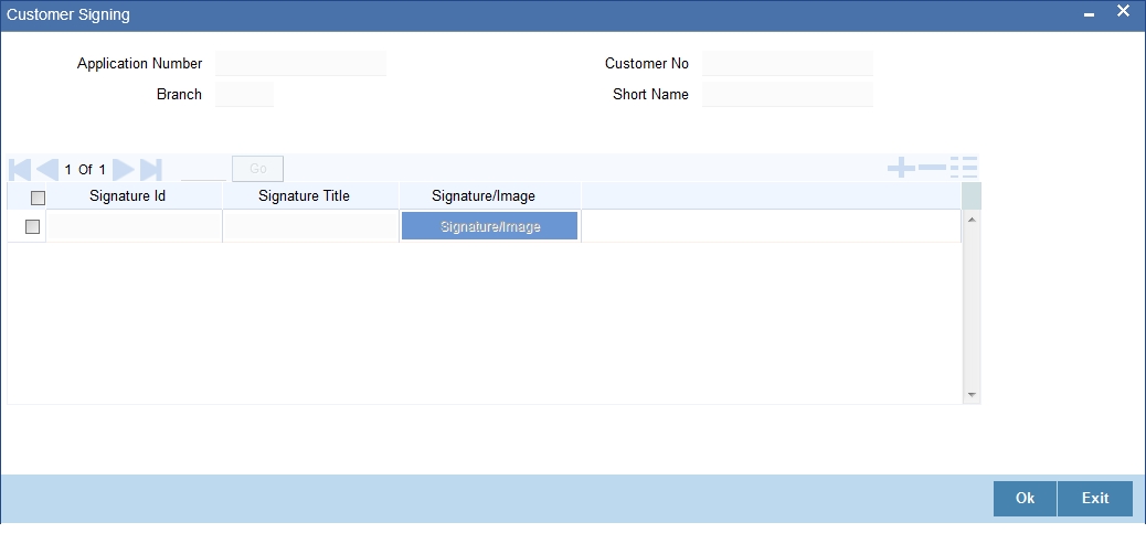

9.1.5.1 Image Button

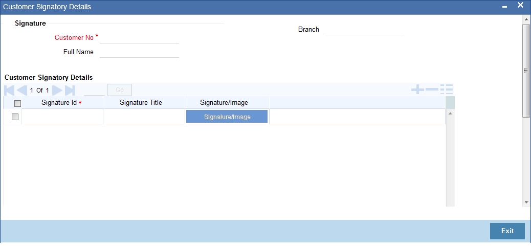

Click on the ‘Image’ button to invoke ‘Customer Signatory Details’ screen. Here you can view the signature image and photograph of the customer.

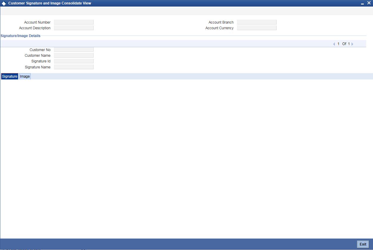

Click ‘All Signatures/Images’ button to view ‘Customer Signature/Image Consolidated View’ screen.
The ‘Signature/Image’ tab displays nine signatures/Images for a signature id in a single pane with three signatures/Images in a row.
If there is more than one signature id linked to a customer account, then they would be displayed in different pages.
Each image is provided with the following buttons:

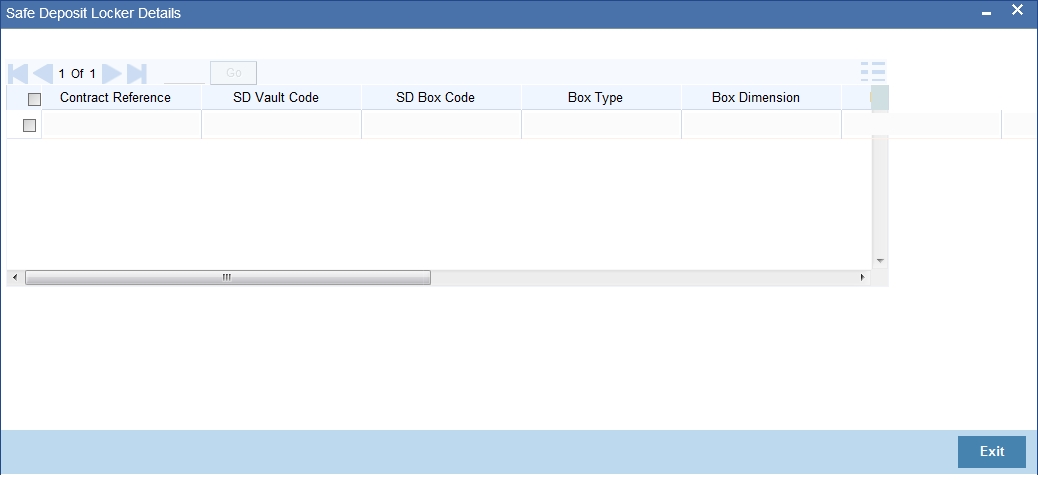

9.1.5.3 Locker Details Button
Click on the ‘Locker Details’ button to invoke ‘Safe Deposit Locker Details’ screen. Here you can view the locker details of the customer.
The screen is as shown below:
Here, you can view the following details:

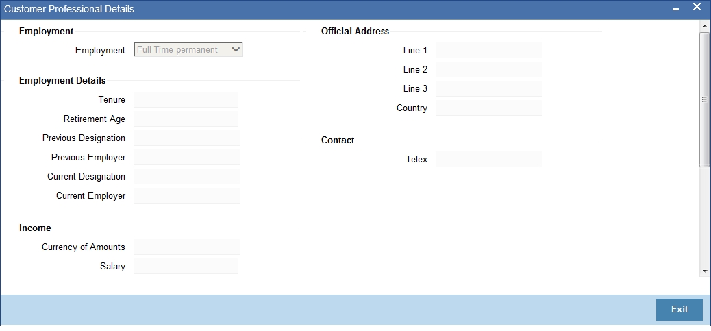

Click on the ‘Professional’ button to invoke ‘Customer Professional Details’ screen. Here you can view the professional details of the customer.

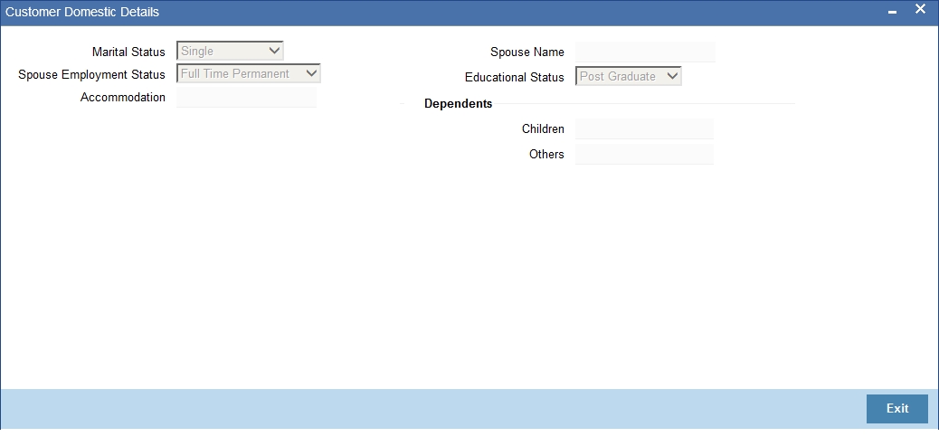

9.1.5.5 Domestic Button
Click on the ‘Domestic’ button to invoke ‘Customer Domestic Details’ screen. Here you can view the domestic details of the customer.

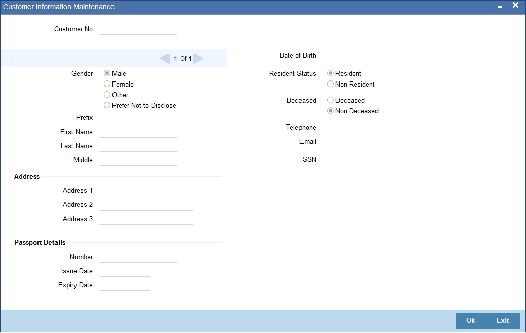

9.1.5.6 Joint Button
Click on the ‘Joint’ button to invoke ‘Customer Information Maintenance’ screen. Here you can view information about the customer.

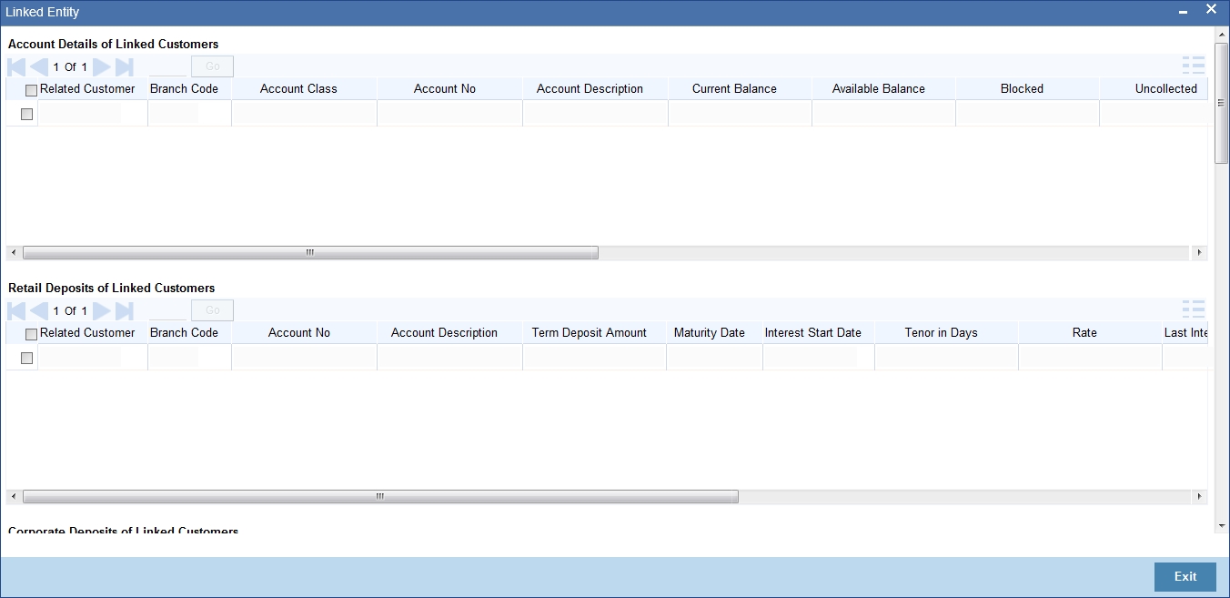

9.1.5.7 Linked Entity Button
Click on the ‘Linked Entity’ button to invoke ‘Linked Entity’ screen. Here you can view details about customers who are linked to this customer, accounts for which this customer is linked,reverese relationship of the queried customer and loans which are guaranteed by this customer.
CASA Details of Linked Customers
Retail Deposits of linked Customers
Corporate Deposits of Linked Customers
Loan Details of linked Customers

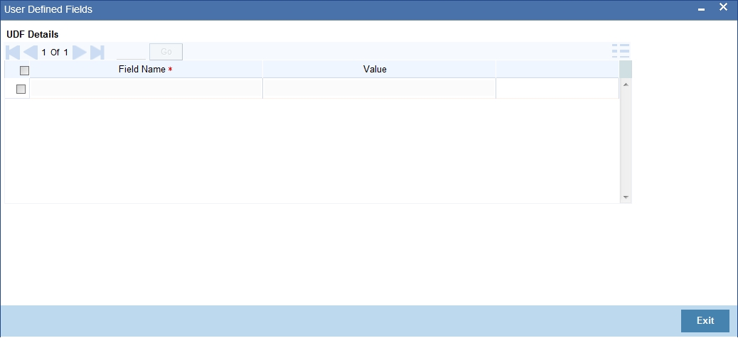

9.1.5.9 Fields Button
Click on the ‘Fields’ button to invoke ‘User Defined Fields’ screen. Here you can view the UDF details of the customer.

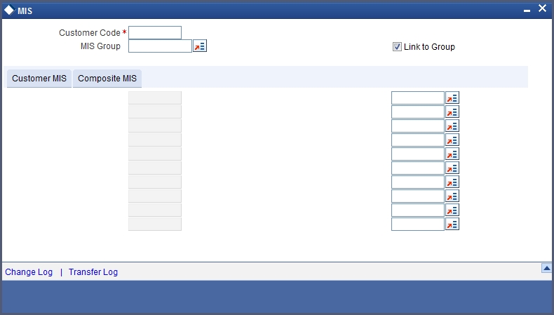

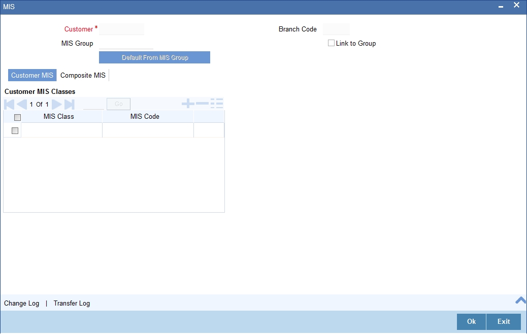

9.1.5.10 MIS Button
Click on the ‘MIS’ button to invoke ‘MIS’ screen. Here you can view the MIS details of the customer.

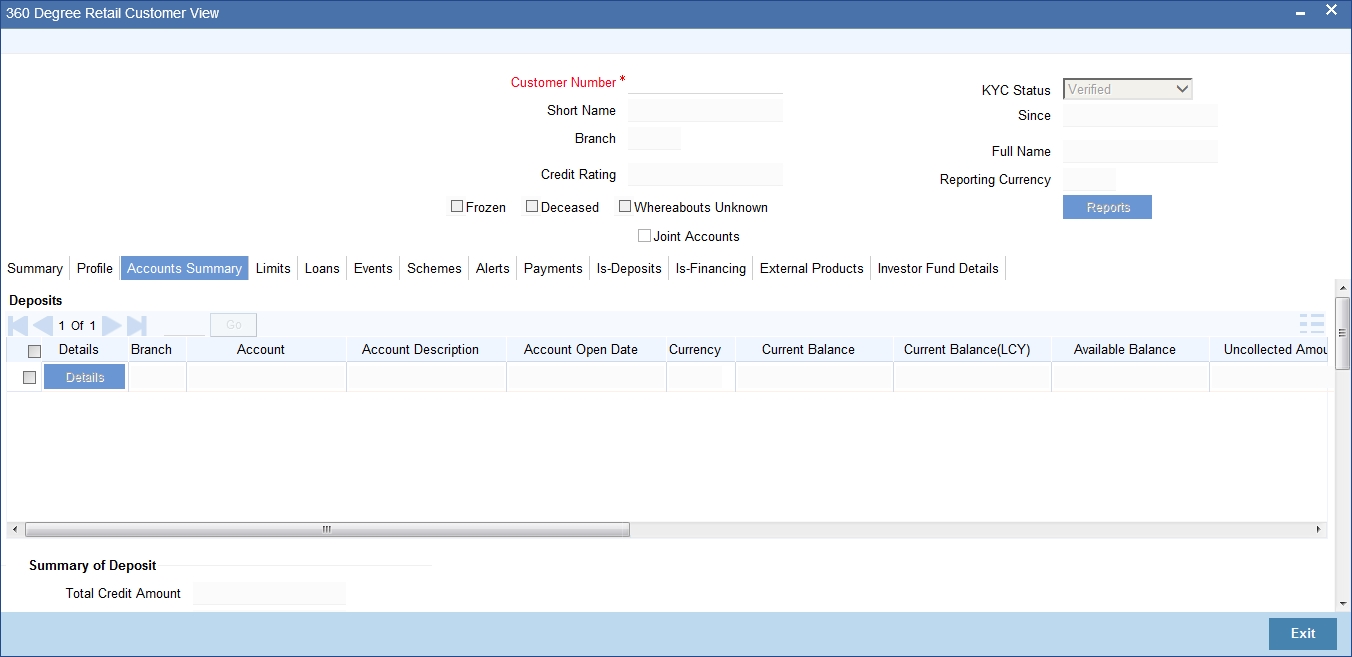

9.1.6 Accounts Summary Button
Click ‘Accounts Summary’ tab in the ‘360 Degree Retail Customer View’ screen to view the details of the customer deposits.
CASA Deposits
Here, you can view the following details for an active CASA account:
Note
Closed accounts will not be displayed.

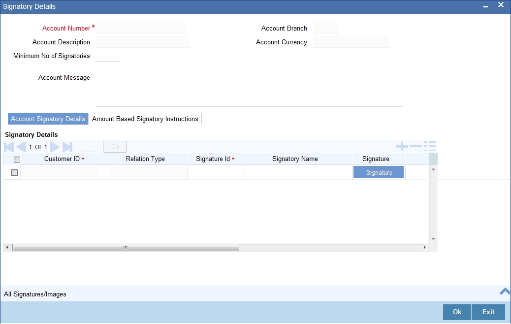

9.1.6.1 Account Signatory Button
Click ‘Account Signatory’ button to view the ‘Signatory Details’ screen. In this screen, you can view the signatory details of the selected account.
You can view consolidated customer signature in the ‘Customer Signature/Image Consolidated View’ screen. To view this screen, click ‘All Signatures/Images’ button.
Refer the section ‘Specifying Account Signatory Details’ under the ‘Current and Savings Account’ module for more information.

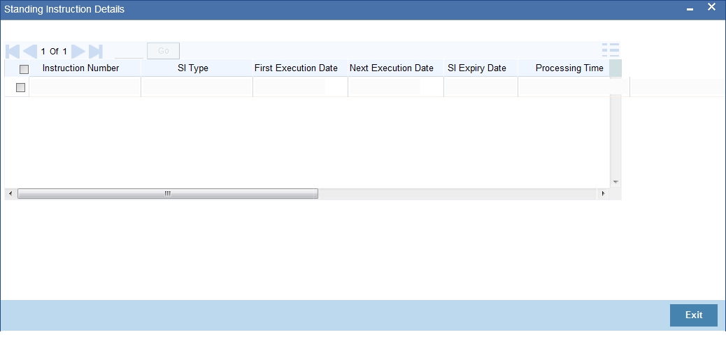

9.1.6.2 Standing Instruction Button
Click ‘Standing Instruction’ button to view the ‘Standing Instruction Details’ screen. In this screen you can view the standing instructions which have debit account as account selected from multiple block.

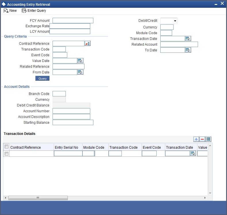

9.1.6.4 Transactions Button
Click ‘Transactions’ button to view the ‘Customer Account Transaction Query’ screen. In this screen, you can query the transactions of an account during a given period.
Account Description
The system displays the description of the specified account number based on the details maintained at ‘Customer Account Maintenance’ level.
Refer the section ‘Querying Accounting Entries’ under ‘Core Services’ module for more information.

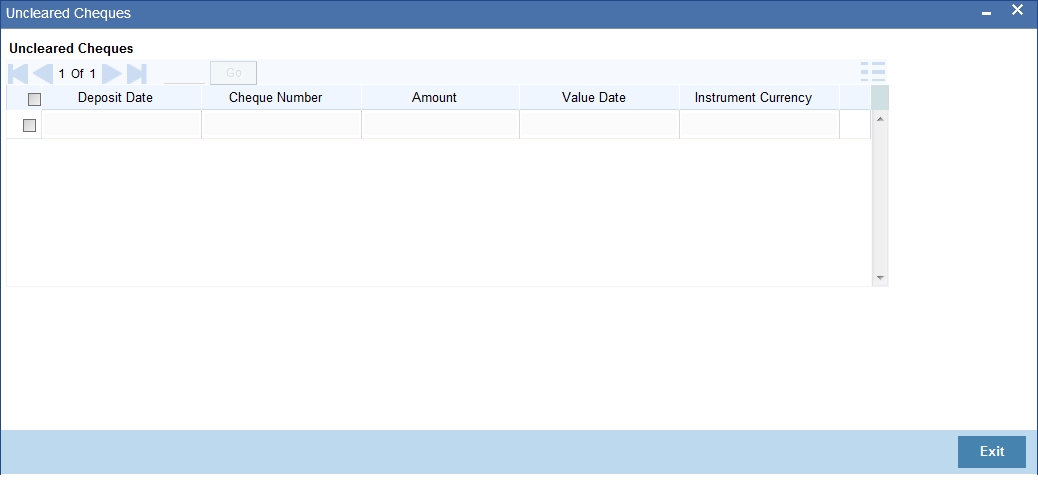

Click on 'Uncleared Cheques' button to invoke 'Uncleared Cheques' screen. You can view customer's cheques details which are uncleared in this screen.
You can view the following details related to uncleared cheques:

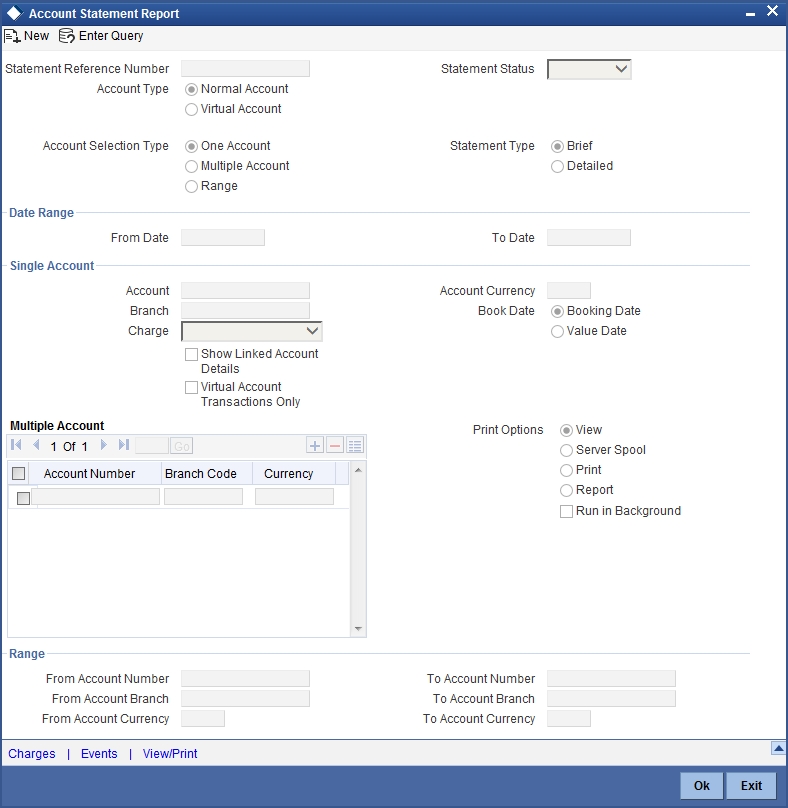

9.1.6.7 Statement Generation Button
Click ‘Statement Generation’ button to view the ‘Account Statement Report’ screen. In this screen, you can generate adhoc statement for an account.
Refer the section ‘Account Statement Report’ under ‘Current and Savings Account’ module for more information.

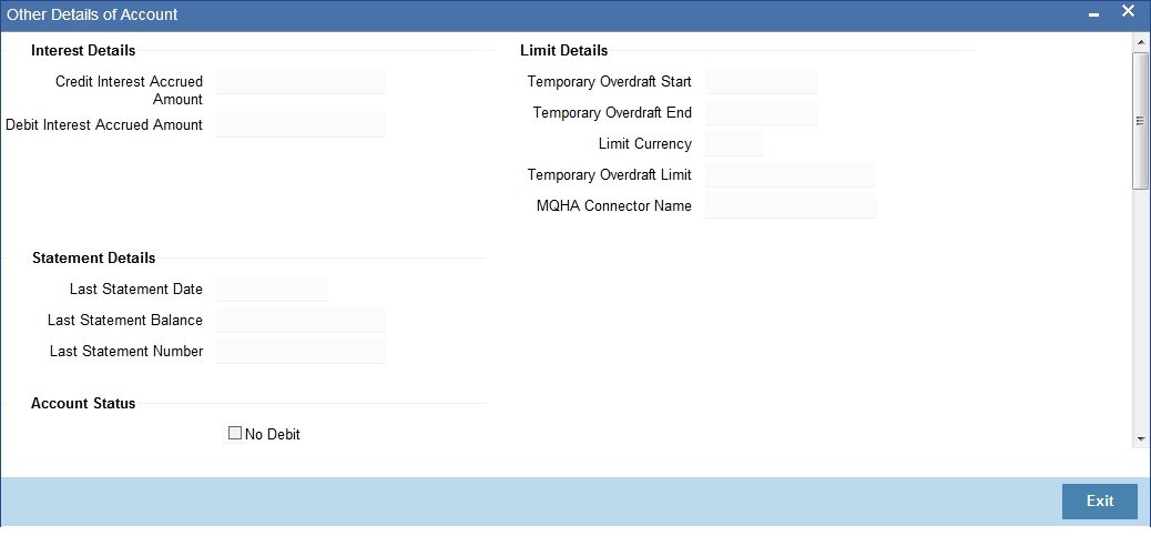

9.1.6.9 Others Button
Click ‘Others’ button to view the ‘Other Details Of Account’ screen. In this screen, you can view additional details about interest, limit, statement, account and nominees.

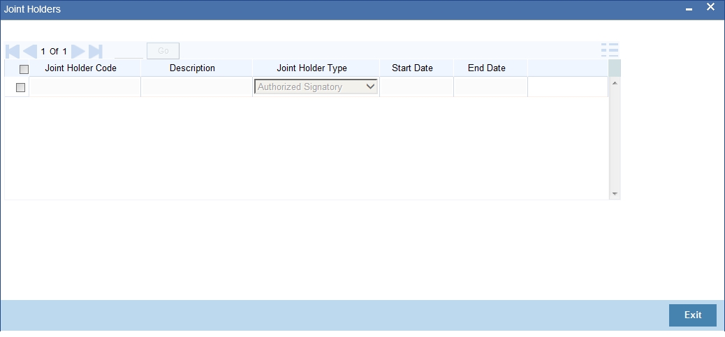

Click ‘Joint Holders’ button to view the ‘Joint Holders’ screen. In this screen, you can view the joint holders details.

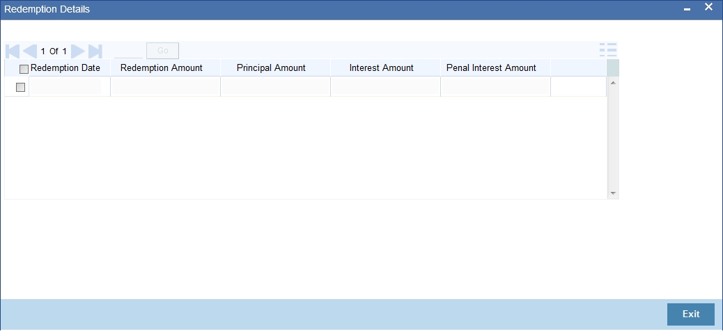

9.1.6.12 Redemption Details Button
Click ‘Redemption Details’ button to view the ‘Redemption Details’ screen. In this screen, you can view redemption deposits of a deposit account.

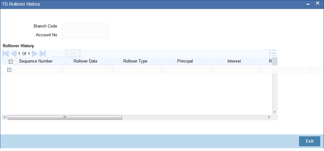

9.1.6.13 Rollover History Button
Click on ‘Rollover History’ button to view Rollover History screen.
You can view the following details here:

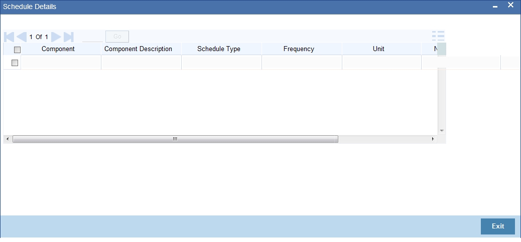

9.1.6.15 Schedules Button
Click ‘Schedules’ button to view the ‘Schedule Details’ screen. In this screen, you can view the schedule details of all components attached to the corporate deposit contract.

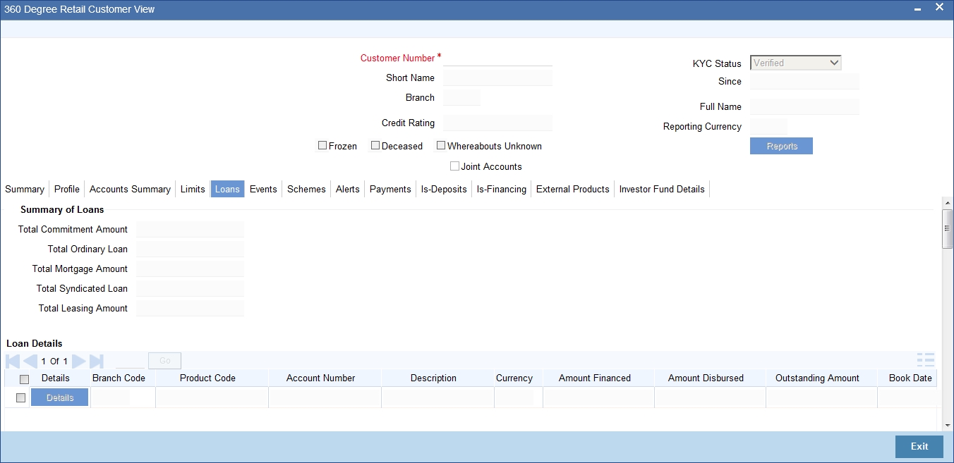

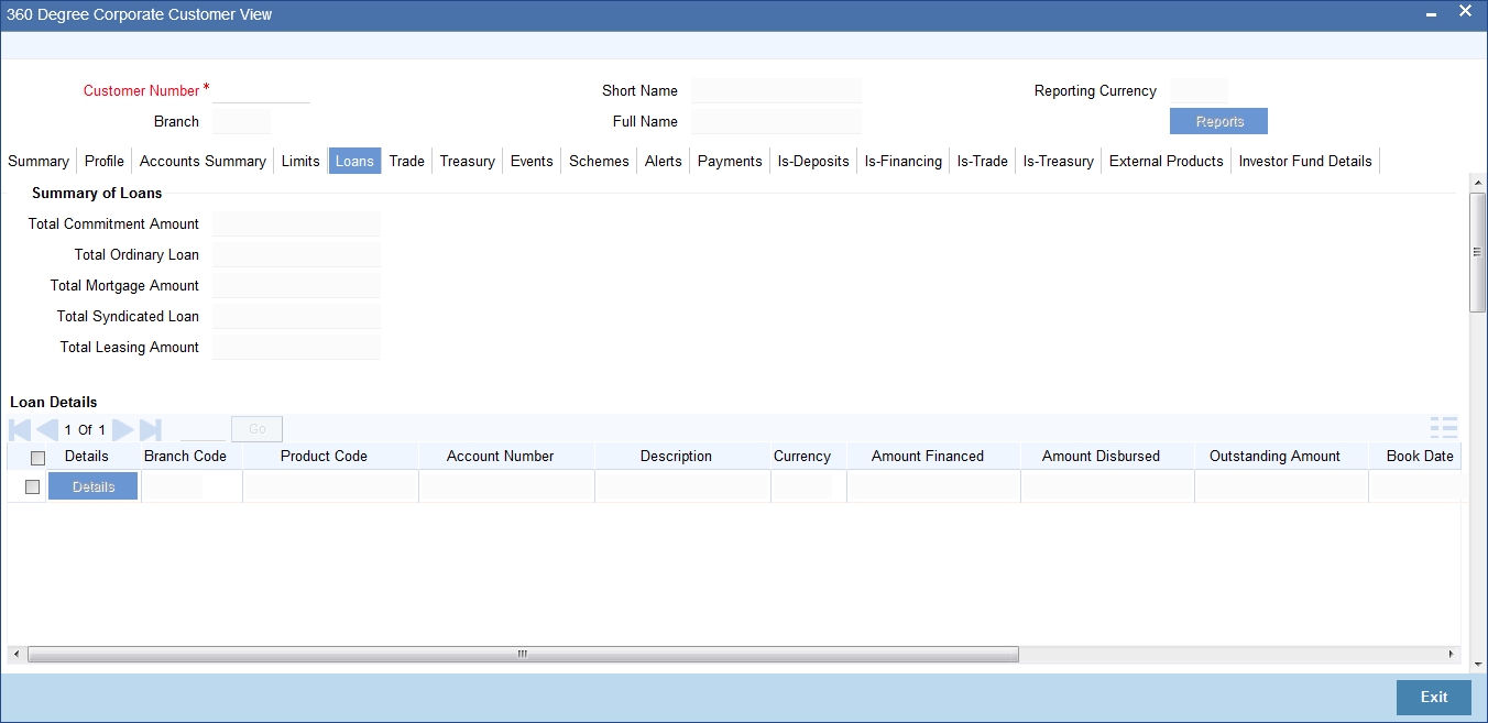

9.1.7 Loans Tab
Click ‘Loans’ tab in the ‘360 Degree Retail Customer View’ screen to view the details of the customer’s loan.
The loans details are classified as follows:
Under each of the loan details, the system displays the following:

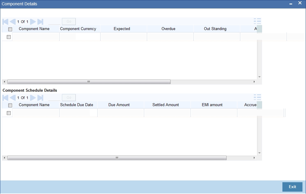

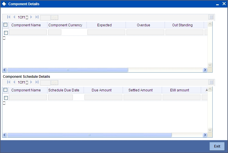

9.1.7.1 Component Details Button
You can view details about the components linked to an account in the ‘Component Details’ screen. You can invoke this screen by clicking the ‘Component Details’ button in the ‘360 Degree Retail Customer View’ screen.
You can view the following component details:
Component Schedule details
Here you can view the following:

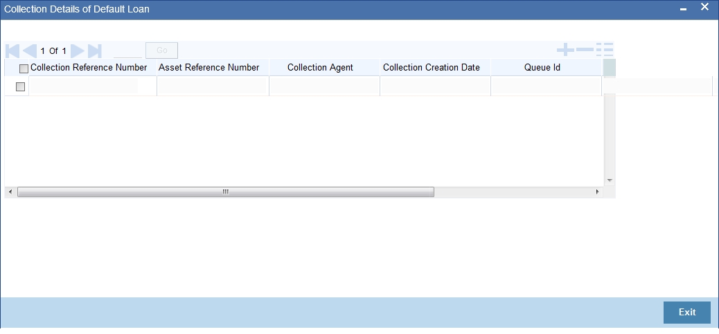

9.1.7.2 Collection Details Button
You can view the collection details of a loan in the ‘Collection Details of Default Loan’ screen. You can invoke this screen by clicking the ‘Collection Details’ button in the ‘360 Degree Retail Customer View’ screen.

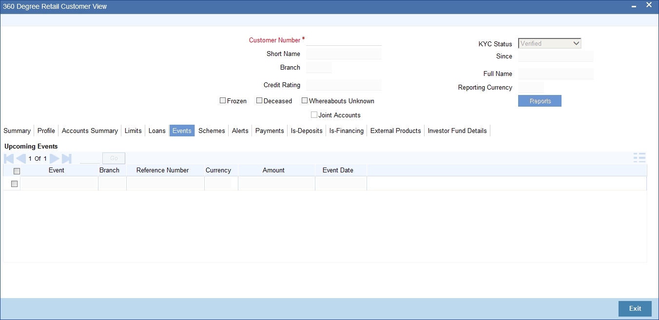

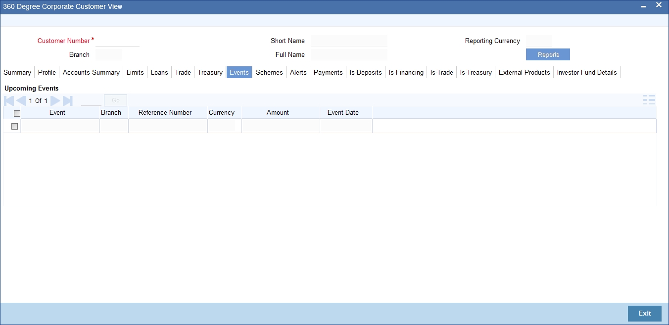

9.1.8 Events Tab
Click ‘Events’ tab in the ‘360 Degree Retail Customer View’ screen to view the details of the upcoming events.

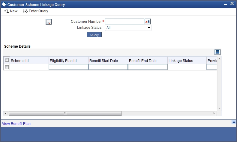

9.1.9 Schemes Tab
Click ‘Schemes’ tab in the ‘360 Degree Retail Customer View’ screen to view the details of the relationship schemes.
Here, you can view the relationship schemes which are not linked to the customer. The following fields are displayed:
9.1.9.1 RP Scheme Linkage Details Button
Click ‘RP Scheme Linkage Details’ to view relationship pricing schemes linked to the customer.
Refer ‘Relationship Pricing’ module for more information about this screen.

9.1.11 Limits Tab
Click ‘Limits’ tab in the ‘360 Degree Retail Customer View’ screen to view the limits and collaterals of the customer.
Limits Details
Here the system displays the following limits details:
Line Details
Here the system displays the following line details:
Collateral Details
Here the system displays the following collateral details:
Obligation Details
Here the system displays the following obligation details:
9.1.12 Payments Tab
Click ‘Payments’ tab in the ‘360 Degree Retail Customer View’ screen to view the FT and PC contracts of the customer which is not liquidated.
Funds Transfer Details
Here you can view the following Funds Transfer details:
Payments and Collection Details
Here you can view the following payments and collection details:
9.1.13 Is-Deposits Tab
Click ‘Is-Deposits’ tab in the ‘360 Degree Retail Customer View’ screen to view details about active CASA account and Term deposit.
Islamic Accounts
Note
The following details about Islamic term deposit will be displayed:
9.1.14 Is-Financing Tab
Click ‘Is-Financing’ tab in the ‘360 Degree Retail Customer View’ screen to view details about Islamic Finance.

9.1.15 External Products Details
Click ‘External products’ tab in the ‘360 Degree Retail Customer View’ screen to view external details about products like credit cards, insurance, and mutual fund.
Credit Card
Here you can view the following credit card details:
Insurance
Here you can view the following insurance details:
Mutual Fund
Here you can view the following mutual fund details:
9.1.16 Investor Fund Details Tab
Click ‘Investor Fund Details’ tab in the ‘360 Degree Retail Customer View’ screen to view the mutual fund details. The following details relating to Mutual Fund can be viewed:

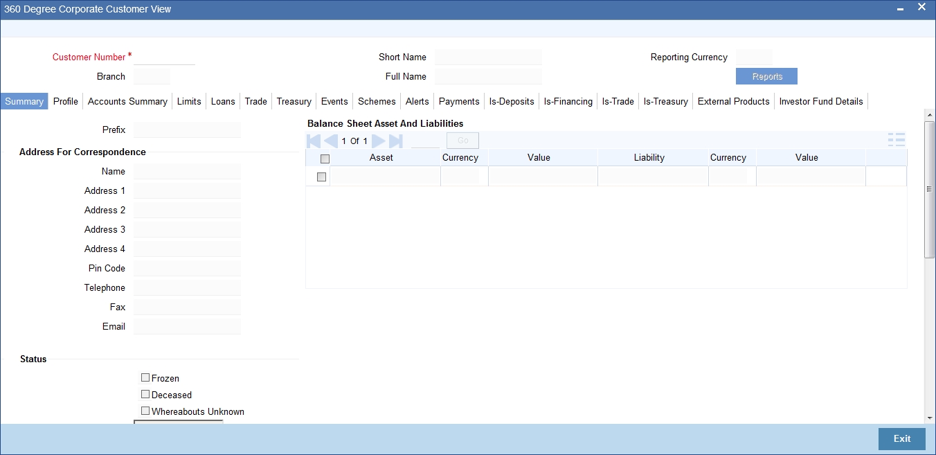

9.1.17 Viewing 360Degree Corporate Customer Details
You can invoke ‘360 Degree Corporate Customer View’ screen if the customer is Corporate by double clicking on the customer record in the ‘360Degree Customer View Entry Point’ screen or by typing ‘STDCUSVW’ in the field at the top right corner of the Application tool bar and clicking on the adjoining arrow button.
9.1.17.1 Reports Button
Click the ‘Reports’ button to view the ‘360 Degree Customer Report’ screen.
The details that can be viewed in the ‘360 Degree Corporate Customer View’ screen is classified into 16 broad heads.

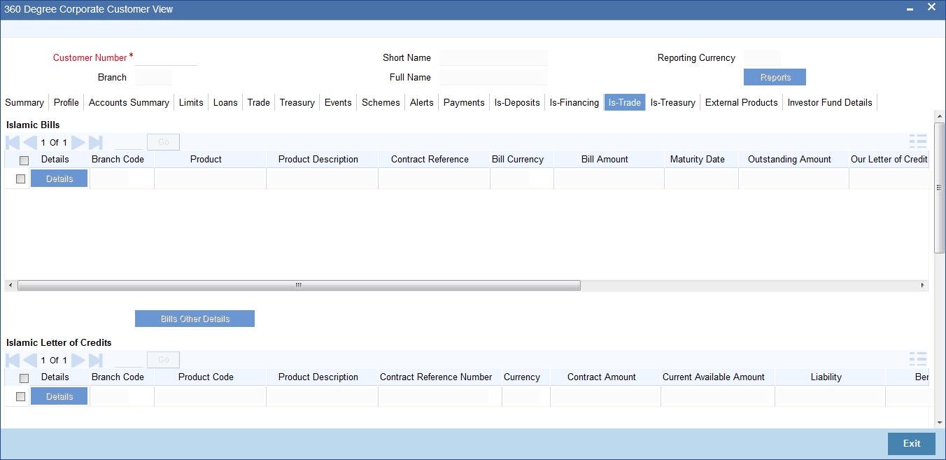

Is-Trade
You can view Islamic trade details.

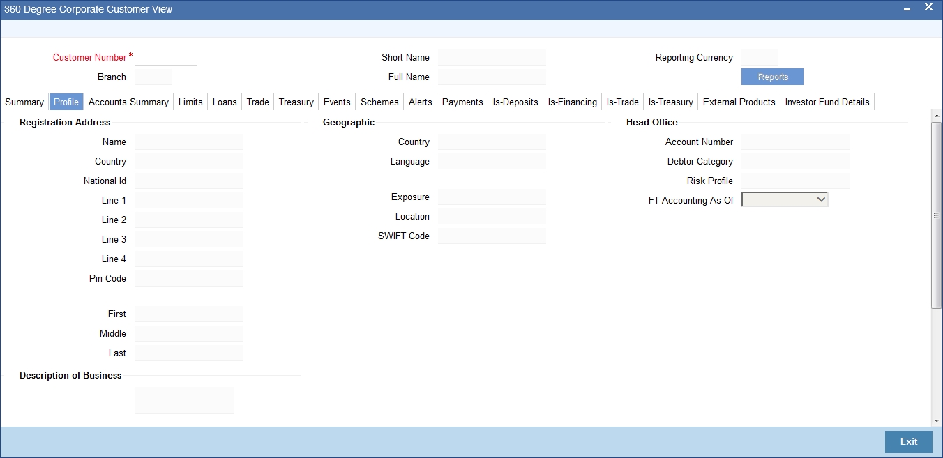

9.1.19 Profile Tab
Click ‘Profile’ tab in the ‘360 Degree Corporate Customer View’ screen to view the details of the customer’s profile.
Registration Address
Geographic
Incorporation
Head Office
9.1.20 Image Button
Refer the section titled ‘Viewing Signature Image and Photograph of the customer’ under ‘Viewing 360 Degree Retail Customer Details’ for further details.

9.1.22 Locker Details Button
Refer the section titled ‘Viewing Locker Details’ under ‘Viewing 360 Degree Retail Customer Details’ for further details

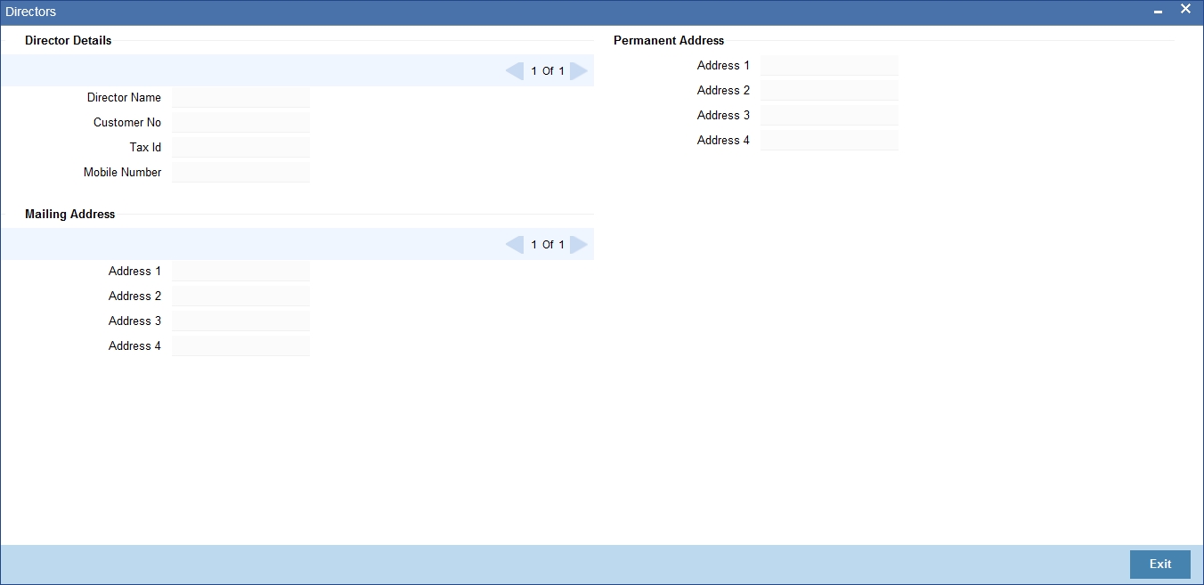

9.1.23 Directors Button
Click on the ‘Directors’ button to invoke ‘Directors’ screen. Here you can view the director details of the customer.
9.1.24 Linked Entity Button
Click the ‘Linked Entity’ button to invoke ‘Linked Entity’ screen. Here you can view details about customers who are linked to this customer, accounts for which this customer is linked,reverse relationship of the quiered customer and loans which are guaranteed by this customer.
Refer the section titled ‘Viewing Customer Entities’ under ‘Viewing 360 Degree Retail Customer Details’ for further details

9.1.26 Fields Button
Refer the section titled ‘Viewing User Defined Fields’ under ‘Viewing 360 Degree Retail Customer Details’ for further details.
9.1.27 MIS Button
Refer the section titled ‘Viewing MIS Details’ under ‘Viewing 360 Degree Retail Customer Details’ for further details.

9.1.29 Account Signatory Tab
9.1.30 Standing Instruction Button
Click ‘Standing Instruction’ button to view the ‘Standing Instruction Details’ screen. In this screen you can view the standing instructions.
Refer the section titled ‘Viewing Standing Instruction ’ under ‘Viewing 360 Degree Retail Customer Details’ for further details.

9.1.32 Transactions Button

9.1.34 Statement Generation Button

9.1.36 Others Button
Refer the section titled ‘Viewing Other Details’ under ‘Viewing 360 Degree Retail Customer Details’ for further details.

9.1.37.2 Redemption Details Button
Refer the section titled ‘Viewing Redemption Details’ under ‘Viewing 360 Degree Retail Customer Details’ for further details.
9.1.37.3 Rollover History Button
9.1.37.4 Schedules Button
Refer the section titled ‘Viewing Schedule Details’ under ‘Viewing 360 Degree Retail Customer Details’ for further details.
9.1.38 Loans Tab
Click ‘Loans’ tab in the ‘360 Degree Corporate Customer View’ screen to view the details of the customer’s loan.
Refer the section titled ‘Viewing Loans Details’ under ‘Viewing 360 Degree Retail Customer Details’ for further details.
9.1.38.1 Component Details Button
You can view details about the components linked to an account in the ‘Component Details’ screen. You can invoke this screen by clicking the ‘Component Details’ button in the ‘360 Degree Corporate Customer View’ screen.
Refer the section titled ‘Viewing Component Details’ under ‘Viewing 360 Degree Retail Customer Details’ for further details.
9.1.38.2 Collections Details Button
You can view the collection details of a loan in the ‘Collection Details of Default Loan’ screen. You can invoke this screen by clicking the ‘Collection Details’ button in the ‘360 Degree Corporate Customer View’ screen.
Refer the section titled ‘Viewing Collection Details’ under ‘Viewing 360 Degree Retail Customer Details’ for further details.

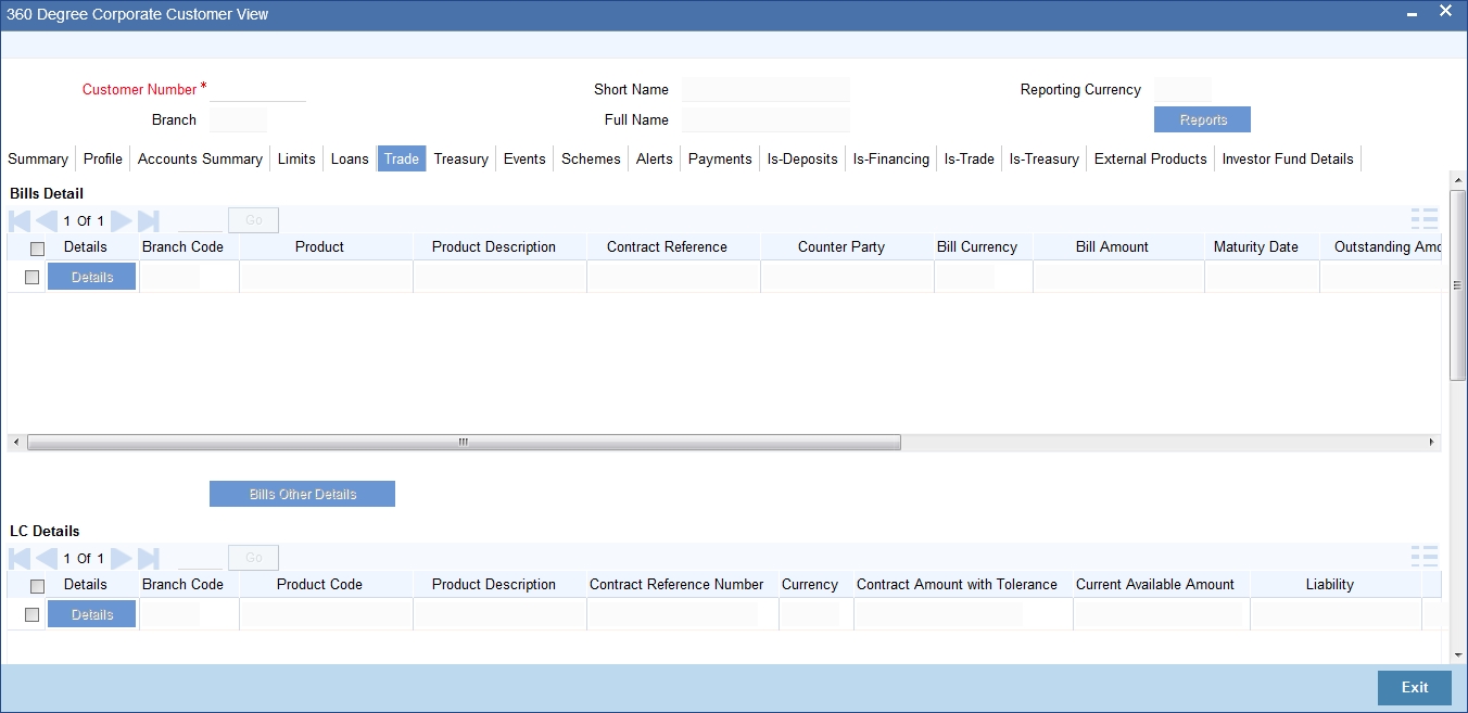

9.1.39 Trade Tab
Click ‘Trade’ tab in the ‘360 Degree Corporate Customer View’ screen to view the details of trade.
Bills Detail
Here you can view the following bills details:
LC Details
Here you can view the following details relating to Letters of credits:
Guarantee Details
Here you can view the following details relating to guarantees:

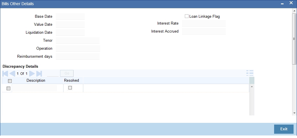

9.1.39.1 Other Bills Details Button
You can view additional details about the bill from the ‘Bills Other Details’ screen. You can invoke this screen by clicking on ‘Other Bill Details’ button.
Discrepancy Details

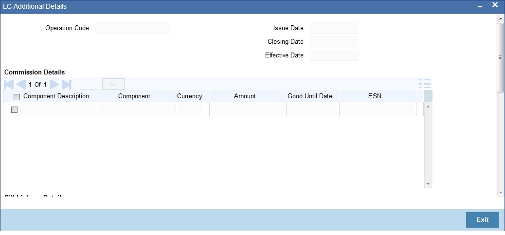

9.1.39.2 LC Others Details Button
You can view additional details about LC in the ‘LC Additional Details’ screen. You can invoke this screen by clicking on ‘LC Other Details’ button.
Commission Details
Bill Linkage details
Loan Details
Here you can view the Loans details which are related to LC. The following fields are displayed:

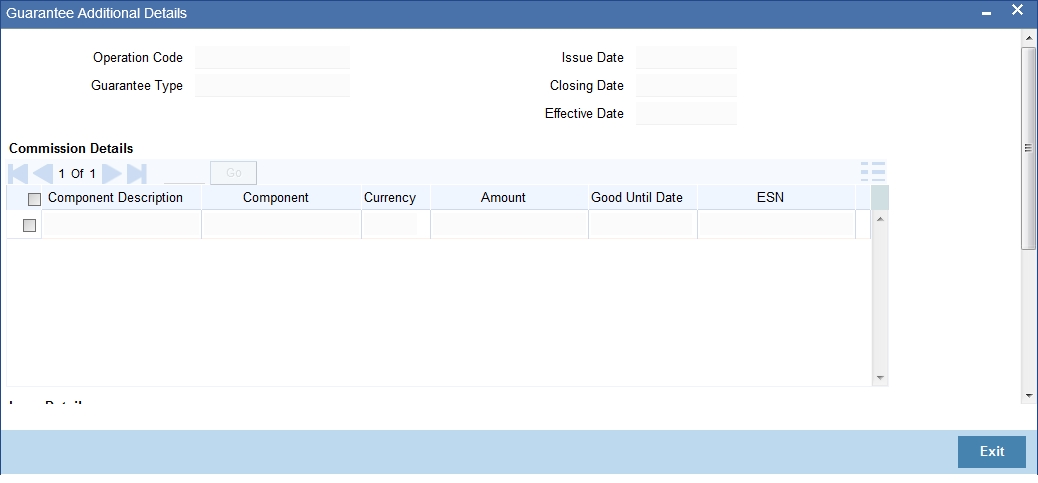

9.1.39.3 Guarantee Other Details Button
You can view additional details about guarantee in the ‘Guarantee Additional Details’ screen. You can invoke this screen by clicking on ‘Guarantee Other Details’ button.
Commission Details
Loan Details
Here you can view the Loans details which are related to guarantee. The following fields are displayed:

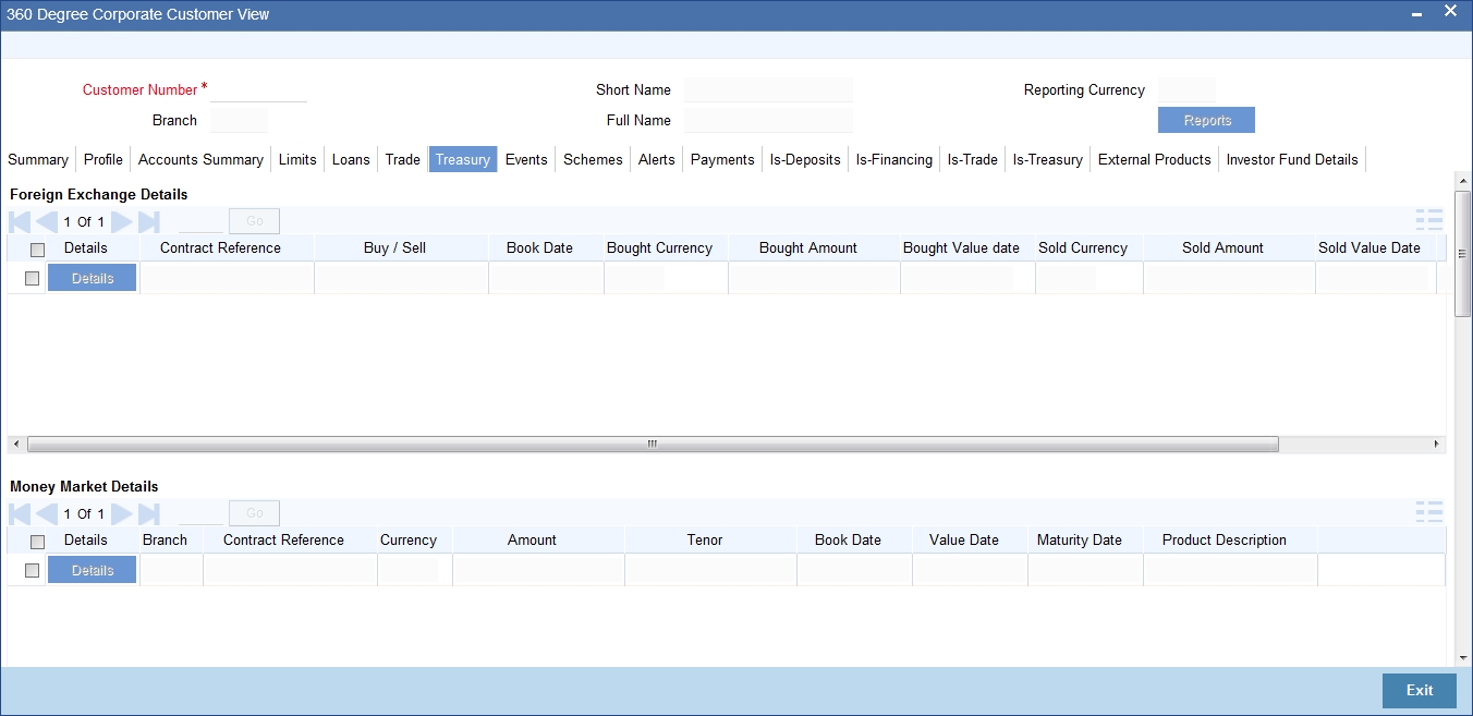

9.1.40 Treasury Tab
Click ‘Treasury’ tab in the ‘360 Degree Corporate Customer View’ screen to view the details of Treasury.
Foreign Exchange Details
Money Markets Details
Security Portfolio
Derivatives
OTC Options
ETD Portfolio Details
9.1.41 Events Tab
Click ‘Events’ tab in the ‘360 Degree Corporate Customer View’ screen to view the details of the upcoming events.
Refer the section titled ‘Viewing Events Details’ under ‘Viewing 360 Degree Retail Customer Details’ for further details.
9.1.42 Schemes Tab
Click ‘Schemes’ tab in the ‘360 Degree Corporate Customer View’ screen to view the details of the relationship schemes.
Refer the section titled ‘Viewing Schemes Details’ under ‘Viewing 360 Degree Retail Customer Details’ for further details.
9.1.42.1 RP Schemes Linkage Details Button

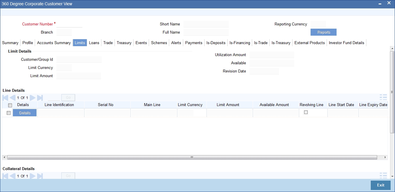

9.1.44 Limits Tab
Click ‘Limits’ tab in the ‘360 Degree Corporate Customer View’ screen to view the limits and collaterals of the customer.
Refer the section titled ‘Viewing Limits Details’ under ‘Viewing 360 Degree Retail Customer Details’ for further details.

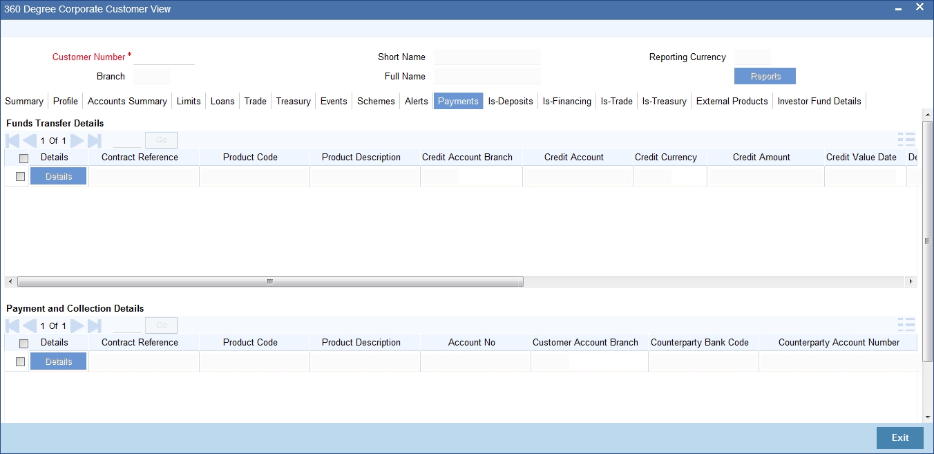

9.1.45 Payment Tab
Click ‘Payments’ tab in the ‘360 Degree Corporate Customer View’ screen to view the FT and PC contracts of the customer which is not liquidated.
Refer the section titled ‘Viewing Payments Details’ under ‘Viewing 360 Degree Retail Customer Details’ for further details.

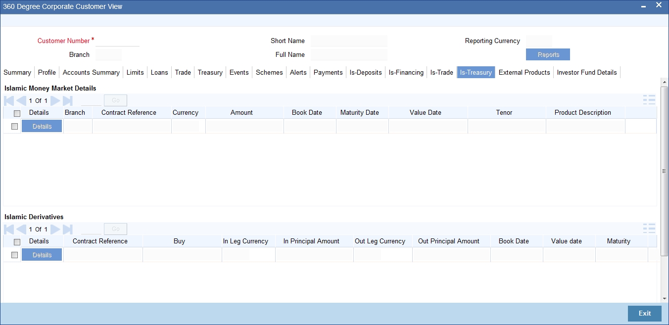

9.1.46 Is-Deposits Tab
Click ‘Is-Deposits’ tab in the ‘360 Degree Corporate Customer View’ screen to view details about active CASA account and term deposit.
Refer the section titled ‘Viewing Additional Bill Details’ under ‘Viewing 360 Degree Corporate Customer Details’ for further details.
Refer the section titled ‘Viewing Additional LC Details’ under ‘Viewing 360 Degree Corporate Customer Details’ for further details.
9.1.46.3 Guarantee Other Details Button
Refer the section titled ‘Viewing Additional Islamic Bank Guarantee’ under ‘Viewing 360 Degree Corporate Customer Details’ for further details.
9.1.47 Is-Financing Tab
Click ‘Is-Financing’ tab in the ‘360 Degree Corporate Customer View’ screen to view details of Islamic finance.
Refer the section titled ‘Viewing Islamic Financing Details’ under ‘Viewing 360 Degree Retail Customer Details’ for further details.
9.1.47.1 Component Details Button
Refer the section titled ‘Viewing Components Details’ under ‘Viewing Loan Details’ for further details.
9.1.48 Is-Trade Tab
Click ‘Is-Trade’ tab in the ‘360 Degree Corporate Customer View’ screen to view details of Islamic trade.
Islamic Bills Detail
Islamic Letter of Credit Details
Islamic Bank Guarantee Details
9.1.49 Is-Treasury Tab
Click ‘Is-Treasury’ tab in the ‘360 Degree Corporate Customer View’ screen to view the details of Islamic Treasury.
Islamic Money Market Details
Islamic Derivatives
9.1.50 External Products Tab
Click ‘External products’ tab in the ‘360 Degree Corporate Customer View’ screen to view external details about products like credit cards, insurance, and mutual fund.
Refer the section titled ‘Viewing External Details’ under ‘Viewing 360 Degree Retail Customer Details’ for further details.
9.1.51 Investor Fund Details Tab
Click ‘Investor Fund Details’ tab in the ‘360 Degree Corporate Customer View’ screen to view details of the mutual fund.
The following details on a mutual fund can be viewed in this screen:

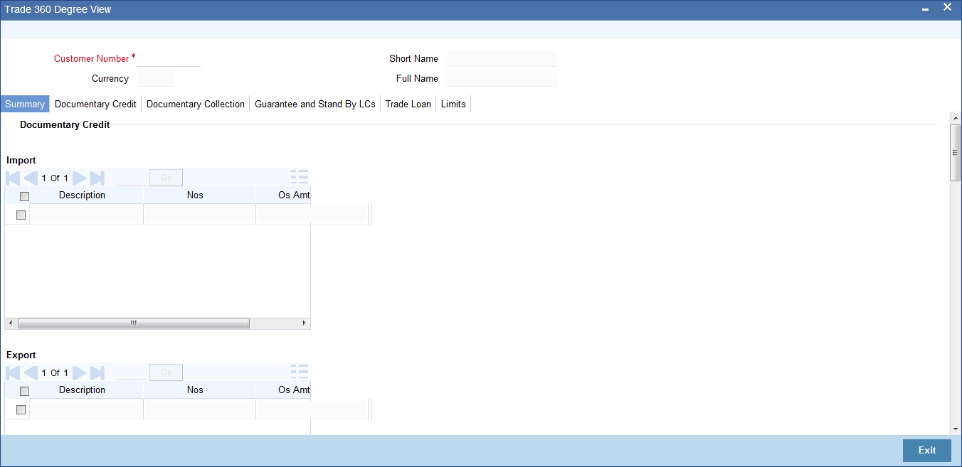

9.1.52 Viewing CustomerTrade 360 degree
You can invoke Trade 360 degree view of the customer by typing ‘STDTRDVW’ in the field at the top right corner of the Application tool bar and clicking on the adjoining arrow button.
This facility is only supported for corporate customers.
Customer Number
Specify the customer number for which the trade summary is to be viewed.
The system displays the following:
The details that can be viewed in the Trade 360 Degree View can be classified into the following tabs:

9.1.53 Summary Tab
Documentary Credit
The Import and Export Documentary credit outstanding balances in local currency will be displayed in various heads
Documentary Collection
The Import and Export Documentary Collection outstanding balances in local currency will be displayed in various heads
Guarantee/Stand-by-LCs
Issued and Advised Guarantee/Shipping Guarantee/Stand-by-LCs outstanding balances in local currency will be displayed in various heads
Trade Loan
Import and Export Trade Loan outstanding balances in local currency will be displayed in various heads.

9.1.58 Limits Tab
Limit Details
Line Details
Collateral Details
