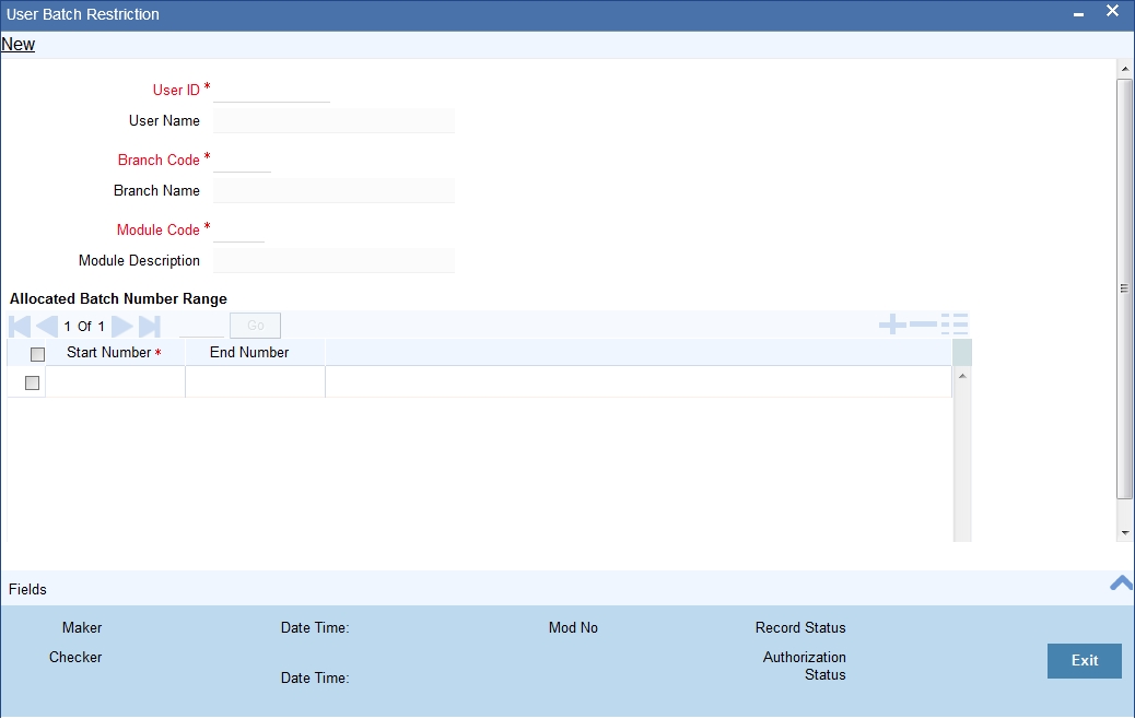

Each time you post journal and multi offset entries, you need to open a batch. You can specify that the batch numbers of the journal entry batches opened in your bank should be generated automatically by enabling the Auto Batch option.
Consequently, the system automatically generates batch numbers while posting journal and multi offset entries.

You can restrict the usage of batches to specific user by placing bank-wide User level batch restrictions. If you enable this option as a Bank Parameter, you need to allocate the batch number range for each user through the ‘Batch Restriction Maintenance’ screen.
The restriction on the usage of batch numbers is made applicable on data entry and PC transactions. The user will be allowed to enter only those batches reserved for the user profile. As a result, each time a user specifies a batch number; it will be validated against the ‘Allocated Batch Number Range’.
This feature is applicable only when batch generation is manual. Therefore, if you enable this option, you must ensure that the Auto Generate option has not been enabled. In a scenario where the User Restriction for Batch Number field is enabled and Auto Batch option has also been enabled, the system displays an error message as “Not a Valid Batch Number For the User”.
In case you choose to auto generate batch numbers, the System will not perform the batch restriction validation.
You can invoke the ‘Batch Restrictions Maintenance’ screen by typing ‘STDBRRES’ in the field at the top right corner of the Application tool bar and clicking the adjoining arrow button.
Specify the following details in this screen:
Note
While processing DE and PC transactions, the batch number specified by the user is validated against the allotted range. If the validation fails, an error message is displayed.
