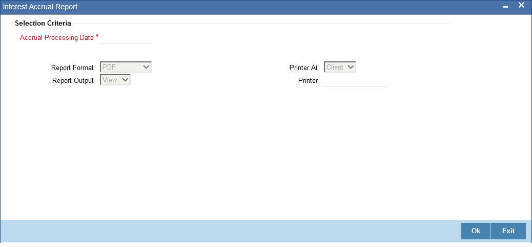

The interest accrual report gives details of accruals done on hedge type of derivative contracts.
You can invoke the screen by typing the code ‘DVRPACCR’ in the field at the top right corner of the Application tool bar and click on the adjoining arrow button.
Accrual Processing Date
Specify the accrual processing date on which you want to generate the interest accrual details report.
The report will be sorted based on the Branch and the User ID of persons who entered the contracts.

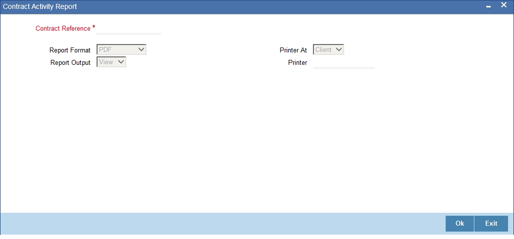

The Contract Activity report gives details of all the activities that were performed on the contract in a chronological order. This is from the date on which the contract was booked in the system upto today’s date.
You can invoke the screen by typing the code ‘DVRPCACT’ in the field at the top right corner of the Application tool bar and click on the adjoining arrow button.
Contract Reference
You have to specify the reference number of the contract for which the report is to be generated.
Apart from the header the following information will be provided for the Contract Activity report. The contents of the report are discussed under the following heads:

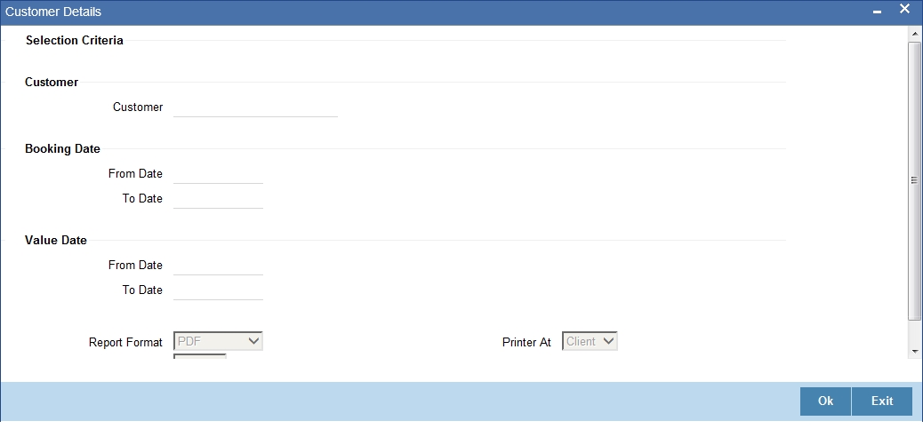

The Customer-wise Details report gives you details of all contracts where the counter-party involved is a specific customer of your bank.
You can invoke the screen by typing the code ‘DVRPCSDT’ in the field at the top right corner of the Application tool bar and click on the adjoining arrow button.
Once you indicate the ID of the customer for whom the report should be generated you have to specify the Booking date range within which the contracts generated for the specific customer should fall. You can do this by way of specifying the From and To booking dates.
In addition to the booking date range you can also specify that the report should be generated for contracts, which have value dates falling within a specified date range.
The generated report will contain details of the various activities carried out on all the contracts that were processed between the specified date range (both for the Booking Date and the Value Date) for the particular customer.
The report options that you selected while generating the report are printed at the beginning of the report.

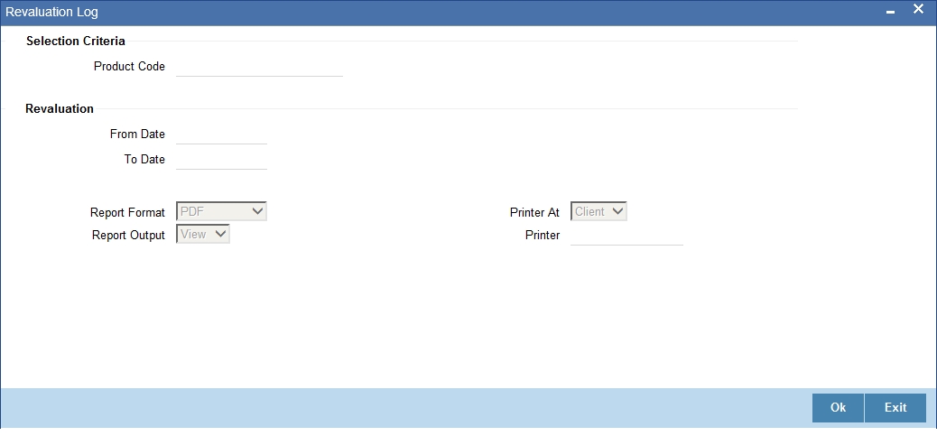

Through the Revaluation Log report you can get product-wise details of all contracts which were revalued within a specific period. Thus at the product level you can guage the gains and losses due to changes in the market interest rates or the exchange rates.
You can invoke the screen by typing the code ‘DVRPRVAL’ in the field at the top right corner of the Application tool bar and click on the adjoining arrow button.
Product Code
Select the product code for which the report has to be generated.
is to be revalued you have to indicate the period for which revaluation should be carried out.
From Date
Specify the date from when the contract is to be revalued.
To Date
Specify the date till when the contract is to be revalued.
Note
You can choose to generate the revaluation log report either for one particular product or for all the products.

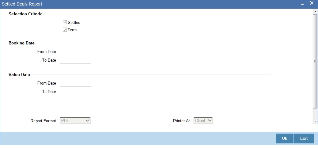

Through the Settled Deals report options screen you can generate a detailed report on all contracts which were settled as well as on those contracts which were terminated.
You can invoke the screen by typing the code ‘DVRPSTLD’ in the field at the top right corner of the Application tool bar and click on the adjoining arrow button.
Firstly you have to indicate whether the report should be generated for settled deals or whether the report should contain details of contracts which were terminated.
After you indicate this specification you have to specify the date range within which the settled/terminated contracts were booked. Similarly you can specify that the report should contain deals bearing a value date falling within a specific date range.
The generated report will contain details of contracts satisfying the above criteria.
