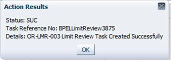

While viewing the results, you can also use the ‘Action’ button to invoke a text capture window where important information about the credits can be recorded.
Enter the description and click ‘Execute’. You will see the result window.
You can also create a manual review task through the workflow process.

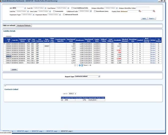

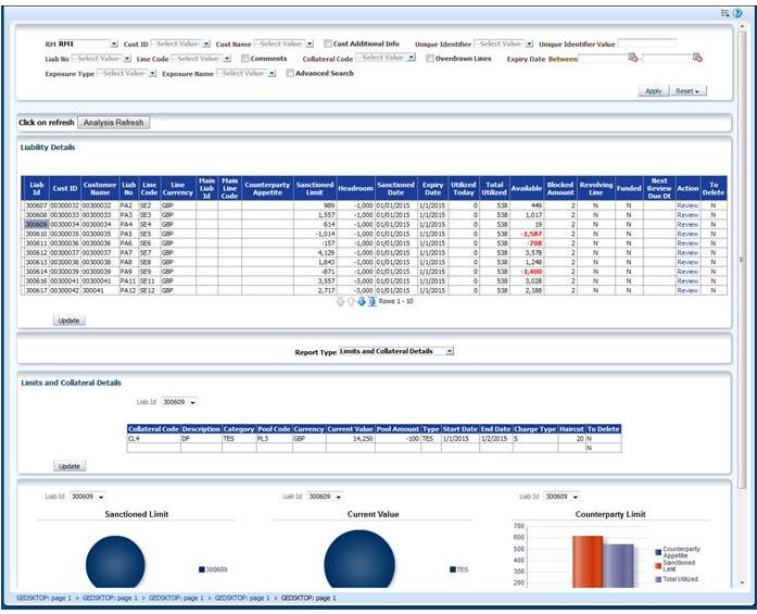

In ‘Report Type’ field, if you select ‘Limit and Collateral Details’, the system displays this tab. This contains the limits and collateral details linked to the line/liability ID.
From this tab, you can view a graph displaying the counterparty appetite, Sanctioned Limit and Total Utilized for every Liability.
You can also perform a what if analysis from this tab.
While doing what if analysis, you can edit the report and click ‘Apply’ button to apply the changes.
In ‘Report Type’ field, select ‘Linked Contracts’ to view the contracts linked to a particular line/customer.

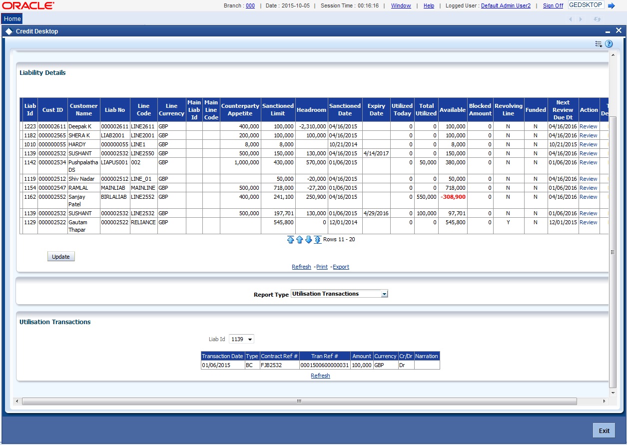

In ‘Report Type’ field, select ‘Utilization Transaction’ to view transaction details of any OD account linked to the line. If the number of transactions is more than 50, then the system will prompt you to define a date range criteria.

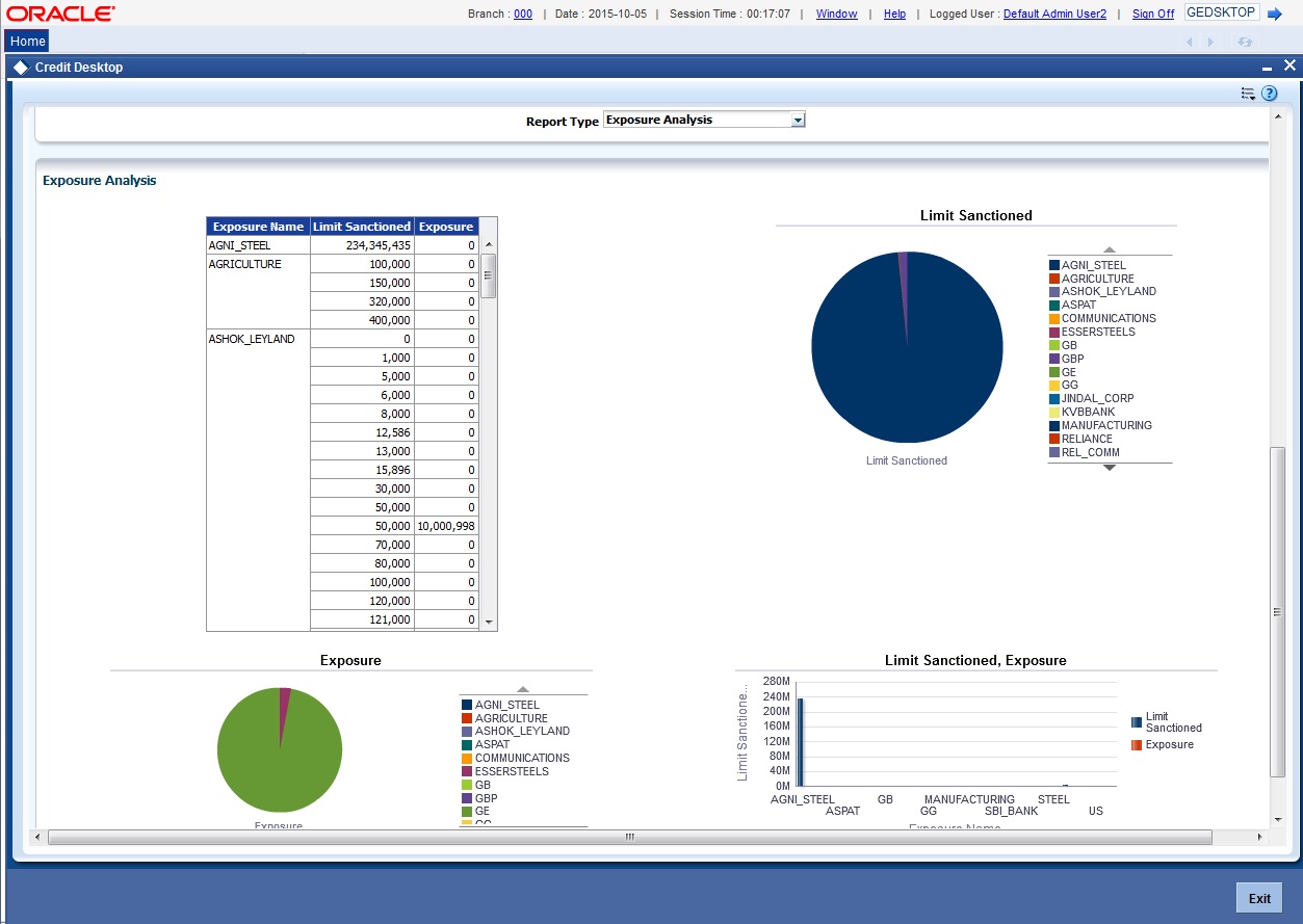

In ‘Report Type’ field, select ‘Exposure Analysis’ to view the data and graph of bank/branch wise exposure based on a selected criteria.

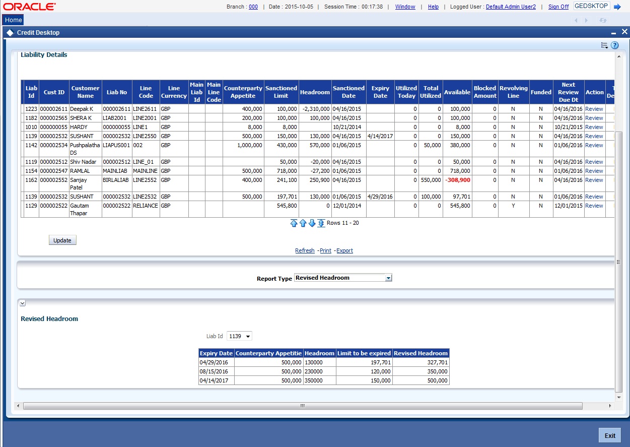

In ‘Report Type’ field, select ‘Revised Headroom’ to view the future dated headrooms available to the customer. This depends on the expiry of the limit.

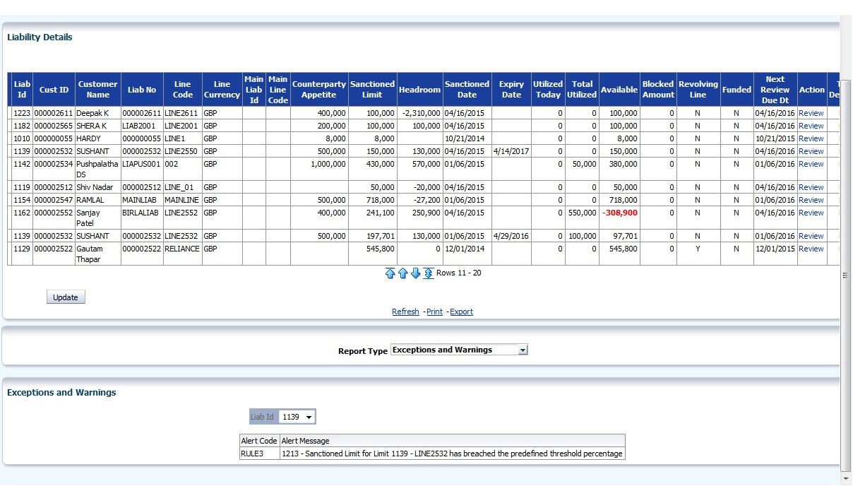

In ‘Report Type’ field, select ‘Exceptions and Warnings’ to view the list of exceptions and warnings in a separate window. These exceptions and warnings are the alerts generated for the rules maintained in the system with channel ‘Credit Desktop’. Click and select a liability ID in Liability Details to view the alert codes and alert messages.

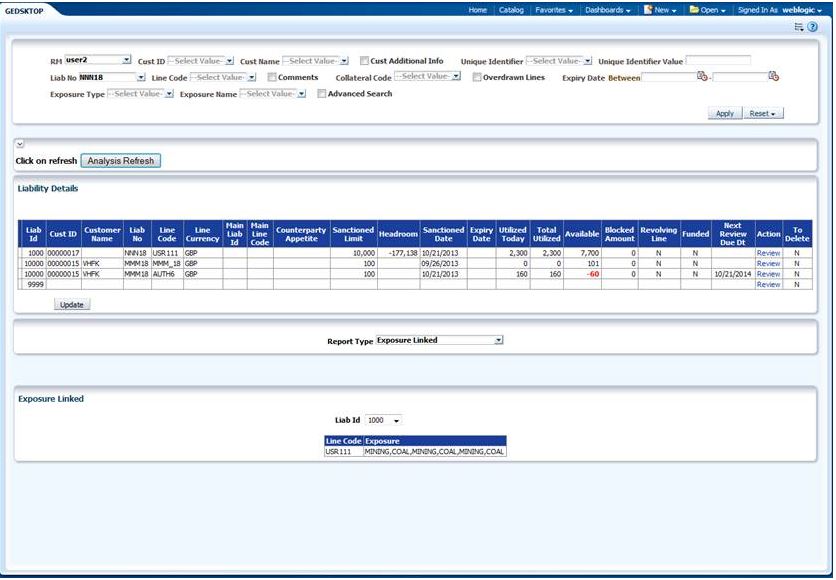

In ‘Report Type’ field, select ‘Exposure Linked’ to view the exposures linked to a selected customer.
