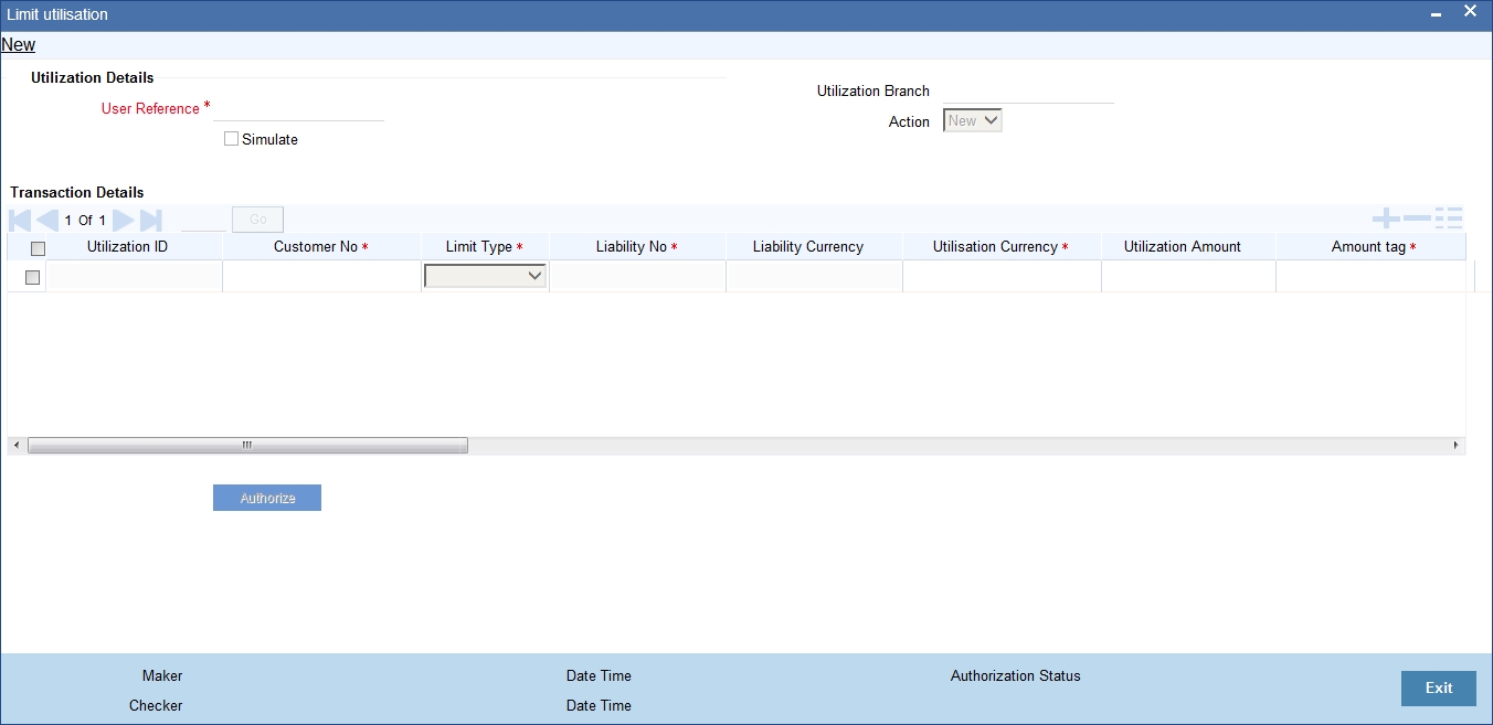

6.1 New Utilization
The process wherein a facility is given to a customer and is utilized by the customer is called a Utilization Process. Utilization Process is termed as a New Utilization when the customer utilizes his facility in a new transaction.
A New Utilization Transaction can arise from any kind of transaction like Loan input, Letter of credit input, Bill/Collection input, foreign exchange deal input etc.
New utilization involves the following actions:
6.1.1 Input Utilization
New Utilization process increases the Utilization Amount and decreases the Available Amount for the associated Liability, Facility, or Exposure. If the Liability Facility, Sector Facility Or Country Facility has an associated Main Line then the utilization will reflect at all the parent levels.
Following data are input for a New Utilization transaction.

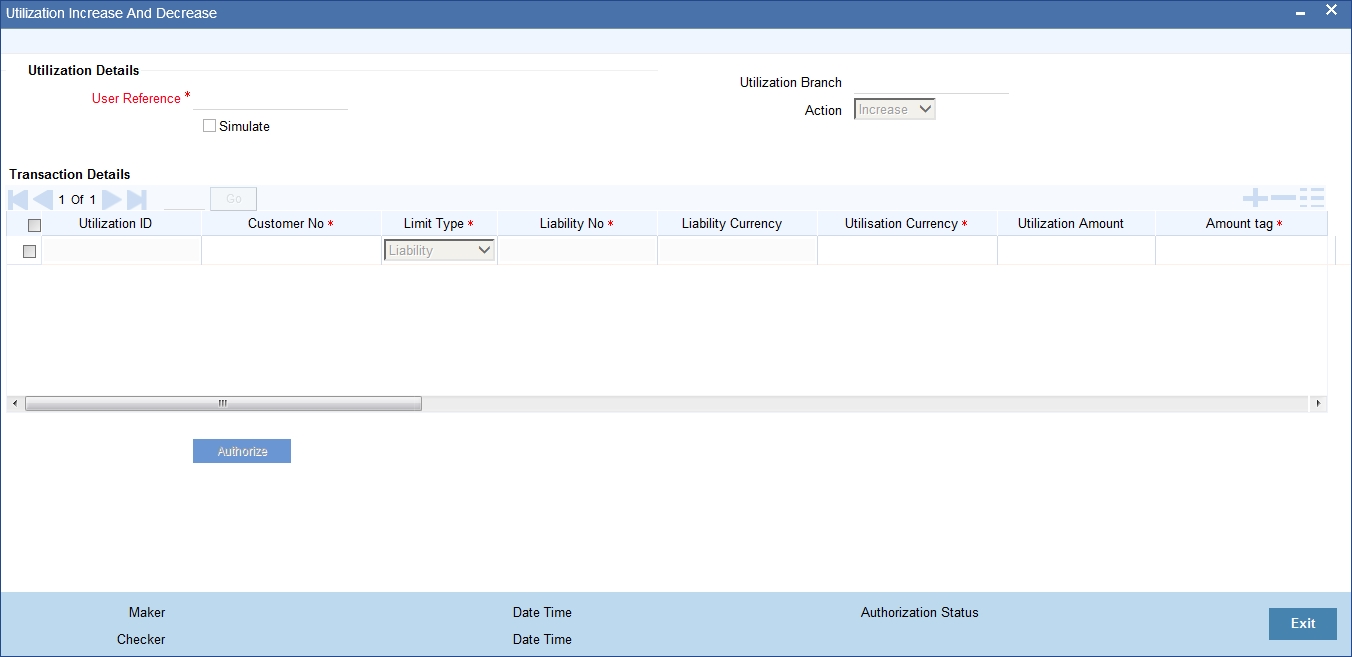

6.2 Increase/Decrease Utilization
Increase/Decrease utilization transaction would be used to modify the utilization amount of the transaction. This transaction will be used when customer is making payment for the loan or when the loan amount is modified.
Apart from the GW header information, system requires following information.

All utilization requests explained above can also be raised through the ‘Limit Utilization’ screen.
You can invoke the ‘Limit Utilization’ screen by typing ‘GEDUTILS’ in the field at the top right corner of the Application tool bar and clicking the adjoining arrow button.
Note
The limit utilization feature explained in this section will be available only if the Enterprise Limits and Collateral Management module has been set up in standalone mode. In case of embedded or hybrid setups, you will not be able to invoke this screen.
Utilisation Branch
Specify the branch where the utilization request should be processed. The adjoining option list contains all the branches maintained in the system. Select the appropriate one.
User Reference Number
Specify a unique reference number for the transaction.
Transaction Module
Specify the module for the transaction. The adjoining option list contains all the modules in the system. Select the appropriate one.
Transaction Date
Specify the date for the transaction.
Simulate
Check this box to indicate that the details for the transaction being entered should be used only for simulation and not stored permanently within the system. After a simulated transaction has been successfully put through, the system will display the utilized amount for the facility and the for the liability.
Customer Number
Specify a valid customer number for the transaction. The adjoining option list contains all the customers maintained in the system. Select the appropriate one.
Utilisation Amount
Specify the amount for the utilization transaction.
Utilisation Currency
Specify the currency for the amount entered. The adjoining option list contains all the currencies maintained in the system. Select the appropriate one.
Utilisation Product
Specify the product for the transaction. The adjoining option list contains all the relevant products. Select the appropriate one.
Uncollected Amount
Specify the amount that has not yet been collected from the customer.
Tenor Basis
Check this box to indicate that the utilization should be tracked tenor wise for the facility. You can specify the basis on which it is to be tracked in the ‘Tenor’ field.
Tenor
Enter the basis on which tenor tracking should be done for the utilization. You need to have checked the ‘Tenor Basis’ option before you can specify the basis here.
Maturity Date
Specify the date on which the transaction matures.
Amount Tags
Specify the component type for the transaction. The adjoining option list contains all the relevant tags. Select the appropriate one.
Remarks
Enter any additional remarks that you wish to maintain for this transaction. You can enter up to 255 characters.
Value Date
Specify the value date for the transaction.
Line Code
Specify the line code to be used for the transaction. The adjoining option list contains all the line codes allowed. Select the appropriate one.
Facility Block Reference Number
During a new utilization, you can specify a valid block reference number to increase the amount in a facility. On the basis of the block reference number, the system validates if the liability and facility details of the new utilization and the existing facility for which the block has been maintained match. If there is a match, it increases the amount available under the facility by unblocking the corresponding amount block for the facility and making it available for use by the new utilization.

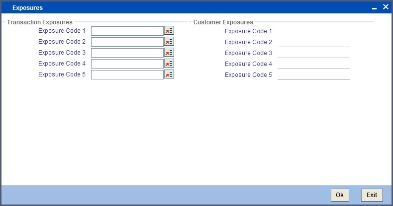

Click the ‘Exposures’ button. In the screen that is displayed, you can specify the transaction exposures that the system should track while processing utilization requests. The system defaults the customer exposures.

You can modify the utilization amount of the transaction through the ‘Utilization Increase And Decrease’ screen. This transaction can be used when customer is making payment for the loan or when the loan amount is modified.
You can invoke the ‘Utilization Increase and Decrease’ screen by typing ‘GEDUTNID’ in the field at the top right corner of the Application tool bar and clicking the adjoining arrow button.
Note
The feature explained in this section will be available only if the Enterprise Limits and Col­lateral Management module has been set up in standalone mode. In case of embedded or hybrid setups, you will not be able to invoke this screen.
Utilization Reference No
Specify the reference number for the utilization that you wish to modify. The adjoining option list contains all the utilizations in the system. Select the appropriate one. The system displays the user reference number, the utilization currency and the amount tag.
Utilization Amount
Enter the amount by which you wish to modify the utilization.
Action
Indicate the operation for the utilization – whether you would like to increase or decrease the utilization amount.
The ‘Limit Utilization’ screen will be displayed when you click on the ‘Details’ button where you can view the details of the original utilization request.

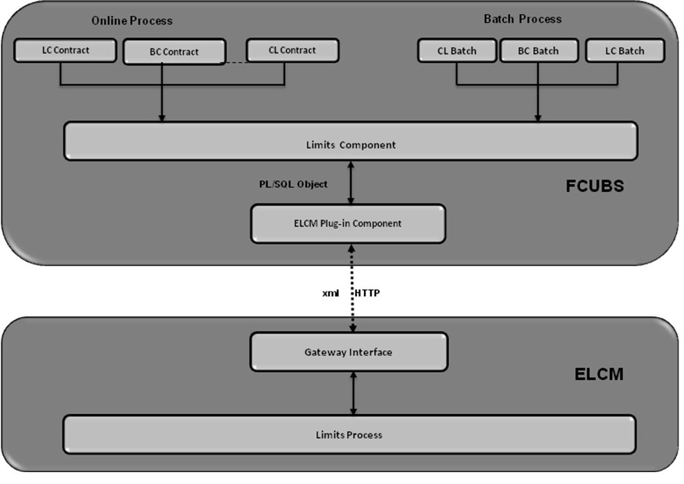

If a contact needs to be tracked under facility, then you have to link the contact to the facility and during transaction processing, Oracle FLXCUBE sends the utilization details to ELCM for processing.
The below diagram briefs the Utilization Transaction Integration Approach flow between Oracle FLEXCUBE and ELCM:
The table below explains the actions you can perform for which Oracle FLEXCUBE hands-off utilization transaction to ELCM:

As part of the contract or transaction process, if a line code is linked to a contract then it is required to track the limits of the linked line. The system exposes limits process as subsystem and any module would interact with Limits subsystem.
The system allows you to trap all the utilization transaction. The system would interface with ELCM Gateway HTTP to upload the utilization transactions in ELCM. Based on the utilization event, the system creates utilization request in ELCM format. It also logs transaction data and status of each utilization transaction.
6.11.1 Collateral Pool Utilization Transaction Process
You are allowed to link collateral pool as part of contact and upload all collateral pool utilization transactions in ELCM. You can process the following events as part collateral pool utilization:
The system allows you to plug the pool utilization data from Oracle FLEXCUBE and passes to ELCM using ELCM Gateway HTTP/WS communication channel.

Oracle FLEXCUBE sends the utilization transaction to ELCM and while processing this transaction, If ELCM processes it completely, then this transaction would be considered as success. Oracle FLEXCUBE would continue to process remaining contract process.
During transaction process, if transaction is uploaded successfully in ELCM and if any error or overrides (overrides not accepted) occurs in Oracle FLEXCUBE then uploaded transaction is reverted back using technical undo feature of ELCM.
6.11.2.2 Transaction Status Failure
Oracle FLEXCUBE sends the utilization transaction to ELCM and while processing this transaction, if any error occurs, ELCM will send failure status with error details to Oracle FLEXCUBE.
ELCM plug-in updates the transaction error objects which ELCM error code, as part of transaction process. Later Oracle FLEXCUBE checks the error object and subsequently raises error as part of contract process.
As part of the transaction process, if ELCM process is failed then ELCM error details are displayed to the user.
Note
6.11.2.3 Transaction Status Override
Oracle FLEXCUBE sends the utilization transaction to ELCM and while processing this transaction, if any override occurs, in such cases ELCM would generate override reference number (Multitrip ID) and log override details along with Multitrip ID for further reference. It marks the final transaction status as override and override details only with Multitrip ID is passed to Oracle FLEXCUBE for further processing.
ELCM plug-in would updates override details in Oracle FLEXCUBE error object it also logs the status and Multitrip ID as part of log table, later as part of transaction process Oracle FLEXCUBE checks the error object and subsequently raises transaction status as override.
Note
If overrides occur as part of transaction process, then the system displays the override de­tails to the user. You have an option to accept or reject the overrides.
If the override occurs as part of the request, XML Multitrip ID is also passed and this Multitrip ID is passed to ELCM as part of utilization transaction. As part of the utilization process in ELCM if same (previous transaction) overrides occurs, then it is accepted and the transaction will be saved.
6.11.2.4 Transaction Status Dual Auth
Oracle FLEXCUBE sends the utilization transaction to ELCM and while processing this transaction, if any of the validation requires authorization, then ELCM processes the transaction completely and sends dual auth details and marks the transaction status as Dual auth required.
ELCM plug-in updates dual auth details in error object, later as part of transaction process it updates dual auth details in Oracle FLEXCUBE tables. It updates the Auth status for the dual auth error code as ‘U’ – Unauthorized, if you try to authorize the contract, Oracle FLEXCUBE will check whether contract has any unauthorized dual-auth error code. If yes, the system does not allow contract to be authorized, till all dual-auth error codes are authorized.
In ELCM if any error code requires dual authorization, the system triggers credit exception management process flow. You are allowed to accept or reject the validation (dual-auth) error code. On accept or reject of the validation code, ELCM handoffs these details to JMS queue and ELCM out adapter is used to invoke Oracle FLEXCUBE WS for updating status of dual-auth error code.
