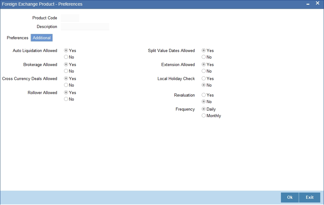

Preferences are the attributes or terms defined for a product that can be changed for a deal involving the product. By default, an FX deal acquires the attributes defined for the product to which it belongs.
However, the attributes that are defined as the product’s “preferences” can be changed for a deal. To invoke the ‘Preferences’ screen click ‘Preferences’ button.
You can define the preferences for a product in the ‘FX Product Preferences’ screen. The following are the preferences that you can define for a product.
The product for which you are maintaining preferences is defaulted here.
Description
The description of the product is displayed here.
Option Date Allowed
For a product, you can indicate whether an Option Date can be specified for forward deals during deal processing. If you specify an option date, then you can change the contract value date to any date between the option date and the original value date, This means that the contract may be liquidated anytime between the option date and the value date of the contract.
To allow an option date, check this box.
However, if you have allowed an option date for a product, you need not necessarily enter an option date during deal processing.

Foreign exchange deals can be liquidated automatically or manually. In the ‘Product Preferences’ screen, you can indicate whether the mode of liquidation of deals, involving a product, is
If you specify the automatic mode of liquidation, deals involving the product will automatically be liquidated on the Settlement Date during the Beginning of Day processing (by the Automatic Contract Update function).
If you do not specify auto liquidation for a product, you have to give specific instructions for liquidation, through the ‘Manual Liquidation’ screen, on the day you want to liquidate a deal.
Note
If the Value Date of a deal is a holiday, the deal will be liquidated depending on your specifications in the Branch Parameters table. In this table
You can specify whether foreign exchange deals, involving the product that you are defining, can be rolled over into a new deal if it is not liquidated on its Value Date.
If you specify that rollover is allowed for the product, it will apply to all the deals involving the product. However, at the time of processing a specific deal involving the product, you can choose not to rollover the deal.
If you specify that rollover is not allowed for a product, you cannot rollover a deal involving the product.
When a contract is rolled over, the terms of the original contract will apply to the new contract. If you want to change the terms of a rolled over contract you can do so during contract processing.
Note
The rolled over contract will retain the reference number of the original contract.
For a product, you can indicate whether the Value Date (settlement date) of the Bought and Sold legs of FX deals, linked to the product, can be different.
If you select Yes, you can specify different value dates for the Bought and the Sold legs of the contract during deal processing. However, deals with the same Value Date can also be entered for the product.
If you select No, the Value Date (settlement date) should be the same for both legs of the deal.
You can choose to allow extension of the Value Date of FX deals involving a product.
If you disallow the extension of value dates for a product, you cannot extend the Value Date of deals involving the product.
Local Holiday Check
After you have specified all your preferences in this screen, click on ‘Yes’ button to store them in the system. Click on ‘No’ button if you do not want to store your preferences in the system.

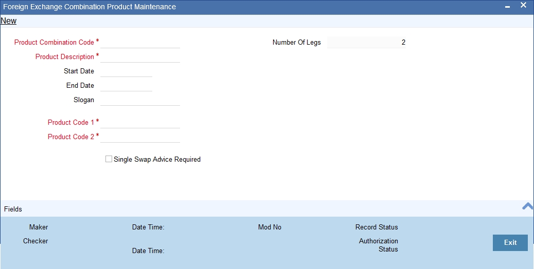

A swap deal is usually a combination of two foreign exchange contracts. These contracts could be Spot - Forward or Forward - Forward contracts. It involves a simultaneous buying and selling of currencies, wherein, the currencies traded in the first deal are reversed in the next.
A swap deal would be defined in Oracle FLEXCUBE as a Product Combination - that is, involving two different products (a particular spot or forward product and another spot or forward product).
A swap deal is, in effect, a combination of two foreign exchange contracts. These contracts could be

You can define products that are a combination of two other products through the ‘Foreign Exchange Combination Product Maintenance’ screen.
You can invoke the ‘Foreign Exchange Combination Product Maintenance’ screen by typing ‘FXDPRDCO’ in the field at the top right corner of the Application tool bar and clicking on the adjoining arrow button.
You can enter the following details relating to FX Product Combination Definition
Product Combination Code
In this field, you should specify the code by which the product combination is identified in the system. If you are defining a new product combination, enter a new code in this field. You can define a product that is a combination of two different products.
Description
Enter a description for the product.
Start Date
You can create a product such that it can only be used over a particular period. The starting date for this period should be specified in this field. The system defaults to today’s date. Enter a date that is the same as, or later than, today’s date.
End Date
You can create a product that it can only be used over a particular period. The End Date of this period is specified in this field.
Number of Legs
This field identifies the number of contract legs that can be defined under this product combination. The system defaults to a value of two legs. This cannot be changed.
Slogan
This is the marketing punch line for the product. The slogan that you enter here will be printed on the mail advices that are sent to the counterparties who are involved in deals involving the product.
Product Code 1
If the product is a combination of two other products, each leg of the deal corresponds to one product in the combination. Specify which product corresponds to which leg in the ‘Product Combination’ screen. For deals involving such a product, select the product for the first leg of the deal.
Product Code 2
Select the product for the second leg of the deal.
Single Swap Advice Required
Even if you have specified swap advices for both products in a combination, you can generate a single swap advice by choosing this option.
