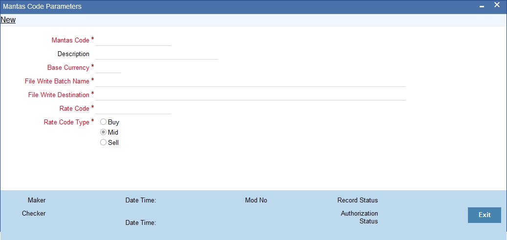

You can capture the details specific to the Mantas installation in the ‘Mantas Code Parameters’ screen.
You can capture the following details in this screen:
Mantas Code
Specify the Mantas Code which identifies the Mantas instance to which the Oracle FLEXCUBE physical instance is mapped.
Description
Specify the description for the Mantas installation.
File Write Destination
Specify the pre-defined destination, where Oracle FLEXCUBE will place the hand-off file. Mantas will pick up the hand-off file from this destination.
File Write Batch Name
Specify a pre-defined name for the file batch which will be a part of the hand-off file name.
Note
This pre-defined string should be unique across all Mantas codes to which the bank is handing-off files.
Base Currency
Select the base currency into which the amount involved in a transaction has to be converted to be sent to the hand-off files.
Note
There can be only one base currency associated with a Mantas Code.
Rate Code
The rate codes are maintained by Oracle FLEXCUBE for a base and reporting currency pair. Select the Rate Code to be used for the base and reporting currency conversions.
Rate Code Type
Select the Rate Code Type that specifies if it is a Buy rate, Sell rate, or Mid rate. This will also be used in the base and reporting currency conversions.

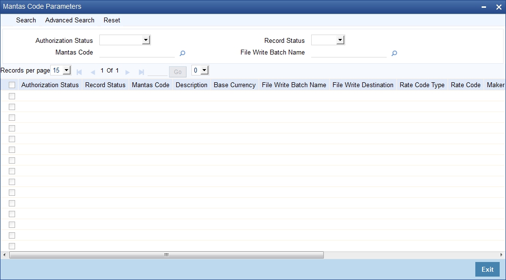

You can view the Mantas code parameter details in ‘Mantas Code Parameters Summary’ screen. To invoke this screen type ‘IFSMTSCDI’ in the field at the top right corner of the Application tool bar and click the adjoining arrow button.
In this screen, you can query based on any combination of the following fields:
After specifying the parameters for the query, click ‘Search’. The system displays all the records matching the parameters specified.

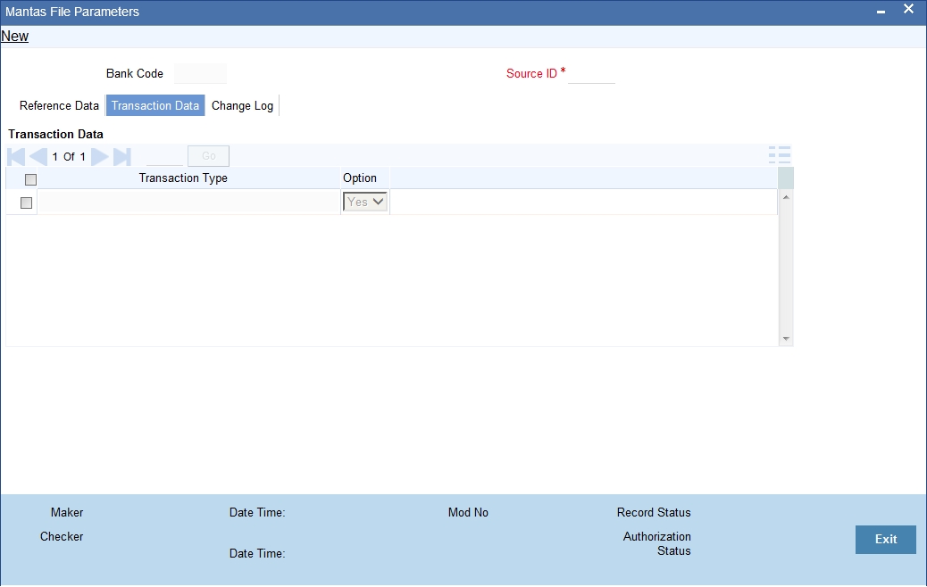

Transaction data file parameterization provides the bank an option to choose the type of transactions to be included in the transaction hand-off files.
You can specify the following details here:
Transaction Type
The different transaction types with the corresponding modules, which qualify for hand-off, are listed out.
Option
You can specify whether you want to include or exclude a particular transaction type for the hand-off.

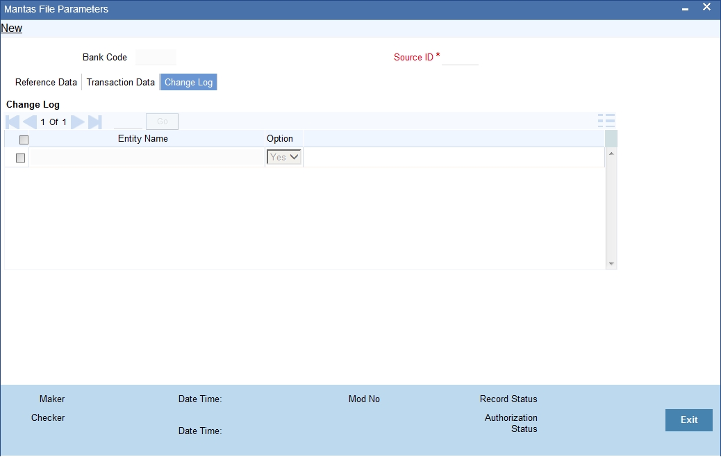

Change Log file consists of modified data of specific fields relating only to Account, Account Address, Customer, and Account to Customer entities. Change Log parameterization provides the bank an option to include or exclude an entity in the Change Log hand-off file.
Entity
The list of the entities which qualify for hand-off, are displayed.
Option
You can specify whether you want to include or exclude a particular entity for the hand-off.

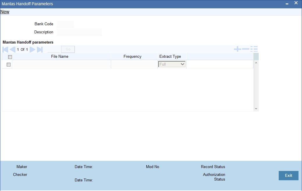

Frequency and hand-off type parameterization provides the bank the option to choose the frequency and the type of hand-off. This option is available only for the hand-off files related to Reference Data.
Note
Frequency and/or hand-off type parameterization will not be available for Change Log and Transaction hand-off files.
You can specify these details in the ‘Mantas Handoff Parameters’ screen.
You can invoke the ‘Mantas Handoff Parameters' screen by typing 'IFDMTSFH' in the field at the top right corner of the Application tool bar and clicking the adjoining arrow button.
Bank Code
The Bank Code is defaulted from the Bank maintenance.
File Name
This is the name of the hand-off data file. All the hand-off files related to Reference data type are displayed.
Frequency
This is the handoff frequency type. The frequency value will be displayed as ‘As Needed’ for the Country and AccountCustomerRole files. All the other files will have the frequency set as Daily.
Extract Type
Specify the type of extract for the handoff, indicating whether a file is to be sent as Full or Incremental.
For files with frequency specified as “As needed”, the extraction type will always be Full. A Full extraction takes place only if any modification happens to the data. If there are no modifications for a day, no file will be handed off for that day. For all other frequencies, an empty file would be handed off for the day, if there is no data for hand-off.

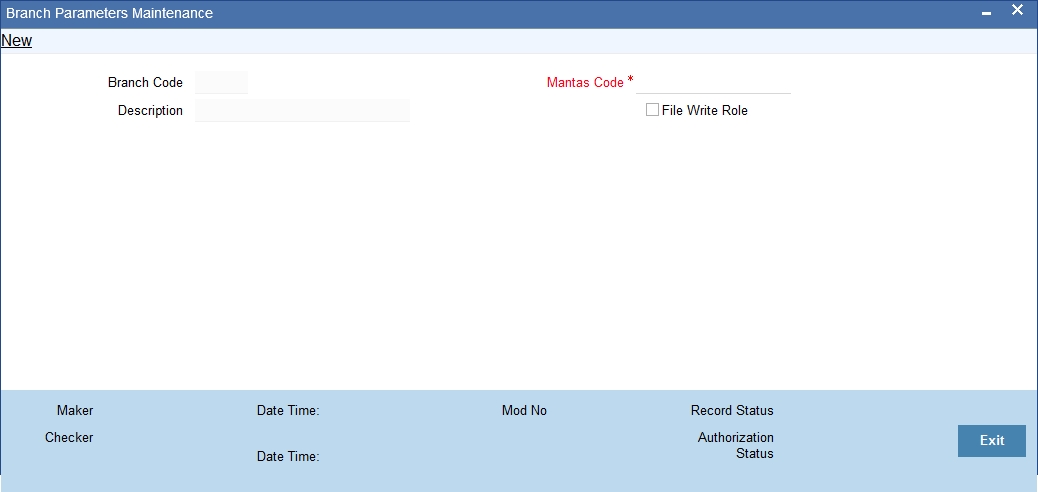

Every branch of a bank extracts the reference and the transaction data for itself and writes the data into a data store, as one of its mandatory pre-EOD programs. Only one branch will be designated to write the hand-off file on behalf of all the other branches and itself, for a particular Mantas code. The Extraction and the File Write roles can be assigned to the branches using the ‘Mantas Branch Parameters’ screen.
You can invoke the ‘Mantas Branch Parameters' screen by typing 'IFDMTSBR' in the field at the top right corner of the Application tool bar and clicking the adjoining arrow button..
You can specify the following details in this screen:
Branch Code
The Branch Code will be defaulted from the logged in branch.
Description
The description for the branch is also defaulted from the Branch maintenance.
File Write Role
Check this option to specify that file write role should be designated to write the extracted data on behalf of all the other branches and itself..
Mantas Code
Select the Mantas Code corresponding to the branch, from the option list provided.

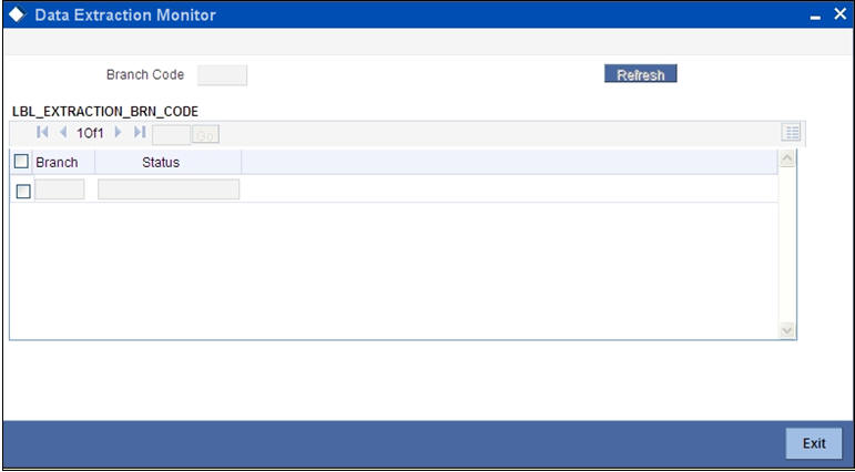

In the ‘Data Extraction Monitor’ screen, you can specify details pertaining to data extraction. To invoke this screen type ‘IFDMTSEM’ in the field at the top right corner of the Application tool bar and click the adjoining arrow button.
You can specify the following details:
Branch Code
Select the branch code which has got the file write role from the list of options.
Click ‘Refresh’ button to view the extraction status pertaining to the branch. The status will be ‘C’ or ‘N’ which indicates the ‘completed’ and ’not completed’ status of data extraction.
