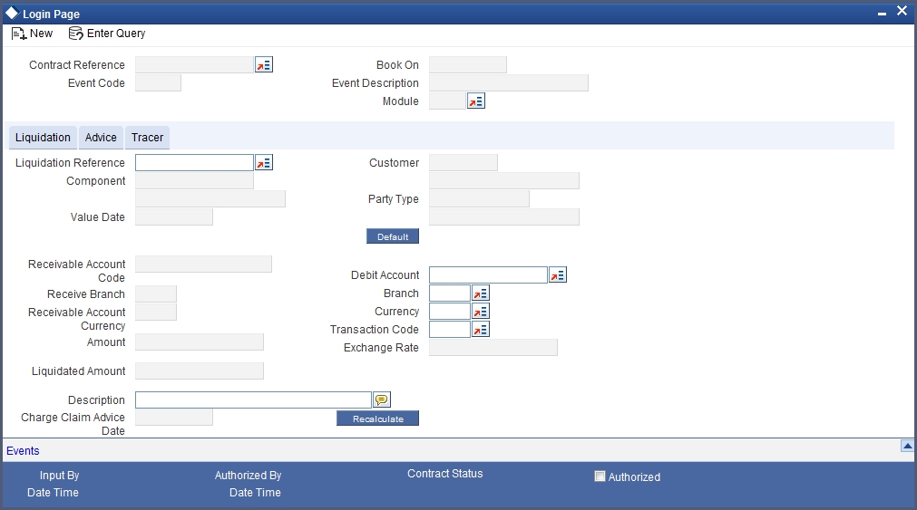

You can pass manual entries into LQ Module to maintain additional entries into AR/AP LQ Module in the ‘Receivable/Payable Online’ screen. You can invoke ‘Receivable/Payable Online’ screen by typing ‘LQDTRONL’ in the field at the top right corner of the Application tool bar and clicking the adjoining arrow button.
For further details on generic attributes that you can define for liquidation of an LC contract, please refer the ‘Liquidation’ User Manual under Modularity.
Once you enter the reference number of the Islamic LC in the Receivable Liquidation screen, the system automatically assigns a unique liquidation reference number to the component you are liquidating. Besides this, the following details of the Islamic LC are picked up and displayed:
You can specify the following details for the Liquidation:
The outstanding components of an Islamic LC are displayed for each event. To liquidate an outstanding component, choose Liquidate by clicking ‘Processing’ on the application tool bar.
After the liquidation of an outstanding component, if there are other outstanding components for the event, the system will inform you of them and prompt you to liquidate them as well.

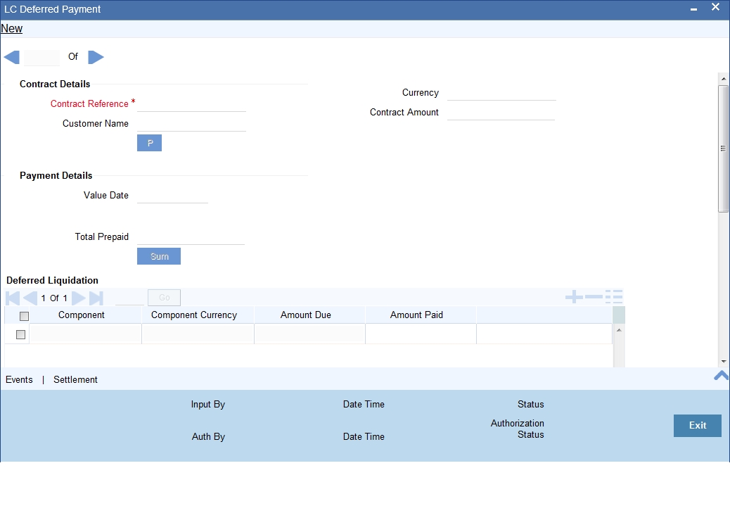

In order to perform manual liquidation of transferable charge and/or commission components to an Islamic LC, invoke the ‘Islamic LC Deferred Liquidation’ screen.
You can invoke this screen by typing ‘LIDEPMNT’ in the field at the top right corner of the Application tool bar and clicking the adjoining arrow button.
The outstanding commission and charge components can be liquidated using this manual liquidation screen.
During manual liquidation, you can opt to waive the receivable charge / commission amounts. No backdated value dates are allowed during manual liquidation of these components.
Reference Number
This displays the reference number of the Islamic LC being liquidated.
Contract Amount
This displays the total contract amount.
Contract Currency
This displays the currency of the contract.
Customer
This displays the customer information.
Value Date
The value date is defaulted to the application date and the same cannot be modified.
Total Paid
This displays the total amount to be paid against liquidation of the Islamic LC.
The total amount due for the commission and charge components till date is displayed by the system during payment as the payment breakup, inclusive of the details of each component.
Upon complete liquidation of the component, the system updates the status of the component from Receivable to Liquidated. The amount liquidated is also updated in the receivable component details.
The accounting entries maintained in ‘MLIQ’ event are passed for the amount paid.
During manual liquidation of charges the system allows waiver of certain components. When the waiver option is selected, the system defaults the amount paid as the amount due and does not allow modification of the same for the component.
Upon waiver, the system marks the component in the Islamic LC as liquidated, internally. Waivers are processed in the system as a new event initiated along with the MLIQ event.
