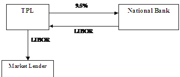

The resultant swap after exercise of the swaption, along with the impact of the market borrowing, is diagrammatically shown as follows:

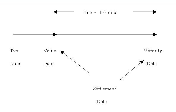

Interest period
The interest period or the contract period is the duration for which the underlying interest rate is to apply and is the tenor basis on which the settlement amount is computed. This is the period between the value date and the maturity date. In the previous example, the interest period is between July 01 and December 31, 2003.
Value date / Effective date
This is the business day which is the first day of the interest period. In the previous example, July 01, 2003 is the value date.
Maturity date
This is the last day of the interest period. In the previous example, December 31, 2003 is the maturity date.
Settlement date
This is the date on which the settlement is effected. The settlement date can either be the value date (for deals settling in advance) or the maturity date (for deals settling in arrears).
Fixing date / Strike date / Exercise date
This is the date on which the strike and reference rates (both are defined later in this document) are compared and the settlement amount is arrived at. This is usually either the same date as the value date or a couple of days prior to the value date.
The above dates are depicted in the figure given below:
