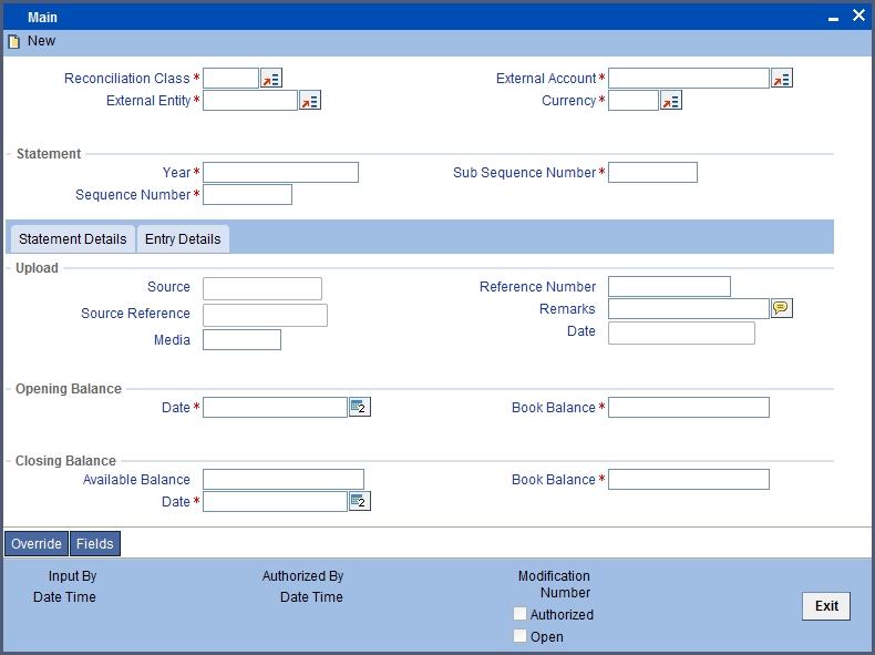

Through the upload facility you can automatically upload statements that have come in for a reconciliation class + external entity + account + currency combination. To upload an external statement into the nostro subsystem, you should:
The details of an uploaded statement will be automatically displayed in the relevant fields of External Statement Input screen.

You can invoke the ‘Reconciliation External Statement Input’ screen by typing ‘REDSTMIN’ in the field at the top right corner of the Application tool bar and clicking on the adjoining arrow button.
Indicating the Upload Source
To upload an external statement from a source external to Oracle FLEXCUBE you should indicate the code assigned to the source from where the message should be uploaded.
Indicating Details of the External Statement
The details of an external statement that you should specify are as follows:
