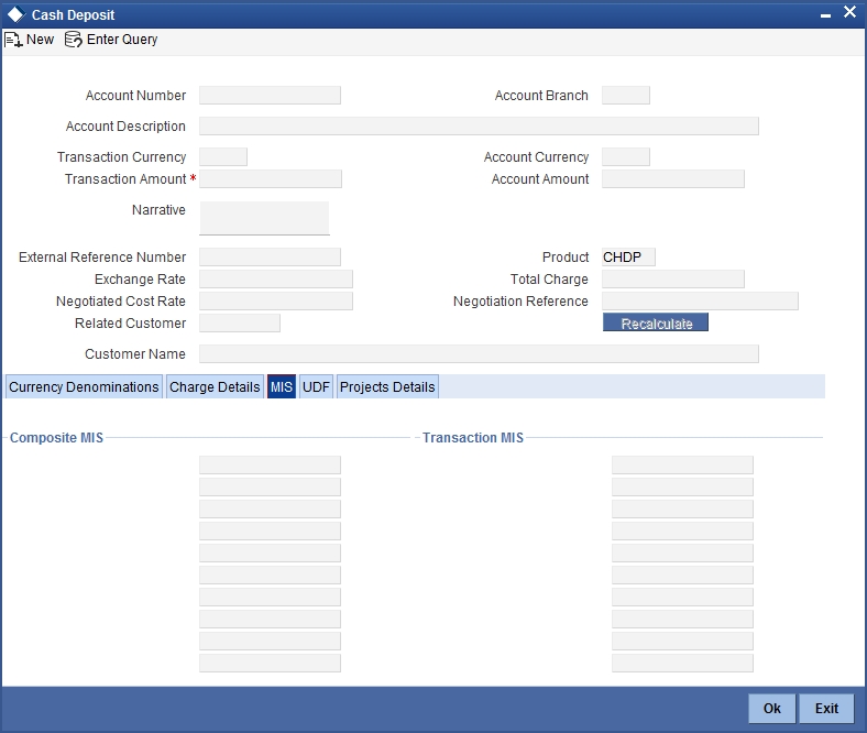

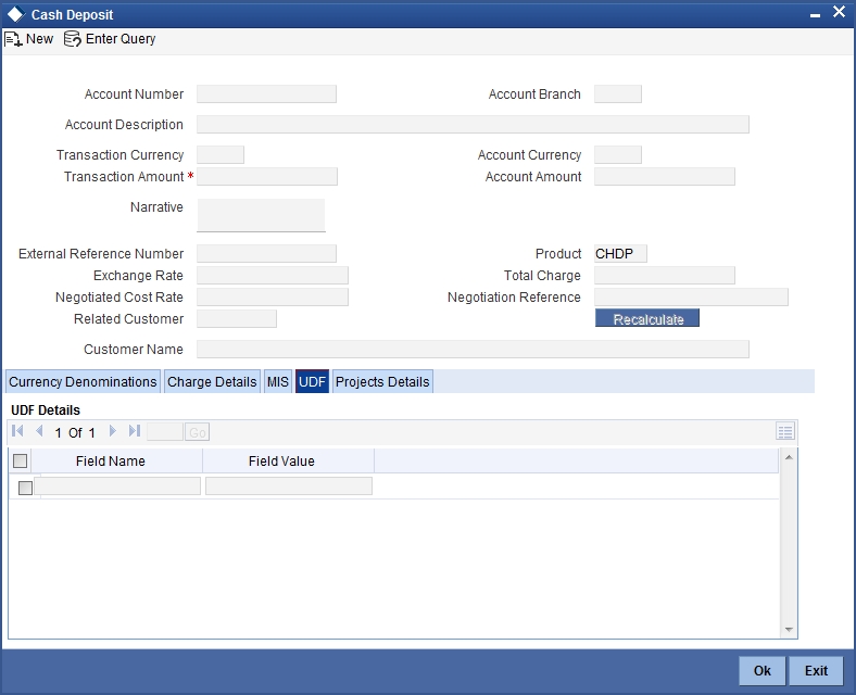

You can capture a cash deposit transaction through the ‘Cash Deposit’ screen. You can invoke this screen by typing ‘1401’ in the field at the top right corner of the Application tool bar and clicking on the adjoining arrow button.
The cash deposit can be done in single step or two step process. The single step process is the single screen approach. For the single step cash deposit, the teller accepts the cash and accounting entries are passed in a single step. In two step process, the teller just collects the information and posts the transaction where no accounting entries are passed. The cashier accepts the cash and then the accounting entries are passed in the second step.
You can also specify Virtual Accounts in this screen. These virtual accounts can be used as a routing account to credit the underlying physical account.
If a virtual account number is specified in this screen, then the F10, F11, and F12 keys will not display any value, however the following error messages will be displayed for each of these keys:
Click the OK button and you will be able to proceed further with the transaction.
Here the teller can capture the following details:
Account Number
Physical Account Number:
Specify the customer account number into which the cash needs to be deposited. You can also select an account number from the list displayed by clicking on the adjoining option list.
Note
In case of multiple accounts with the same account number, the system will display a list of corresponding account branches to select.
To view the joint holder’s details of an account and the mode of operation maintained at the account level, place the cursor on the Account Number field and press Ctrl+J. The system displays the ‘Joint Holder’ screen.
For more information on the ‘Joint Holder’ screen refer to the section ‘Joint Holder Maintenance’ in the Core User Manual.
Virtual Account Number
You can also specify a virtual account number in this field. The physical account number is identified based on the Virtual Account Number and Account Currency combination. If there is no physical account available for the combination, then the default physical account number is selected. The account currency changes as per the default physical account number.
Account Branch
The system displays the logged-in branch. If you specify another account number and tab out of the Account Number field, the system displays the corresponding account branch.
Account Description
The system displays the description of the account number chosen.
Transaction Currency
The system displays the local currency. If you specify another account number and tab out of
the Account Number field, the system displays the currency associated with the specified account.
Account Amount
The system displays the transaction amount in terms of account currency.
Total Charge
The system computes the charges applicable for the transaction and displays it here.
Net Account Amount
The system displays the net amount to be credited to the account (in the account currency) after calculating the applicable charges. This amount depends on the charge method – whether inclusive or exclusive.
Related Customer
The system displays the related customer.
Customer Name
The system displays the customer name.
Account Currency
The system displays the currency associated with the account.
For a Virtual Account, the transaction currency is defaulted as the account currency. The physical account number is identified based on the account currency and virtual account number combination. If physical account number is available then the transaction currency remains the same.
If the physical account number is not available, then the default physical account number is selected and the transaction currency changes as per the default physical account number. The account currency changes according to the default physical account number.
Transaction Amount
Specify the amount that should be credited to an account in terms of transaction currency. If the account to be credited is a Trust account, this amount should be within the cash deposit limit defined for the credited account class.
Pickup
Click on pickup to default the data into the Denominations, Charges, MIS, UDF and Project details. It is mandatory to click on ‘Pickup’ button before save.
Exchange Rate
The system displays the exchange rate used to convert the transaction currency into account currency. If the transaction currency is the same as the account currency, the system will display the exchange rate as ‘1’.
Negotiated Cost Rate
Specify the negotiated cost rate that should be used for foreign currency transactions between the treasury and the branch. You need to specify the rate only when the currencies involved in the transaction are different. Otherwise, it will be a normal transaction.
Negotiation Reference
Specify the unique reference number that should be used for negotiation of cost rate, in foreign currency transaction. If you have specified the negotiated cost rate, then you need to specify the negotiated reference number also.
Note
Oracle FLEXCUBE books the online revaluation entries based on the difference in ex­change rate between the negotiated cost rate and transaction rate.
Token Number
Specify the token number.
Narrative
The system displays ‘Cash Deposit’. You can modify it, if required.
The system generates the advice on click of ‘OK’ button or save after providing all the details.
External Reference Number
The system generates a unique number based on the branch-specific sequence number generation logic and displays it here. The Host system identifies a branch transaction with the external reference number.
Note
You can generate a transaction slip by clicking on ‘Generate’ button after providing ac­count number, transaction amount and clicking on pickup button. It is produced to the cus­tomer to sign and confirm the transaction.
Note
When Duplicate Advice Tracker field is checked and you click the EXIT button on the ad­vice generation screen, the system displays a message “Print Successful?”. Click OK but­ton to confirm the successful printing. Every subsequent print of the advices will be considered as duplicate advice. For more information on Duplicate Advice Tracker refer to section “Messaging Branch Parameters Maintenance” in the Core User Manual

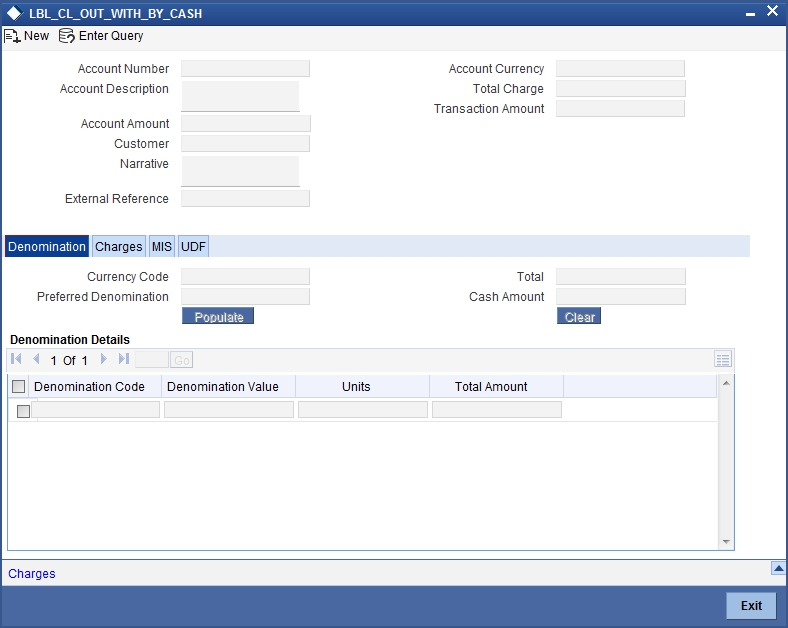

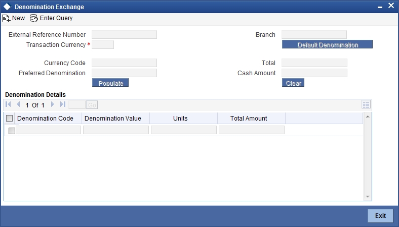

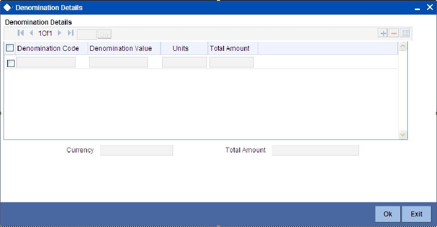

7.2.2 Specifying denomination details
In this block, you can capture details of the currency denominations involved in the transaction through the following fields:
Currency Code
The system displays the currency of the account.
Cash Amount
The system displays the amount for which the denominations have to be captured.
Preferred Denomination
Specify the preferred denomination.
Denomination Total
The system displays the total denomination.
Denomination Details
Denomination Code
For every currency, the various denominations are assigned separate denomination codes. These codes are displayed here.
Denomination Value
The system computes the face value of the denomination and displays it. For instance if the denomination code represents a USD 100, the value will be displayed as ‘100’.
Units
Indicate the number of units of the specified denomination. By default, till contents are incremented for inflow transactions like cash deposit. To reverse this default behaviour, you can specify units in negative.
Total Amount
The system computes the denomination value by multiplying the denomination value with the number of units. For instance, if the denomination code represents a USD 100 and the number of units is 10, the denomination amount will be ‘1000’.
Click ‘OK’ to validate the denominations with the cash amount. If you click on ‘Cancel’ then the data specified will not be available.

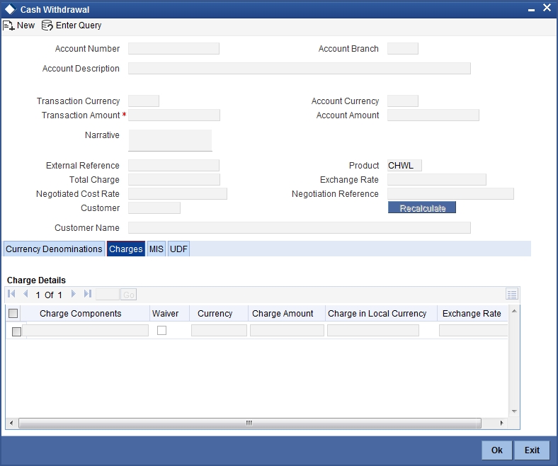

7.2.3 Specifying charge details
This block allows you to capture charge related details. Click on ‘Charges’ button to invoke the following screen.
Here you can capture the following details:
Charge Component
The system defaults the charge components applicable to the transaction.
Waiver
You can waive a certain charge for the customer by checking this box against the charge component.
Currency
The system displays the currency in which the charge has to be deducted.
Charge Amount
The system displays the charge amount to be deducted for the corresponding charge component. You can edit the amount.
Charge in Local Currency
In case the transaction currency is different from the local currency, the system will compute the local currency equivalent of the charge and display it here.
Exchange Rate
The exchange rate used for the currency conversion is displayed here. If the charge currency is the same as the transaction currency, the system will display ‘1’ as the exchange rate.
7.2.3.1 Recalculating charges
You can modify the charges by clicking on the charges button. You can edit the charge amount and Click “OK” button. The system displays the new charges in the main screen against ‘Total Charge’, which subsequently updates the changes in ‘Net Account Amount’ too.

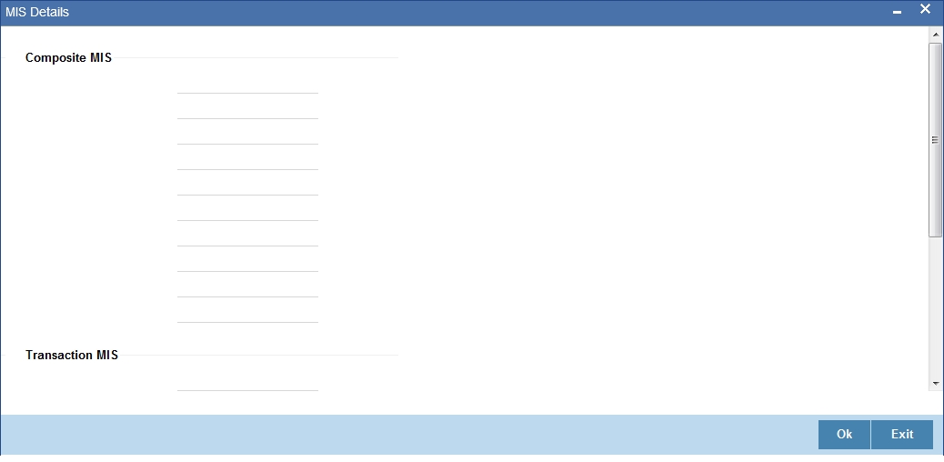

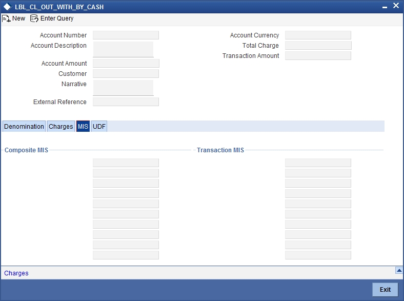

7.2.4 Specifying MIS details
This block allows you to capture details pertaining to MIS. Click on the ‘MIS’ button to invoke the following screen:
This block allows you to capture details pertaining to MIS. Click on the ‘MIS’ tab to capture the following details:
Transaction MIS
Specify the transaction MIS code.
Composite MIS
Specify the composite MIS code.
Refer the ‘MIS’ User Manual of Oracle FLEXCUBE Host, for further details about MIS.

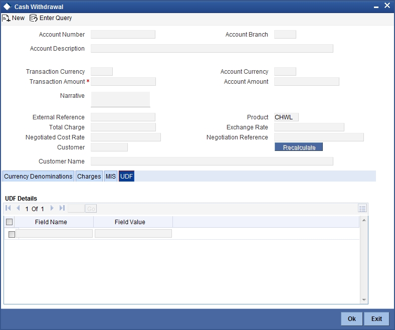

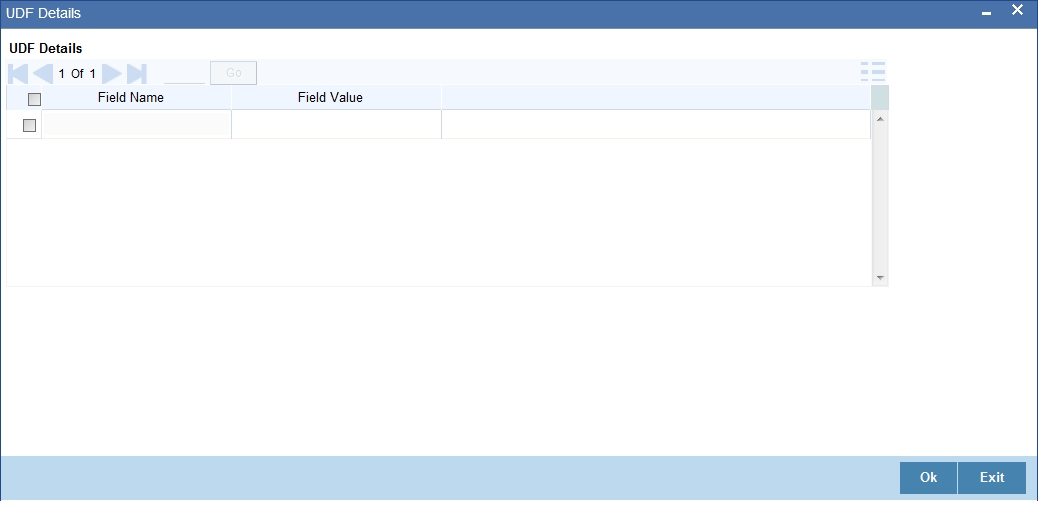

7.2.5 Specifying UDF Details
You can capture the UDF details under ‘UDF’ button.
Field Name
The system displays the various User-Defined Fields (UDFs) that you have maintained for the product in the Host.
Field Value
Specify the value for the each UDF that is displayed.

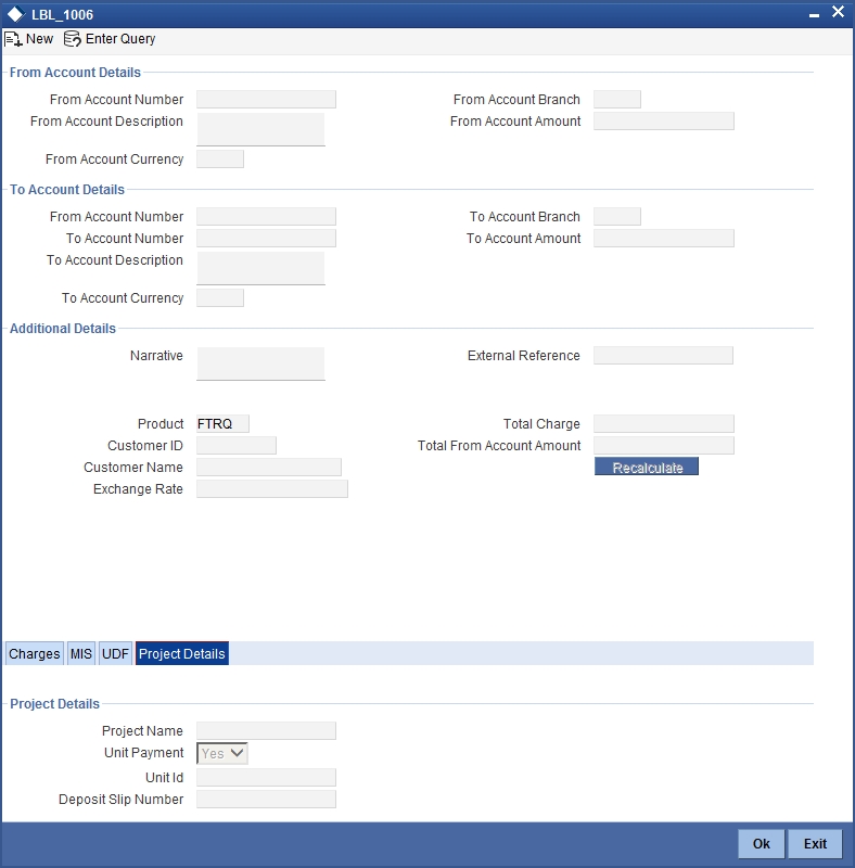

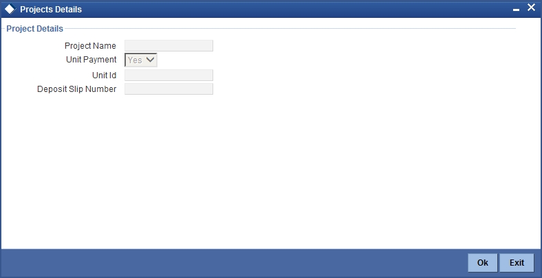

7.2.6 Specifying Project Details
You can capture project details under ‘Project Details’ button. Note that this button will be applicable only if the cash is being deposited in a Trust account.
Specify the following details:
Project Name
Specify the developer project name for which payment is being made. The adjoining option list displays all valid projects maintained in the system. You can select the appropriate one. Input to this field is mandatory.
Unit Payment
Indicate whether the transaction is a unit payment or not by choosing the appropriate value from the adjoining drop-down list. The following values are available:
Unit ID
Specify the unit ID of the project. This field will be enabled only if you have selected ‘Yes’ against ‘Unit Payment’. The adjoining option list displays all unit IDs along with the unit holder names corresponding to the project name chosen. You can select the appropriate one.
Deposit Slip Number
Specify the deposit slip number for the payment.

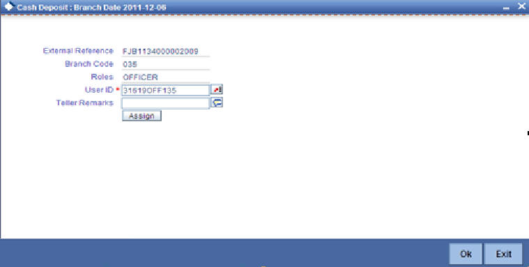

Click save icon to save the transaction. On saving, the system checks whether the account to be credited is a Trust account or not. If it is a Trust account, the system will check whether the deposit amount is within the deposit limit maintained for the transaction currency at the account class level. If the currency-wise limit has not been maintained, it will verify the deposit amount against the deposit limit maintained for the account class. If the deposit amount exceeds the limit, it will display an error message.
Note

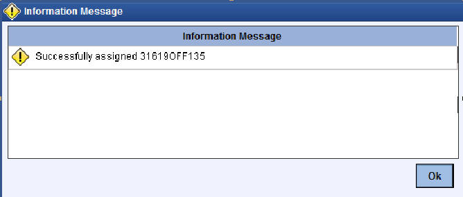

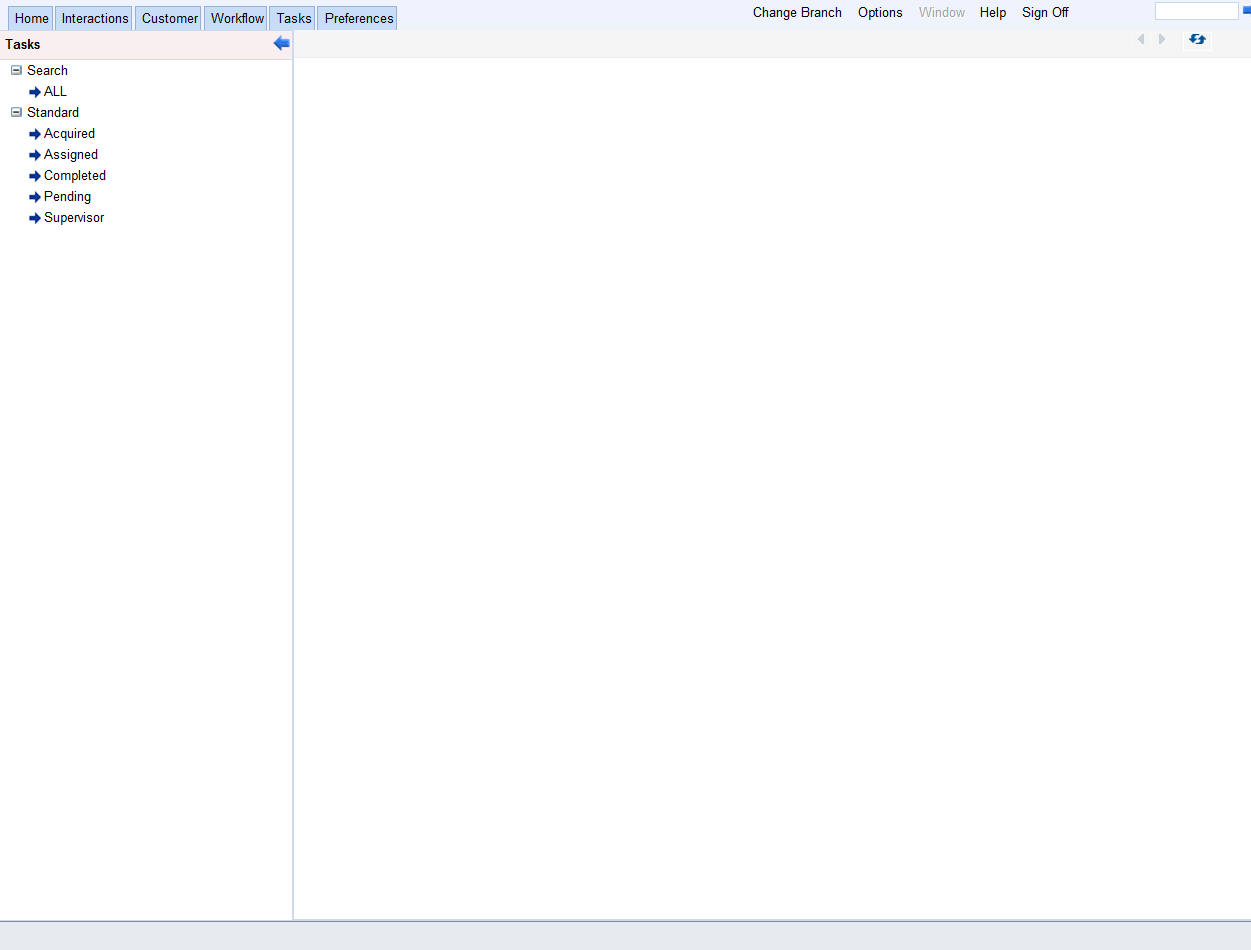

The supervisor can view the transactions pending authorization in his or her task list as shown below. You can view this list by choosing the ‘Workflow’ option in the application.
The person needs to click on the ‘Assigned’ option to view all transactions assigned to you.
In case of auto assign, the transaction will get assigned to all the eligible authorizers as per the assignment criteria maintained at your branch. All these eligible supervisors will be able to view these transactions in their ‘Pending Tasks’ lists. The first authorizer to fetch the transaction from his or her task list will lock the same and then can either approve or reject it. This process is similar to the remote authorization flow described earlier. You can view the tasks that are approved by other supervisors in the ‘Approved’ lists and also you can view the history of authorization in the ‘Auth-History’ lists.
Irrespective of the supervisor’s action (approve or reject), the transaction will be re-assigned to the maker.
You can fetch and see the response from your task list.

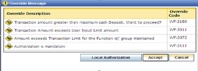

When overrides are raised by the system and have to be approved, the teller will have the option to choose between remote and local authorization. By default remote authorization will be selected. If the teller wants local authorization then the choice has to be made explicitly.

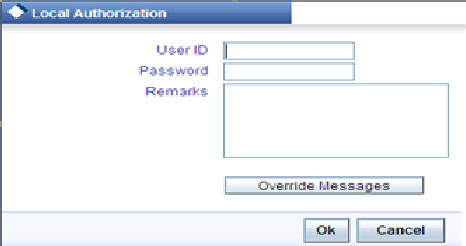

7.2.7.1 Local Authorization
In case of local authorization, the authorizer can allow or cancel the transaction. The following screen is used for local authorization:
The authorizer can only view the transaction details here. He or she will have to enter the following details:
User Id
Specify the user ID of the authorizer.
Password
Specify the password with which he or she can either authorize or reject the transaction.
Remarks
The authorizer can specify some remarks pertaining to the transaction.
Click ‘OK’ button to authorize the transaction. On successful validation of the User ID and password, the transaction will proceed to the next stage as per workflow. The validations for User ID will be same as in Remote Auth. The user credential validation includes ‘Holiday Maintenance’ check also. However, if you click ‘Cancel’ button, the transaction will move to unassigned queue.
You can view the override messages by clicking ‘Override Messages’.
Note
Local Authorization option is not available when user authentication is via Single Sign On (SSO).

7.2.8 Viewing errors and overrides
You can view overrides for the transaction by clicking on the ‘Override Messages’ link on the ‘Remote Authorization’ screen. You need to click on ‘OK’ to close the ‘Overrides’ window and then take appropriate action on the main screen.

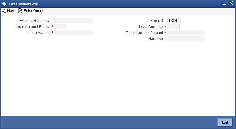

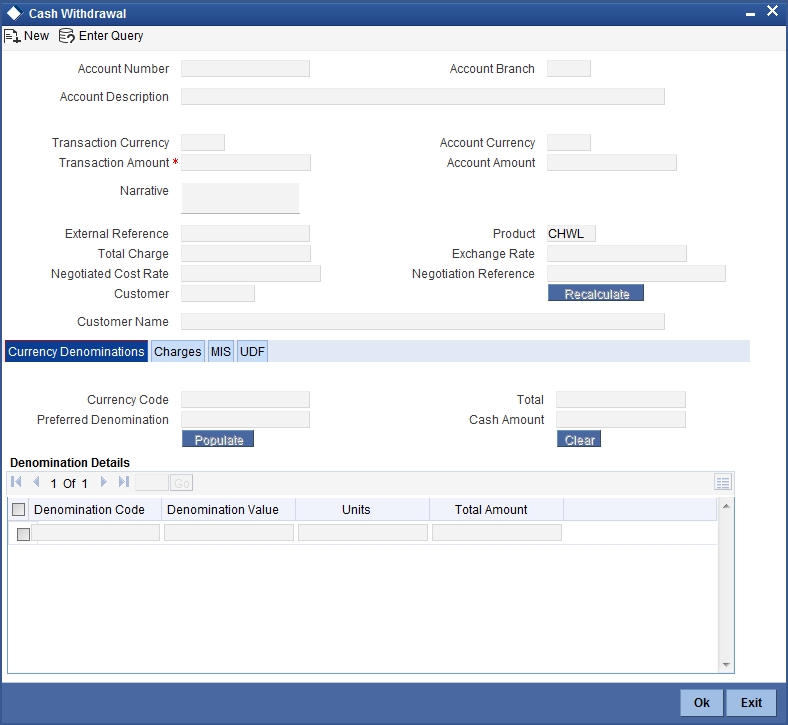

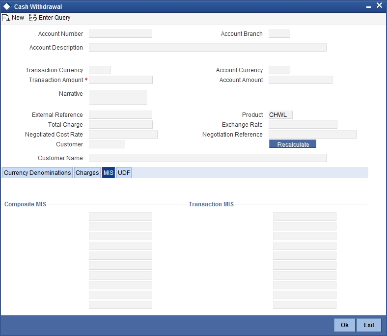

7.3 Withdraw Cash
7.3.1 Withdrawing Cash
You can capture a cash withdrawal transaction through the ‘Cash Withdrawal’ screen. You can invoke this screen by typing ‘1001’ in the field at the top right corner of the Application tool bar and clicking on the adjoining arrow button.
Note
When you press the ‘Tab’ key, you can move from one field to another based on the order of field alignment. The cash withdrawal can be done in single step or two step process. The single step process is the single screen approach. For the single step cash withdraw­al, the teller disburses the cash and accounting entries are passed in a single step. In two step process, the teller just collects the information and posts the transaction. In the first step accounting entries will be passed where the customer accounts will get debited. The cashier accepts the cash and then the accounting entries are passed in the second step. In two step process accounting entries will be passed in steps 1 and 2.
Account Number
Specify the customer account number into which the cash needs to be deposited. Upon keying the account number, the system will default the Account Number, Account Branch and Account Currency for the corresponding account.
Note
In case of multiple accounts with the same account number, the system will pop-up a list of account numbers with account branch to select.
Account Branch
Account Description
The system displays the local currency. If you specify another account number and tab out of the Account Number field, the system displays the currency associated with the specified account.
Account Currency
Transaction Amount
Specify the amount that should be debited from account in terms of transaction currency. If the account to be debited is a Trust account, this amount should be within the cash withdrawal limit defined for the debited account class.
Pickup

Token No
Narrative
The system displays ‘Cash Withdrawal’. You can modify it, if required.
Click OK button or save after providing all details to generate advice with token number.
The system generates a unique number based on the branch specific sequence number generation logic and displays it here. The Host system identifies a branch transaction with the external reference number.
Account Amount
You can generate a transaction slip by clicking on ‘Generate’ button after providing account number, transaction amount and clicking on pickup button. It is produced to the customer to sign and confirm the transaction.
7.3.2 Specifying Denomination Details
In this block, you can capture details of the currency denominations involved in the transaction.
Specify the denomination code that should be preferred. The system processes the transactions with the preferred denominations. If the transaction amount is less than the preferred denomination, the system will use the low valued denomination than the preferred denomination based on the defaulting rule.
If the preferred denomination is not captured, the system will consider the highest available denomination as the preferred denomination.
If the denomination is not available, the system will display ‘Denomination not available’ message.
Click ‘Populate’ button to display the units of currency denomination based on the defaulting rule.
Note
Refer the section titled ‘Specifying denomination details’ under ‘Depositing Cash’ for further details.
7.3.3 Specifying charge details
This block allows you to capture charge related details. You need to click on the ‘Charges’ button to invoke the following screen.
Refer the section titled ‘Specifying charge details’ under ‘Depositing Cash’ for further details.
7.3.4 Specifying MIS details
Refer the section titled ‘Specifying MIS details’ under ‘Depositing Cash’ for further details.
7.3.5 Specifying UDF Details
Refer the section titled ‘Specifying the UDF details’ under ‘Depositing Cash’ for further details.
7.3.6 Specifying Project Details
Project Name
Unit Payment
Unit ID
Deposit Slip Number
Click save icon button to go to the next stage. The authorization process is similar to cash deposit.

7.3.7 Cash Withdrawal in Two Step Processing
During two step processing, the two step role needs to be defined at workflow level.
Role of Teller
The customer approaches the teller for cash withdrawal. The teller collects the details from the customer and maintains the details like transaction account and transaction amount, and clicks on ‘Pickup’ button and generates the advice by clicking ‘Generate’ button. It is not mandatory for the teller to specify the denomination as cash is handed over to customer by the cashier. The system validates the total denomination amount with cash amount and does not update the till of the teller irrespective of till being open or closed. The accounting entries are passed at this stage. It is not mandatory for the teller to open the till at step 1.
The teller role is performed by CHWL.
Accounting Entry:
Dr/Cr and Account
Amount
Dr Customer A/C
Txn amount + Charges
Cr Misc-credit GL
Txn amount
Cr Intermediary GL
Charges
Role of Cashier
The cashier picks the transaction from the pending queue which is saved by the teller. The customer is then called by referring to the token number available in the transaction. The cashier checks whether the denomination button has got the values by confirming with the customer. If the data persist in the button, the cashier will cross check with the physical denominations in hand. If respective denomination is not available then the cashier will make required changes in the denominations and click ‘OK’ and save the transaction. If the data is not available in the denominations tab, then the cashier should update the denomination details and save the record. The cashier’s till gets updated and accounting entries are passed.
The cashier role is performed by CHW2.
Accounting Entry:
Dr/Cr and Account
Amount
Dr Misc-Credit GL
Txn amount
Cr Cash GL
Txn amount
Dr Intermediary GL
Charges
Cr Income GL
Charges
Dr Income GL
Tax payable on Charge
Cr Tax payable GL
NSF is not applicable when the Charge debit account maintained under the charges tab is a GL.
Note
By default the cash deposit and cash withdrawal will follow the single screen approach.

In the single stage flow, if there is an transaction level override or error during approval then the transaction will be moved to the pending queue. Without save action being initiated, the transaction will not be in pending queue.

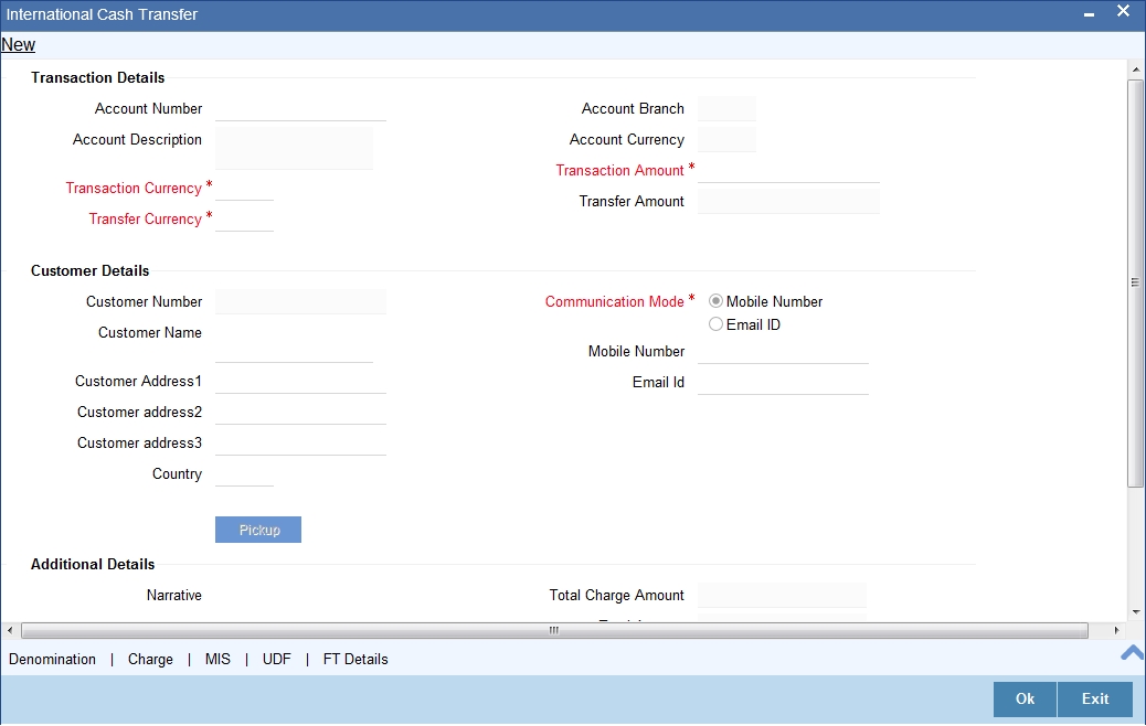

7.5 International Cash Transfer
7.5.1 Transferring Cash Internationally
Oracle FLEXCUBE facilitates international funds transfer by cash. A Walk in customer or an account holder of the Bank can perform the transfer by remitting cash in foreign currency.You can process International Cash Transfer for an account holder or for a walk-in customer, if the Product Code is defaulted as ‘CXTR’ and the FT Transaction check box is selected in the RT Product Preference (DEDRTPRM) screen.
You can process international cash transfer through the ‘International Cash Transfer’ screen. You can invoke this screen by typing ‘1406’ in the field at the top right corner of the Application tool bar and clicking on the adjoining arrow button.
You can specify the following details:
Transaction Details
Account Number
Specify the account number for the transaction. Alternatively, you can select the account from the option list. The list displays all valid accounts maintained in the system. In case of walk-in customer, this field is left blank.
Account Description
The system displays the description of the account number.
Account Branch
The system displays the branch of the main account of the transaction.
Account Currency
Specify the currency of the transaction. Alternatively, you can select the transaction currency from the option list. The list displays all the currencies maintained in the system.
Transfer Currency
Specify the transfer currency in which the amount has to be transferred. Alternatively, you can select the transfer currency from the option list. The list displays all the currencies maintained in the system.
If the customer wants the deposited FCY cash to be transferred in another currency to the Beneficiary account, you need to specify the transfer currency for FT transaction in the ‘Transfer currency’ field. The system converts the transaction amount into the transfer currency and credits it to the beneficiary account using the specified exchange rate.
Transaction Amount
Specify the transaction amount.
Transfer Amount
The system displays the transfer amount based on the transfer currency selected and the derived exchange rate.
Customer Details
Customer Number
The system displays the customer Id. If the customer number is a walk-in customer, the walk-in customer number maintained at the branch parameter level is defaulted.
Customer Name
The system displays the customer name. If the customer number is a walk-in customer, specify the customer name.
Note
If the customer is a Walk-in Customer, you can specify the customer name in the Customer Name field.
Customer Address1
Specify the first line of the customer address.
Customer Address2
Specify the second line of the customer address.
Customer Address3
Specify the third line of the customer address.
Country
Specify the country code of the ordering customer. Alternatively, you can select the country code from the option list. The list displays all the country codes maintained in the system.
Communication Mode
Select the mode of communication for the funds transfer. The options are as follows:
Mobile Number
Specify the mobile number of the customer. If you select the mode of communication as ‘Mobile Number’, it is mandatory to specify the mobile number of the customer.
Email ID
Specify the email Id of the customer. If you select the mode of communication as ‘Email ID’, it is mandatory to specify the email Id of the customer.
Additional Details
Narrative
Specify any remarks pertaining to the transaction.
Exchange Rate
The system displays the exchange rate, if the transaction currency and transfer currency are different. This exchange rate used to convert the transaction currency into transfer currency and derive the transfer amount.
Specify the negotiated cost rate that should be used for foreign currency transactions between the treasury and the branch. You should specify the rate only when the currencies involved in the transaction are different. Else, it will be a normal transaction.
Negotiated Reference
Specify the unique reference number that should be used for negotiation of cost rate, in foreign currency transaction. If you have specified the negotiated cost rate, then it is mandatory to specify the negotiated reference number.
Note
Oracle FLEXCUBE books an online revaluation entries based on the difference in ex­change rate between the negotiated cost rate and transaction rate.
Total Charge Amount
The system displays the total charge amount of the transaction in the transaction currency.
Total Amount
The system displays the total amount of the transaction. In case of walk-in customer, the total amount would be the total transaction amount with the applicable charges.
If the customer is a walk-in customer, the system displays the charges as the total amount. If the customer is an Account Holder, the system displays the transaction amount as the total amount.
The system displays the external reference number maintained in the system.
Click ‘Pickup’ button to populate the data such as total Amount, total charge amount in transaction currency, customer number, customer name, and address details. In case of walk-in customer, you need to enter the customer name, address, country code and communication mode. It is mandatory to click ‘Pickup’ button to populate the data in the Denomination, Charge, MIS, UDF and FT Details screens.
After clicking ‘Pickup’ button, if you modify the Transaction Amount, Transaction Amount Currency or Account then it is mandatory to click ‘Pickup’ button before saving the transaction.

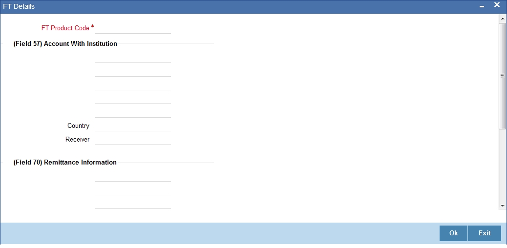

7.5.6 FT Details Button
You can capture Funds Transfer details in the ‘FT Details’ screen. Click the ‘FT Details’ button to invoke the screen.
You can specify the following details here:
FT Product
Specify the FT product code. The system allows only outgoing FT product codes to be specified. Alternatively, you can select the product code from the option list. The list displays all product codes maintained in the system.
(Field 57) Account with Institution
Specify the account with institution details. Alternatively, you can select the account from the option list. The list displays all accounts with institution details maintained in the system.
Country
Specify the country code. Alternatively, you can select the country code from the option list. The list displays all the country codes maintained in the system.
Receiver
Specify the receiver BIC code. Alternatively, you can select the code from the option list. The list displays all the receiver BIC codes maintained in the system.
(Field 70) Remittance Information
Specify the remittance information. Alternatively, you can select the remittance details from the option list. The list displays the remittance details maintained in the system.
(Field 59) Ultimate Beneficiary
Specify the ultimate beneficiary details. Alternatively, you can select the beneficiary from the option list. The list displays all the beneficiary maintained in the system.

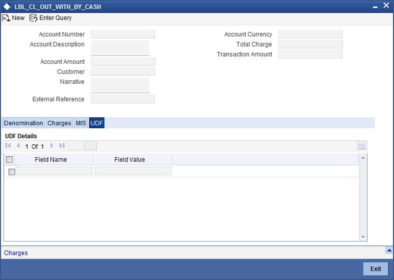

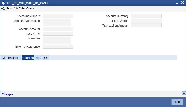

7.6 Close out Withdrawal by Cash
7.6.1 Closing out Withdrawal by Cash
You can capture a close out withdrawal transaction through the ‘Close Out Withdrawal by Cash’ screen. You can invoke this screen by typing ‘1301’ in the field at the top right corner of the Application tool bar and clicking on the adjoining arrow button.
Account Number
Specify the account number that needs to be closed. The adjoining option list displays all the accounts maintained in the Host. You can select the appropriate account number.
Account Branch
The current logged-in branch code is displayed here. However, you can modify it. Specify the branch where the customer account which needs to be closed resides.
Account Description
The system displays a brief description on the selected account.
Account Currency
The system displays the account currency here.
Account Amount
The system displays the available amount in the account.
Customer ID
The system displays the customer ID based on the account specified.
Narrative
The system defaults ‘Close Out Withdrawal by Cash’ here. However you can modify this.
External Reference
On clicking Pickup button, the system populates the vales in all the callforms of the screen and clicking pickup button is mandatory if you make any changes to the Transaction amount and exchange rate after first pickup.
Once you click ‘Pickup’ button once, then on amendment of xrate, amount, charge, pickup will be mandatory before save. On pick up, the fields that are currently enabled in the enrich stage will alone be retained as enabled fields.
Note
The Close out Withdrawal of Account transactions are processed without any change till the ‘Branch Available’ status is marked as ‘Yes’. If the branch available status is ‘No’ or branch date is ahead of host date, the transactions are not allowed.
Clicking ‘Pickup’ button, the system defaults the following details:

7.6.4 Specifying the UDF details
You can capture these details in the ‘UDF’ tab of the screen.
Specify the following details.
Field Description
The system will display all the User-Defined Fields (UDF) maintained for the product.
Field Value
Specify the value for the required UDFs.
Click save icon to save the transaction. The authorization process is similar to cash deposit.
Refer the corresponding section under ‘Depositing Cash’ for further details.

7.7.2 Specifying Denomination Details
You can capture denomination related details in this screen. Click ‘Denomination’ button to invoke this screen.
For more information on denomination details screen, refer to the section ‘Specifying denomination details’ in the chapter ‘Depositing Cash’ in this User Manual.
7.7.3 Specifying Charge details
You can capture charge related details in this screen. Click ‘Charge’ button to invoke this screen.
For more information on charge details screen, refer to the section ‘Specifying charge details’ in the chapter ‘Depositing Cash’ in this User Manual.
7.7.4 Specifying the MIS details
You can capture details pertaining to MIS. Click on the ‘MIS’ button to invoke the screen.
For more information on MIS details screen, refer to the section ‘Specifying the MIS details’ in the chapter ‘Depositing Cash’ in this User Manual.
7.7.5 Specifying the UDF details
You can capture the UDF details in the ‘UDF details’ screen. Click ‘UDF’ button to invoke this screen.
For more information on UDF screen, refer to the section ‘Specifying the UDF details’ in the chapter ‘Depositing Cash’ in this User Manual.
7.8 Exchanging Denominations
A customer may approach your bank to exchange currency denomination. That person may or may not be an actual bank customer (with a valid CIF or customer account). He or she may give you two notes of USD 50 each and ask for 10 notes of USD 10 each. This transaction involves only denomination exchange from your till. The total value in the till will remain the same. Hence there won’t be any accounting entries for this exchange. However, the denomination count in the till will change and hence it needs to be updated. You can capture such a transaction through the ‘Denomination Exchange’ screen. You can invoke this screen by typing ‘DENM’ in the field at the top right corner of the Application tool bar and clicking on the adjoining arrow button.
Branch Code
The system displays the current logged-in branch code.
Specify the currency in which your customer wishes to exchange denominations. The adjoining option list displays all the currency codes maintained in the system. Choose the appropriate one.
7.8.1 Specifying Denomination Details
This block allows you to capture exact details of the denominations being exchanged.
Currency Code
Specify the currency in which the transaction is being performed. You can select the appropriate code from the adjoining option list.
Denomination Code
Specify the denomination of the currency used in the transaction. For every currency, the various denominations are assigned separate denomination codes. These codes are displayed in the adjoining option list. Choose the appropriate one.
Value
Units
By default, a positive value is considered to be an inflow unit. To reverse this default behaviour and to enter the units for denominations going out, you can specify a negative value. The summation of the total amount should be zero.
If the total value is not zero, the system will display an error message.
Total Amount

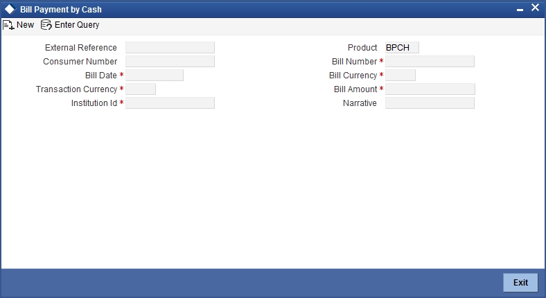

7.9 Pay Bill by Cash
7.9.1 Paying a Bill by Cash
This module allows you to undertake cash transactions for payments of all the utility bills. To enter into such transactions, you need to invoke the ‘Bill Payment by Cash’ screen. You can invoke this screen by typing ‘1025’ in the field at the top right corner of the Application tool bar and clicking on the adjoining arrow button.
Product Code
The system displays the code of the retail teller product maintained in the system that will be used for processing the transaction.
Consumer Number
Specify the consumer number for the transaction.
Bill Number
Specify the bill number here.
Bill Date
Specify the date on which the bill has been issued. The adjoining button when clicked invokes a calendar in which you need to double-click on the appropriate date. The chosen date will then be seen in the ‘YYYYMMDD’ format.
Bill Currency
Specify the currency in which the bill should be paid. You can select the appropriate code from the adjoining option list that displays all the currency codes maintained in the system.
Specify the currency in which the payment is being made by your customer. You can select the appropriate code from the adjoining option list that displays all the currency codes maintained in the system.
Institution Id
Specify the unique ID corresponding to the institution towards which the bill payment is being made. You can select the appropriate code from the adjoining option list that displays all the institution codes maintained in the system.
Bill Amount
Specify the amount that should be paid towards the bill.
Narrative
You may enter remarks about the transaction here. This is a free format text field.
Exchange Rate
The system displays the exchange rate used to convert the bill amount in the bill currency to transaction currency. If the transaction currency is the same as the bill currency, the system will display the exchange rate as ‘1’.
Charges
Total Amount
The system displays the total amount inclusive of the bill amount and the charges.
Note
A transaction slip is generated at the time of input stage completion and is produced to the customer to sign and confirm the transaction.
Negotiation Reference Number
Note
Oracle FLEXCUBE books then online revaluation entries based on the difference in ex­change rate between the negotiated cost rate and transaction rate.

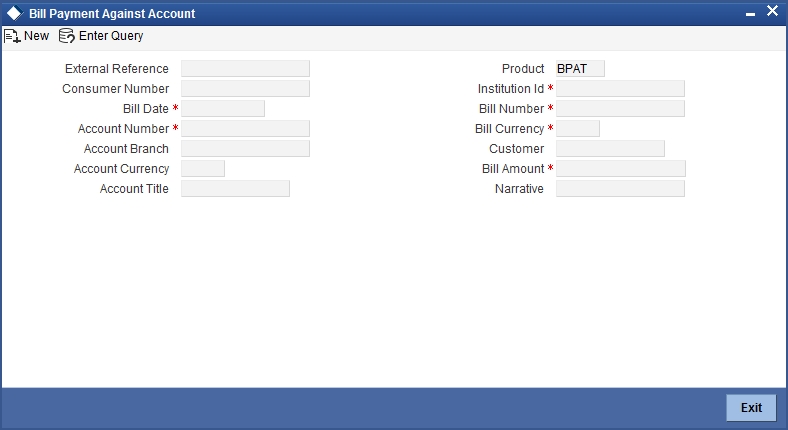

You can capture a bill payment transaction against account through the ‘Bill Payment (Against Account)’ screen. You can invoke this screen by typing ‘1075’ in the field at the top right corner of the Application tool bar and clicking on the adjoining arrow button.
Product Code
Bill Number
Consumer Number
Bill Date
Institution Id
Bill Currency
Bill Amount
Account Number
Specify the account number of the customer against which the bill should be paid. You can select the appropriate number from the adjoining option list that displays all the accounts maintained in the system.
Account Branch
The branch where the chosen account resides is displayed here.
Narrative
Account Currency
The system displays the currency in which the chosen account is maintained.
Customer ID
Account Title
The system displays a brief title for the chosen account.
Exchange Rate
The system displays the exchange rate used to convert the bill amount in bill currency to transaction amount in transaction currency. If the transaction currency is the same as the bill currency, the system will display the exchange rate as ‘1’.
Total Charge
Total Amount
Note

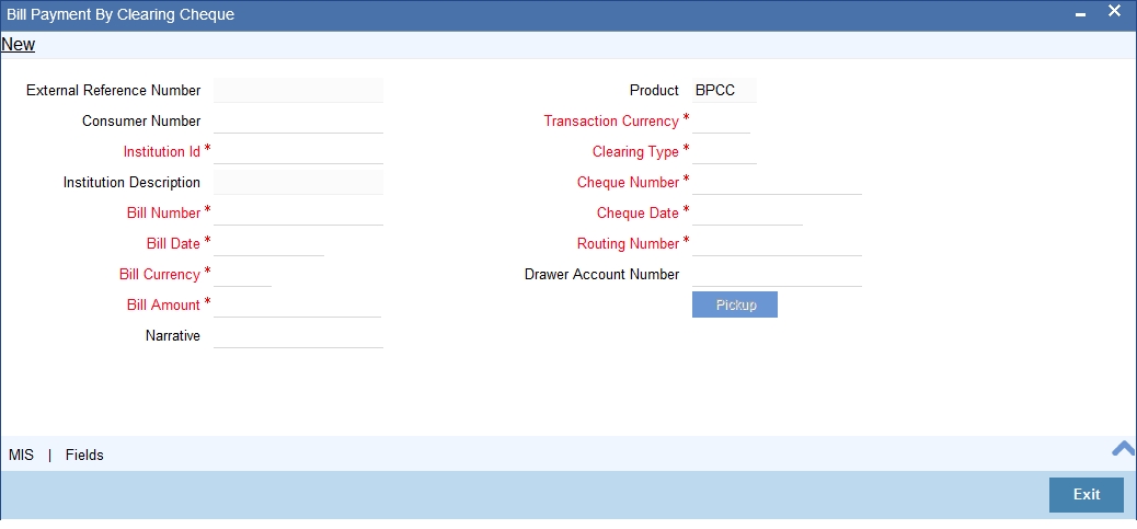

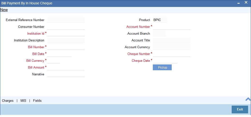

7.11 Pay a Bill by Clearing Cheque
7.11.1 Paying a bill by clearing cheque
You can undertake other bank cheque transactions for the payment of all the utility bills through ‘Bill Payment By Clearing Cheque’ screen. You can invoke this screen by typing ‘1045’ in the field at the top right corner of the application tool bar and clicking on the adjoining arrow button.
You can capture the following details:
The system displays the external reference number.The system generates a unique number based on the branch-specific sequence number generation logic and displays it here.
Consumer Number
Institution Id
Specify the unique Id corresponding to the institution towards which bill payment is being made. Alternatively, you can select the institution id from the option list. The list displays all institution code maintained in the system.
Institution description
The system displays the description of the biller institution.
Bill Number
Specify the bill number.
Bill Date
Select the date on which the bill has been issued from the adjoining calendar.
Bill currency
Specify the currency in which the bill should be paid. Alternatively, you can select the currency from the option list. The list displays all bill currency maintained in the system.
Bill Amount
Specify the bill amount.
Narrative
Product
The system displays the utility payment product. The Product ‘BPCC’ will be defaulted for the transaction pertaining to the bill payment for clearing cheques.
Specify the currency in which the payment is made by the customer. Alternatively, you can select the transaction currency from the option list. The list displays all transaction currency maintained in the system
Clearing Type
Select the clearing type. Alternatively, you can select the type of clearing from the option list. The list displays all clearing products maintained in the system.
Cheque Number
Specify the cheque number provided by the customer. Alternatively you can select the cheque number from the option list. The list displays all the cheque numbers of the customer maintained in the system.
Cheque Date
Select the date on which cheque has been issued from the adjoining calendar.
If the cheque is issued before three months, the system displays an error message “Cheque is a stale one”.
Routing Number
Specify the routing number. Alternatively you can select the routing number from the option list. The list displays all routing number maintained in the system.
Drawer Account Number
Specify the drawer account number.
Pickup Button
Click on pickup to default the data into the MIS and fields details. It is mandatory to click on ‘Pickup’ button before save.
7.11.2 Specifying the MIS details
You can capture details pertaining to MIS. Click on the ‘MIS’ button to invoke this screen.

You can capture the UDF details in the ‘UDF details’ screen. Click ‘Fields’ button to invoke this screen.
For more information on UDF screen refer to the section ‘Specifying the UDF details’ in the chapter ‘Depositing Cash’ in this User Manual.
7.12 Pay a Bill by In-house Cheque
7.12.1 Paying a bill by in-house cheque
You can pay all the utility bills using same bank cheque. You can maintain these transactions, in the ‘Bill Payment By In-house Cheque’ screen. You can invoke this screen by typing ‘1035’ in the field at the top right corner of the application tool bar and clicking on the adjoining arrow button
Consumer Number
Institution Id
Bill Number
Bill Date
Bill currency
Bill Amount
Narrative
Product
The system displays the utility payment product. The Product ‘BPIC’ will be defaulted for the transaction pertaining to the bill payment for in-house cheques.
Account Number
Specify the account number of the customer against which the bill should be paid. Alternatively, you can select the account number from the option list. The list displays all the accounts maintained in the system
Account Branch
The system displays the branch where the chosen account resides.
Account Title
Account Currency
The system displays the currency in which the account is maintained.
Cheque Number
If the cheque is cancelled, the system displays an error message “Selected cheque is cancelled”.
If the cheque has stop payment, the system displays an error message “There is a stop payment on the selected cheque”
Cheque Date
Pickup Button
Click on the Pickup button to default the data into the Charges, MIS and Fields details. It is mandatory to click on ‘Pickup’ button before save.
7.12.2 Specifying Charge details

7.12.4 Specifying the Field details

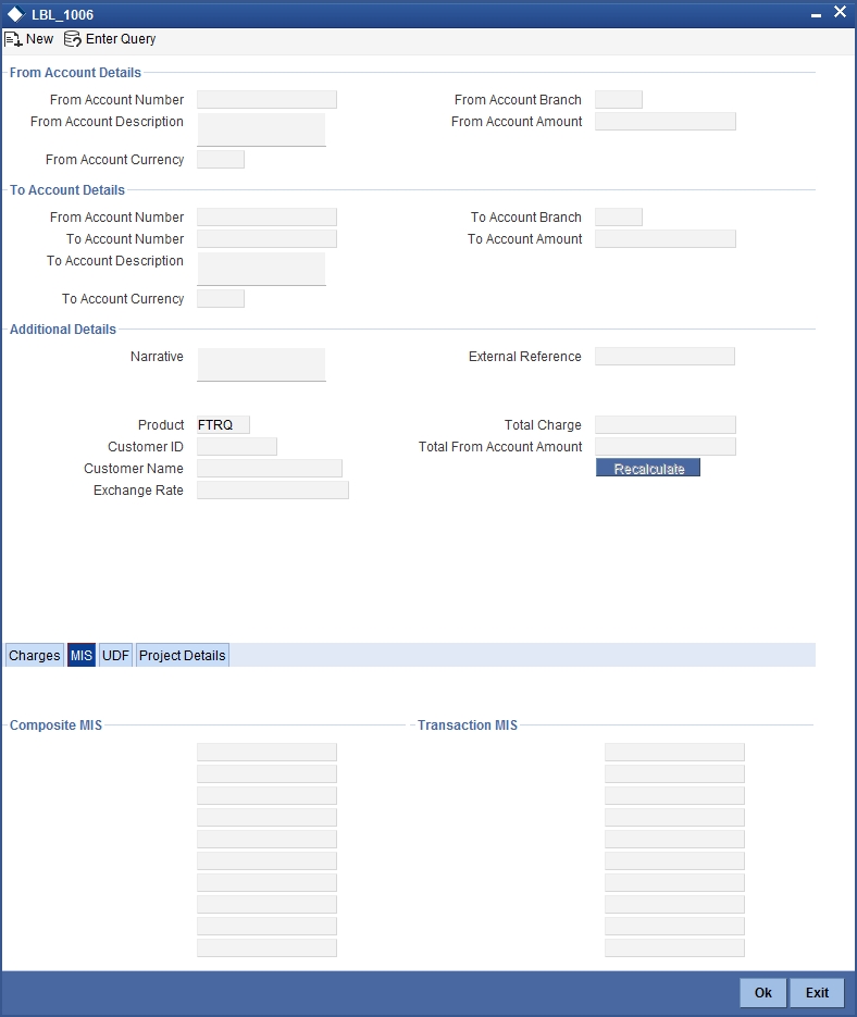

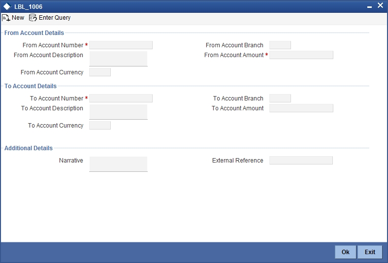

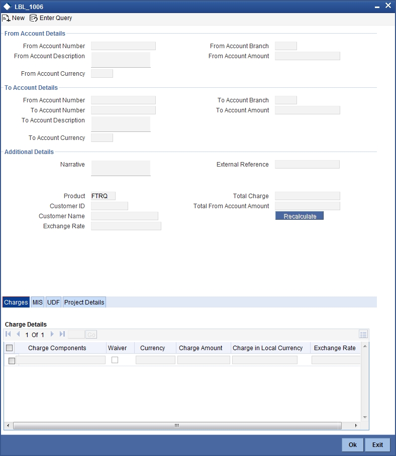

7.13 Request for Funds Transfer
7.13.1 Requesting for Funds Transfer
You can transfer funds in a particular currency from one account to another using the ‘Account to Account Transfer’ screen. The funding account and the beneficiary account can be in different currencies and can belong to different branches.
You can invoke this screen by typing ‘1006’ in the field at the top right corner of the Application tool bar and clicking on the adjoining arrow button.
From Account Details
From Account Number
Specify the account that should be debited for the funds transfer. After specifying the account number, the system will display the From Account Branch and From Account Currency.
Note
In case of multiple accounts with the same account number, the system will display a list of account numbers with associated account branches. Choose the appropriate one.
To view the joint holder’s details of an account and the mode of operation maintained at the account level, place the cursor on the From Account Number field and press Ctrl+J. The system displays the ‘Joint Holder’ screen.
From Account Branch
From Account Description
The system displays the local currency. If you specify another account number and tab out of the Account Number field, the system displays the currency associated with the account.
From Account Amount
Specify the transferrable amount in the currency associated with the From Account.
To Account Details
To Account Number
Physical Account
Specify the account that should be credited for the funds transfer. After specifying the account number, the system will display the To Account Branch and To Account Currency. In case of multiple accounts with the same account number, the system will display a list of account numbers with associated account branches. Choose the appropriate one.
To view the joint holder’s details of an account and the mode of operation maintained at the account level, place the cursor on the To Account Number field and press Ctrl+J. The system displays the ‘Joint Holder’ screen.
To Account Branch
To Account Description
For Virtual Accounts, the virtual account name is displayed in this field.
To Account Currency
For a Virtual Account, the ‘From Account’ currency is defaulted as the account currency.
The physical account number is identified based on the account currency and virtual account number combination. If the physical account number is available, then the account currency remains the same.
is selected and the account currency changes as per the default physical account number.
To Account Amount
To Account Number is a read-only field displaying the transferrable amount in the currency associated with the To Account.
Click ‘Pickup’ button. The system validates if all the mandatory details are specified. This button will be disabled after the first click.
Additional Details
Narrative
The system displays ‘Funds Transfer from <From Account Number> to <To Account Number>’. Once you specify the ‘From Account Number’ and ‘To Account Number’, the system replaces the account numbers respectively.
If virtual account number is entered in the ‘To Account Number’ field, then that virtual account number will be displayed in the Narrative field.
Click the OK button to go to the next stage.
External Reference
The system generates a unique number based on the branch-specific sequence number generation logic. The Host system identifies a branch transaction with the external reference number.
If there is a transaction level override or error during approval then the transaction will be moved to the pending queue. Without save action being initiated, the transaction will not be in pending queue.
On clicking ‘Pickup’ button, the system defaults the following details:
The currency in which the ‘From Account’ is maintained is displayed.
Customer ID
Exchange Rate
The system displays the exchange rate used to convert the from account currency into to account currency. If the from account currency is the same as the to account currency, the system will display the exchange rate as ‘1’.
Total Charge
To Amount
Specify the amount that should be credited to the account.
Note
7.13.2 Specifying charge details
7.13.3 Specifying MIS details
This block allows you to capture details pertaining to MIS. Click on the ‘MIS’ tab to invoke the following screen:
7.13.4 Specifying UDF Details
You can capture the UDF details under ‘UDF’ tab.
7.13.5 Specifying Project Details
You can capture project details under ‘Project Details’ tab. Note that this tab will be applicable only if the funds are being transferred to a Trust account.
Project Name
Unit Payment
Unit ID
Deposit Slip Number
Click save icon to save the transaction. On saving, the system checks whether the accounts mentioned in the ‘from’ and ‘to’ leg of the transaction belong to the same netting group or not. If they belong to the same netting group, the entries will not be posted. Instead the transaction will be logged for the netting batch. On authorisation, the transaction will be made available for the netting batch if logged for netting batch. The rest of the authorization process is similar to that of cash deposit.

7.14.1 Specifying Charge Details
You can specify charge details under the ‘Charge Details’ tab. You can specify the following details here:
Charge Components
Specify the charge component name.
Waiver
Check this box to indicate that charge is waivered.
Charge Amount
The system displays the computed charge amount.
Currency
The system displays the charge currency.
Specify the charge in local currency.
Exchange Rate
The system displays the exchange rate if the transaction currency and account currency are different.

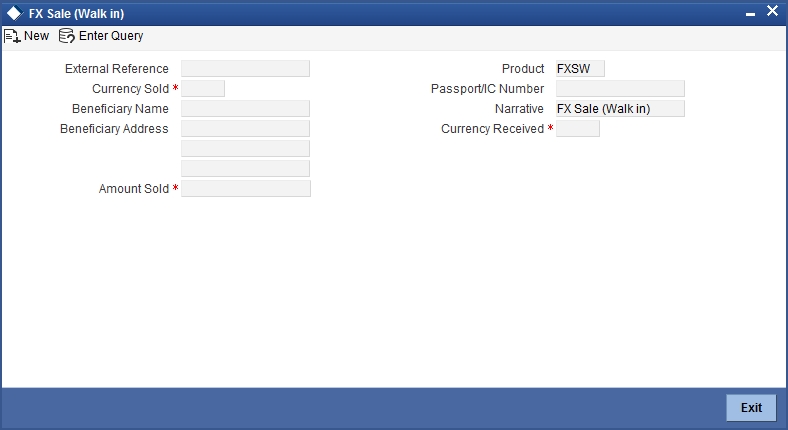

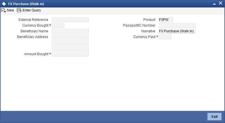

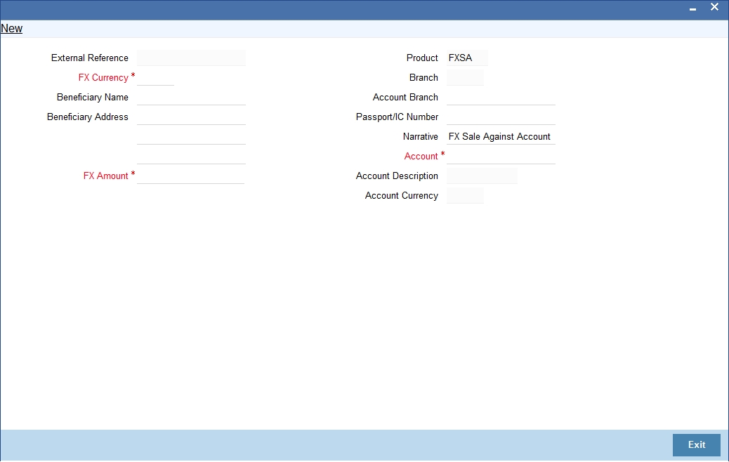

7.15 Sell Foreign Exchange to a Walk-in Customer
7.15.1 Selling Foreign Exchange to a Walk-in Customer
You can sell a foreign currency to a walk-in customer in return for the equivalent amount in another currency. To achieve this you need to invoke the ‘FX Sale (Walk-in)’ screen by typing ‘8203’ in the field at the top right corner of the Application tool bar and clicking on the adjoining arrow button.
Product
Currency Sold
Specify the currency that you are selling to the customer. You can select the appropriate code from the adjoining option list that displays all the currency codes maintained in the system.
Amount Sold
Specify the amount that is being sold in the sold currency.
Currency Received
Specify the currency that you have received from the customer in return for the currency sold. You can select the appropriate code from the adjoining option list that displays all the currency codes maintained in the system.
Customer ID
Specify the customer ID. Alternatively, you can select customer ID from the option list. The list displays all valid customer ID maintained in the system.
Narrative
Here, you can enter your remarks pertaining to the transaction.
Beneficiary Name
Here, you can capture the beneficiary customer’s name.
Passport/IC No
Here, you can enter the passport or other unique identification number of the beneficiary.
Beneficiary Address
Here, you can capture the address of the beneficiary customer.
Denomination Variance Applicable
This Check box will have the value Y by default only if you have set the required parameter to ‘Yes’ in ‘FBTB_PARAMS’.

7.15.2 Specifying denomination details
In the ‘Denomination’ screen, you can capture details of the currency denominations involved in the transaction. You can invoke this screen by clicking the ‘Denomination’ button.
In the ‘FX Denomination’ screen, you can capture details of the foreign currency denominations involved in the transaction. If you have checked the check-box ‘Denomination Variance Applicable’, then you must capture the ‘FX denomination details’ before Pickup stage. You can invoke this screen by clicking the ‘FX Denomination’ button.

7.15.5 Specifying UDF Details

7.16 Purchase Foreign Exchange from a Walk-in Customer
7.16.1 Purchasing Foreign Exchange from a Walk-in Customer
You can buy a foreign currency from a walk-in customer in return for the equivalent amount in another currency. To achieve this you need to invoke the ‘FX Purchase (Walk-in)’ screen by typing ‘8004’ in the field at the top right corner of the Application tool bar and clicking on the adjoining arrow button.
Product
Currency Bought
Specify the currency that you have received from the customer. You can select the appropriate code from the adjoining option list that displays all the currency codes maintained in the system.
Amount Bought
Specify the amount that is being purchased in the bought currency.
Currency Paid
Specify the currency that you are paying the customer in return for the currency bought. You can select the appropriate code from the adjoining option list that displays all the currency codes maintained in the system.
Narrative
Beneficiary Name
Passport/IC No
Here, you can enter the passport or other identification number of the beneficiary.
Beneficiary Address
By default, the system displays the status of the check-box as checked. However, you can modify this based on the transaction requirements.
If this box is checked, then based on the denominations of the currency, the system will apply the respective variance to the rate of exchange. The variance is applied based on the variance maintained for the currency pair involved in the transaction.
If you check this box, it is mandatory to specify the denominations in ‘FX Denominations’ sub-screen.
On clicking the ‘Pickup’ button the following details will be displayed:
Transaction Currency Rate
The system displays the exchange rate to be used for the foreign exchange purchase.
Negotiated Rate
Specify the negotiated rate to compute profit or loss of this transaction.
You can book profit or loss for each retail FX transaction based on the negotiated rate and transaction rate.
The formula for computing Profit/Loss is as follows:
Direct Method (Stronger currency to Weaker currency) = Negotiated Cost Rate – Transaction Rate) * Transaction Amount
Indirect method (Weaker currency to Stronger currency) = (1/Negotiated Cost Rate – 1/Transaction Rate) * Transaction Amount
If both the currencies of transaction are Foreign currency, then revaluation will be as follows:
Revaluation method = Amount * (Transaction Rate–Negotiated Cost Rate) * Revaluation MID Rate of CCY2
At the time of booking, the profit or loss generated by the transaction will be booked as part of REVL. This profit or loss will be booked under separate GLs as per ARC maintenance.
If Negotiated rate and transaction rate are same there will not be any accounting entry for profit or loss.
Specify the negotiated reference details.
For the negotiated transactions, the negotiation reference number and negotiated rate will be provided by the treasury which needs to be manually captured during transaction input.
Charges
The system displays the charge to be levied on the customer for the transaction.
Amount Paid
Based on the exchange rate and amount bought, the system computes and displays the amount that needs to be paid to the customer in the paid currency.
7.16.2 Specifying Denomination Details
In the’Denomination’ screen, you can capture details of the currency denominations involved in the transaction. You can invoke this screen by clicking the ‘Denomination’ button.
7.16.3 Specifying charge details
This screen allows you to capture charge related details. You need to click on the ‘Charges’ button to invoke the screen.Refer the section titled ‘Specifying charge details’ under ‘Depositing Cash’ for further details.
7.16.4 Specifying MIS details
This screen allows you to capture details pertaining to MIS. Click on the ‘MIS’ screen to invoke the screen:
7.16.5 Specifying UDF Details
You can capture the UDF details under ‘UDF’ screen. Refer the section titled ‘Specifying the UDF details’ under ‘Depositing Cash’ for further details.
7.17 Purchase FX against Account
7.17.1 Purchasing FX against Account
Oracle FLEXCUBE facilitates purchase of foreign currency from the branch using CASA account. While purchasing, you can maintain denomination details for the foreign currency amount. On completion of the transaction successfully, the system generates an advice for the same.
You can generate the details from the purchase of foreign currency by crediting CASA account using ‘FX Purchase against Account’ screen. You can invoke ‘FX Purchase against Account’ screen by typing ‘8207’ in the field at the top right corner of the Application tool bar and clicking on the adjoining arrow button.
You can maintain the following parameters here:
FX Currency
Specify a valid currency purchased by the customer from the adjoining option list. The option list displays list of foreign currencies maintained by the bank.
Beneficiary Name
Specify the name of the beneficiary customer.
Beneficiary Address
Specify the address of the beneficiary customer which should appear in the advice.
FX Amount
Specify the amount of the foreign currency purchased by the customer.
Product
Branch Code
The system displays the branch code of the current branch here.
Account Branch
The system displays the branch code of the branch to which the specified customer account belongs.
Passport/IC Number
Specify the passport or unique identification number of the beneficiary.
Narrative
Specify additional remarks pertaining to the transaction, if any. If virtual account number is entered in the account number field, then that virtual account number will be displayed in the Narrative field.
Account
Physical Account
Specify a valid CASA account to be debited for the FX sale from the adjoining option list. The option list displays the customer accounts maintained in the system.
Virtual Account
To view the joint holder’s details of an account and the mode of operation maintained at the account level, place the cursor on the Accounts Number field and press Ctrl+J. The system displays the ‘Joint Holder’ screen.
Account Description
Specify the description of the specified customer account. For a virtual account, the virtual account name is displayed here.
Account Currency
Currency of the specified customer account is defaulted here.
For a Virtual Account, the FX currency is defaulted as the account currency.
The physical account number is identified based on the account currency and virtual account number combination. If physical account number is available then the account currency remains the same.
If the physical account number is not available, then the default physical account number is selected and the account currency changes as per the default physical account number.
If you check this box, it is mandatory to specify the denominations in ‘Denominations’ sub-screen.
On clicking the Pickup button, the following fields will be defaulted:
In addition to the parameters defaulted from the previous stage, you can maintain the following:
Currency Rate
The current exchange rate of the currency is defaulted here.
Negotiated Rate
Charges
The charge amount in account currency, if any, associated with the retail teller product FXSP is defaulted here.
Amount
The actual amount equivalent to the foreign currency which is credited to the customer account is defaulted here.
Net Amount
Sum of the actual amount credited and the charges in account currency is defaulted here.
If you have checked the check-box ‘Denomination Variance Applicable’, then the system will apply the variance for each denomination and calculate the net amount.
Recalculate
Click the ‘Recalculate’ button to recalculate the amount after modifications to values, if any.
7.17.2 Denomination Details Tab
In the ‘Denomination’ screen, you can capture details of the currency denominations involved in the transaction. You can invoke this screen by clicking the ‘Denomination’ button. If you have checked the check-box ‘Denomination Variance Applicable’, then you must capture the ‘FX denomination details’ before Pickup stage in the Denomination screen.
Refer the section titled ‘Specifying Denomination Details’ under ‘Depositing Cash’ for further details.
7.17.3 Charges Tab
You can maintain the charge related details of the transaction. Click on the ‘Charges’ button to invoke the screen.
Refer the section titled ‘Specifying Charge Details’ under ‘Depositing Cash’ for further details.
7.17.4 MIS Tab
You can maintain the MIS related details of the transaction. Click on the ‘MIS’ button to invoke the screen:.
Refer the section titled ‘Specifying MIS Details’ under ‘Depositing Cash’ for further details.
7.17.5 UDF Tab
You can capture the UDF related details of the transaction. Click on the ‘UDF’ button to invoke the screen.
Click ‘Save’ to save the transaction. The authorization process is similar to cash deposit.
Refer ‘Authorization Stage’ section under ‘Depositing Cash’ for further details.

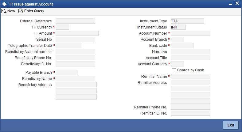

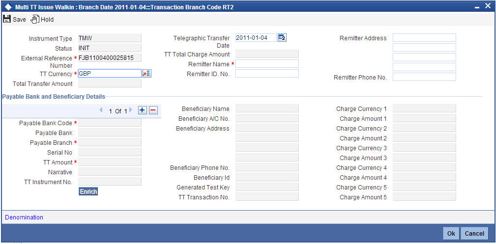

7.18 Issue TT against Account
7.18.1 Issuing a TT against Account

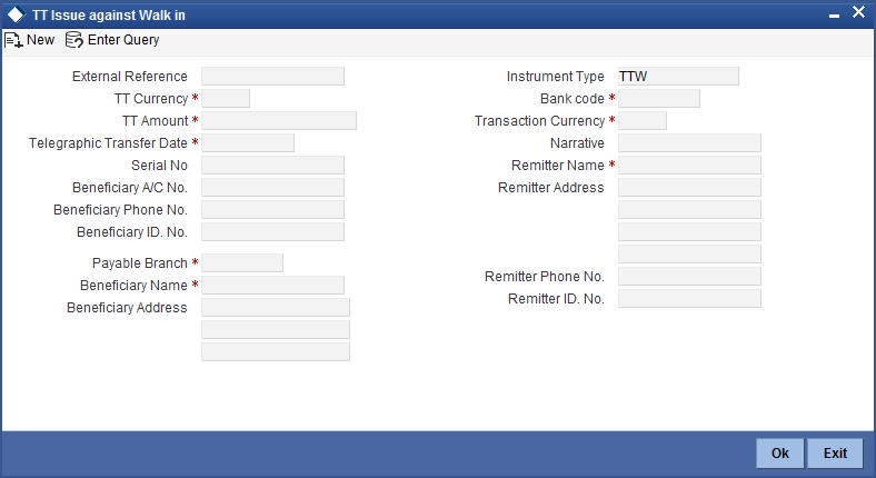

You can issue a Telegraphic Transfer drawn on your branch against an account through the ‘TT Issue Against Account’ screen. You can invoke this screen by typing ‘8318’ in the field at the top right corner of the Application tool bar and clicking on the adjoining arrow button.
When you invoke the screen, the External Reference Number is displayed.
You need to specify the following details:
Bank Code
Specify the clearing bank code for the transaction.
TT Currency
Specify the TT currency or select a currency for the TT from the list of values.
Account Currency
Specify the currency of the account or select the account currency from the list of values.
Remitter Name
Specify the name of the remitter.
Remitter Address
Specify the address of the remitter
Remitter Phone Number
Specify the phone number of the remitter.
Remitter ID Number
Specify a unique identification value of the remitter.
Beneficiary A/C number
Specify the account number to which the proceeds have to be credited.
Beneficiary ID Number
Specify the beneficiary ID number.
Beneficiary Phone Number
Specify the phone number of the beneficiary.
Charge by Cash
Check this box “Charge by Cash” to select the charge mode, that is by cash or from account.
Note
For the TT where Charge by “Cash” is selected, then all the TT transactions are treated as cash transactions.
Payable Branch
Specify the branch where the transfer amount should be paid out.
Account Number
Specify the account number of the customer or select an account number from the list of values.
To view the joint holder’s details of an account and the mode of operation maintained at the account level, place the cursor on the Account number field and press Ctrl+J. The system displays the ‘Joint Holder’ screen.
TT Amount
Specify the transfer amount.
Telegraphic Transfer Date
The date on which the instrument is issued is displayed here.
Serial Number
Specify the serial number printed on the TT.
Narrative
Here, you can enter remarks pertaining to the transaction.
Beneficiary Name
Specify the name of the beneficiary of the TT.
Beneficiary Address
Specify the address of the beneficiary.
The system displays the exchange to be used for the transaction in case the transaction currency is different from the transfer currency.
Charges
The system computes the charges applicable to the transaction and displays the amount here.

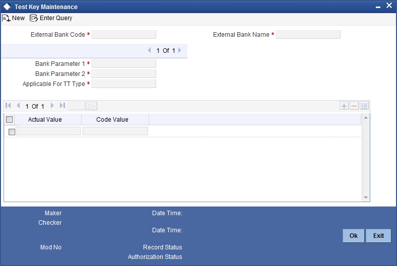

Generated Test Key
The generated test key is system populated. This field is system populated at Enrich stage.
7.18.2 Specifying denomination details
In this block, you can capture details of the currency denominations involved in the transaction. These details need to be mandatorily updated if ‘Charge by Cash’ is selected.
Refer the section titled ‘Specifying denomination details’ under ‘Depositing Cash’ in this manual for further details.

7.18.5 Specifying the UDF details
Refer the section titled ‘Specifying UDF details’ under ‘Depositing Cash’ for further details in this manual.

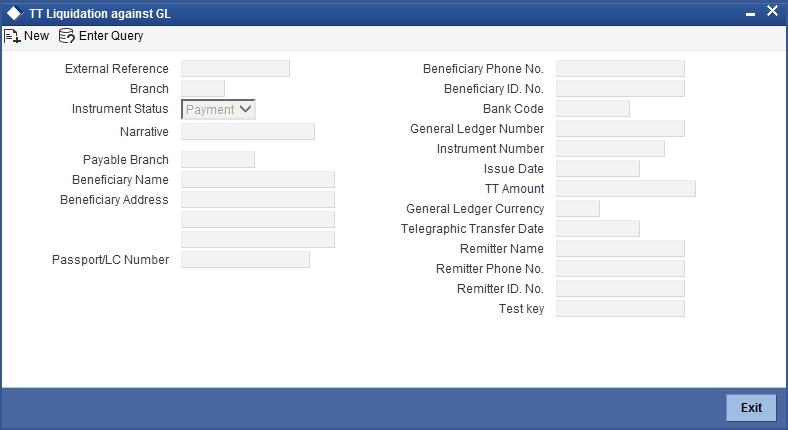

7.19 Issue a TT against GL
7.19.1 Issuing a TT against GL
You can issue a Telegraphic Transfer against a GL account for your customer through the ‘TT Issue against GL’ screen. You can also invoke this screen by typing ‘8317’ in the field at the top right corner of the Application tool bar and clicking on the adjoining arrow button.
On invoking this screen, the External Reference Number and the Instrument Type of the transaction are displayed.
Bank Code
Specify the bank code or select a bank code from the list of values.
TT Currency
Payable Branch
General Ledger Number
Specify the account number of the GL against which a TT is issued.
General Ledger Currency
Specify the GL currency in this field.
General Ledger Title
TT Amount
Serial Number
Specify the Serial number printed on the TT.
Remitter Name
Remitter Address
Remitter ID Number
Specify the remitter ID number.
Narrative
Specify description/remarks for the transaction. This is not mandatory.
Beneficiary Name
Specify the name of the beneficiary.
Beneficiary Address
Txn Ccy Rate
The system displays the transaction currency.
Charges
TT Amount
The system displays the TT amount.
Total Amount
Generated Test Key
7.19.2 Specifying Charge Details
Refer the section titled ‘Specifying the charge details’ under ‘Capturing a Cash Deposit’ in this manual for further details.
7.19.3 Specifying MIS Details
Refer the section titled ‘Specifying MIS details’ under ‘Capturing a Cash Deposit’ in this manual for further details.
7.19.4 Specifying the UDF details
7.20 Issue a TT to a Walk-in Customer
7.20.1 Issuing a TT to a Walk-in Customer
You can issue a Telegraphic Transfer to any walk-in customer through the ‘TT Issue (Walk-In)’ screen. You can invoke this screen by typing ‘8316’ in the field at the top right corner of the Application tool bar and clicking on the adjoining arrow button.
When you invoke the screen, the External Reference Number and instrument type of the transaction are displayed.
Bank Code
TT Currency
Specify the currency in which the TT is being issued.
Payable Branch
Specify the branch where the TT amount should be paid out.
Specify the currency in which the customer is making the payment.
TT Amount
Specify the amount for which the TT needs to be drawn in the transfer currency.
The date on which the instrument has been issued is displayed here.
Remitter Name
Remitter Address
Remitter ID Number
Specify the beneficiary Identification number.
Narrative
Beneficiary Name
Specify the name of the beneficiary in whose favor the telegraphic transfer is done.
Beneficiary Address
Specify the address of the beneficiary in whose favor the telegraphic transfer is done.
Charges
Total Amount
The system computes the total amount to be paid by the walk-in customer by adding the charge amount to the TT amount.
Generated Test Key
7.20.2 Specifying denomination details
7.20.3 Specifying charge details
Click on the ‘Charges’ tab to capture charge related details.
Refer the section titled ‘Specifying the charge details’ under ‘Depositing Cash’ in this manual for further details.
7.20.4 Specifying MIS Details
Click on the MIS tab to capture details pertaining to MIS.
Refer the section titled ‘Specifying MIS details’ under ‘Depositing Cash’ in this manual for further details.
7.20.5 Specifying the UDF details
7.21 Issuing Multiple TT against Account
Issuance of multiple TT against a customer account with multiple beneficiaries respectively from single transactions is performed through this screen. The beneficiaries can be in different banks. The charge for this TT would be the sum of individual charges for each of the beneficiary banks. The charge can be collected either in cash or debited to the customer account. You can invoke the ‘Multiple TT Issue against Account’ screen, by typing ‘8324’in the field at the top right corner of the Application tool bar and clicking on the adjoining arrow button.
When you invoke this screen, the External Reference Number, Instrument Type and Instrument Status is defaulted.
Specify the following details in this screen:
TT Currency
Total Transfer Amount
The value in this field is defaulted. The sum total of the multiple TT amount is displayed in this field.
Specify the telegraphic transfer date.
Remitter Account Number
Specify the account number of the customer or select an account number from the adjoining option list.
To view the joint holder’s details of an account and the mode of operation maintained at the account level, place the cursor on the Remitter Account Number field and press Ctrl+J. The system displays the ‘Joint Holder’ screen.
Remitter Name
Remitter Address
Remitter ID Number
Charge by Cash
Check the box “Charge by Cash” to select the charge mode that is by cash or from account.
Payable Bank Code
Payable Bank
The name of the payable bank is displayed here.
Payable Branch
Serial Number
Specify the serial number.
TT Amount
TT Instrument Number
The instrument number of the generated child TT’s is system populated.
Narrative
Specify remarks pertaining to the transaction.
Beneficiary Name
Beneficiary Address
TT Transaction Number
The system displays the Telegraphic Transfer transaction number in this field.
On clicking the ‘Enrich’ button, the following fields are defaulted:
Test Key
This field stores the test key generated at Enrich Stage.
TT Total Charge Amount
The value in this field is defaulted. The Total Charge will be equal to sum of all the Charges as computed and returned by the ARC of Individual Child TTs in the Enrichment Stage.
Charge Amount 1 to 5
These fields are defaulted by the system. It computes all 5 charges (if applicable) for each individual child TT from their respective ARC and populates the same in the fields Charge 1,Charge 2, Charge 3, Charge 4, and Charge 5.
Charge Currency 1 to 5
The currency in which charge has to be deducted is displayed in these fields.
The Telegraphic Transfer transaction number is defaulted in this field.
7.21.1 Specifying Denomination Details
In this block, you can capture details of the currency denominations for the charge, if the Charge by Cash is Y.
7.22 Issuing Multiple TT for Walk In
Issuance of Multiple TT against a walk-in customer with multiple beneficiaries from a single transaction is possible through this facility. You can invoke the ‘Multiple TT Issue against Walk in’ screen, by typing ‘8323’ in the field at the top right corner of the Application tool bar and clicking on the adjoining arrow button.
TT Currency
Specify the TT currency or select a currency for the TT from the adjoining option list.
Select the telegraphic transfer date in this field.
Remitter Name
Remitter Address
Remitter ID Number
Payable Bank Code
Payable Bank
Payable Branch
Serial Number
TT Amount
The system generates the instrument number of the generated child TT’s.
Narrative
Beneficiary Name
Beneficiary Address
On clicking the ‘Enrich’ button, the system populates the following details.
This field is auto populated. The Total Charge will be equal to sum of all the Charges as computed and returned by the ARC of Individual Child TTs in the Enrich Stage.
Test Keys
This field stores the test key generated. This field is defaulted at Enrich state.
The system displays the telegraphic transfer transaction number in the field.
These fields are defaulted by the system. It computes all 5 charges (if applicable) for each individual child TT from their respective ARC and populates the same in the fields Charge 1, Charge 2, Charge 3, Charge 4, and Charge 5.
The currency in which the charges need to be deducted is defaulted in these fields.
7.22.1 Specifying denomination details
7.23 Maintaining TT Test Keys
With this facility a unique Test Key is generated for Individual TT remittance when the funds are being remitted to another bank. It is also beneficial for validating funds remitted from external banks payable at the branches of Home Bank. The generated Test Key is a part of the outgoing TT message. The test key generation is based on the following parameters:
You can invoke the ‘TT Test Key Maintenance screen by typing ‘STDTTKEY’ in the field at the top right corner of the Application tool bar and clicking on the adjoining arrow button.
Specify the following details in this field:
External Bank Code
Select the external bank code from the adjoining option list. The option list displays all the bank codes as maintained in the ‘Clearing Bank Code Maintenance’.
External Bank Name
This field is defaulted as per your selection in the external bank code field.
Bank Parameter 1
Select the bank parameter from the drop down list. The available parameters are as follows:
Bank Parameter 2
Based on your selection in the Bank Parameter 1 field, select the appropriate value from the drop down list. The list of values displayed are as follows:
Applicable for TT type
Select the appropriate value from the drop down list. The list of values displayed are as follows:
Actuals
Specify the actual value in this field.
Code Value
Specify the code value in this field.

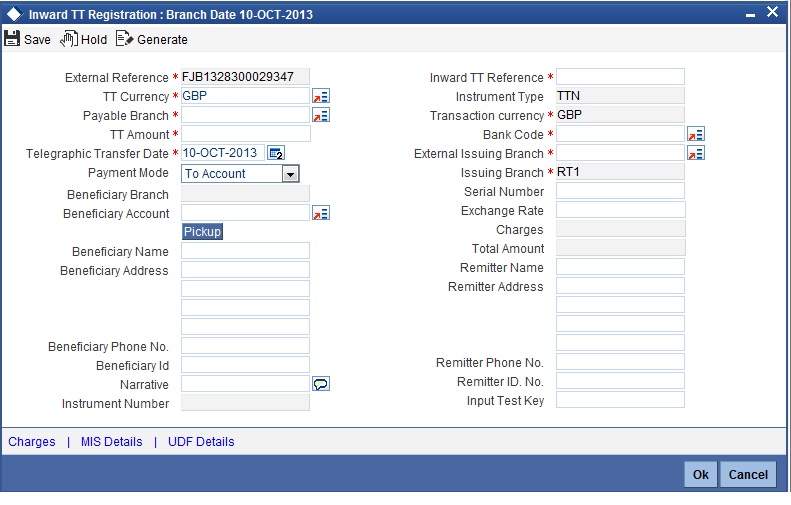

7.24 Inward TT Registration
7.24.1 Defining Inward TT Registration
With this facility an inward remittance, that is, remittance from a external bank, is processed in the following manner:
Any charges, if applicable, is calculated and collected from the customer. The charges are calculated based on the remitting bank and branch, beneficiary branch, amount, and so on. The charges can be collected either in cash or debited to a customer account. At the time of processing this inward remittance, the test key sent by the remitting bank is also validated
You can invoke this screen by typing ‘8322’ in the field at the top right corner of the Application tool bar and clicking on the adjoining arrow button.
When you invoke the screen, the External Reference Number and Instrument type of the transaction are displayed.
TT Currency
Specify the currency in which the customer is receiving the payment.
TT Amount
Specify the amount that the customer is receiving.
Specify the Telegraphic Transfer Date.
Payable Branch
Specify the branch where the TT amount is paid out.
Payment Mode
Select the appropriate option from the drop down list to indicate whether the TT is Payable by Immediate Liquidation to Account or Payable by Deferred Liquidation.
Beneficiary Account
Select the beneficiary account number from the adjoining option list.
To view the joint holder’s details of an account and the mode of operation maintained at the account level, place the cursor on the Beneficiary A/C field and press Ctrl+J. The system displays the ‘Joint Holder’ screen.
Beneficiary Branch
The beneficiary’s home branch is displayed in this field on the selection of the beneficiary account.
Beneficiary Name
Beneficiary Address
Narrative
Instrument Number
The system displays the instrument number.
Inward TT Reference
Specify the Reference No. of the Inward Inter Bank TT.
Bank Code
Issuing Branch
Select the branch of the external bank where the TT has been issued. Only the branches of the External Bank for which the Bank Code is selected, is listed
Serial Number
Remitter Name
Remitter Address
Remitter ID Number
Input Test Key
Specify the Test Key sent by External Bank on the fax message of the TT
Pick Up
Click this button to retrieve details and compute charges if applicable. The following details are computed by the system:
Exchange Rate
Specify the rate of exchange.
Charges
Total Amount
7.24.2 Specifying Charge details
Click on the ‘Charges’ button to capture charge related details.
7.24.3 Specifying MIS Details
Click on the MIS button to capture details pertaining to MIS.
7.24.4 Specifying the UDF details
You can capture these details in the ‘UDF’ button of the screen.

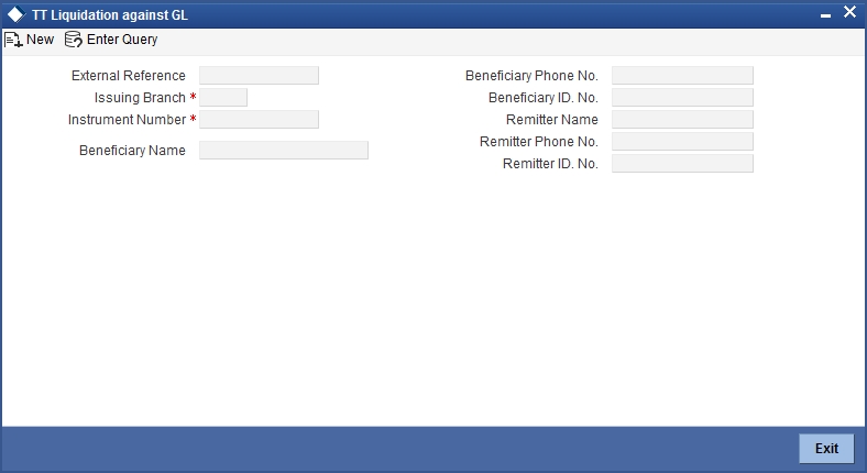

7.25 Liquide a TT against GL
7.25.1 Liquidating a TT against GL
You can liquidate a telegraphic transfer drawn on your branch against a GL through the ‘TT Liquidation Against GL’ screen. You can invoke this screen by typing ‘8320’ in the field at the top right corner of the Application tool bar and clicking on the adjoining arrow button.
On invoking this screen, the External Reference Number of the transaction is displayed. Select the branch code in the ‘Issuing Branch’ field and the instrument number of the TT to be liquidated in the ‘Instrument Number’ field.
The following details will be auto populated:

7.27.2 Specifying Denomination Details
In this block, you can capture details of the currency denominations involved in the transaction. Refer the section titled ‘Specifying denomination details’ under ‘Depositing Cash’ for further details.

Refer the section titled ‘Specifying the charge details’ under ‘Depositing Cash’ in this manual..
7.27.4 Specifying MIS details
Refer the section titled ‘Specifying the MIS details’ under ‘Depositing Cash’ in this manual.
7.27.5 Specifying the UDF details

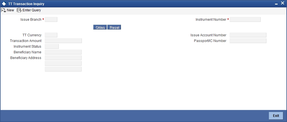

7.28 Inquiring on a TT Transaction
You can query a Telegraphic Transfer transaction for a specified branch and Instrument Number. This can be done by using the ‘TT Inquiry’ screen. You can invoke this screen by typing ‘7795’ in the field at the top right corner of the Application tool bar and clicking on the adjoining arrow button.
Instrument Number
Specify an instrument number of the TT transaction that needs to be queried.
Issue Branch
Specify a branch for which you wish to query the TT transaction. Or select a branch from the list of values.
After you specify the above details, click ‘Ok’ button.
The system will display the following details based on the instrument number:
Clicking ‘Query’ button, the system validates if all the mandatory details are specified. This button will be disabled after the first click.

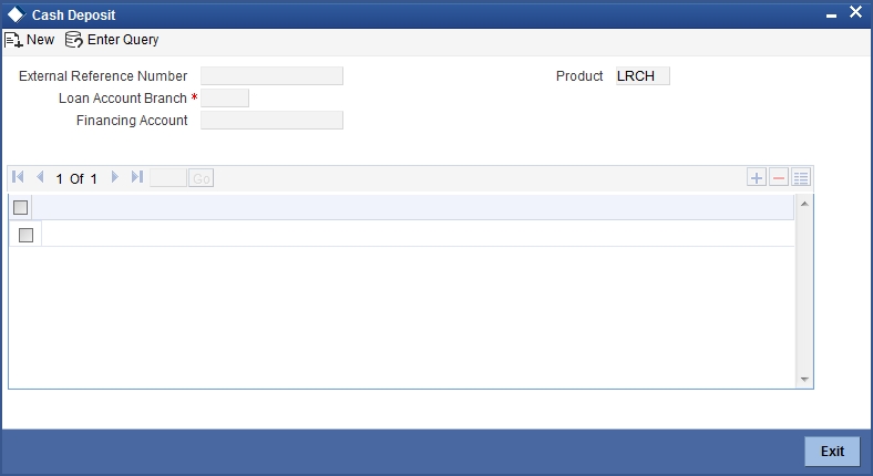

7.30 Disbursing Loan Manually By Cash
You can manually disburse loan amount by cash using the ‘Loan Disbursement by Cash’ screen. You can invoke this screen by typing ‘5001’ in the field at the top right corner of the Application tool bar and clicking on the adjoining arrow button. The screen is displayed below:
The system displays a unique number.
Product
The retail teller product code ‘LDCH’ is displayed in this field.
Loan Account Branch
Specify the loan account branch from which the amount is to be disbursed. You can also select the appropriate branch from the adjacent option list. The list displays all the branches maintained in the system.
Loan Account
Specify the loan account number from which the amount is to be disbursed. You can also select the appropriate account number from the adjacent option list. The list displays all the valid loan accounts maintained in the system.
Disbursement Currency
Specify the currency of the disbursement amount. You can also select the appropriate currency from the adjacent option list. The list displays all the currencies maintained in the system. The denomination tracking will be against this currency.
Disbursement Amount
Specify the disbursement amount.
Narrative
Specify any remarks for the transaction.
After specifying the above details, click ‘Save’ button. The following screen along with the loan details is displayed:
The details specified in the first screen are displayed here. However, you can capture the following details:
Disbursement Amount
The disbursement amount mentioned in the first screen is displayed here. However, you can modify the same. Specify the disbursement amount and click ‘Recalculate’ button to calculate the total cash being disbursed.
Total Cash Disbursed
The total cash disbursed, after deducting the charges is displayed.
Exchange Rate
Loan Account Title
You can specify any title or remarks for the loan account.
Narrative
Currency Denominations
You can specify denomination details if you have checked the ‘Denomination Tracking Required’ option in the ‘Function Workflow Definition Detail’ screen.
Units
Specify the number of units for each denomination.
Total Amount
The total amount for each denomination is displayed.
On saving the transaction, it will move to the enrichment stage for further processing.
Note
The total amount of all the denominations must be equal to the total cash being disbursed.

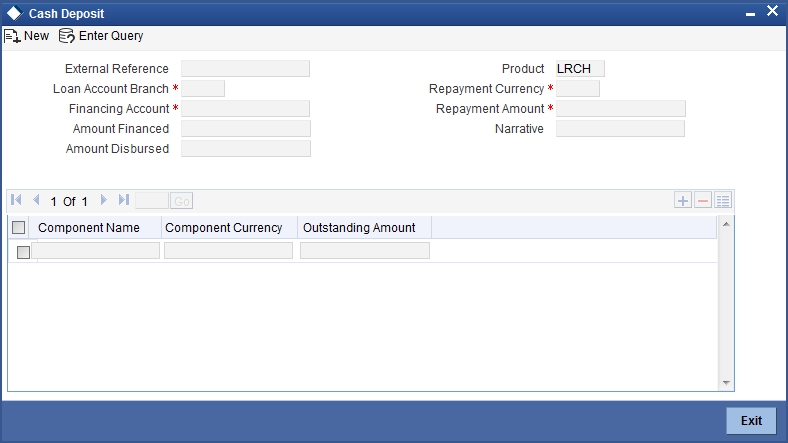

7.31 Repaying Loan Manually By Cash
You can manually repay retail loan amount by cash using the ‘Repayment towards Loan’ screen. You can invoke this screen by typing ‘5401’ in the field at the top right corner of the Application tool bar and clicking on the adjoining arrow button. The screen is displayed below:
Here, you query the loan details by specifying the following:
Loan Account Branch
Specify the branch of the loan account for which the amount is to be repaid.
Loan Account Number
Specify the loan account number for which the amount is to be repaid.
Click ‘Save’ button. The total amount financed, disbursed, the total outstanding amount for each component and currency is displayed in the following screen:
Specify the following in this screen:
Loan Account Branch
Loan Account Number
Repayment Currency
Specify the currency of repayment amount. You can also select the appropriate currency from the adjacent option list. The list displays all the valid currencies maintained in the system. The denomination tracking will be against this currency.
Repayment Amount
Specify the amount to be repaid.
Narrative
Repayment Amount
The amount mentioned in the input screen is displayed here. However, you can modify the same. Specify the amount to be repaid and click ‘Recalculate’ button to calculate the total cash being amount.
Total Cash Amount
The total amount to be paid after including all the charges is displayed here.
Exchange Rate
Loan Account Title
Narrative
Note
Units
Total Amount

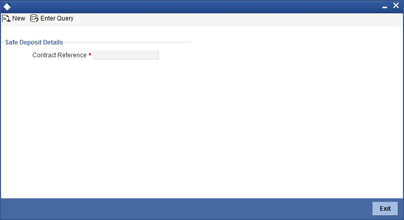

7.32.2 Input Stage
You can invoke the ‘Safe Deposit Rental By Cash’ screen by typing ‘3401’ in the field at the top right corner of the Application tool bar and clicking on the adjoining arrow button. The following screen is displayed:
In this screen, select the Contract Reference Number of the transaction from the option list.
You can enter the following details:
Narrative
Enter additional information for the transaction.
Settlement Account
The system will display the account selected at the contract level. You can modify this, if required.
Settlement Branch
The system will display the branch selected at the contract level. You can modify this, if required.
Settlement Currency
The system will display the currency selected at the contract level. You can modify this, if required.
You can save the transaction by clicking the save icon.

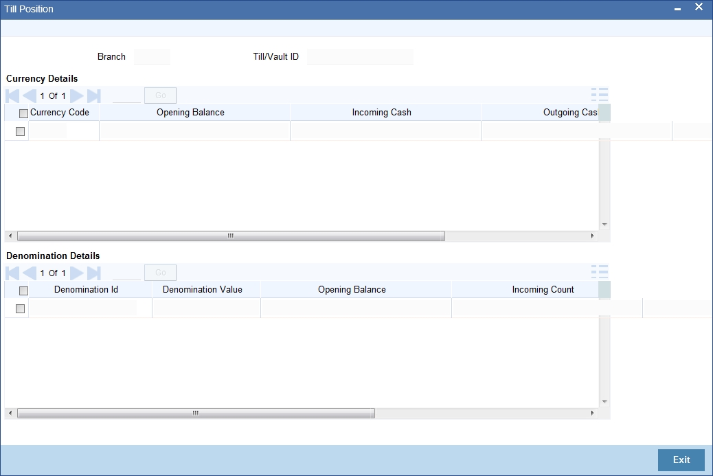

7.34 Querying Till Vault Position
You can view the cash position for all the currencies in the Till for the current day and view the vault position including denomination, at any given point of timein the ‘Till Vault Position Query’ screen. You can invoke this screen by typing ‘TVQR’ in the field at the top right corner of the Application tool bar and clicking the adjoining arrow.
Here you can view the following details:
Branch Code
The system displays the current branch code.
Till/Vault ID
The system displays the identification of the currently logged in user.
Currency Details
Currency Code
The system displays the code of the currency available in the Till.
Opening Balance
The system displays the opening balance in the Till for the day.
Incoming Cash
The system displays the incoming cash in the Till for the day.
Outgoing Cash
The system displays the outgoing cash in the Till for the day.
Total Cash
The system displays the total cash currently available in the Till.
Check one of the Till details record to view the following currency details:
Denomination ID
The system displays the denomination code for the currency in the selected till details record.
Denomination Value
The system displays the value of the corresponding denomination ID.
Opening Balance
The system displays the opening balance in the till for the day in terms of denominations.
Incoming Cash
The system displays the incoming cash in the Till for the day in terms of denominations.
Outgoing Cash
The system displays the outgoing cash in the Till for the day in terms of denominations.
Total Cash
The system displays the total cash currently available in the Till for the day in terms of denominations.

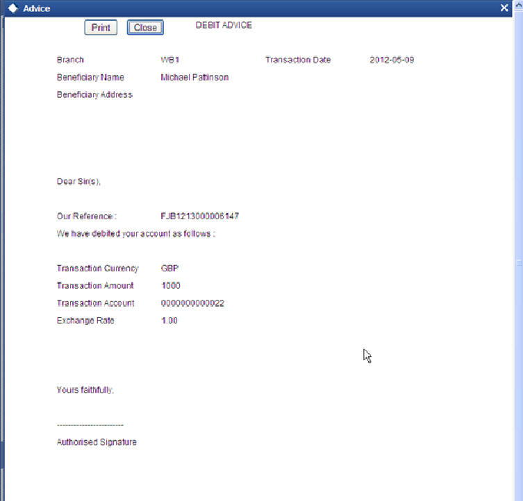

You can sell foreign currency from the branch through the CASA account. You can do this by debiting corresponding account currency from CASA account. You can capture this foreign currency sale transaction through the ‘FX Sale against Account’ screen. You can invoke this screen by typing ‘8206’ in the field at the top right corner of the Application tool bar and clicking on the adjoining arrow button.
External reference
This is the unique transaction number generated by the system for each transaction. The host system identifies a branch transaction with the external reference number.
Fx Currency
Specify the foreign currency sold by the bank to the customer from the adjoining option list.
Fx Amount
Specify the total value of the foreign currency sold to the customer.
Beneficiary name
Specify the name of the beneficiary which will be reflected in the advice.
Beneficiary address
Product
The system defaults the retail teller product code. The product code for this transaction would be FXSA.
Account
Specify the CASA account to be debited for the foreign currency sale from the adjoining option list.
To view the joint holder’s details of an account and the mode of operation maintained at the account level, place the cursor on the Accounts field and press Ctrl+J. The system displays the ‘Joint Holder’ screen.
Account description
The description of the customer account gets defaulted based on the selected account number.
Account branch
The account opening branch detail gets defaulted based on the selected account number.
Account currency
Negotiated Rate
Passport/IC no
Specify either the passport number or the unique identification number of the customer.
Narrative
You can input additional remarks for the transaction, if there are any.
This Check box will have the value Y by default only if you have set the required parameter to ‘Yes’ in ‘FBTB_PARAMS.
On clicking the pickup button, the following details will be defaulted:
Charges
The system displays the charge amount associated with the retail teller product FXSA in account currency.
Amount Received
The system displays the amount received from the customer account in exchange of the foreign currency amount sold.
Net Amount
It is the sum of actual account currency amount and the charges incurred.
If you have manually changed the exchange rate, then you can recalculate the net amount by clicking ‘Recalculate’ button.
Currency Received Rate
Specify the current exchange rate of the currency.
7.35.2 Specifying Denomination Details
7.35.3.1 Recalculating Charges
You can modify any of the charges for any of the components. In case of modification, you need to click ‘Recalculate’ button. The system will compute the new charge amount and display the same. In case you modify the charge details and don’t click on this button, the system will trigger the charge recalculation internally, when you click the save button.
7.35.4 Specifying MIS details
This screen allows you to capture details pertaining to MIS. Click on the ‘MIS’ button to invoke the following screen:
7.35.5 Specifying UDF Details
