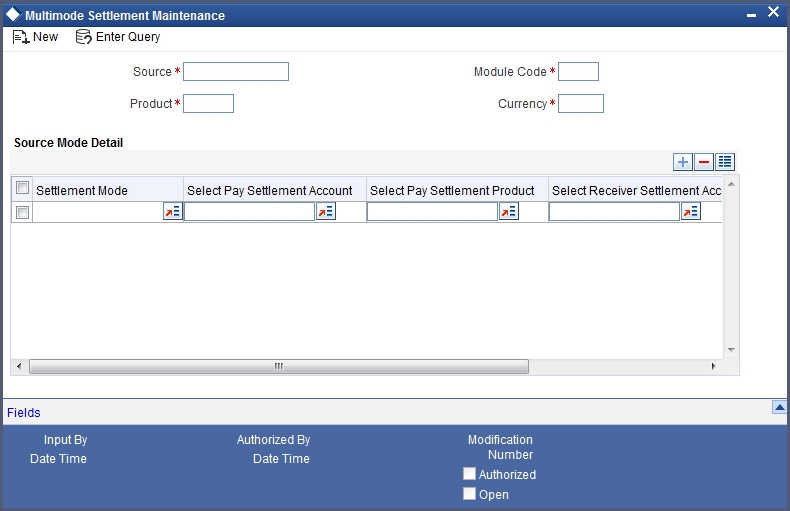

You can capture the different modes of settlement through the ‘Multimode Settlement Maintenance’ screen. You can invoke this screen by typing ‘ISDSRCMD’ in the field at the top right corner of the Application tool bar and clicking the adjoining arrow button. The modes are captured for a Source, Module, Product and Currency combination.
The following details have to be captured in this screen:
Source
Oracle FLEXCUBE interfaces with other external systems of your bank. Transactions originating in external systems may require to be uploaded into Oracle FLEXCUBE for further processing. For maintaining the settlement modes for such transactions, you have to indicate the source code of the external system here. The source codes of all external systems are available in the option-list provided from where you can make the appropriate selection.
You may use the Source Code ‘Oracle FLEXCUBE’ to maintain settlement modes for transactions originating in Oracle FLEXCUBE.
Module
You have to specify the module of the transactions that have to be settled using different modes. The value of this field is defaulted to CL (Consumer Lending). You cannot modify this value.
Product
Here, you have to indicate the product of the transactions that have to be settled using different modes. The option-list will display the different products available under the selected module. You may also use the wild character ‘****’ as the product code. The system will use this information if settlement mode maintenance is not available for a product under the selected module.
Currency
You have to specify the currency of the transactions that have to be settled using different modes. You may also use the wild character ‘***’ for a currency. This will be used if maintenance for a specific currency is not available.
For the above combination of Source, Module, Product and Currency, you can maintain multiple settlement modes and the associated details given below:
Setl Mode
For the selected combination, you have to specify the settlement mode. The list of available modes is predefined in the system and you can select a mode from the drop-down list. Since CL is the module used for the multimode settlement the different modes available are:
Pay Setl Ac
For the selected settlement mode, you have to specify the Suspense/Control GL into which the transactions (that satisfy the selected combination) need to pass the accounting entry. This GL will be used only when the bank is making a payment. The settlement account gets credited in this case.
Pay Setl Prod
For the selected settlement mode, if the originating transaction results in a linked transaction, you need to specify the product that should be used to create the linked transaction. This product will be used when the settlement account gets credited. For example, if the settlement mode is ‘DD’, you have to specify the product code (i.e. the DD instrument type) for creating the corresponding instrument transaction in Oracle FLEXCUBE.
Recv Setl Ac
Just as you specify the pay settlement account for the mode selected, you also have to indicate the Suspense/Control GL into which transactions (that satisfy the selected combination) need to pass the accounting entry when the bank receives a payment. The selected account gets debited in this case.
Recv Setl Prod
If the originating transaction (payment received) results in a linked transaction, you have to specify the product to be used to create the linked transaction. This product will be used when the settlement account gets debited. For instance, if the settlement mode is ‘External Cheque’, you have to specify the clearing product to be used for creating the clearing transaction.

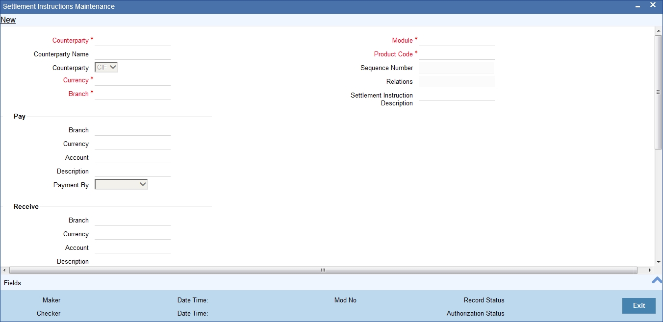

You can maintain the settlement preferences of a customer or a bank in the ‘Settlement Instructions Maintenance’ screen. You can invoke this screen by typing ‘ISDINSTN’ in the field at the top right corner of the Application tool bar and clicking the adjoining arrow button.
Indicating preferences for an entity means defining the settlement accounts and a detailed settlement route comprising the correspondent accounts and the intermediaries through which payment is to be routed. (The party information you can capture adheres to SWIFT standards.).
You can maintain the following basic settlement preferences for an entity (Customer /BIC), module, currency, product, Sequence Number and branch combination.
Counterparty Type
The Counterparty Type can either be CIF or BIC depending on whether your bank has an accounting relationship with the party for whom the instruction is being maintained or whether it only has a SWIFT messaging relationship. If the counterparty is a CIF in Oracle FLEXCUBE, you will have to select CIF as the party type and choose the relevant CIF ID in the adjacent field.
However, if the entity is not an actual customer of your bank but you would be sending/receiving payment messages to/from that party, you will have to choose BIC as the counterparty type and specify the counterparty’s address as well. As a result, you will need to identify the preferred Nostro/ Vostro accounts for that currency and BIC code combination.
Note
While processing an FT for the customer the appropriate charge account is picked up depending on the customer, currency and branch processing the FT.
In addition, you can maintain the details of the various intermediaries involved in payments and receipts. The preferences maintained for an entity determine the manner in which money settlements are made on behalf of the entity.
Counter Party
You can maintain settlement instructions for all the customers or for specific customers only. From the option list select the specific customer number or choose the ALL option
Counterparty Name
The system displays the name of the specified counterparty based on the details maintained at ‘Customer Maintenance’ level.
Module
You can maintain different settlement instructions for different products. If you choose Module as ‘ALL,’ then the Product must also be chosen as ‘ALL’. If you choose a specific module for maintaining settlement instructions, then you can choose any Product available under the module from the option list provided. You can also choose ‘All’ to maintain settlement instructions for all products under the selected module.
Product Code
Indicate a specific product code or choose All from the option list. However, if you have chosen All in the Module field, this field will be defaulted to ALL. You will not be allowed to change this.
Currency
You can maintain settlement instructions for a particular currency or for all the currencies From the option list select the particular currency code or choose the ALL option.
Branch
You can maintain settlement instructions for all the branches or for a particular branch. From the option list select the particular branch code or choose the ALL option.

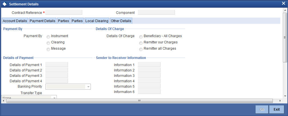

Payment By
Indicate the method of payment for both Outgoing as well as Incoming Payments, for a Branch, Account and Currency combination. The following options are available:
Note
You can indicate the payment method as ‘Clearing’ only,
No payment message will be generated for settlements routed through a Clearing House.
Note
You can select ‘Payment By’ as ‘Instrument’, to ensure the payment by Instrument in SI settlements screen and then the system would look for the instrument type.
Charge Details
Specify whether charges for the message are to be borne by the bank (ourselves) or the beneficiary, or will be shared. This information is inserted in Field 71A of an MT103 message involving the combination for which settlement instructions are being maintained. You can select one of the following options:

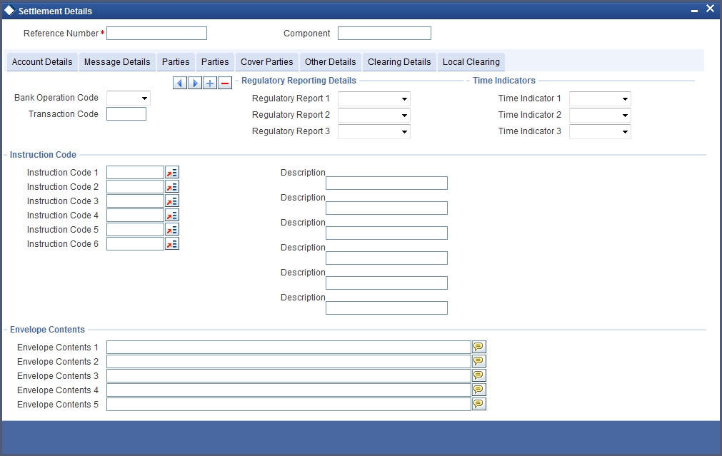

Settlement Through an Instrument or Message
When the actual settlement event for a contract (involving the entity) takes place, the payment and receive message details are updated in a message hand-off table. The Messaging system picks up the details from this table, and based on the formats set up, generates the messages.
Depending on the route funds take when you receive (incoming) payments, you can maintain Intermediary and Beneficiary Institutions in the ‘Receive Parties’ section of the ‘Settlements Instructions Maintenance’ screen.

Clearing Network for Local Clearing in Settlement Instructions
You can specify a clearing network during settlement instruction maintenance for the Pay Leg and the Cover details. This will be defaulted as part of Settlement pick-up during Contract input and used subsequently while generating a PC Contract.
The Counter-party name shows the list of Bank Codes for Cover Transfer and Bank Transfer. The system will validate that the Bank Code Type for both the Counter-party name and Counter-party Bank Code is the same. For Customer transfers, this would be a user enterable field.
You can define the default values for fields in MT 103 messages that are generated in respect of contracts involving the customer. When a contract is entered for the customer in any module, the values that you maintain here will be defaulted for MT 103 generation in respect of the contract.
You can maintain these details in the ‘Other Details’ tab in the ‘Settlement Instructions Maintenance’ screen.
You can maintain the default MT 103 values for the following fields:
Bank Operation Code
You can indicate the bank operation code that will be inserted in Field 23B of the MT 103 message. The options available are SPRI, SSTD, SPAY and CRED.
Note
If the Bank Operation Code contains SPAY, SSTD or SPRI, the following validations will be done:
Instruction Code
You can indicate the Instruction code that will be inserted in Field 23E of the MT103 message. The options available are CHQB, TELE, PHON, PHOI, REPA, INTC, TELI, SDVA, PHOB, TELB, HOLD, CORT and BONL.
Instruction Code Description
You can specify the additional information, if any, which would be inserted to qualify the Instruction Code in Field 23E of the MT103 message. The instruction code description can only be maintained for the instruction codes PHON, PHOB, PHOI, TELE, TELB, TELI, HOLD or REPA.
For instance, if the Instruction Code is REPA and the description is ‘Repayment’ then the text ‘REPA/Repayment’ is inserted in Field 23E.
Transaction Type
You can indicate the Transaction Type that will be inserted in Field 26T of the MT103 message.
Regulatory Reporting Details
You can indicate the Regulatory Reporting Details that will be inserted in Field 77B of the MT103 message.
Charges Details
You can indicate whether charges for the message are to be borne by the bank (ourselves) or the beneficiary, or will be shared. You can specify this in the Charges Details section, in the main Settlement Instructions screen.
This information is inserted in Field 71A of the MT103 message.

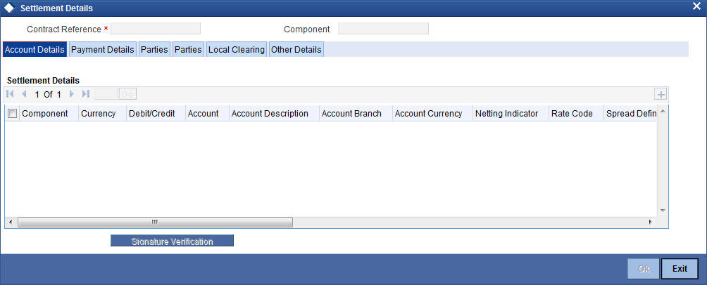

While processing a contract you can modify the following information pertaining to Settlements:
In the Settlement Instructions screen you would have maintained the settlement accounts for an entity, module, currency and branch combination.
While processing a contract, these details will be defaulted to the Settlement sub-screen of the contract main screen. You have the option of changing any or all of the settlement accounts while processing a contract.
The account details that get defaulted include the following:
Note
Account Description
The system displays a brief description on account.
Netting Indicator
In addition to maintaining a netting agreement for each counterparty, you have to specify whether or not the contract is under the netting agreement for each contract involving the counterparty.
Check this box to indicate that you would like to enable the Netting option for the various components (Amount Tags) involved in the transaction. These components could be commission, interest, tax, charges etc.
Rate Code
Specify rate code by selecting appropriate rate code frx‘om selection list. Following values are available:
Note
In case of charges, if charge currency and settlement currency are different, system applies mid rate.
Spread Definition
Select the spread definition from the adjoining drop-down list. The options available are:
Customer Spread
This defaults from your specification of tenor-wise spread for the relevant Currency Pair in the Customer Spread Maintenance screen. You can change this for a specific contract.
Original Exchange Rate
If the component currency is different from the account currency, the system requires an exchange rate for the conversion. The components of the final exchange rate used for conversion are:
The final exchange rate = Base Rate +/- Customer Spread (depending on whether it is a Buy or a Sell deal).
Note
If Customer Spread details for a specific counterparty (for the currency pair) are unavailable, the System looks for the customer spread maintained for the wildcard ALL entry. If even that is not available, then the Customer Spread defaults to zero.
The method of spread definition, whether percentage or points is also displayed.
Note
If you have specified an account that uses an account class that is restricted for the product, an override is sought when you attempt to save the contract.

The details of the payment have to be specified in the ‘Payment Details’ screen..
Payment By
Note
Depending on the method in which you want to settle the contract, you should specify either Instrument or Message details.
Details of Charge
In this section you can maintain details of the party who will bear the charges incurred in processing the transaction. It could be either:
Note
In FT Module, ‘Details of Charges’ is selected on the basis of value selected in ‘Charge Bearer’ field in the ‘Other Details’ tab.
Note
Here you can specify information, from the Ordering Party to the Beneficiary Customer, about the reason for the payment.
This field can contain reference numbers, invoice numbers or any other details, which will enable the Beneficiary to identify the transaction. This information is to be passed through the payment chain to the Beneficiary.
This field corresponds to field 70 of S.W.I.F.T. Refer to the S.W.I.F.T. manual for details on the code words and the format of the message you can input.
Banking Priority
Select the priority of the payment messages from the drop down list. The options available are:
The default value is Normal.
Information 1,2,3,4,5 and 6
This could be instructions or additional information for the Receiver, Intermediary, Account With Institution or Beneficiary Institution.
This field corresponds to field 72 of the S.W.I.F.T. message. The format of the message depends on the type of S.W.I.F.T. message that is generated. Refer to the S.W.I.F.T. manual for details on the format of the message and the code words to be used.
Clearing Network
Cover details for local clearing will capture Clearing Network. This clearing network will be defaulted during Contract Input and be used subsequently for PC Product resolution while generating a PC contract.

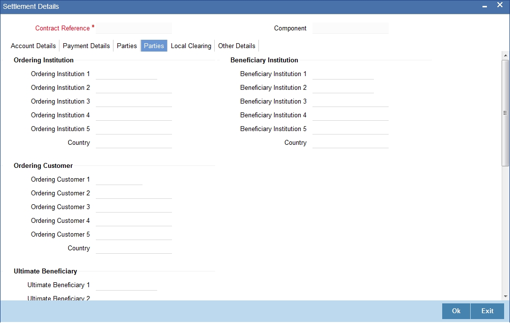

Ordering Institution
The Ordering Institution is the financial Institution, which is acting on behalf of itself, or a customer, to initiate the transaction. This field corresponds to 52a of SWIFT. In this field, you can enter one of the following:
Country
Specify the country of the ordering institution. This adjoining option list displays all valid country codes maintained in the system. You can choose the appropriate one.
Ordering Customer
The Ordering Customer refers to the customer ordering the transfer. Here, you can enter the name and address or the account number of the Customer, ordering the transaction. This field corresponds to field 50 of SWIFT. You will be allowed to enter details in this field only if you have initiated a customer transfer (MT 103 and MT 102). In case of an MT 910, a credit confirmation message, the first line should contain number ‘1’ in option F of field 50.
Country
Specify the country of the ordering customer. This adjoining option list displays all valid country codes maintained in the system. You can choose the appropriate one.
Here, you can enter details of the institution in favor of which the payment is made. It is in reality the bank, which services the account of the Ultimate Beneficiary. This is applicable only in the case of bank transfers and not for customer transfers. This field corresponds to field 58a of SWIFT
You will be allowed to make entries into this field only for Bank Transfers (when the remitter and beneficiary of the transfer are financial institutions –MT 202). Here you can enter either:
Country
Specify the country of the beneficiary institution. This adjoining option list displays all valid country codes maintained in the system. You can choose the appropriate one.
The Ultimate Beneficiary refers to the Customer to whom the amount of the component is to be paid. This field refers to field 59 (is this now 59A) of SWIFT. You can make entries into this field only for a customer transfer (MT 103 or MT 100). This would not be applicable for Bank Transfers, only for Customer Transfers.
You can also select an ultimate beneficiary account from the option list provided. Upon selection of the account, the Account with Institution of the selected ultimate beneficiary will appear by default in the AWI field in the Parties 1 tab. If no selection is made for AWI in the Parties tab 1 screen, then all accounts of ultimate beneficiaries existing in the system will be appear for selection.
Country
Specify the country of the ultimate beneficiary. This adjoining option list displays all valid country codes maintained in the system. You can choose the appropriate one.
Note
The country information is captured to enable Mantas to analyse the transactions for possible money laundering activities.
For more details on Mantas, refer 'Mantas' interface document.
When the SWIFT message is captured in the ‘Settlement Message Details – Parties’ screen, the system will display the parties involved in the transaction based on the values that come in the fields 52, 54, 55, 56, 57 58 etc. However, you can change the parties by choosing the appropriate value from the respective option lists. In case of the messages MT 103, MT202 and MT210, the option lists will display only those BICs for which the option ‘BEI Indicator’ is unchecked in the ‘BIC Code Maintenance’ screen. However you can manually enter a BIC for which the option ‘BEI Indicator’ is checked. During message generation, the system will replace the BIC with the corresponding name and address of the party.
The number of banks/intermediaries involved in the transfer would, in practice depend on the:
Note
During the life-cycle of a contract you will be allowed to amend the details of a Settlement Instruction only for those components which are yet to be settled.

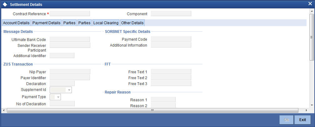

You can maintain the local clearing details here.
Ultimate Bank Code
Select the ultimate bank code from the adjoining option list.
Sender Receiver Participant
Specify the sender receiver participant.
Additional Identifier
Specify the additional identifier.
Payment Code
Specify the payment code.
Additional Information
Specify additional information, if any.
Nip Payer
Specify the nip payer.
Payer Identifier
Specify the payer identifier.
Declaration
Specify the declaration.
Supplement Id
Select the supplement Id from the adjoining drop-down list.
Payment Type
Select the payment type from the adjoining drop-down list.
No of Declaration
Specify the number of declaration.
Free text 1, 2 and 3
Specify free text, if any.
Reason 1, 2, 3 and 4
Specify the reason for repair.
Receiver Name
Specify the receiver name.
Address 1,2 and 3
Specify the address here.
Information 1, 2, 3, 4, 5 and 6
Specify the sender receiver information here.
Information 1, 2, 3 and 4
You can maintain the other details here.
Bank Operation Code
Transaction Code
This is the code for the transaction type. This field corresponds to field 26T of the MT103 message.
Instruction Code 1, 2, 3, 4 and 5
You can indicate the Instruction code that will be inserted in Field 23E of the MT103 message. You can specify a maximum of six instructions codes here. However, you cannot repeat any code that has already been specified. The options available are:
You can specify the additional information, if any, which would be inserted to qualify multiple Instruction Codes in Field 23E of the MT103 message. The instruction code description can only be maintained for the following instruction codes
You can select the Regulatory Reporting Details from the option list displaying the following values:
The chosen value will be inserted in Field 77B of the MT103 message.
Time Indicators
Time Indication, specifies one or several time indication(s) related to the processing of the payment instruction. Select the time indication code from the following values available in the option list:
In the Settlement Instructions screen you would have maintained the default values for fields in MT 103 messages that are generated in respect of contracts involving an entity, module, currency and branch combination.
When a contract is entered for the customer in any module, the values that you maintain here will be defaulted for MT 103 generation in respect of the contract, and you can view them in the Settlement sub-screen of the contract main screen.
While amending a contract, you can modify the settlement information on the following tabs:
Save the contract once you have made the required changes. The system validates the modified information as in case of a new settlements operation.
