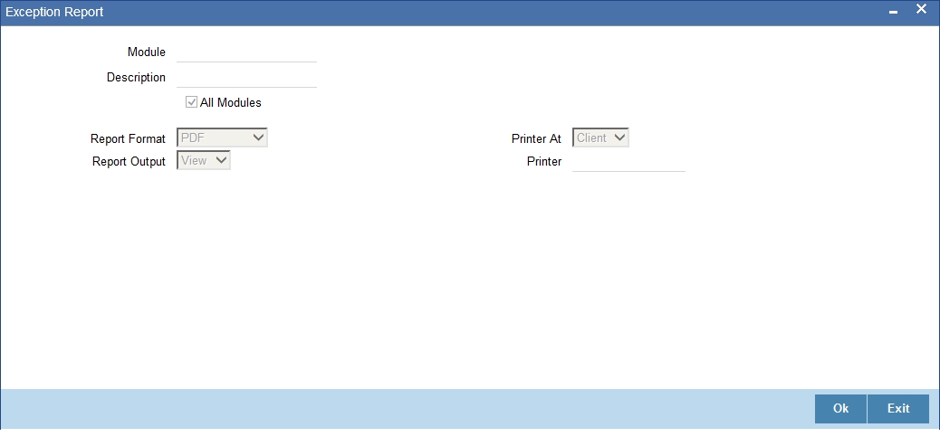

The report gives details of overrides accepted during transaction processing.(for example, Available Balance * for * is less than the Min balance for the A/c Class, Signature Verification not done, etc. You can specify the period for which you require the report when you invoke the report function. In the Application Browser, this report is available under the Signature Verification module.
To invoke this screen type ‘SVROV in the field at top right corner of the Application tool bar and click the adjoining arrow button.
The contents of this report are discussed under the following heads:
Header
The Header carries the title of the report, information on the branch code, the ID of the user who generated the report, the date and time at which it was generated, the branch date, the modules covered in the report.
Body of the report
The following details are displayed in the report.
