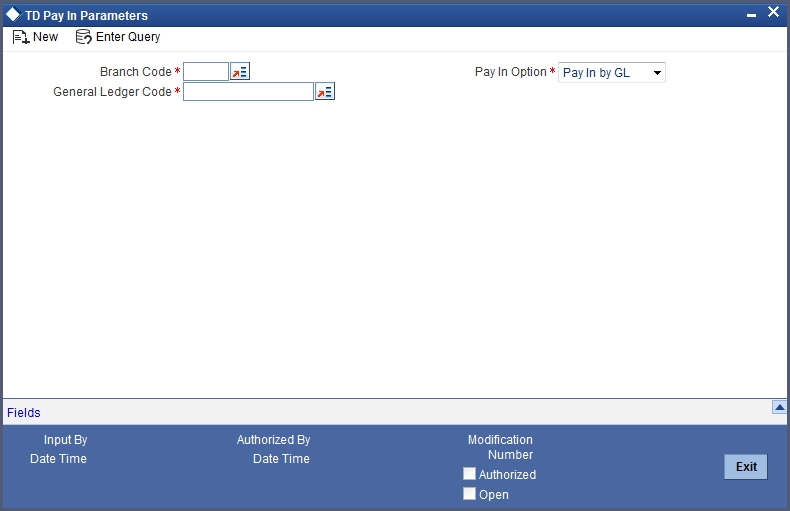

In case you have specified that the TD Pay-in be done by GL, you need to maintain the GL details through the ‘Term Deposit Payin Parameters Maintenance’ screen. You can also invoke this screen by typing ‘STDTDPAY in the field at the top right corner of the Application tool bar and clicking the adjoining arrow button.
To link appropriate GLs in case the pay in option chosen is pay in by GL, you need to maintain the following details:
Branch Code
Specify the branch code for which you want to maintain payin parameters. The adjoining option list displays all valid branch codes maintained in the system. You can select the appropriate one.
Pay-in Option
Select the pay-in option from the adjoining drop down list. The options available are:
General Ledger Code
Specify the GL code that should be picked up the system for the TD pay in. The adjoining option list displays all valid GLs maintained in the system. You can select the appropriate one.

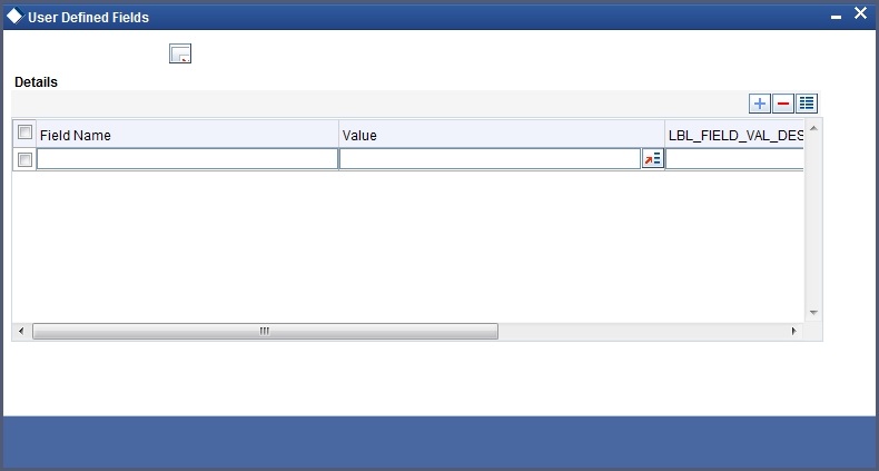

All User Defined Fields (UDFs) linked to the function ID ‘STDTDPAY’ are displayed in the ‘User Defined Fields’ screen. Invoke this screen by clicking ‘Fields’ button on the ‘Term Deposits Payin Parameters Maintenance’ screen.
Here you can specify values for each UDF.
Refer the User Manual titled ‘User Defined Field’ for details about defining UDFs.

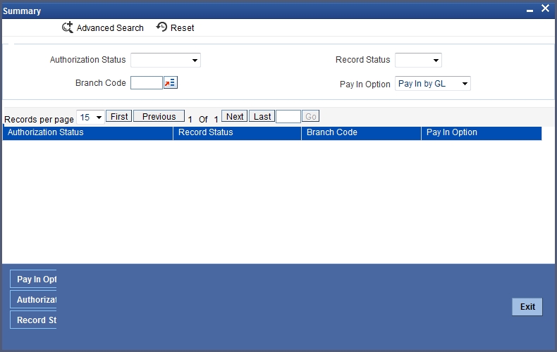

You can view summary of all payin parameters using the ‘Term Deposit Payin Parameters Summary’ screen. To invoke this screen, type ‘STSTDPAY’ in the field at the top right corner of the Application tool bar and click the adjoining arrow button.
You can query on records based on any one or all of the following criteria:
Click ‘Search’ button. The system identifies all records satisfying the specified criteria and displays the following details for each one of them:
Double click on a record to invoke the detailed screen for that record.

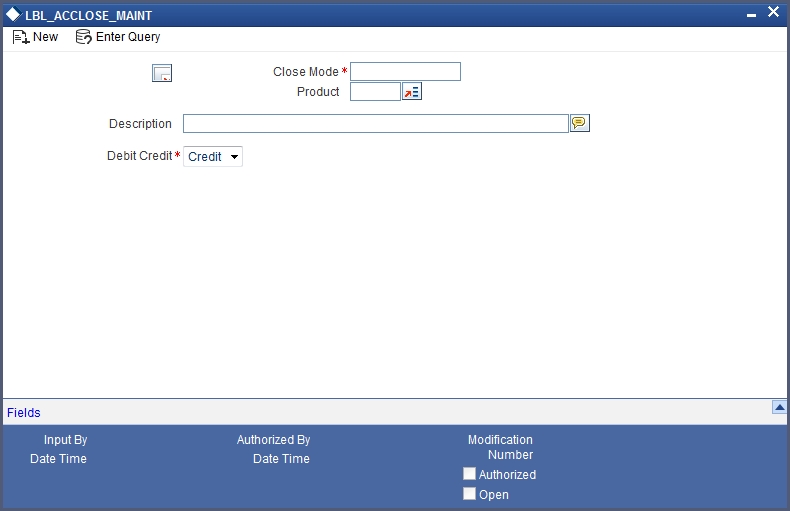

When you close an account the system checks whether any Interest/Charge (IC) products linked to the account are pending liquidation. If the account does not have any IC products pending liquidation the system will display list of ‘Close Out’ modes to facilitate account closure. You can maintain the closing modes using ‘Term Deposit Closing Mode Maintenance’ screen. To invoke this screen, type ‘STDCLOSE’ in the field at the top right corner of the Application tool bar and click the adjoining arrow button.
Specify the following details:
Closing Mode
You need to maintain the following modes:
Note
Description
Give a brief description for the closing mode.
Product
Specify the Retail Teller product that should be used for booking withdrawal entries. It can be any one of the following:
Debit Credit
The closure can be effected by means of a debit or a credit to the account. For each of the aforesaid closing modes, you need to select the ‘Debit’ option from the adjoining drop-down list..
All User Defined Fields (UDFs) linked to the function ID ‘STDCLOSE’ are displayed in the ‘User Defined Fields’ screen. Invoke this screen by clicking ‘Fields’ button on the ‘Term Deposit Closing Mode Maintenance’ screen.

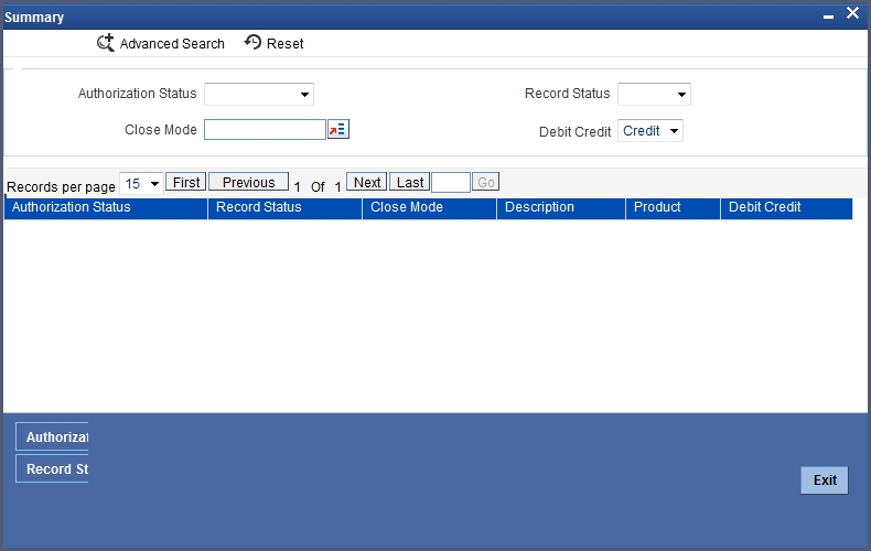

You can view summary of all closing modes using the ‘Term Deposit Closing Mode Maintenance’ screen. To invoke this screen, type ‘STSCLOSE’ in the field at the top right corner of the Application tool bar and click the adjoining arrow button.

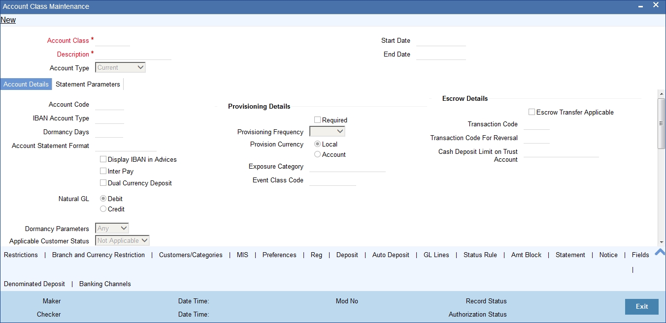

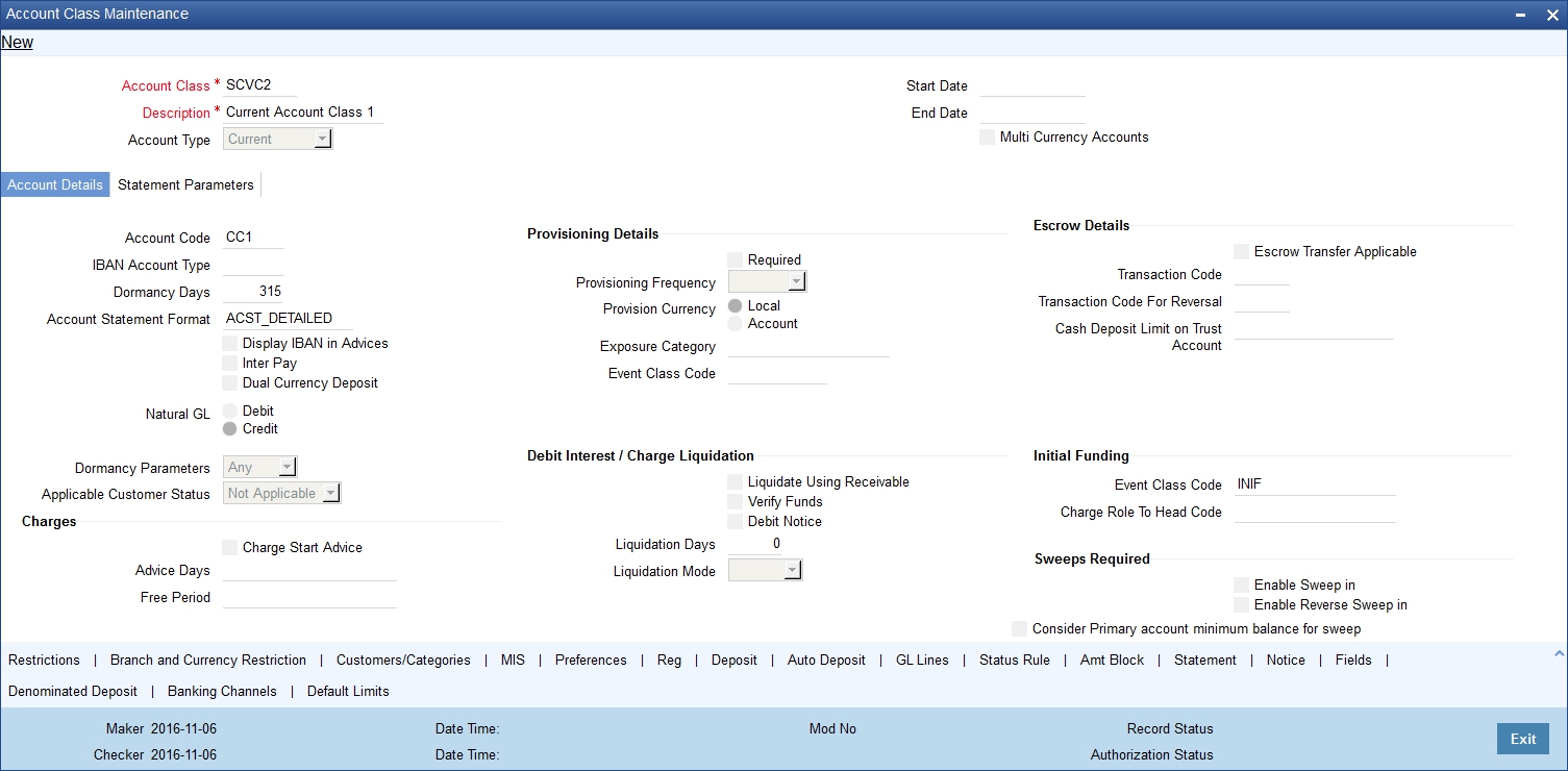

To handle term deposits in Oracle FLEXCUBE, you have to set up an account class of type ‘Deposit’, in the ‘Account Class Maintenance’ screen. To invoke this screen, type ‘STDACCLS’ in the field at the top right corner of the Application tool bar and click the adjoining arrow button.
Account Class and Description
Identify the account class you are setting up with a unique code and a brief description.
Account Type
Select the ‘Deposit’ from the drop-down list.
Start Date
Specify the date from which the account class should become active, using the adjoining calendar. You will be able to create deposit accounts under this account class only from this date.
End Date
You can also specify the life span of the account class by indicating the end date.
The end date for an account class refers to the termination date after which, creation of new account under the account class is disallowed.
Consequently, the option list for Account Class in all further transactions screen in Oracle FLEXCUBE, will not display the ‘expired’ account class as of the system date. However, the existing accounts for the account class will be active even after the end date.
Note
If you do not specify an End Date for the account class, the account is taken to be an open-ended account class.
This tab is displayed by default on invoking the ‘Account Class Maintenance’ screen.
Account Code
As per your bank’s requirement you can choose to classify account classes into different account codes. The bank can decide the manner in which the account classes are to be assigned to different account codes. An account code can consist of a maximum of four characters. Depending on the customer account mask maintained, the value in the account code field would be used during the generation of customer account numbers through the ‘Customer Accounts Maintenance’ screen.
If you have decided to include account code as part of the customer account number (in the account number mask), then at the time of creating a new customer account number, you will need to select the account class for the account number being generated. In the option-list provided, the account class is displayed along with the associated account code. When the account number gets populated, it is the account code that forms a part of the customer account number.
Dual Currency Deposit
Check this box to indicate that account class is for creating dual currency deposits. You can check this box only if the account type is ‘Deposit’.
Natural GL
The reporting of all turnovers of the particular account class will be directed to the GL that you identify as the natural GL. Based on the characteristic of the account balance; you can specify whether the turnover is to be posted to the Debit GL or to the Credit GL. Deposit accounts normally have a credit balance.
Applicable Customer Status
Select the applicable customer status to indicate whether deposit product is available to minors or not. You can choose one of the following values from the adjoining drop-down list:
Note

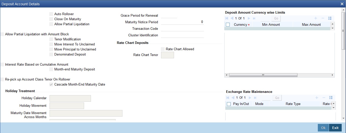

Click the ‘Deposits’ button to define the parameters for a deposit type account class. The ‘Deposit Account Details’ screen is displayed.
On the maturity date of a deposit, you can opt to:
The values given here will be defaulted when the TD is opened. You can modify defaulted values for each TD.
Auto Rollover
You can opt to automatically rollover a deposit if it is not liquidated on its maturity date. Check this box to automatically rollover deposits opened under the account class. TDs that are open and marked for Auto Rollover will automatically be rolled over during the Beginning of Day operations on the Maturity date. You can define the terms and conditions for the new deposit while maintaining the deposit account.
Close on Maturity
Deposit accounts opened under an account class can be closed automatically on the Maturity Date of the deposit. You can specify this for the account class you are maintaining by checking this box.
If you check this box, then during the Beginning of Day operations on the Maturity Date, the account will be closed. The principal will be moved, if specified, to the account your customer has directed. In case you don’t check this box and the deposit remains unclaimed, you can opt to move the principal and interest to the respective ‘Unclaimed GLs’ maintained at your bank.
Note
If you check the ‘Auto Rollover’ box, you will not be able to check ‘Close on Maturity’ box. Your specifications here will default to all deposit accounts opened under the account class. However, when maintaining a deposit account, you can change the specifications that default.
You have to check this box mandatorily, if you had checked the box ‘Recurring Deposit’ in the ‘Deposit Account Details’ screen.
Allow Partial Liquidation
Check this box to indicate that partial redemption is allowed. If ‘Allow partial Liquidation’ is not checked, then partial redemption will not be allowed on term deposits under this account class.

Tenor Modification
Check this box if you intend to avail a tenor modification facility for a Term Deposit Account,
Move Interest to Unclaimed
Check this field to move the interest amount to the unclaimed GL mapped at the IC product in the accounting role ‘INT_UNCLAIMED’ on maturity date or grace period end date of the term deposit account.
Move Principal to Unclaimed
Check this field to move the principal amount to the unclaimed GL mapped at the IC product in the accounting role ‘PRN_UNCLAIMED’ on maturity date or grace period end date of the term deposit account.
Note
Rate Chart Allowed
Check this box to indicate that the system should calculate TD interest based on the LDMM float rate maintained in the ‘LD MM Floating Rate input’ screen (‘CFDFLTRI’), If you check this box, the system will pick interest rates based on different tenors, amount slab, currency and effective date for a TD. The rate is picked up at the time of booking. The rate is further picked up only at the time of liquidation/ rollover/ redemption operations based on re-population flag at IC product level.
You will not be able to modify this preference once the record is authorised.
Re-pick up Account Class Tenor On Rollover
Check this box to enable re-pick up of the account class tenor on rollover. If you check this box, the system will default the rollover tenor as 'Account Class Tenor'. During rollover, the system will pick up the default account class tenor.

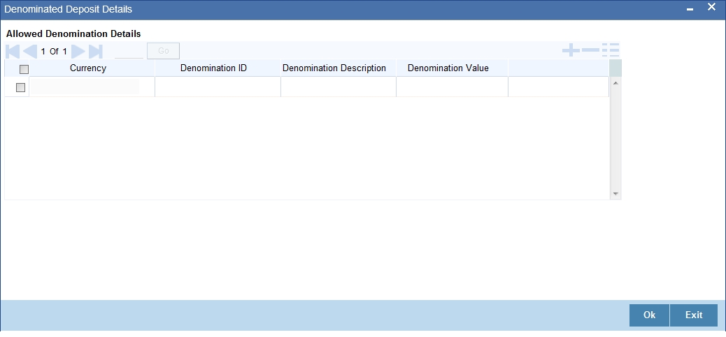

Denominated Deposit
Check this box to allow opening of denominated deposits. This box is automatically selected during save, if the Denomination details are maintained for the account class at the ‘Denominated Deposit Details’ Tab.

Month-end Maturity Deposit
Check this box to indicate that the deposit is a month-end maturing deposit, i.e., the deposit matures on the last working day of the month.
If this box is checked at the account class, then during deposit input, if the account opening date is the last working day of the month and the maturity date is the last day of the subsequent month, then you have to enter the tenor in Months only. If this box is un-checked, then the deposit is not considered as an month-end maturing deposit even though the deposit is opened on the last working day of the month and the tenor of the deposit is across months.
During TD opening, a deposit is considered as a month-end maturing deposit only if the following criteria are met:
An account class with ‘Month-end Maturity Deposit’ box checked can also have deposits that are not month-end maturing deposits. A deposit is classified as an ordinary deposits (not month-end maturing deposit) if the following criteria are met:
Note
Grace Period for Renewal
Specify the grace period for renewing a TD. Only if grace days are provided, the TD can be renewed using the ‘Term Deposit Redemption’ screen (ICDREDMN) or ‘Renewal Simulation’ screen (ICDREDRN) upon maturity of the TD. This option is applicable only for deposits whose interest and principal is moved to unclaimed GLs upon maturity. If you check the ‘Auto Rollover’ box or the ‘Close on Maturity’ box, the system will ignore the value that you specify here. In other words, grace period will not be applicable on the maturity date in case of auto rollover or closure of the account.
After the account has matured, renewal of the TD is possible from the beginning of day (BOD) of the maturity date to the end of day (EOD) of the grace period. The TD gets renewed with the value date as of the maturity date when the grace period is valid.
The counter for the grace period is ‘0’ on the maturity date. It is incremented by 1 during EOD processing of every subsequent day. When the grace period counter is ‘0’, TD renewal is possible before start of the EOD as of the maturity date. When the grace period counter goes to ‘1’, TD renewal is possible before start of the EOD of the (maturity date +1),and so on.
Refer the section ‘Redeeming a TD’ and ‘Transferring to Unclaimed Deposit on Maturity’ in this User Manual for details about TD redemption and application of grace period respectively.
Grace period is maintained only at the account class level. You cannot modify it at account level.
Maturity Notice Period
Specify the number of days before which the notification is to be sent for TD maturity. If ‘N’ days is mentioned, then the notification will be sent ‘N’ working days prior to the TD maturity date. The default value is zero.
Settlement Bridge GL

You can top-up an existing Term Deposit by adding funds to the TD account.You can allow or disallow top-up and also define the top-up block duration after opening date and top-up block duration before maturity date. The block duration are considered as calendar days based on the account branch holidays.
Allow top-up of Deposit
Check this box to indicate that you can top-up funds to an existing term deposit. By default this box is not checked.
Block Duration after Opening Date
You can specify the duration for which the term deposit top up has to be blocked after the account opening date. The block duration after Opening date (Days / Months) should not be greater than the max tenor at the account class.
Months
Specify the number of months for which the term deposit top-up has to be blocked after the account opening date.
Days
Specify the number of days for which the term deposit top-up has to be blocked after the account opening date.
Block Duration Before Maturity Date
You can specify the duration for which the term deposit top-up has to be blocked before the account maturity date. The top-up can be done any time before the maturity date (i.e. in term) of the deposit if there is no block duration defined. The block duration before maturity date (Days / Months) should not be greater than the max tenor at the account class.
Months
Specify the number of months for which the term deposit top-up has to be blocked before the account maturity date.
Days
Note
The sum of block duration after opening date and block duration before maturity date should not be greater than the max tenor at account class. If not, system displays the error message "Block duration cannot be greater than maximum tenor allowed".
Interest Rate
Select the interest to be applied on the top-up deposit, from the adjoining drop-down list. The options available for selection are:
Note
Dual Currency Deposit (DCD) is a short-term currency-linked deposit through which you earn a higher interest rate than regular term deposits. The Bank converts the deposit currency into the linked currency at the pre-determined conversion rate on the fixing date two working days prior to deposit maturity. At maturity you receive the principal and interest in either the deposit currency or the linked currency, whichever is weaker.
The following details are captured here;
Linked Currency
Specify the linked currency if the account class is to be used for creating TD with Dual Currency option. Alternatively, you can also choose the currency from the adjoining option list.
Note
You will be allowed to capture this value here only if the option ‘Dual CCY Deposit’ is checked at the ‘Account Class Maintenance’ screen. You will be allowed to modify this value even after authorization.
Currency Option Product
Specify the currency option product under which an Options contract has to be created in case of a Dual Currency deposit. The adjoining option list displays all valid Options products with Product Type ‘CO’, with the following features.
On saving the account class, system validates the following to ensure that the currency option product selected here has the below features:
Fixing Days
Specify the number of days from TD maturity date, before which the exchange rate has to be fixed. On maturity, the exchange rate at the time of booking and the exchange rate at the time of fixing date are compared to determine the currency in which TD amount should be settled.
Note

You can maintain various denominations of the denominated certificates per currency using ‘Denominated Deposit Details’ screen. Only the denominations maintained in this screen can be used for issuance of denominated certificates under this account class.
To invoke this screen click the button ‘Denominated Deposits’ on the Account Class Maintenance’ screen.
The following details are captured here:
Currency
If inventory module is allowed, select a valid currency code for which the denomination ids are maintained in inventory module. If inventory module is not allowed then select any valid currency code maintained in the system.
Denomination ID
If inventory tracking is ‘YES”, then select the denomination id available at the inventory module. If inventory tracking is ‘NO’ then you can specify the required denomination id.
Denomination Description
Enter a description if inventory tracking is not available. If inventory tracking is done then the denomination description of the selected denomination id is defaulted here.
Denomination Value
Specify a denomination value if inventory tracking is not available. If inventory tracking is done then the denomination value of the selected denomination id is defaulted here. For further details about setting up an account class, refer the chapter ‘Maintaining Mandatory Information’ in the Core Entity User Manual.

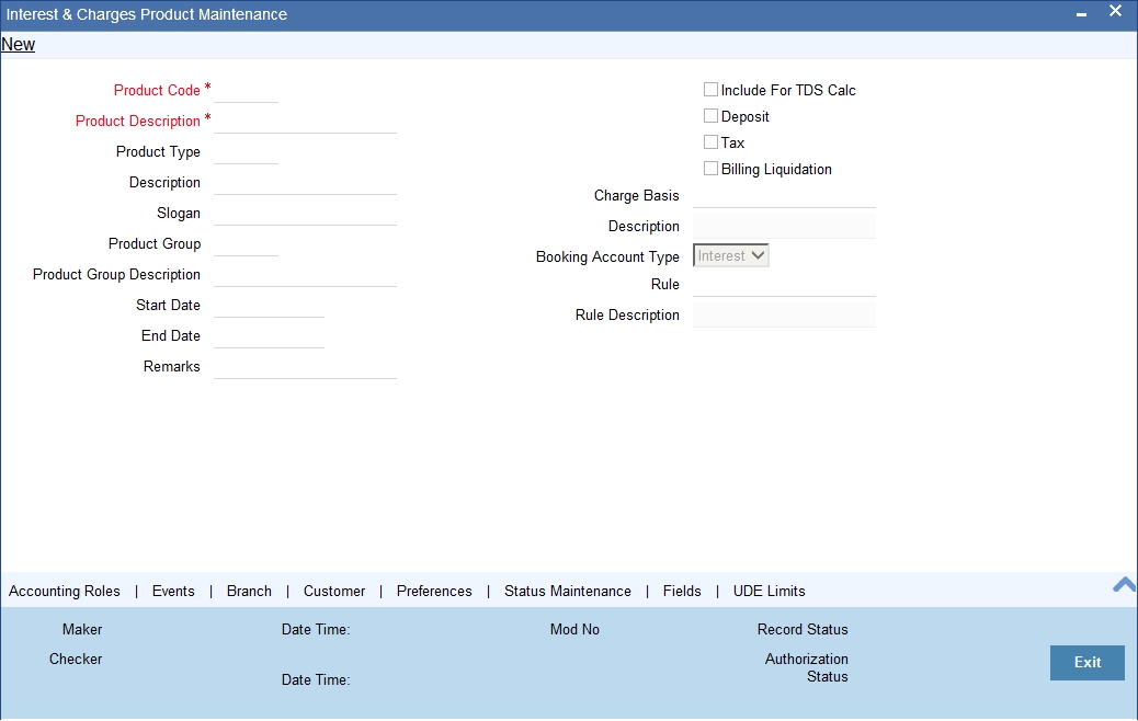

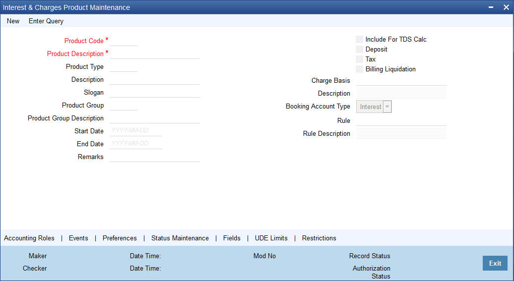

You need to set up an Interest/Charge product to handle the calculation of interest and charges on a TD. You can invoke the ‘Interest and Charges Product Maintenance’ screen by typing ‘ICDPRMNT’ in the field at the top right corner of the Application tool bar and clicking the adjoining arrow button.
Check 'Deposit' to create Deposit Interest product. The booking account type should be maintained as Interest for the deposit product. The accounting roles are generated for the product based on the interest rule maintained at ICDRUMNT.
In case you have checked the option ‘Move Interest to Unclaimed’ and ‘Move Principal to Unclaimed’ in the Deposit Account Details’ screen at the account class level, you will have to specify appropriate accounting roles for the IC product using the ‘Accounting Roles’ screen. Click ‘Accounting Roles’ button on the ‘Interest and Charges Product Maintenance’ screen and invoke the following screen.
Specify the following details in case you have opted for moving interest and/or principal to unclaimed GL:
Accounting Role
Choose 'PRN_UNCLAIMED' ,'INT_UNCLAIMED' and 'MAT_UNCLAIMED' from the adjoining list.
Account Head
Attach 'INT_UNCLAIMED' to a miscellaneous GL for unclaimed interest - for eg '25691234'. Similarly, map 'PRN_UNCLAIMED' and 'MAT_UNCLAIMED' to a miscellaneous GL for unclaimed principal - for eg '25691235'.
You can link the TD Account Class to the Interest product in the ‘Interest and Charges–Interest Product Preferences’ screen. Click ‘Preferences’ button on the ‘Interest and Charges Product Maintenance’ screen and invoke the following screen.

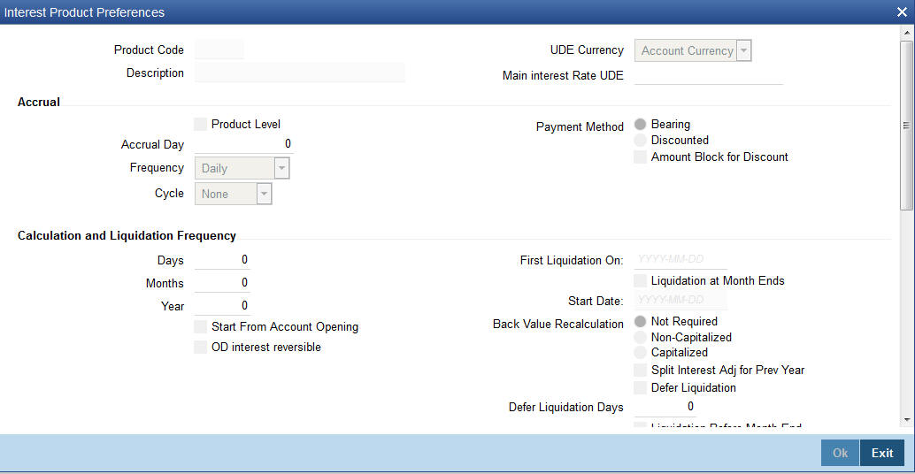

Here you can specify preferences for profit calculation and application on the accounts to which this product is applied.
You can indicate the TD accounts on which this product should be applied.
Account Class
Specify the account class of ‘Deposit’ type that you have maintained for creating TDs. The adjoining option list displays all valid account classes maintained in the system. You can select the appropriate one.
All TDs created under this account class will inherit the interest parameters as maintained in this screen.
You should not link the same account class to multiple IC products. One deposit account class should be linked only to one interest product.
Currency
Specify the currency here. You can book deposit accounts in the currency and account class combination specified at the IC product level.
The system defaults the interest product to account at the time of booking if the account class with the currency combination is linked to the IC product.
Special Condition
Check this box to calculate interest. If Special Condition is checked, then the product is defaulted while booking the deposit account.
Note
While saving the IC product with Deposits checked, special condition is mandatory
Rate Change on Interest Liquidation.
If the box 'Rate Chart Allowed' has been checked for the account class, then you should leave this box unchecked. If this box is checked, then on every interest liquidation new rates are picked up for interest calculation. However, you cannot modify this box once authorized.
Rate Change onRollover
Check this box to re pick up the rate activity on the rollover of TD. The rate is picked up for fixed and rate chart allowed term deposits.
Open
Check this box if the account class and product combination is effective and open for booking deposit accounts. To discontinue the mapping of an account class on an IC product, uncheck this box.

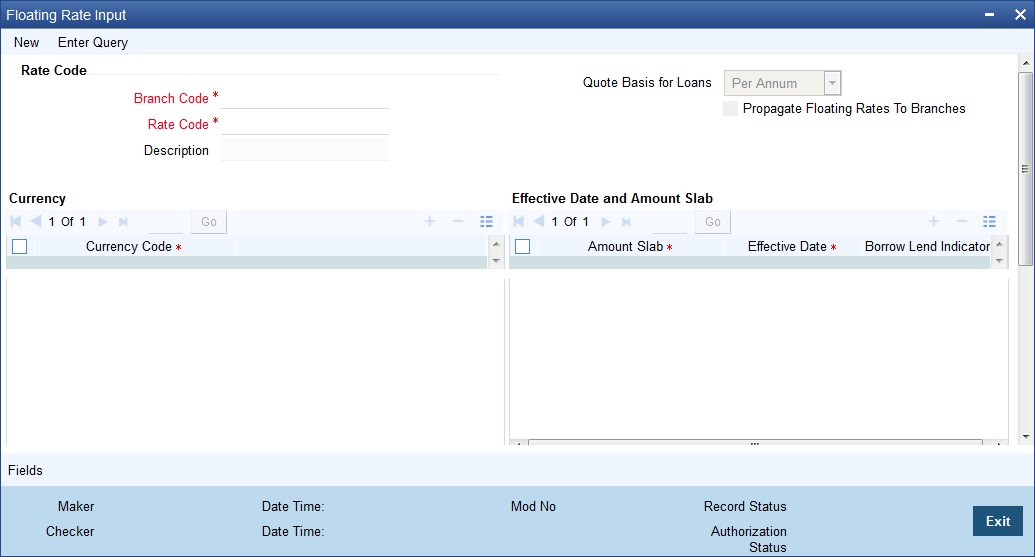

You can apply interest either as a ‘Fixed’ rate or as a ‘Floating’ rate. A floating rate corresponds to the market rates for the day. These rates are maintained and updated daily (or whenever they change,) in the ‘Floating Rate Maintenance’ screen.
You can invoke this screen by typing ‘CFDFLTRI’ in the field at the top right corner of the Application tool bar and clicking on the adjoining arrow button.
The floating interest rates are defined through this screen. A Rate Code identifies a set of rates defined for a combination of Currency, Amount Slab and Effective Date. Also, for each such combination, you can maintain rates that can differ by each tenor.
The following details have to be captured here:
Rate Code and Description
You can maintain new rate codes and also provide values for existing ones (like MIBOR, LIBOR etc). For a new code, you need to capture a unique id. The id can include a maximum 10 alphanumeric characters.
Currency
You have to associate each Rate Code with a currency. You can define rates for the same Rate Code in different currencies. Select a currency from the option list provided.
Effective Date
Each rate that you define for a Rate Code and Currency combination should have an Effective Date associated with it. This is the date on which the rate comes into effect. Once a rate comes into effect, it will be applicable till a rate with another Effective Date is given for the same Rate Code and Currency combination.
Borrow/Lend Indicator
For every Amount Slab - Effective Date combination, you should define the rate to be applied as a borrow rate, a lend rate or a mid rate. Borrow rates are applied for loans taken by the bank and lend rates applied on loans disbursed.
Tenor and Interest Rates
The rates that will be applied for a given combination of Amount Slab – Effective date – Lend/Borrow Indicator can be tenor based. In this screen, you can also define interest rates for different tenors.
For instance, for an amount slab you can maintain rates for the Rate Code LIBOR for tenors 1 - 30 Days, 30 – 90 Days and so on. If you do not maintain tenor wise interest rates, you have to maintain the tenor as ‘0’ and then specify the rate. This is mandatory to save the details.
Note
You can maintain negative values for Tenor and Interest Rates.

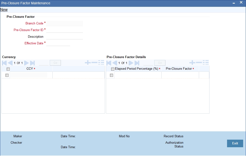

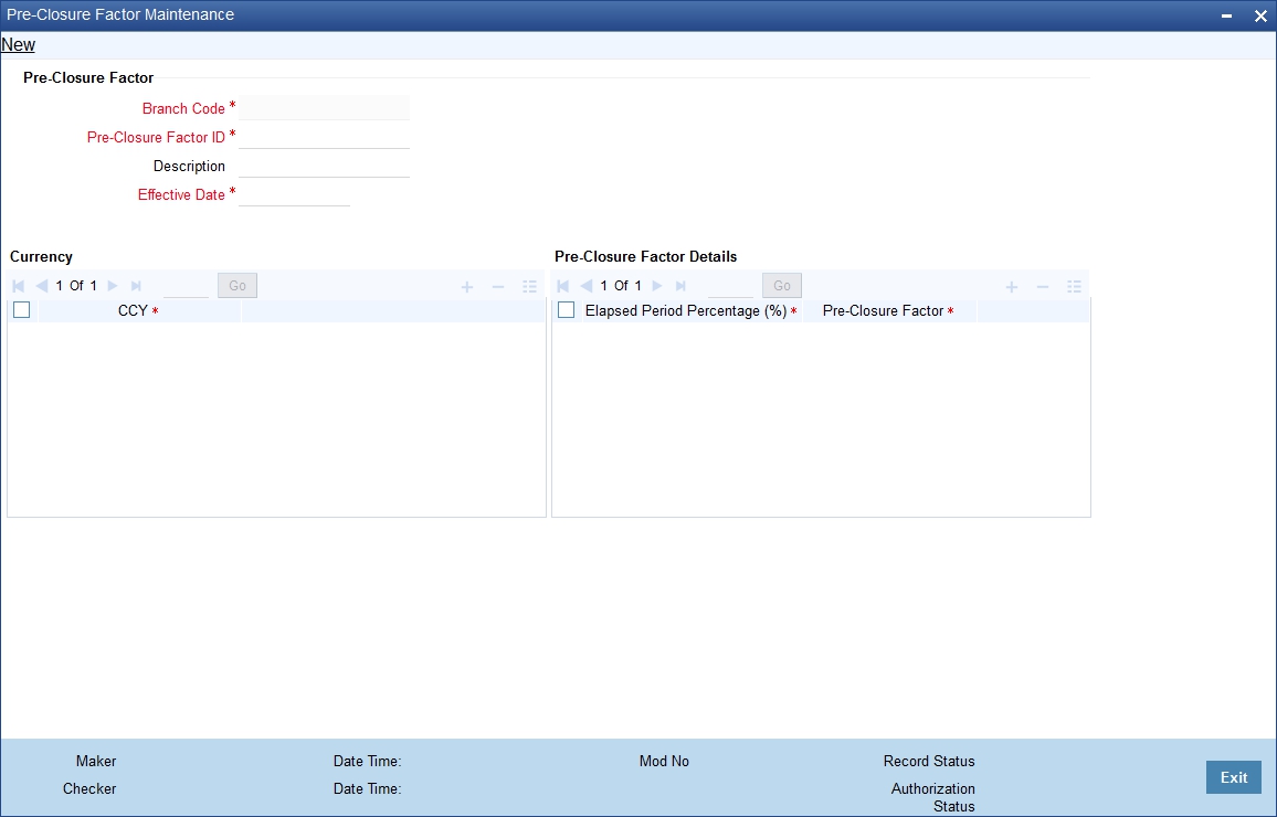

During pre-mature redemption of a Term Deposit, a penalty can be levied on the interest amount. To calculate the penalty amount the pre-closure factor needs to be maintained based on the TD closing period percentage.This maintenance is computed based on the effective date for the currency and TD elapsed period percentage combination.
To maintain this pre-closure factor, you can invoke the ‘Pre-closure Factor Maintenance’ screen, by typing ‘STDPCMNT’ in the field at the top right corner of the Application tool bar and clicking the adjoining arrow button.
You can specify the following parameters:
Branch Code
The system defaults the logged in branch. You cannot modify it.
Pre-closure Factor ID
Specify a unique pre-closure factor ID with effective date. This is a mandatory field.
Description
Specify a brief description of the factor ID to be maintained.
Effective Date
Specify the date from which the factor ID will be effective from the adjoining calendar. A back-date value or a future dated value can be specified in this field. A duplicate date cannot be maintained for the same factor ID.
CCY
Select a valid currency code from the option list. Alternatively, you can select the currency from the option list. The list displays all valid currency codes maintained in the system. You can select a particular currency only once. If you select the same currency more than once, the system displays an error message. You can also select the option ‘ALL’ from the option list.
Elapsed Period Percentage
Specify the percentage of the TD term at which the TD terms lapses. You can maintain multiple TD elapsed period percentages for a currency.
For example: A one year TD deposit is redeemed in 6 months then the Elapsed Period Percentage will be 50%.
For a particular currency, you can maintain multiple TD elapsed period percentage records.
Pre-closure Factor
Specify the pre-closure factor on the basis of the currency and elapsed period percentage maintained. You should specify a value between 0 and 1. The value ‘0’ is not an allowed value.
During pre-mature redemption of the TD, the system calculates the percentage of completed tenor by using the following formula:
(Completed Tenor/Actual Tenor)*100
Based on the completed tenor percentage the pre-closure factor which is maintained in this screen against the elapsed period percentage and the currency combination, is identified by the system. Both the completed and actual tenors are calculated from the account opening date of the deposit account.
Note
The day count method as maintained at the rule level is used for computing the completed and actual tenors. If branch is selected as 'ALL', the pre-closure factor maintained will be propagated to all the branches.
A System Data Element (SDE) ‘PRE_CLS_FACT’ computes the percentage of completed tenor and based on the result identifies the TD elapsed closing percentage and fetches the linked pre-closure factor. If the pre-closure factor is not maintained for a specific completed tenor percentage, then the SDE considers the value as 1.
The SDEs ‘PRE_CLS_LIQ’ identifies the liquidation period during pre-closure of the term deposit. If the interest calculation is performed for the liquidated period and for the redemption amount, SDE ‘PRE_CLS_LIQ’ will return the value as ‘1’.
The SDEs ‘PRE_CLS_ACCR’ identifies the accrual period during pre-closure of the term deposit. If the interest calculation is performed for the accrued period for the redemption amount, SDE ‘PRE_CLS_ACCR’ will return the value as ‘1’.
An SDE ‘PRE_CLS’ identifies whether the TD is redeemed pre-maturely or not. If the redemption is a pre-mature redemption, then the SDE considers the value as 1 or else the SDE considers the value as 0. For a partial redemption, the SDE considers the formula with the condition PRE_CLS = 1 and executes only for the redemption amount not for the remaining amount.
The formula setup is as follows:
