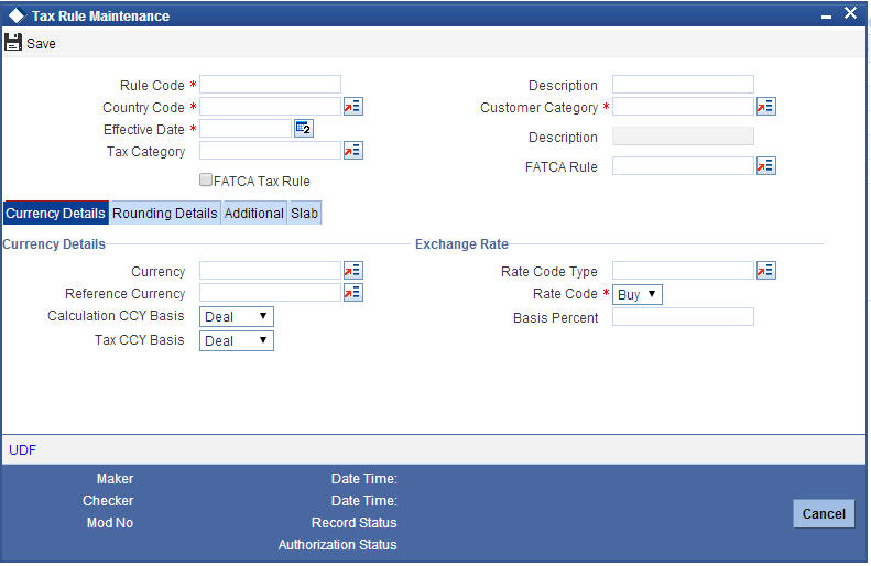

A tax rule identifies the method in which a tax component (a Stock Exchange tax, a Local tax, etc.) is calculated.
You can build tax rules in the ‘Tax Rule Maintenance’ screen. You can invoke this screen by typing ‘TADRULEM’ in the field at the top right corner of the Application tool bar and clicking the adjoining arrow button.
Rule Code
This is the code by which the tax rule is identified. If you are defining a new tax rule, enter its code in this field. You can specify the attributes for this tax rule in the rest of the fields.
If you select an existing tax rule from the Tax Rule Summary View table, the code is displayed in this field. You can select an existing tax rule if you want to perform any of the following operations:

Customer Category
Customer categories are maintained by your bank in the customer maintenance module. These could be categories like banking, corporate, brokers, financial institutions etc. You can choose the customer category for which the tax rule is being defined. You could also choose to define the tax rule for all categories of customers.
Country Code
You can apply specific tax rules based on the country of residence of the customer. Thus individual tax rules for each combination of customer category, country code with an effective date can be maintained. Select the country code for the customer from the option list. Based on the country of residence of the customer, specific tax rules can be applied.

Effective Date
Every tax rule is associated with an Effective Date. On the specified Effective Date, the rule becomes applicable. When more than one rule is linked to a Tax Scheme, a rule will be applied till the next rule for the same component, with a different Effective Date, is encountered.

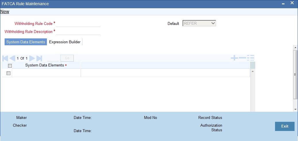

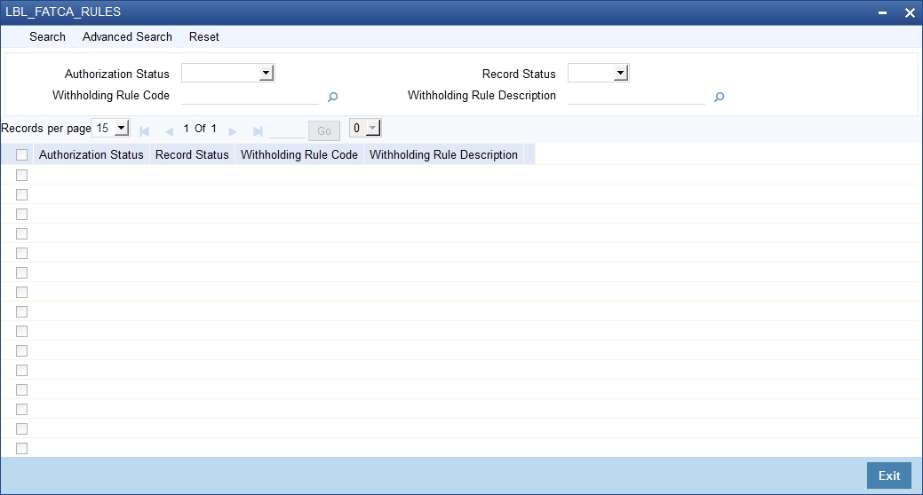

FATCA Tax Rule
Check this box to indicate that the tax rule maintained is a FATCA tax rule.
This field is enabled only if the ‘FATCA Applicable’ field at bank level is enabled.
If the tax rule is marked as a FATCA tax rule, then the system will create a FATCA withholding rule using FATCA withholding rule maintenance which will be linked to the tax rule. At the time of tax computation, the system will first evaluate the withholding rule. Based on the outcome of the withholding rule, the system will compute the tax.
FATCA Rule
Specify the FATCA validation rule that needs to be applied to evaluate the FATCA tax.
This can be the local currency or the currency of the contract. When a rule for which the tax should be calculated in local currency is applied on a contract involving a foreign currency, the local currency equivalent of the contract amount is considered.
Calculation Currency Basis
Calculation currency is the currency in which the Basis Amounts slabs are defined.
You need to specify whether the calculation currency for the Basis Amount should be Specific or Deal.
Specific indicates that the Basis Amount will be defined as per the currency selected in the Currency field.
Deal indicates that the Basis Amount will be defined in the currency of the transaction.

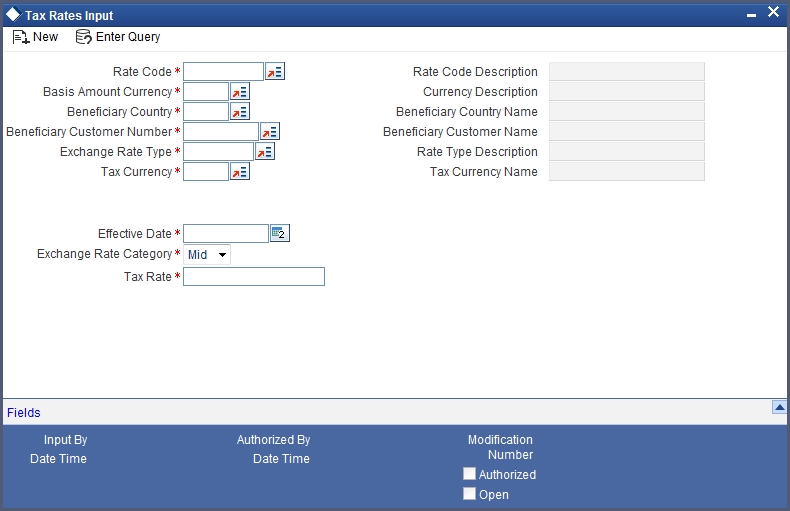

Rate Type
When maintaining a tax rule, you must specify the type of exchange rate that you would like to use to compute tax. At your bank, you may have defined different types of exchange rates. For example, you may have defined a ‘Central Bank Rate’, a ‘Standard Rate’, a ‘Cash Rate’, a Travelers Check Rate, etc. In Oracle FLEXCUBE, these rates are referred to as ‘Rate Types’.

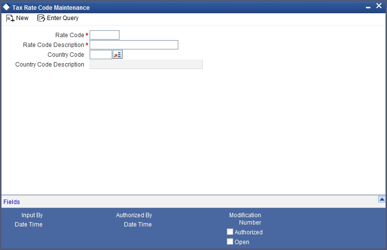

Rate Code
If you have specified that tax is to be computed as a percentage of the taxable amount, you should also specify if the rate to be used is:
The rate value, corresponding to the Rate Type, will be applied to the Basis Amount as per the application basis defined (slab or tier).

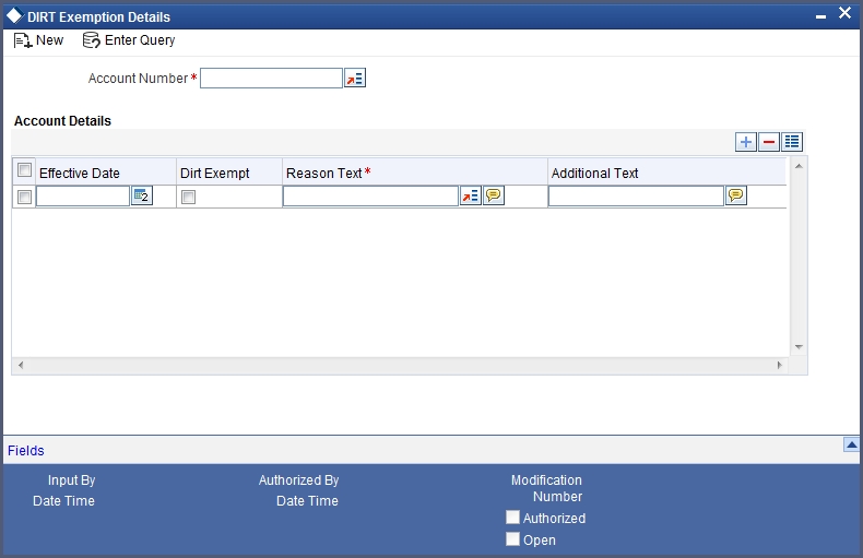

Exemption Allowed
Deposit Interest Retention Tax (DIRT) is payable on interest on deposits and accounts. Customers belonging to certain customer categories can be exempt from paying DIRT.
As part of the DIRT exemption maintenance, you need to indicate such deposits and accounts which will not attract DIRT. While doing so, you will have to mark off specific tax components which you do not wish to be applicable to the account / deposit.
In order that a particular tax component is available for marking off as non-applicable during DIRT exemption maintenance, you will have to select the ‘exemption allowed’ option for that component while maintaining its tax rule.

0.05 |
0 |
0 |
20,000 |
0.06 |
10,000 (upper limit of the first tier) |
X (tax amount that will be considered for the first tier) |
999999999 (a big amount since there is no upper limit for the third slab). |
0.08 |
20,000 (upper limit of the second tier). |
Y (tax amount that will be considered for the earlier slabs). |
When this tax rule is applied on a deal, tax will be calculated, depending on the component amount (example, brokerage paid), as follows:
If the component amount is USD 5,000, it falls in the first tier. The tax amount will be calculated in the following manner:
Amount = USD 5,000
Tax 0.05% of USD 5,000 = USD 2.5
If the component amount is USD 15,000, it falls in the second tier. The tax will be calculated in the following manner:
Amount = USD 15,000
Floor Charge (X)= 5.0
Amount to be taxed at 0.06% = USD 5,000 (Component Amount - the floor amount of the second tier)
Tax = USD 3+ 5 = USD 8
If the Component Amount is USD 30,000, it falls in the third slab. The tax amount will be calculated in the following manner:
Component Amount = USD 30,000
Floor Charge (Y)= 11.0
Amount to be taxed at 0.08% = USD 10,000 (Component Amount - the floor amount for the second tier)
Tax Amount = USD 8+ 11 = USD 19
If a with-holdable payment is to be made to a recalcitrant customer or to a non participating foreign financial institution, it is necessary to withhold 30% of the with-holdable payment and transmit the rest to the beneficiary.
You can define the unique rule using ‘FATCA Withholding Rule Maintenance’ screen. To invoke this screen, type ‘TADFATTX’ in the field at the top right corner of the Application tool bar and click the adjoining arrow button.
Withholding Rule Code
Specify the withholding rule code.
Withholding Rule Description
Specify the description for the selected withholding rule code.
Default
Select the default value to be returned if no expression is satisfied from the drop-down list. Following are the options available in the drop-down list:
System Data Elements
Specify the system data elements. You can also select the valid SDE from the adjoining option list.
Expr No
Specify the expression number.
An expression is built up using the SDEs, operations (>, <, =, <>) and logical operators (AND, OR). The expressions will be evaluated in increasing order of expression number. Thus the system will evaluate the expression number 1 first, if it is not satisfied, then expression number 2 will be evaluated. If expression number 1 is satisfied, then the system will not evaluate expression 2.
If none of the expressions are satisfied, then the rule will return the result maintained at the ELSE part. This will be the default return value for the rule.
Condition
Specify the condition for the rule.
For instance, If module is MM and the amount tag is MMCRINT_LIQD and transaction code is INT and currency code is USD then FATCA withholding is required, then the condition should be as follows:
IF MODULE_CODE = ‘MM’ AND AMOUNT_TAG = ‘MMCRINT_LIQD’ AND CCY_CODE = ‘USD’ and TXN_CODE = ‘INT’ and DRCR_IND = ‘D’
Return Value
Select the return value from the drop-down list. Following are the options available in the drop-down list:
Select the SDEs from the drop-down list. you can select one or more SDEs to be used in the rule.
Each system data element must appear only once in the list.
Operators
Select the type of operator from the drop-down list.
The rule would use the following elements:
You can view the FATCA withholding rules in the ‘FATCA Withholding Rule Maintenance Summary’ screen. You can invoke this screen by typing ‘TASFATTX’ in the field at the top right corner of the Application tool bar and clicking on the adjoining arrow button.
In the above screen, you can base your queries on any or all of the following parameters and fetch records:
Select any or all of the above parameters for a query and click ‘Search’ button. The records meeting the selected criteria are displayed.
The system displays the following details pertaining to the fetched records:
The system will evaluate the tax rule applicable at the product level. The rule evaluation process is as follows:
The FATCA evaluation will be triggered by the transaction to which the tax rule ID is linked. While evaluating the tax rule, its FATCA flag will be checked. If the tax rule has a FATCA flag, then the associated FATCA rule will be evaluated before the tax is computed by the tax rule.
The system will evaluate the expression number 1 first, if it is not satisfied, then expression number 2 will be evaluated. If expression number 1 is satisfied, then the system will not evaluate expression 2. If none of the expressions are satisfied, then the rule will return the result maintained at the ELSE part.
The result of the evaluation of FATCA Rule will be as follows:

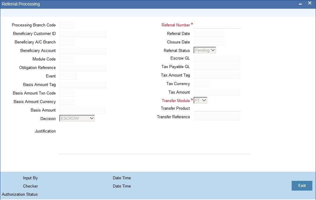

You can process FATCA tax for referred Transactions using ‘FATCA Tax - Referred Transactions Processing’ screen, invoked from the Application Browser. You can invoke this screen by typing ‘TADFATRF’ in the field at the top right corner of the Application tool bar and clicking the adjoining arrow button.
You can perform the following actions from the above screen:
You can fetch a referral record which is in E – ESCROW and P – PENDING status to make a decision for withholding or not withholding. Once the decision is made, the record will be saved. At the time of saving, only the referral record will be saved in an un-authorized mode. the system will not pass any actual accounting entries. The following fields will be editable while saving the record:
On saving the record, the referral status will be updated to C – CLOSED and the authorization status of the referral record will be updated to U – Unauthorized. The checker ID and Checker Date stamp will be null.
You can delete an un-authorized referral record to the referral. On deleting the un-authorized referral record, the system will not delete the actual referral record. However, it will go back to the original condition before the changes were done. The Decision status will go back to E – ESCROW, the referral status will be P – PENDING, the justification field will be made null. The system will change the authorization status to A.
An un-authorized referral record can be authorized by another user. At the time of authorization, the following changes will happen:
If the decision status is WITHHOLD/NO WITHHOLD, a FT contract will be booked using one of the FT product maintained at the bank parameter level. The various parameters for the FT contract to be booked will b:

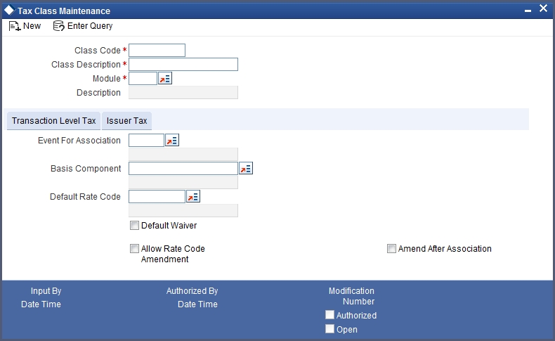

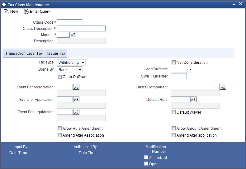

A class is a specific type of component that you can build with certain attributes. For instance, you can build a tax class, with the attributes of a specific type of tax component, such as an Issuer Tax. Similarly, you can build a charge class, with the attributes of a specific type of charge, such as Charges for provision of services.
When building a tax class, certain attributes such as the following can be defined:
Tax classes can be categorized into:
Transaction level taxes are those that would be levied, on the portfolios you maintain and the contracts that you enter into. Issuer taxes are those that are withheld by the Issuer (of a security) when disbursing cash dividends and coupons.
You can define the attributes of a transaction level tax under the corresponding section of the ‘Tax Class Maintenance’ screen. You can invoke this screen by typing ‘TADTAXCL’ in the field at the top right corner of the Application tool bar and clicking the adjoining arrow button.
Before defining the attributes of a Transaction Tax Class, assign the class a unique identifier, called the Class Code, and briefly describe the class. A description would help easily identify a class.
A tax class is built for use in a specific module. This is because the basis amounts on which the tax is applied could vary with the modules. In the Foreign Exchange module, for instance, you might want to levy tax on the brokerage paid. In the Securities module, you might have to pay a tax on the value of a security that you purchase. The basis on which the tax component is calculated is different in these two cases.
Note
The Basis Amount Tags available, in this screen, would depend on the module for which you build the class.
The type of tax indicates who bears the tax, whether the bank or the customer.
Withholding
Withholding type tax is borne by the beneficiary on an income (either the bank or the customer). For example, the tax on the brokerage paid would be borne by the broker. You withhold this component in a Tax Payable account, by debiting the customer account (since brokers are defined as Customers in Oracle FLEXCUBE) and later paying the tax to the government on behalf of the broker.
Expense Type
If you choose to bear the tax that is payable on brokerage, you would define it as an expense type of tax. The tax entries, in this case, would be posted to an Expense account.
If you bear the tax, there could either be an immediate cash Outflow or payment, or a mere crediting of it to a Tax Payable account. In the latter case, there would not be an immediate Outflow. The tax would be paid at a later date, from the Tax Payable account.
The sum of the different components of a contract determines the net value of the contract. To indicate that a transaction level tax component should be taken into account when determining the net value of a contract, choose the Net Consideration option.
If you choose to include the tax component in the net value of the contract, you should also indicate if the tax component is to be added or subtracted, while calculating the net consideration amount.

Defining the Events and the Basis Amount
Each contract that your bank enters into goes through different stages, each of which is referred to as an Event in Oracle FLEXCUBE.
A securities deal, for instance, goes through different stages in its life cycle, such as:
Each of these stages is referred to as an Event in Oracle FLEXCUBE.
The following are examples of the events for a portfolio that you maintain:
At any of these events, you can choose to apply a tax. The event at which you would like to associate a tax component, is referred to as the Association Event. At this event, no accounting entry (for the tax component) is passed.
The event at which the tax component is actually computed is referred to as the Application Event. The tax is liquidated at the Liquidation Event.
The basis on which a tax is calculated is referred to as the Basis Amount. A tax can be on the basis of the principal, the brokerage paid and so on. When building a tax class, you have to specify the tag associated with the Basis Amount.
A tax rule can be linked to the tax component that you are building. When you link a rule to a component, the attributes that you have defined for the rule, will default to the component.
A tax rule identifies the method in which tax, is to be calculated. A rule is built with attributes such as the following:
The tax component to which you link a rule acquires ITS properties. Tax for the contracts with which you associate a tax component will, by default, be calculated according to the rule linked to the component. However, when processing a contract, you can choose to waive the rule.
When building a tax class, you can choose to allow the amendment of the rule linked to it, under the following conditions:

A Tax Rate Code identifies the rate that applies on an issuer tax. For instance, you can create a rate code and specify the rate values for different Effective Dates, in the ‘Tax Rate Maintenance’ screen. When building an Issuer Tax component, say Issuer_01, in the ‘Tax Class Maintenance’ screen, you only need to specify the Rate Code that should apply. For all securities associated with Issuer_01, the rates corresponding to the code will be picked up.
You can define a rate code, and enter a brief description for it, in the ‘Tax Rate Code Maintenance’ screen. You can invoke this screen by typing ‘TADRTCD in the field at the top right corner of the Application tool bar and clicking the adjoining arrow button.
Since tax rates would vary across markets, you can define rate codes specific to markets (countries).
The actual rate values for a rate code can be maintained in the ‘Tax Rates Input’ screen. You can invoke this screen by typing ‘TADRATE’ in the field at the top right corner of the Application tool bar and clicking the adjoining arrow button.
For a rate code, you can enter the following details:
Rate code |
Details |
The Basis Amount Currency |
The basis (the coupon amount, the cash dividend amount, etc.) on which a tax is calculated, is referred to as the Basis Amount. You can specify the currency of the Basis Amount. |
The Beneficiary Country |
Issuer Tax Rates are specific to markets. When maintaining a rate value for a code, you have to identify the market for which you are defining the rate. |
The Beneficiary CIF |
You can maintain unique tax rates for issuers of securities. When you maintain a security, the system applies the tax rate defined for the issuer. If you have not maintained a rate for an issuer, the system applies the rate maintained for the country to which issuer belongs. |
The Effective Date |
The date on which a rate becomes effective is referred to as the Effective Date. For a code and Effective Date, you can maintain a rate. |
The Tax Currency |
You can specify the currency in which the tax should be applied. |
The Exchange Rate Type and Category |
If you specify a Basis Amount Currency that is different from the Tax Currency, you have to indicate the type of rate (standard, spot, cash, etc.), and the rate category (mid, buy, or sell rate) that should be used in the currency conversion. |
The Tax Rate |
In this field, you can enter the actual rate value for a Code, for an Effective Date. When you associate a rate code with an issuer tax class, the rates corresponding to Effective Dates will be picked up and applied. |
The tax that applies on a coupon would be calculated at a specific rate. When building an issuer tax component, you have to specify the rate at which tax should be computed for a coupon. When you associate a rate code that you have maintained with a component, the rates corresponding to the component will be picked up. A rate code identifies the rate that applies on a tax. A rate code is built with attributes such as the following:
Tax for the component to which you link a rate code will be computed by default, on the basis of these properties.
When maintaining a security, however, you can choose to waive the rate code altogether.

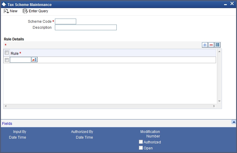

A Tax Scheme consists of a set of Tax Rules that will be made applicable on a product. Tax schemes can be two types:
The manner in which you can maintain Money and Security/Derivative scheme types has been discussed in detail in the subsequent sections.
A contract that you enter into could consist of one or more tax components (a Stock Exchange tax, a Local tax, etc.). You can define each of these components as a tax class, and associate each with a tax rule. A tax rule identifies the method in which a tax component is calculated.
A tax scheme is composed of one or more tax classes. For instance, a Transaction Level Tax Scheme would be composed of one or more transaction level tax classes. By associating a Tax Scheme with a product, you can calculate all the tax components for the contracts entered under the product at one stroke.
Tax schemes can be built in the ‘Tax Scheme Maintenance’ screen. You can invoke this screen by typing ‘TADSCHEM’ in the field at the top right corner of the Application tool bar and clicking the adjoining arrow button.
You must identify a Tax Scheme that you build with a unique Code and a brief Description.
A tax scheme is built specifically for a module in Oracle FLEXCUBE. For example, a scheme with Stock Exchange tax classes would only be relevant to the Securities module. When you define a product in a module, only those tax schemes that you have built specifically for the module, will be available to you.
A class in a scheme will remain effective till another class for the same component, but with a different Effective Date, is encountered.
The following example illustrates how the different classes in a tax scheme, defined for the same component is applied.

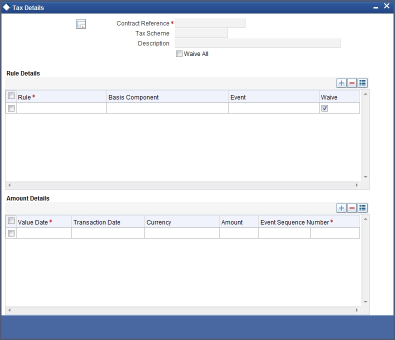

Any transaction on which tax is applicable is linked to a Tax Scheme. A Tax Scheme describes the method in which the tax has to be applied on a transaction.
A tax scheme can have a number of Tax Rules linked to it. The attributes of all these rules will be applied on the transaction. Thus, a Tax Rule is made applicable on a contract through the Tax Scheme. For instance, let us assume we are building a tax scheme, which should be used for the Funds Transfer module of Oracle FLEXCUBE.
You have defined the following Tax Rules (only the fields relevant to the example are discussed):
Scheme Code
Identify the Tax Scheme that you are maintaining with a unique code. A scheme consists of several tax components (classes). You can indicate the components that you would like to include in the scheme in the Component field.

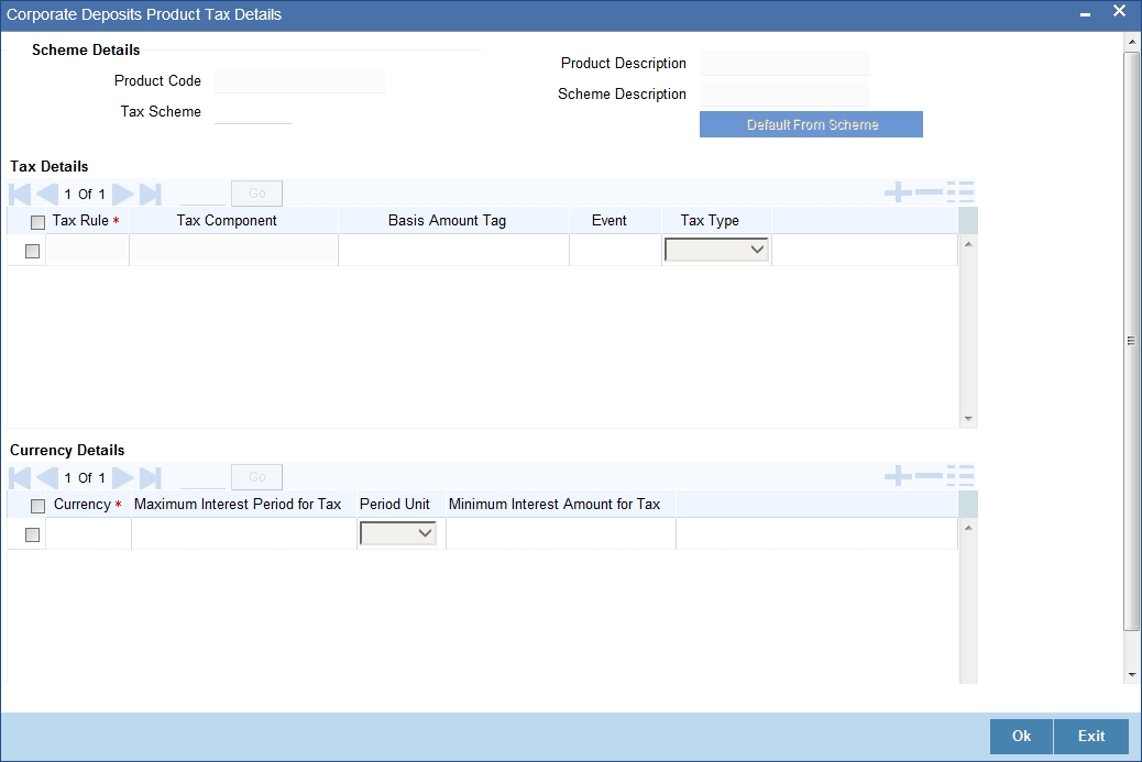

A tax scheme is linked to a product, only if tax is applicable to the product. This linkage is established through the tax screen, of product definition. The tax scheme thus linked will be applicable on a contract processed under the product by default. However, you have the option of waiving the application of tax, for a specific contract
A Tax Rule represents the method in which a specific tax has to be calculated. The amount based on which the tax has to be applied is not specified for a Tax Rule. This is specified only when the Tax Scheme is linked to a product.
The system thus offers you flexibility in terms of the method in which tax has to be calculated. For example, for one type of product, you could use a Tax Rule to apply tax on interest earned, while for another product, the same rule could be used to apply tax on the principal (if the method of tax calculation is the same for both the components).
A Tax Scheme is applicable on a product by linking the two rates mentioned above. Once the Tax Scheme is specified for linkage, you should indicate the component on which the two rules are applicable, the event when the tax should be liquidated and the type of tax - withholding or expense.
To specify the linkage of a tax scheme to a product you have to invoke the Product-Tax Linkage Definition screen from the LD/MM Product Definition screen. Click ‘Tax’ button in the respective ‘Product Definition’ screen.
The following are the features of the Product-Tax Linkage definition screen.
Tax Component and Basis Component
Tax can be applied on the basis of any component that is taxable according to the laws in your country. This component is called the Basis Component. The method of tax application defined for the Tax Rule will be applied on this component.
Event
You should specify the event for which the tax is applicable. For example, if you specify that the tax is to be applied upon initiation of the contract, then the liquidation entries for tax will be passed when the contract is initiated. If you specify the event as the Maturity of the contract, the tax will be liquidated upon Maturity of the contract.
Similarly, if you specify that the tax be to be applied at the time the commissions are collected from the customer, then the entries for tax will be passed when the commission is paid.
Tax Type
The type of tax, decides the bearer the tax. It could be the bank or the customer.
A customer bears withholding type of tax and the tax component is debited to the customer’s account. The bank bears an expense type of tax and the tax component is booked to a tax expense account.
Note
The tax details specified for a product will be automatically applied on all contracts involving the product. However, while processing a contract, you can waive the application of all or specific tax rules for the contract.
Minimum Interest Rate Code for Tax
This field is appears only for LD and MM product maintenance.
You need to specify the rate code that will be used to determine the minimum interest rate for the tax to be applicable. If the rate code is not defined, then the minimum interest rate will be taken as 0.
Currency
This field appears only for LD and MM product maintenance.
You need to specify the currency for which the tax waiver rules (maximum interest period and minimum interest amount) should be defined.
Maximum Interest Period for Tax
You need to specify the interest period beyond which tax on the interest amount liquidated would be waived.
The maximum interest period would be applicable only for Deposit type of products for LD and Borrowing type of products for the MM module.
If the tax rule has a tax category linked to it, then the currency details will be mandatory. A validation for this would be done during tax processing. In case the tax rule does not contain the tax category, and the currency details have not been defined, then the maximum interest period would be ignored and the minimum interest amount would be considered as 0 indicating that the tax would always be computed.
Period Unit
You need to specify the unit for the interest period. The available options are as follows:
Minimum Interest Amount for Tax
You need to specify interest amount up to which tax will be waived. The minimum interest amount would be applicable only for the Deposit type of products for LD and Borrowing type of products for MM module.
If the tax rule has tax category linked to it, then the currency details will be mandatory. A validation for this would be done during tax processing. In case the tax rule does not contain the tax category, and the currency details have not been defined, then the maximum interest period would be ignored and minimum interest amount would be considered as 0 indicating that the tax would always be computed.
If the interest amount being liquidated is less than the minimum interest amount, tax will be waived completely for that transaction

You can invoke the ‘Contract Tax Details’ screen while you are processing a contract. Click ‘Tax’ button in the contract details screen.
You have a choice of waiving tax due to all the Tax Rule(s) linked to the Tax Scheme applicable to the product (and hence the contract) or that which is only due to specific Tax Rule(s).
Note
Only the tax that has not yet been liquidated can be waived.

For marking term deposit contracts as DIRT exempt, invoke the ‘DIRT Exemption Details’ screen from the Application Browser. You can invoke this screen by typing ‘TADACMNT’ in the field at the top right corner of the Application tool bar and clicking the adjoining arrow button.
From the list of values, select the contract that you wish to specify as DIRT exempt. Those tax components attached to the contract, for which the ‘exemption allowed’ option has been selected while maintaining tax rules, are displayed.
Refer to the Specifying Tax Exemption section earlier in this chapter for details on marking tax components for exemption.
Select the components that you wish to be waived for the deposit. For each component that you mark off as waived, you can select a reason from the pre-shipped list of values and also enter additional information as text.
