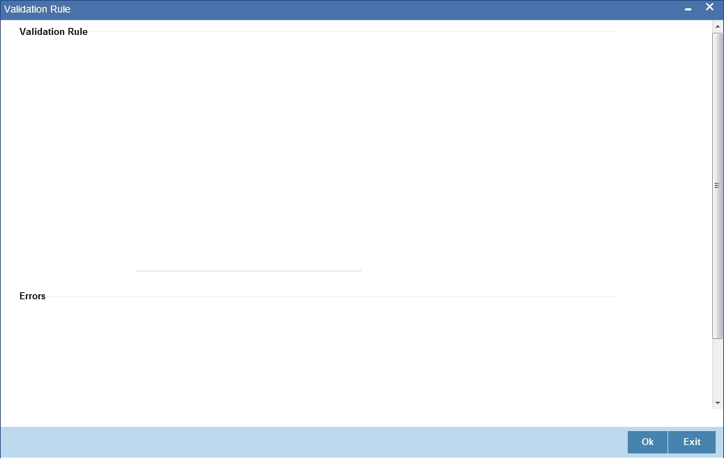

Apart from specifying the validation type for a field, you can specify additional validation rules to meet the requirements of the bank.
To indicate that additional validations are required for a particular user defined field, check against ‘Validation Allowed’. This will allow you to write a code to validate the value in the new field. Click ‘Validation’ button to write the validation code.
This is the PL/SQL validation code based on which the system will check the value of the new field and validates at the time of transaction processing. Entry to this field is mandatory if you have checked against ‘Validation Allowed’.
For example, at the time of processing a contract for a customer, the bank wants to add a new field to enter the first nominee that the customer has specified in his account. The names of the nominees of a customer are maintained in the ‘Customer Accounts Maintenance’ screen. The bank wants the system to check that the name of the nominee that is entered in the new field and the name of the first nominee that is maintained in the Customer Accounts Maintenance screen are same.

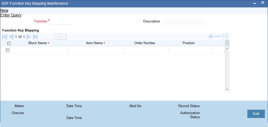

Specifying the UD Function Key Mapping Details
Through the Function Key Mapping screen you can define the Record Key items that are used for the Function ID. This maintenance becomes mandatory if you have to use an UDF in all or any of the Functions.
You can invoke the ‘User Defined Fields Function Key Mapping Maintenance’ screen by typing ‘UDDFNMPT’ in the field at the top right corner of the Application tool bar and clicking on the adjoining arrow button.
In this screen, you must identify the function ID to which you need to link user-defined fields.

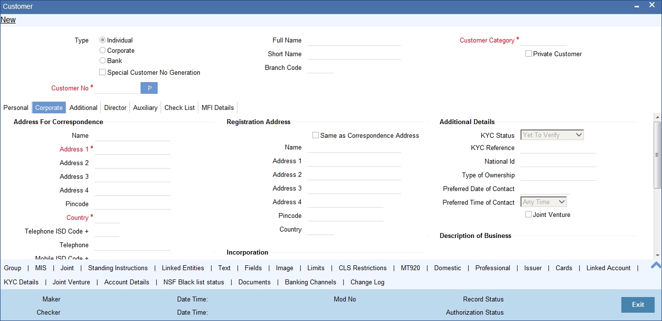

For example, the Function STDCIF is based on the STTM_CUSTOMER table. The primary key maintained for this table is CUSTOMER_NO. From the STDCIF.FMB, check the block name for the item and then enter the BLK Name (block name in the Form for the Item), ITM_NAME (Item name in the Form) and the Order Number in this screen (Order number cannot be Duplicated and Should be sequential).
After completing the Function Key maintenance you can continue defining the UDF for the Function ID.
You will be prompted to link the Function ID (e.g. STDCIF) to the Field at the Definition of the UDF.
(@RECORD_KEY) will hold the value of a combination of all item name values separated by ‘~’ that are mapped in the UD function key mapping screen in the same order of order_no. The Record key can be used only in the select statement.

(@RETURN_VAL)
This syntax can be used only in validation logic. You can Assign TRUE or FALSE Values to this parameter.
Example is given below.
(@RETURN_VAL) := TRUE;
if (@FIELD_VAL) = ‘USD’ then
else
(@RETURN_VAL) := FALSE;
err_code := ‘UD-UDF-01’;
err_param := (@FIELD_VAL);
end if;
The ‘err_code’ and ‘err_param’ parameters can also be assigned, and will be displayed if the validation fails in population of values.

At the time of creating a new customer in the ‘Customer Information Maintenance’ screen, click ‘UDF’ button to invoke the ‘User Defined Fields' screen. Enter the value for the user-defined field, which has to be included in the customer account (since it is mandatory). This value will be displayed at the time of defining a new customer account on selection of the customer.

The procedure for mapping the UDF with the function id ‘STDCIF’ is explained in the following sections.
You can make the UDFs defined for the function id ‘STDCIF’ as part of the Customer Maintenance screen. Oracle FLEXCUBE allows you to include a maximum of five UDFs in the screen.
The mapping is achieved through the ‘Embedded Field Maintenance’ screen invoked from the Application Browser. You can invoke this screen by typing ‘STDBSUDF’ in the field at the top right corner of the Application tool bar and clicking the adjoining arrow button.
Select the function id ‘STDCIF’ from the option-list provided. All the UDFs maintained for the selected function Id would be available in the option-list for the ‘Field Name’. Select the UDFs you want to include in the ‘Customer Maintenance’ screen. You can select a maximum of five UDFs. Also, specify the sequence in which you would like the UDFs to appear in the screen. The selected UDFs will form a part of the Customer Maintenance screen and will be displayed in the sequence that you specify.
The value that you enter for the UDFs will be validated as per the validation rules maintained during the definition of the UDF.
