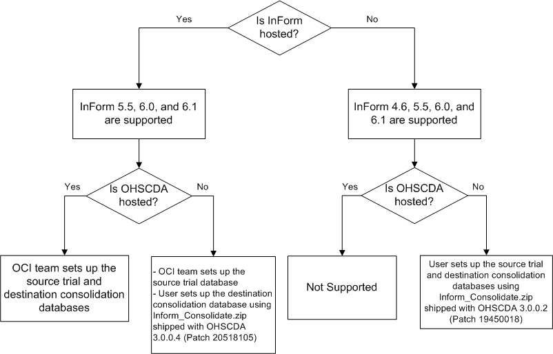

Figure 2-1 displays the OHSCDA InForm consolidation installation scenarios.
Figure 2-1 OHSCDA InForm Consolidation Installation Scenarios
You can download the OHSCDA patch from My Oracle Support (https://support.oracle.com).This section describes how OHSCDA extracts InForm's operational data and loads it into the OHSCDA warehouse. All of the data for each InForm study is maintained in a transactional database (actually a database schema). InForm maintains one or more InForm databases per Oracle database instance. Each study also has a Reporting and Analysis database (again, a set of objects in a schema, not necessarily an exclusive database instance) which contains data in views designed for query, as opposed to transactional activity.

This section describes the steps to create the Consolidation Schema. As part of the process, it enrolls an initial InForm study as a source to be consolidated.
If you are using the OHSCDA 3.0.0.2 patch, you must set up both the source trial and destination consolidation databases.
If you are using the OHSCDA 3.0.0.4 patch, you must only set up the destination consolidation database.
