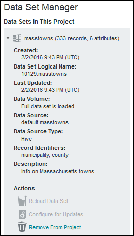

After the data set is configured, its entry in the Data Set Manager page looks like this example:
Note that the Record Identifiers field now lists the attributes that were selected in the Configure for Updates dialogue.
