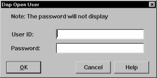

This window appears when you run this utility:
