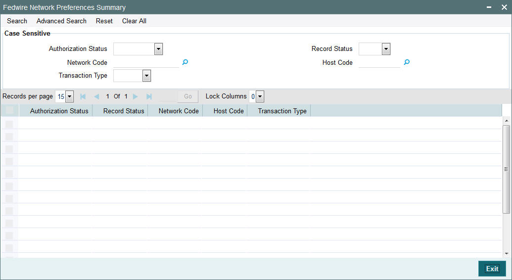

2.0.2 Viewing Fedwire Network Preferences Summary
You can view the summary in “Fedwire Network Preferences Summary” screen. You can invoke the Fedwire Network Preferences Summary screen by typing ‘PWSNWPRF’ in the field at the top right corner of the Application toolbar and clicking on the adjoining arrow button.
You can search for the records using one or more of the following parameters:
Once you have specified the search parameters, click ‘Search’ button. The system displays the records that match the search criteria. You can view the following details:

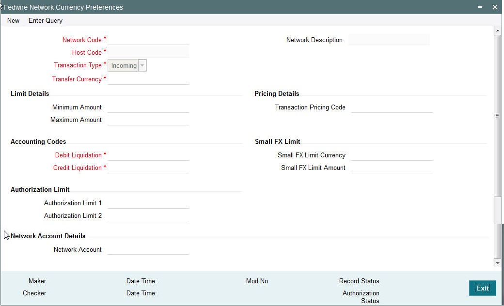

2.0.3 Fedwire Network Currency Preferences
You can capture Network Currency Preferences for Fedwire Network.
You can invoke the “Fedwire Network Currency Preferences” screen by typing ‘PWDNCPRF’ in the field at the top right corner of the application toolbar and clicking the adjoining arrow button. Click new button on the Application toolbar.
Specify the following fields:
Network Code
Select the network code of the logged in user from the available list of values for the Host.
Network Description
This field is auto-populated based on the network code selected.
Host Code
Displays the Host code assigned to of the branch selected by the logged in user.
Transaction Type
Select the type of transaction for which the Fedwire Network preferences are being specified. The options are:
Transfer Currency
Select the required currency from the list of available currencies for the Fedwire network.
Limit Details
Minimum Amount
Specify the minimum amount for a Fedwire payment.
Maximum Amount
Specify the maximum amount for a Fedwire payment.
Pricing Details
Transaction Pricing Code
Select the Pricing code from the list of available Pricing codes.
Accounting Codes
Debit Liquidation
Specify the template for Debit Liquidation from the list of available accounting templates. You can select the template from the option list. The list displays all the accounting templates maintained in the system.
Credit Liquidation
Specify the template for Credit Liquidation.
Dispatch/Receipt Accounting
Specify the template for Dispatch/Receipt Accounting from the list of available accounting templates.
Small FX Limit
Small FX Limit Currency
Select the required currency from the list of available currencies for specifying the Small FX Limit.
Small FX Limit Amount
Specify the amount for the Small FX Limit.
Authorization Limit
Authorization Limit 1
Specify the amount limit above which the transaction will need first level of authorization.
Authorization Limit 2
Specify the amount limit above which transaction will need second level of authorization in addition to first level of authorization.

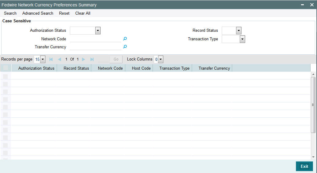

2.0.4 Viewing Fedwire Network Currency Preferences Summary
You can view the summary in “Fedwire Network Currency Preferences” screen. You can invoke the Fedwire Network Currency Preferences screen by typing ‘PWSNCPRF’ in the field at the top right corner of the Application toolbar and clicking on the adjoining arrow button.
Once you have specified the search parameters, click ‘Search’ button. The system displays the records that match the search criteria. You can view the following details in here:
