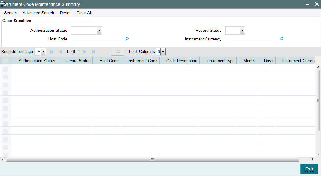

2.1.2 Viewing Instrument Code Maintenance Summary Screen
You can search for records in the Instrument Code Maintenance Summary Screen. You can invoke ‘Instrument Code Maintenance Summary’ screen by typing ‘PGSINSCD’ in the field at the top right corner of the Application tool bar and clicking on the adjoining arrow button..
You can search using one or more of the following parameters:
Once you have specified the search parameters, click ‘Search’ button. The system displays the records that match the search criteria.

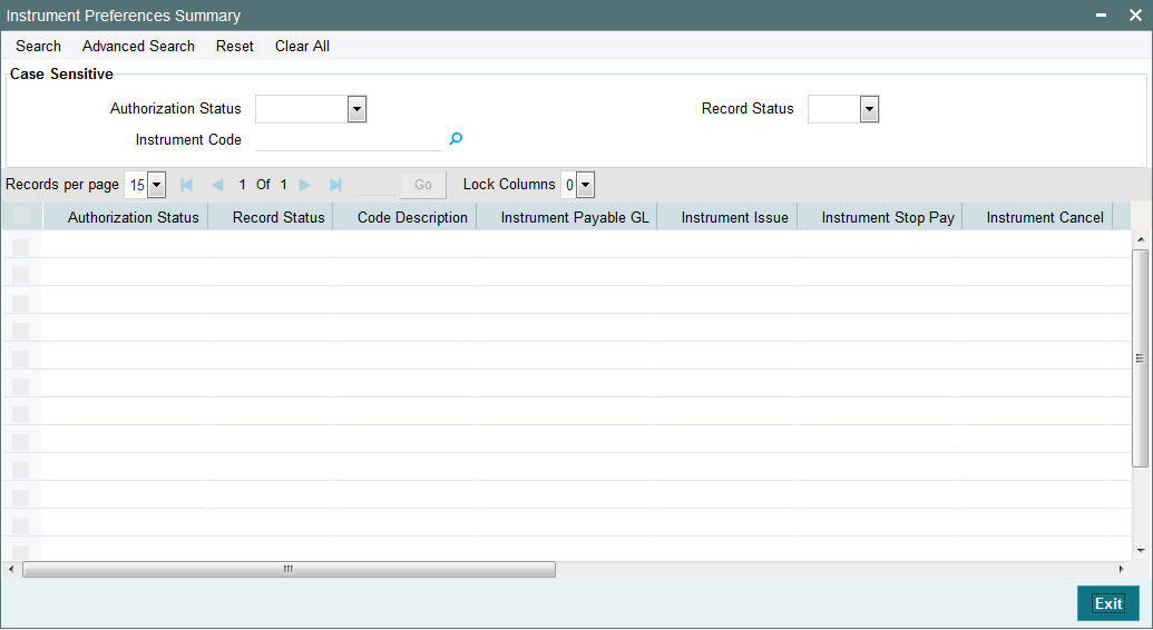

2.2.2 Viewing Instrument Preference Summary Screen
You can search for records in the Instrument Preference Summary Screen. You can invoke ‘Instrument Preference Summary’ screen by typing ‘PISINPRF’ in the field at the top right corner of the Application tool bar and clicking on the adjoining arrow button..

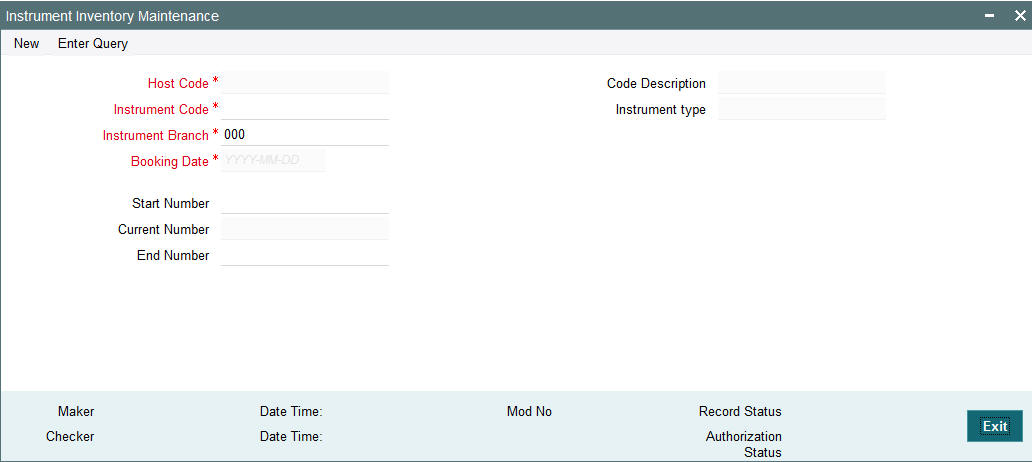

2.3 Instrument Numbers
It is possible to maintain valid range of numbers per Instrument code. This maintenance is branch-wise.
2.3.1 Invoking Instrument Inventory Maintenance Screen
You can invoke ‘Instrument Inventory Maintenance’ screen by typing ‘PIDINSNO’ in the field at the top right corner of the Application tool bar and clicking on the adjoining arrow button...
You can specify the following fields:
Host Code
The system indicates the host code that is linked to the logged in branch of the user.
Instrument Code
All valid Instrument codes of instrument type ‘Demand Draft’ and ‘Manager’s Cheque’ are listed. Select the appropriate code.
Code Description
Based on the Instrument Code selected, this field is auto-populated.
Instrument type
Instrument Branch
User’s logged in branch is displayed in this field.
Received Date
The system defaults the current date.
Start Number
Specify the starting number of the range of inventory numbers to be maintained.
Current Number
Specify the current inventory number.
End Number
Specify the end number of the range.
Note
While allocating inventory number for a processing completed inventory issue transaction, FIFO rule will be followed.

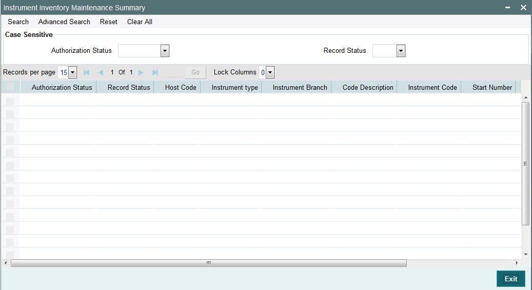

2.3.2 Viewing Instrument Inventory Maintenance Summary Screen
You can search for records in the Instrument Inventory Maintenance Summary Screen. You can invoke ‘Instrument Inventory Maintenance Summary’ screen by typing ‘PISINSNO’ in the field at the top right corner of the Application tool bar and clicking on the adjoining arrow button..

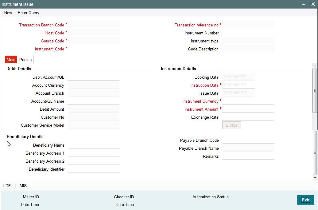

2.4 Instrument Issue Request
There is a new user interface for entering details of issue of instruments. It is possible to send the instrument issue request through channels. Instrument issue request can be part of Corporate (C2B) bulk files.
2.4.1 Invoking Instrument Issue Screen
You can invoke ‘Instrument Issue’ screen by typing ‘PIDINSIS’ in the field at the top right corner of the Application tool bar and clicking on the adjoining arrow button...
Transaction Branch Code
The system indicates the logged in branch of the user.
Transaction reference no
The system populates the transaction reference number.
Host Code
This field is defaulted as user’s logged in Host.
Instrument Number
This field is populated by system upon successfully completing the instrument issue processing. The new instrument number is allocated based on the branch and instrument code and available inventory in FIFO order.
Source Code
This field is defaulted as ‘MANL’.
Instrument type
Based on the instrument code selected, Instrument Type gets auto-populated.
Instrument Code
All valid Instrument codes of instrument type ‘Demand Draft’ and ‘Manager’s Cheque’ are listed. Choose the appropriate code.
Code Description
Based on the instrument code selected, Code Description gets auto-populated.
2.4.1.1 Main Tab
Click Main tab from the Instrument Issue screen.:
Debit Details
Debit Account
You will be able to select the purchaser details. You can select a valid customer account.
Account Currency
The system indicates the account currency.
Account Branch
The system indicates the branch of account.
Account/GL Name
The system indicates the name of the Account or the GL name depending on your selection.
Customer Number
The system indicates the unique customer number that is tagged to the account.
Customer Service Model
The system indicates the Customer Service Model for the account. For example, GOLD and PLATINUM.
Beneficiary Details
Beneficiary Name
Specify the account name of the beneficiary. This is a mandatory field.
Beneficiary Address
Specify the additional details of the beneficiary.
Beneficiary Identifier
Specify the beneficiary identifier details. This is an optional information.
Instrument Details
Booking Date
The system specifies the current date.
Instruction Date
Specify the request date obtained from the customer. This is defaulted as current date. You can change this to a back date or forward date.
Issue Date
The system specifies the Issue Date.If request date is a back dated, issue date will be set as the current date.
Note
If request date is a future date, system processes a holiday check that is maintained for the branch.If customer preference is available for Instruction date movement, the issue date will be moved forward or backward to a business day. If no customer preference is available, it will be always moved forward to next business day. Future dated transaction are processed only on that day well.
Instrument Currency
This is defaulted by the system based on the instrument code selected.
Instrument Amount
Specify the instrument amount for transfer. This is a mandatory field.
Enrich
Click this button to trigger computation of Charges and populate the Charges in the Pricing tab.
Payable Branch Code
This is optional based on the Instrument Type. Select the required branch code from the list of values.
Payable Branch Name
This is defaulted by the system based on the Payable Branch Name selected.
Remarks
Specify internal remarks, if any.
UDF
Click this link to specify user defined fields.
MIS
Click this link to specify MIS details.

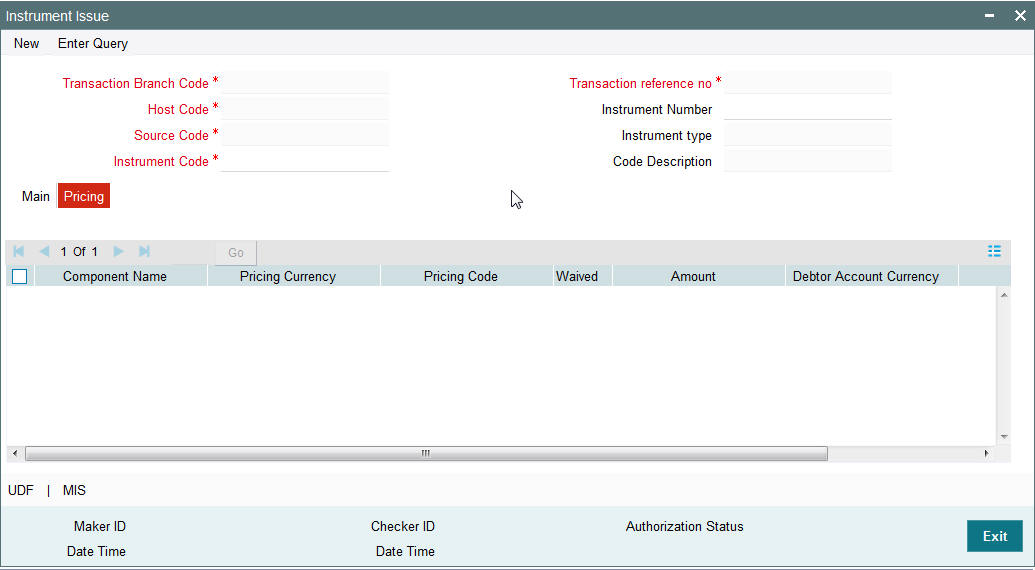

2.4.1.2 Pricing Tab
Click the Pricing tab from the Instrument Issue screen.:
Note
Component Name
The system displays the name of the applicable Charge component.
Pricing Currency
The system displays the pricing currency of the component from the Pricing Code Maintenance.
Pricing Code
The system displays the pricing code of the component from the Pricing Code Maintenance.
Amount
The system displays the fixed or calculated charge amount using the Pricing Value Maintenance. You can edit this field to a non-zero value.
Waiver
Check this box to select the charge component to waive the associated charges.
Note
Debit Currency
The system displays the currency of the selected debit amount.
Note
Debit Currency is the same as Pricing Currency.

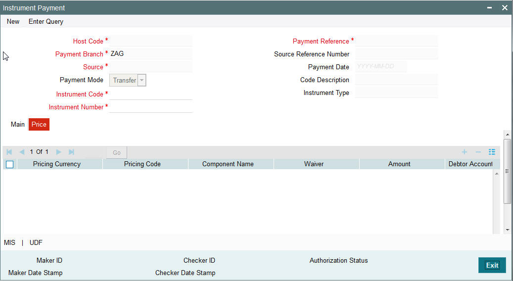

2.5 Instrument Payment
New screen is provided for initiating the liquidation process entering the instrument number.
2.5.1 Invoking Instrument Payment Screen
You can invoke ‘Instrument Payment’ screen by typing ‘PIDINSPY’ in the field at the top right corner of the Application tool bar and clicking on the adjoining arrow button...
Host Code
The system indicates the host code that is linked to the logged in branch of the customer.
Payment Branch
Payment branch is defaulted as the logged in branch of the customer.
Source
The source is defaulted as MANL.
Payment Mode
Payment mode can be ‘Transfer’ or ‘Cancel’.If payment is done by transferring the amount to another account Transfer mode has to be chosen.If purchaser is cancelling the instrument, cancel option to be chosen.
Instrument Code
Select the instrument code.
Instrument Number
Select the instrument number to be paid.All instruments outstanding for the instrument code which are in ‘Active’ status ‘are listed.
Payment Reference
The system populates the payment reference number.
Payment Date
Payment date is defaulted as current date.
Code Description & Instrument Type
Instrument code description and instrument type are defaulted based on Instrument code selected.

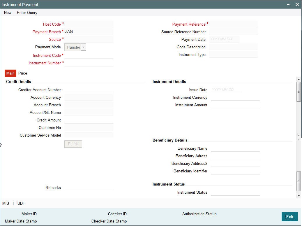

2.5.1.1 Main Tab
Click Main tab from the Instrument Payment screen.:
Credit Details
Creditor Account Number
Specify the Creditor Account Number from the list of values. If Payment mode is Cancel, system defaults the debit account used for the instrument issue in this field.
Account Currency
This field is defaulted based on account number selected.
Account Branch
This field is defaulted as the account branch of account number selected.
Account/GL Name
The system indicates the name of the Account name depending on your account selection.
Credit Amount
Based on the instrument amount and account currency this amount is computed and populated by the system.
Customer Number
The system indicates the Customer Service Model linked to the customer.
Beneficiary Details
Beneficiary Name
Based on the instrument number selected, this field is defaulted.
Beneficiary Address
Based on the instrument number selected, beneficiary address is defaulted.
Instrument Details
Instrument details are defaulted based on the instrument number selected. The following fields are displayed on the screen.
Remarks
Specify Remarks, if any.
Exchange Rate
Based on the instrument currency and account currency and exchange rate related maintenances, exchange rate is computed by the system.
Enrich
Click this button to trigger computation of Charges in the Pricing tab.
Instrument Status
Instrument Status
The status of the instrument is displayed.
UDF
MIS
2.5.1.2 Price Tab
Click the Price tab from the Instrument Issue screen.:
Pricing tab details will be similar to the pricing tab of Issue screen explained in section 2.1.4.2

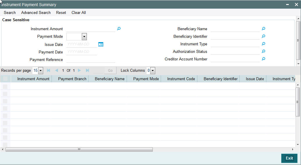

2.5.3 Viewing Instrument Payment Summary Screen
You can search for records in the Instrument Payment Summary Screen. You can invoke ‘Instrument Issue Summary screen by typing ‘PISINSPY’ in the field at the top right corner of the Application tool bar and clicking on the adjoining arrow button..

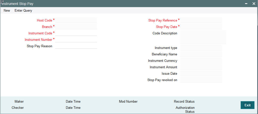

2.6 Stop Payment
It is possible to mark stop payment of an instrument and also to revoke the stop payment. It is also possible to collect charges for stop payment from the purchaser. Instrument status is marked as ‘Payment Stopped’ on authorizing the stop payment. When the stop payment is revoked, the instrument status is moved back to previous status (Active) provided the validity period is not over, else the status is marked as stale.
2.6.1 Invoking Instrument Stop Pay Screen
Payment can be stopped for an instrument which is not in liquidated / cancelled /stale status. You can invoke ‘Instrument Stop Pay’ screen by typing ‘PIDSTPAY’ in the field at the top right corner of the Application tool bar and clicking on the adjoining arrow button...
Host Code
The system indicates the host code that is linked to the transaction branch of the customer.
Branch
The system indicates the transaction branch of the customer.
Instrument Code
Specify the Instrument Code.
Instrument Number
Specify the Instrument Number for which stop payment to be marked. Instrument Number field lists instruments for the instrument codes selected which are in Active status.
Stop Pay Reason
Specify a reason to issue the Stop Pay.
Stop Pay Reference
The system indicates the Stop Pay Reference details.
Stop Pay Date
This field is displayed as current date.
Code Description
The system indicates the instrument code description based on the instrument code chosen.
Instrument type
The system indicates the type of instrument.
Beneficiary Name
The system indicates the name of the beneficiary as mentioned in the instrument.
Instrument Currency
The system indicates the Instrument Currency.
Instrument Amount
The system indicates the Instrument Amount.
Issue Date
The system indicates the date on which the instrument was issued.
Stop Pay revoked on
You can revoke the stop pay by invoking the ‘Revoke’ action. The date on which the Stop Pay revoked is displayed in this field.

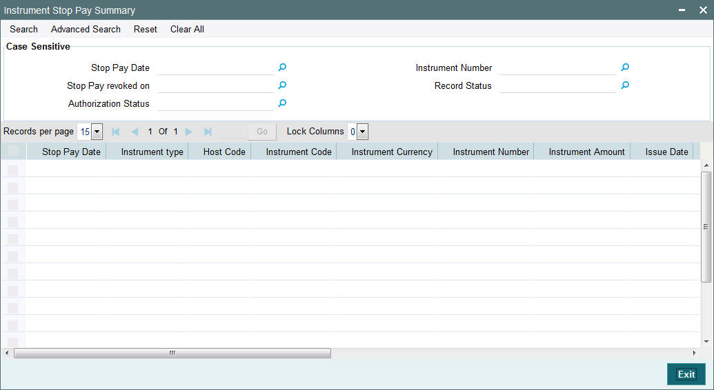

2.6.2 Viewing Instrument Stop Pay Summary Screen
You can search for records in the Instrument Stop Pay Summary Screen. You can invoke “Instrument Stop Pay Summary” screen by typing ‘PISSTPAY’ in the field at the top right corner of the Application tool bar and clicking on the adjoining arrow button..
You can search using the following parameter:
Once you have specified the above parameter, click ‘Search’ button. The system displays the records that match the search criteria.
