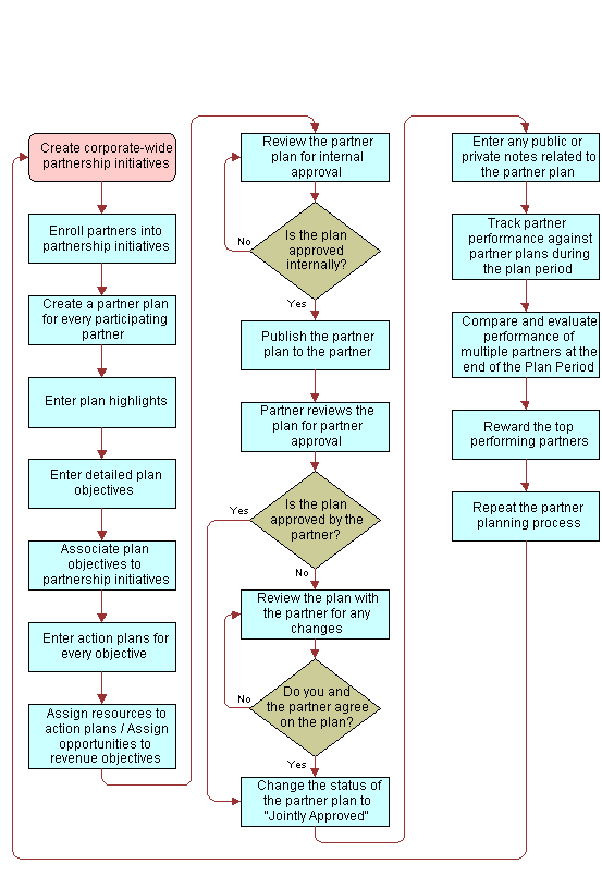

A detailed diagram of the steps the brand owner performs in the CHAMP Planning Module of Siebel PRM is shown in Figure 7-1, "Using the CHAMP Planning Module of Siebel PRM (Brand Owner's Viewpoint)".

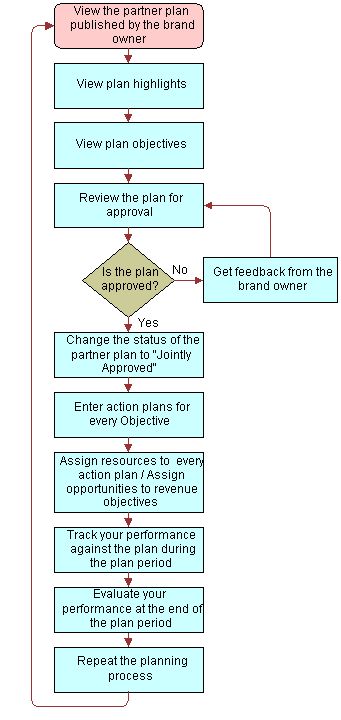

A detailed diagram of the steps the partner performs in the CHAMP Planning Module of Siebel PRM is shown in Figure 7-2, "Using the CHAMP Planning Module of Siebel PRM (Partner's Viewpoint)".
Figure 7-1 Using the CHAMP Planning Module of Siebel PRM (Brand Owner's Viewpoint)
Surrounding text describes Figure 7-1 .
Figure 7-2 Using the CHAMP Planning Module of Siebel PRM (Partner's Viewpoint)
Surrounding text describes Figure 7-2 .
