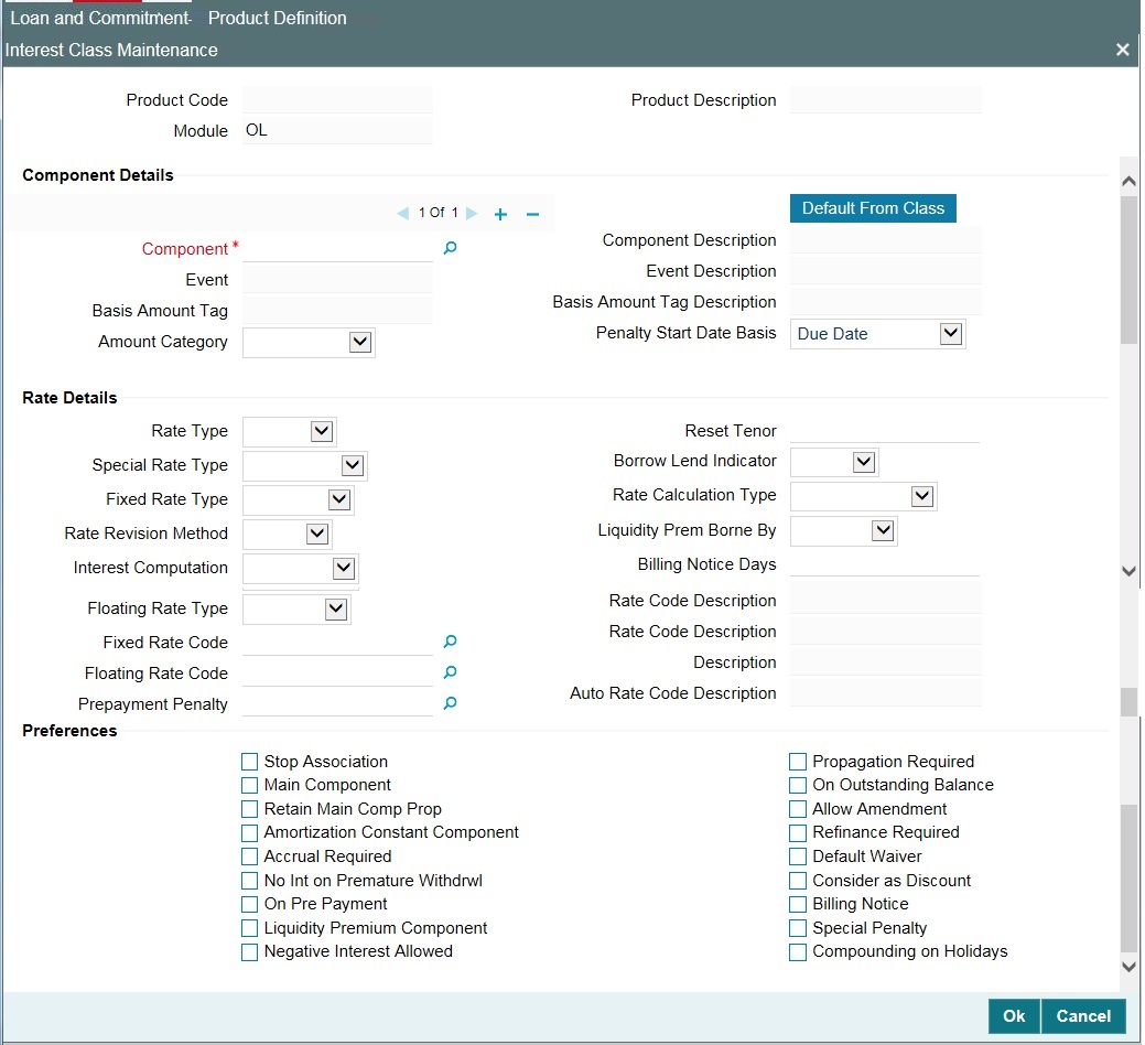

You can specify the interest components applicable to a product in the Interest Class Maintenance’ sub -screen of the ‘Loans and Commitment Product Definition’ screen.
From the Loans and Commitment Product Definition screen (OLDPRMNT), click ‘Interest’ to access ‘Interest Class Maintenance’ sub-screen.
You should necessarily use an interest class that you have created, to indicate the interest components applicable to the product. An interest class is a specific type of interest component that you can build with certain attributes.
Associating an interest class with a product
The attributes defined for the interest class defaults to the product. You have the option to modify the attributes defined for the class, to suit the requirement of the product you are creating.
Associating several interest classes with a product
You can associate several interest classes with a product.
To navigate between the classes associated with a product, you can use the arrow icons that are provided.
To disassociate a class from the product, navigate to the class using the arrow icons described above and click ‘Delete row’ button.

Interest Rate Details
Rate Type - The Rate Type indicates whether the interest is a Fixed Rate, a Floating Rate or a Special amount. When creating a product, you should specify the Rate Type based on which interest is computed.
Floating Rate Code - If the Interest Rate Type has been specified as Floating, indicate the Rate Code to which the product has to be linked. The Rate Code corresponds to the rates, defined in the Floating Rates table, that have to be applied for the product. A Rate Code identifies a set of rates defined for a combination of Currency, Amount (if it is necessary) and an Effective Date.
Select the Rate Code applicable for the product you are defining from the option-list provided. The Rate Code can be changed during contract processing.
Floating Rate Type - In addition, you should specify the method in which the rates in the Floating Rates table have to be applied on the loan. It could either be automatic application (meaning the rate has to be applied every time it changes), or periodic application (meaning the rate has to be applied at a regular frequency, defined for each contract involving the product).
Borrow Lend Ind - For floating rate interest, you should also indicate if the interest rate for a given rate code to be applied, from the Floating Rates table, is the Borrow rate, Lend rate or Mid rate.
Reset Tenor - If interest rates are defined for the tenor of a contract, you should specify the Reset tenor. This will indicate the tenor for which the floating rate (when applied automatically) needs to be picked up from the Floating Rates Table, for contracts using this product.
Rate Calc Type - Interest rates based on the tenor of a contract could be applied in any of the following ways:

You can link a rule to a product. In the Product ICCF Details screen, in the Rule ID field, pick the rule you want to link to the product. For an interest type of rule, all the interest-related details have to be specified in the Product ICCF Details screen.

While creating a loan product, you have the option of indicating whether the accruals/liquidations involving a particular component should be tracked for refinancing. Select the check box positioned next to this field to indicate that Refinancing is required
Specifying the original component
If you enable the ‘Refinancing Required’ option, you have to identify the original component for the refinance component.
Enabling the Consider as Discount option
While defining an interest component for either the loans or the bills module, you can indicate whether the interest component is to be considered for discount accrual on a constant yield basis.
The consider as discount option is available for
The value of this field is defaulted from the ‘Interest Class Maintenance’ screen. However you can change it over here.
For Bearing contracts, if the option ‘Consider as Discount’ is checked then the option ‘Accrual Required’ also has to be checked. If the option ‘Accrual Required’ is not checked, the option ‘Consider as Discount’ is disabled.
For Discounted contracts, you can select either one of the options or both together. If the options ‘Accrual Required’ and ‘Consider as Discount’ are selected then discounted interest is considered for IRR calculation. If the option ‘Accrual Required’ is not selected and ‘Consider as Discount’ is selected, then discounted interest is considered a part of the total discount to be accrued.
If neither option is selected, the interest is directly recognized as income during interest liquidation.

Negative Interest Allowed is added at interest class level which is applicable for main interest classes of OL module. Following are the important functionalities of the ‘Negative Interest Allowed’ option.
Note
The ’Net Negative Interest ‘ check box is available in the ‘Product Preferences’ screen.
If this check box is selected, then during interest liquidation, the system internally nets the positive and the negative amounts being paid to the customer.
This check box is only for products with negative interest allowed is selected for main component.

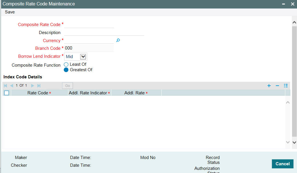

You can link composite rate codes to loans. Based on the formula maintained at the composite rate maintenance, system derives at a composite rate for floating rate.
To link composite rate code with an Oracle Lending (OL) product, you need to select composite rate code from the ‘Float Rate Input’ screen (CFDFLTRI).
To link composite rate code with OL contract, select composite rate code from the list of options available for ‘Floating Rate Code’ in the Loans and Commitment - Contract Input’ screen (OLDTRONL). During reprice, composite rate code can be linked to a contract by selecting ‘Rate Code’ available in ‘Consolidate Details ‘reprice screen (OLDREPRC).
Any rate change in Head Office for the index rate codes triggers a re-pickup of the rate for composite rates also and propagate the same to other branches for composite rate code. Branch wise changes to the index rate codes are not considered for re-pickup of composite rate code.
Note
At any point there can be either a composite rate code or a floating rate code, both cannot co-exist in a single contract. Composite rates are supported for Floating Periodic Auto and Floating Automatic type of loans. Composite rate code definition does not have any impact on the rate revision of a contract.
If there is any change in the index codes for a Composite rate code, the underlying Floating Automatic type of contracts are impacted and the new rate is arrived based on the derivation logic on that day’s EOD. In case of Floating Periodic Auto type of loans, the rate is derived on the EOD of the revision schedule. There is no impact of back value rate change of the index codes on the underlying Floating Periodic (Auto) type of Contracts.
You can maintain the composite rate code from the head office using ‘Composite Rate Code Maintenance’ screen.
You can access this screen by typing ‘OLDCMPMT’ in the field at the top right corner of the Application tool bar and clicking the adjoining arrow button.
Specify the following details here:
Composite Rate Code
Specify the code you want to maintain for the composite rate.
Description
Specify a small description for the composite rate code.
Currency
Select the currency for which the composite rate code is maintained.
Branch Code
Select the branch for which the composite rate code is maintained.
Rate Function
Select if the composite rate should be the least or greatest of the rates maintained plus the additional rate for the rate codes.
Following index code details are populated here:

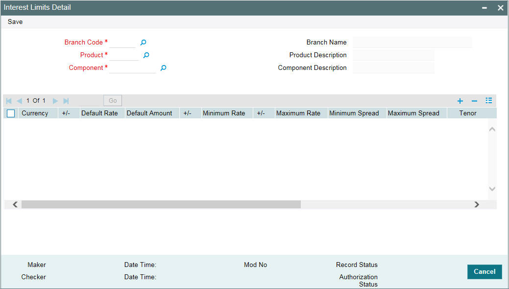

You can maintain tenor based, currency-wise interest limits for a combination of Product and Interest Component through the ‘Interest Limits Detail’ screen. You can access this screen by typing OLDINTLM in the field at the top right corner of the Application tool bar and clicking the adjoining arrow button.
When an interest class for which currency-wise interest limits have been maintained is associated with a Loans product (in the Interest Class Maintenance’ screen), the product inherits the limits, by default. Such default limits can be modified if required, when the interest limits for the product and branch combination are maintained, in the ‘Interest Limits Detail’ screen.This maintenance would be applicable for all contracts for which:
You can maintain the following information to set up the tenor-based, currency-wise interest limits for a product, interest component, and branch combination:

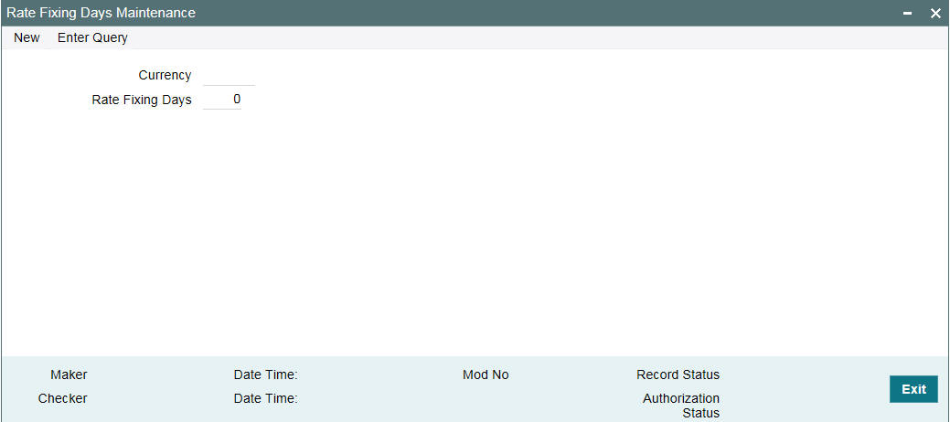

Capturing the Rate Fixing Days
The rate fixing days gets defaulted from the ‘Rate Fixing Days Maintenance’ screen. This is a numeric field. The system checks for the following:
Capturing the Default Amount or Default Rate for Late Payment Charge
For components defined with Rate Type ‘SPECIAL’ in ‘Interest Class Maintenance’ screen, you can specify a default flat amount or a default rate at the interest limit level which is defaulted to the ‘Interest Limits Details’ screen.
Based on the value of ‘Special Rate Type’, you can either maintain the ‘Default Rate’ or ‘Default Amount’ for late payment charge applicable to the loan product.
If the value of ‘Rate Type’ is ‘SPECIAL’ and ‘Special Rate Type’ is ‘FIXED’ in the ‘Interest Class Maintenance’ screen, then you can specify the default fixed rate to be applied as late payment charge to all loans created under this loan product.
You can specify the default late payment charge (either fixed rate or flat) by selecting the loan product code and the late payment charge component. This component should already be linked to the loan product through the ‘Interest Class Maintenance’ screen.
For Fixed Rate products
If the interest rate specified for a contract is less than this minimum rate, the minimum rate is applied on the contract. Similarly, if the interest rate specified for a contract is greater than this maximum rate, this rate is applied on the contract.
By defining minimum and maximum rates for a fixed interest, you can ensure that your rates stay within the stipulated limits.
For penal interest components, you can specify the overdue tenor for which the penalty interest should be applied.
For Rate Products
For Floating Rate products, specify the Minimum and Maximum spread that can be applied on the floating rate.
If the spread specified during contract processing is less than the value specified as the minimum spread, this value will be picked up as the spread. Similarly, if the spread specified during contract processing is more than the value specified as maximum spread, this value is picked up as the spread.
By defining minimum and maximum spread for floating interest, you can ensure that your spread stays within the stipulated limits.
The rate maintained for the maximum tenor is used if the Overdue days extend beyond the maximum tenor maintained.

You can invoke the ‘Rate Fixing Days Maintenance’ screen by typing ‘OLDCCYRF’ in the field at the top right corner of the Application tool bar and clicking the adjoining arrow button.
Specify the following:
Currency
Enter the currency. You can maintain rate fixing days for each currency. The currency details are defined in the Currency Details screens (‘CYDCDEFE’).
Rate Fixing Days
Enter the rate fixing days. The rate fixing days must be greater than zero and not greater than 5 days.

You have to specify the following attributes or preferences through the Product Preferences screen:
Once these attributes of the schedules are defined in the ‘Product Preferences’ screen, the frequency of repayments has to be defined through the ‘Product Default Schedules’ screen.
