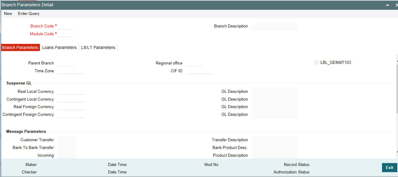

A set of rules that govern the loans that you disburse in a particular branch (of your branch) are defined through the Branch Parameters screen.
You can invoke the ‘Branch Parameters Detail’ screen by typing ‘OLDBRMNT’ in the field at the top right corner of the Application tool bar and clicking the adjoining arrow button.
Automatic processing like accruals, scheduled repayment, generation of billing advices or delinquency notices, and so on, falling due on a holiday is processed either on the last working day before the holiday, or on the first working day after it. The definition for this should be as follows:
If you specify that processing of automatic events should be done upto the System Date, automatic events scheduled till (inclusive of) the current system date are processed.
