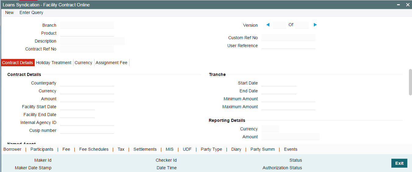

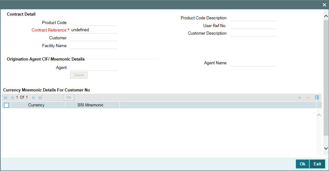

You can capture details for a borrower facility in the ‘Loan Syndication – Facility Contract Online’ screen. The screen is displayed with details of an existing facility.:
You can invoke the ‘Loan Syndication – Facility Contract Online’ screen by typing ‘FCDTRONL' in the field at the top right corner of the Application tool bar and clicking the adjoining arrow button.
To capture a new facility, click ‘New’ from the menu.
You can choose to enter the details of a facility either by:
Using a Template to enter a Facility
A template is a sample borrower facility, with details similar to that of many contracts under a category or involving a particular facility product. When a template is created, it can be re-used while entering other contracts and only those options specific to the contract need to be changed. Therefore, the process of specifying all the details for a contract is faster and easier.
To associate a template, you have to select the ‘Template’ from the option list. The details that have been stored for the template are displayed. A new reference number is automatically generated for the contract. After you have changed the values that need to be changed, click ‘Save’ to store the details in the system.
A description of the ‘Facility Contract Online’ Screen
In the ‘Loans Syndication - Facility Contract Online’ screen, you can capture the following details:
In addition, a vertical toolbar is also provided in the screen. These buttons are used to invoke other sub-systems meant to capture important information for processing a facility contract. These buttons have been described briefly below:

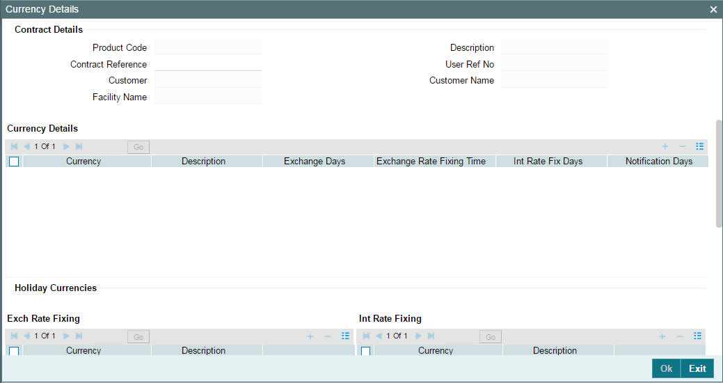

Currency |
Click on this tab to invoke the ‘Currency Details’ screen. In this screen, you can maintain an allowable list of currencies for the contract. |

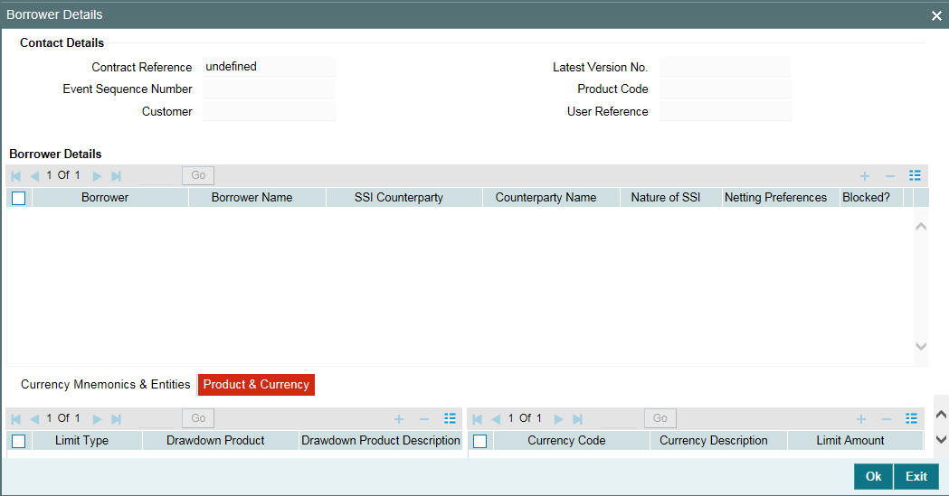

Borrower |
Click on this tab to specify the details pertaining to the borrowers of the facility contract. |

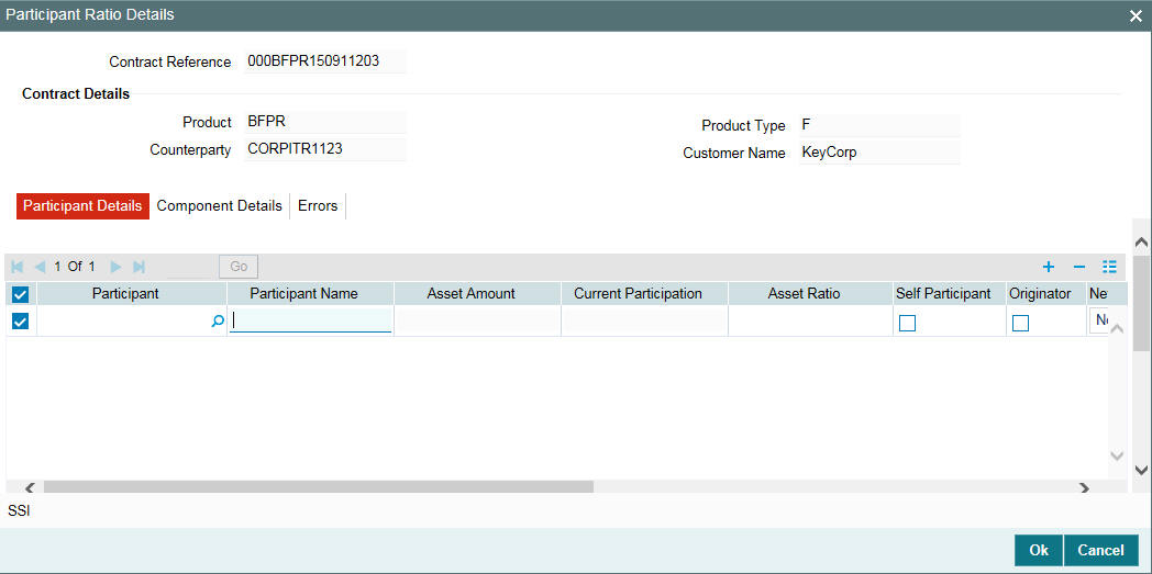

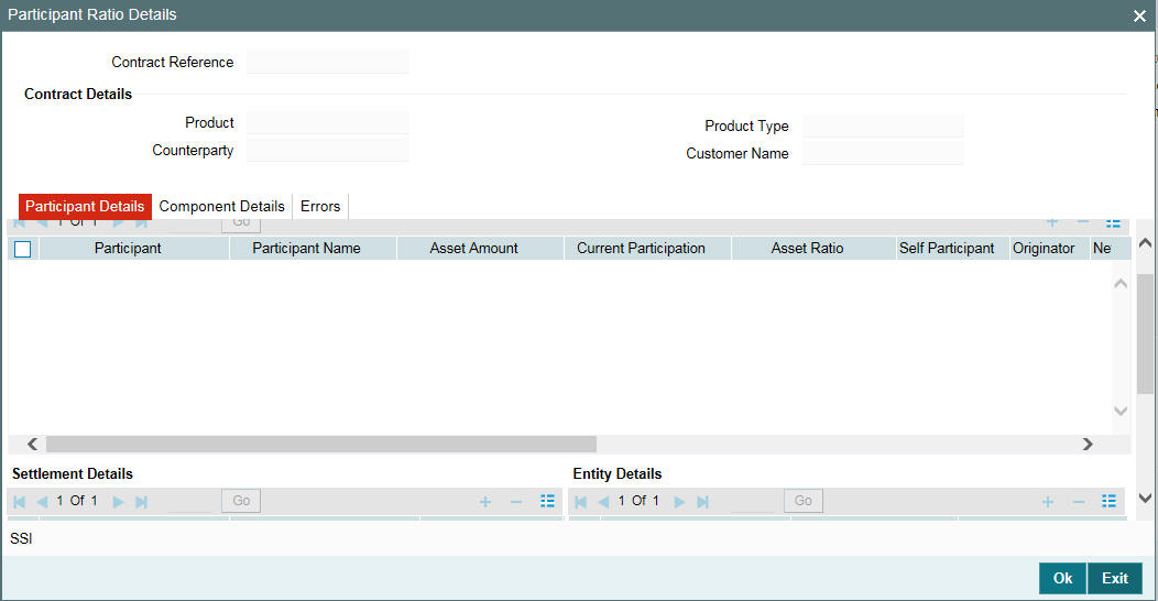

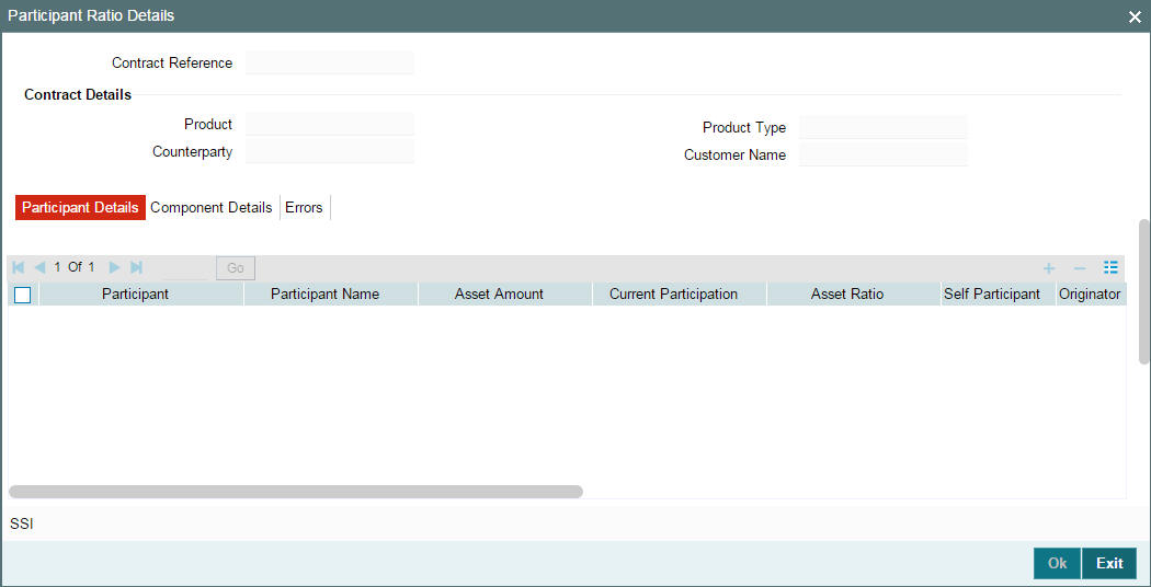

Participant |
This tab invokes the ‘Participant Ratio Details’ screen. |

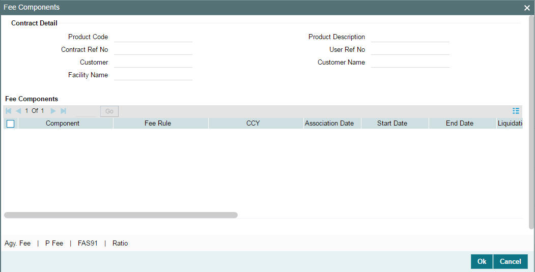

Fee |
This tab displays the ‘Fee Components’ screen where you can view the default fee details for the contract. |

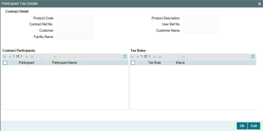

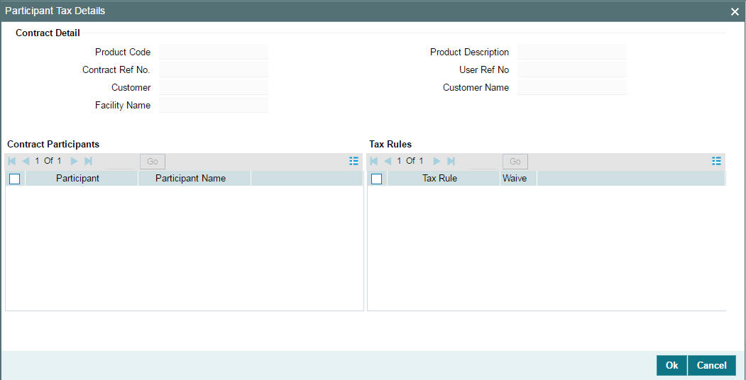

Tax |
You can view the ‘Participant Tax Details’ screen.

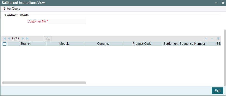

Settlements |
You can view the ‘Settlement Message Details’ screen. |

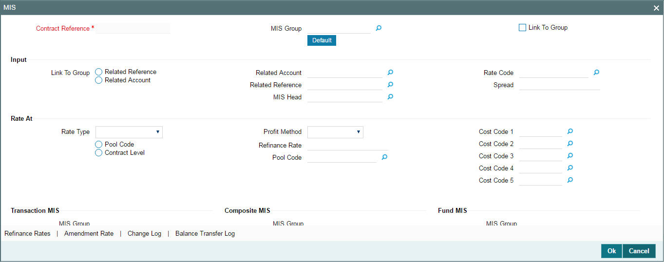

MIS |
Click this tab to define MIS details for the contract. |

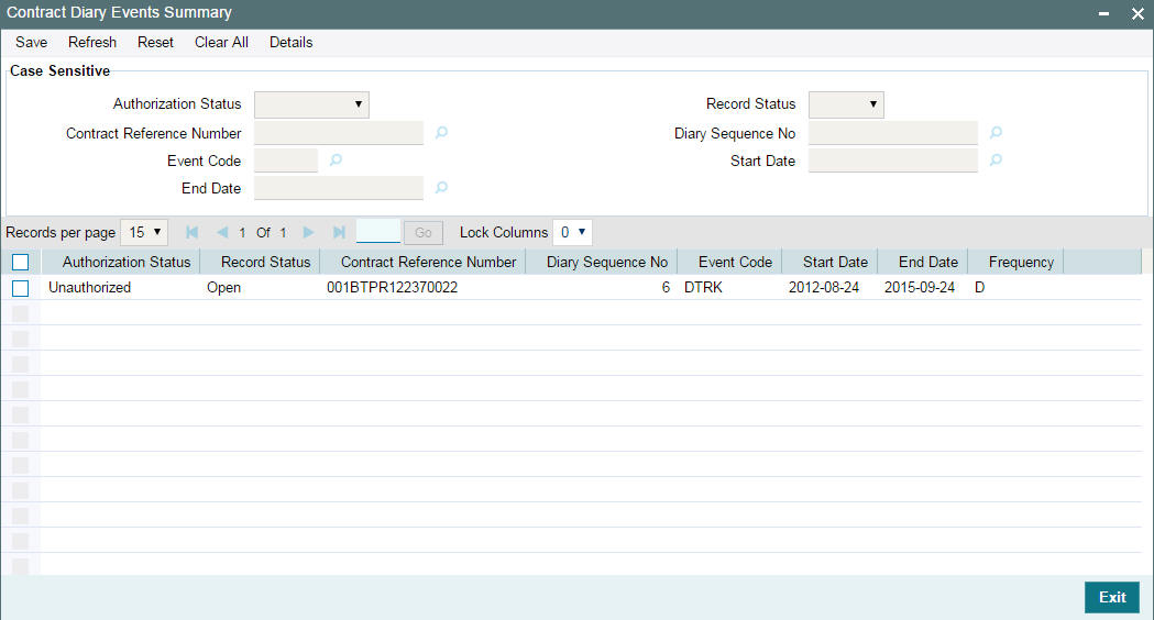

Diary |
Click this tab to invoke the ‘Diary Contracts – Summary’ screen where you can view the event details for the contract. |

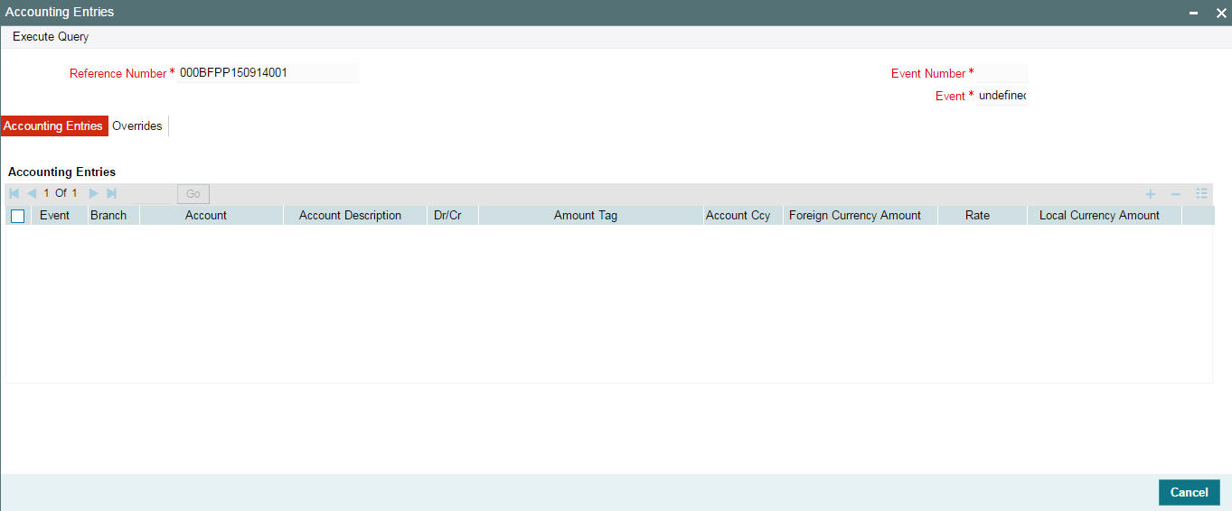

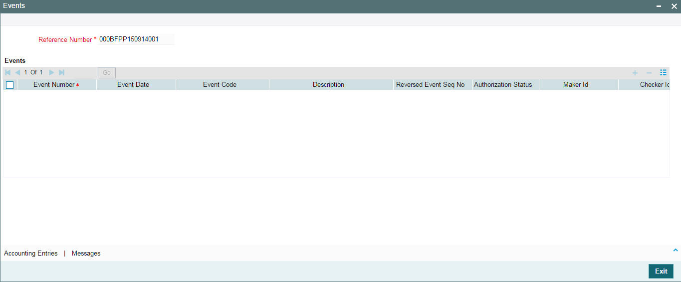

Events |
Click this tab to invoke the ‘Event Log Details’ screen. Here, you can view the accounting entries for each event and the overrides encountered, if any. |

The following section explains the procedure for capturing the contract by associating it with a facility product. Based on the product code you choose, many of the fields are defaulted. You can overwrite some of these defaults to suit your requirements.
Product
You have to select the appropriate facility product from the option list provided. All authorized products maintained in the ‘Facility Product Definition’ screen is available in the option list provided. After you select a product, the following details will default to the contract:
When you click on the ‘Tab’ key on the keyboard, the system automatically generates the following reference numbers.
Contract Reference Number
The Contract Reference Number uniquely identifies the borrower facility contract in the system. It is generated by the system automatically for every borrower facility contract.
The system combines the following elements to form the Contract Reference Number:
Example
For instance, if you are entering the facility contract with Mr. Robert Carr, as in our previous example, the Contract Reference Number generated by the system was 000SNEW000010001.
The Julian date is expressed in the following format - YYDDD
Here, YY represents the last two numerals of the year, and DDD, the number of elapsed days in the year.
Example
For instance, 00059, in Julian format, would mean the 28th of February 2000. Here, 00 stands for the year 2000, and 059 would stand for number of elapsed days in the year 2000. The number of elapsed days in January would be 31, followed by 59-31 days in February, which computes to 28.
User Reference Number
The reference number is the identification that you specify for the borrower facility contract. You can specify any identification number. In addition to the Contract Reference Number that the system generates, this number is also used to retrieve information about the contract.
By default, the Contract Reference Number generated by the system is considered to be the User Reference Number for the contract.
You can use the User Reference Number to uniquely identify as well as classify the borrower facility contract for the internal purposes of the bank. For instance, you may want to identify all facility contracts entered into with all customers (borrowers) of a certain net worth; or all customers in a particular nationality, or a particular industry, and so on. In such a case, you can supply a unique prefix to the user reference number to identify and classify the contract.
Custom Ref No
You can capture a unique reference number for the facility. This number is used to identify the facility in the system. You can also query the facility based on this number. The reference number can consist of a maximum of 16 alphanumeric characters. You have to capture the custom reference number as mandatory information for the facility.
In the ‘Contract Details’ section of the screen, you have to specify the following:
Customer
You must specify the customer with whom the facility contract has been finalized. This, typically, is the borrowing customer.
The customers allowed to be counterparty to a facility contract are defined at the facility product level. The customers allowed for the contract are displayed in the option list provided. Select the customer from this list.
Note
A primary entity must be defined for every customer who is allowed to be a borrower of the facility contract, in the ‘Borrower Details’ screen.
Example
When you are entering a borrower facility contract that we saw in the first example, with Mr. Robert Carr, you can select the code assigned to Mr. Carr, in the system, from the option list.
You must also designate a Primary Entity to whom advices and notices related to the contract would be sent.
Currency
You have to specify the currency of the borrower facility contract. The currencies allowed for the facility product are available in the option list provided. Select the currency from this list. This is the currency in which the contract amount is expressed.
Amount
Specify the total principal that is to be lent to the borrowing customer through the borrower facility contract. The value you enter here is taken to be in the currency specified for the borrower facility contract. You can specify T or M to signify thousand or million, respectively. For instance, 10T would mean ten thousand and 5M, five million.
When you specify the contract amount, the system computes and displays the facility amount in reporting currency using the exchange rate maintained between the two currencies (Contract Ccy and Reporting Ccy) for the branch. This is displayed in the ‘Reporting Details’ section of the screen.
Facility Start Date
This is the date on which the contract becomes effective in the system. On any date following this, you can capture the tranche-level commitment contracts and the individual drawdown loans in the system. By default, the current date is displayed here.
However, you can change this date to any one of the following:
To change the date, click the ‘Calendar’ button. The system then displays the following message to seek confirmation for the change:
‘Facility Start Date and Tranche Start Date are defaulted to System Date, Continue?’
Click ‘OK’ in the message window to proceed with the change.
Note
Example
For instance, when you enter the borrower facility contract with Mr. Robert Carr, you must enter 1st January 2000 as the Value Date.
The application date on the day you enter the contract could be earlier, later or the same as this value date. For instance, Mr. Robert Carr could approach you on 15th January 2000 and enter into a contract with your bank, wanting that the contract to come into effect on 1st January. The value date in this case is 1st January 2000, and the contract would be backdated.
For backdated contracts, you can enter backdated tranches and drawdowns.
Alternatively, Mr. Robert Carr could approach you on 15th December 1999, and enter into a contract with your bank, wanting that the contract must come into effect on 1st January 2000. This is the value date, and the contract would be future dated.
For future dated contracts, you cannot enter tranches before the contract actually comes into effect (that is, before the value date).
Facility End Date
This is the date on or before which all tranches and drawdowns under the borrower facility contract mature.
You can enter any future date as the facility end date. It must be later than the ‘Start Date’ defined for the product involving the borrower facility contract, and earlier than the ‘End Date’ of the same product.
The ‘Facility End Date’ must be later than the ‘Facility Start Date’ defined for the contract.

Use Facility Currency
If you choose this option, the system checks whether the schedule date falls on a holiday defined for the currency of the facility (borrower) contract. This is applicable if the currency is different from the holiday currency you specify.
Use Local Currency
If you choose this option, the system check whether the schedule date falls on a holiday defined for the local currency, provided this currency is different from the holiday currency and facility currency you have indicated.
Holiday Ccy
By default, the system checks the holiday calendar maintained for the facility currency before arriving at the schedule due date. However, if required, you can include another currency for a similar check.
If you specify another currency, the system checks the holiday calendar for both the facility currency as well as the currency you select here.
The system checks the holiday table for the currencies you have specified. If it encounters a contract using any of the specified currencies, with a schedule date falling on a holiday for any of the currencies, the holiday is handled according to the holiday-handling preferences you specify.
Specifying Holiday Handling Preferences for Maturity Date
Just as you maintain holiday handling preferences for schedules of the facility contract, so also you should maintain the preferences for handling maturity dates falling due on holidays. The preferences available are similar to the ones available for the schedules.

For a new contract, the default status is ‘NORM’ (Normal). It may be required that you change the default status of a contract. To change the status, select the appropriate status from option list provided. The statuses defined for the facility product through the ‘Status Maintenance’ screen will be available in this list.
For details on the ‘Status Maintenance’ screen, refer the heading ‘Maintaining statuses for a syndication product’ in the ‘Reference Information for Loan Syndication’ chapter of this User Manual.
Indicating Agency Type
You can indicate the agency type of the transaction from the following options.
Note
You can indicate the agency type during the facility booking and you are not allowed to do any amendments to this at a later stage for this transaction.
Specifying Other Details
You have to capture the following detail also for the facility contract:
Named Agent
Select an appropriate named agent from the adjoining option list. The list displays all valid named agents from ‘Named Agent Maintenance’ screen, who are mapped with the proof code that is the same as the department code under which the facility is being booked.
Note
Primary and Secondary administrators
You have to identify the officer assigned to be the primary and secondary administrator for the borrower facility contract. The administrators maintained through the ‘Administrator Details’ screen are available for selection. Upon selection of the code, the name of the administrator is displayed alongside.
For more details, refer the heading titled ‘Maintaining administrators’ in the ‘Reference Information for Loan Syndication’ chapter of this User Manual.
Agreement Title
A borrowing customer may avail a syndicated loan arrangement for a specific purpose, such as beginning a new venture, or a personal business project. You can capture this information as part of the facility contract.
You can also specify the agreement title in Chinese up to eighty five characters and the same is displayed in the ‘Loans Syndication : Draft - Tranche’ and ‘LS Tranche Contract Online’ screens.
Internal Remarks
You can specify information about the facility contract to be used for reference, within your bank. It is not printed on any correspondence with customers, but it is displayed when the details of the contract are displayed or printed.
You can also specify the internal remarks in Chinese up to eighty five characters and the same will be displayed in the ‘Loans Syndication : Draft - Tranche’ and ‘LS Tranche Contract Online’ screens.
Specifying Watch List Details
You can specify whether you want to keep the facility under watch. The following details related to the watch list can be specified here:
Watch List Facility
Select this check box to indicate that you would like to keep the facility under watch.
Watch List Remarks
Select the reason for including the facility under watch list from the option list available.
Note
This field is enabled only if you select the ‘Watch List’ check box.
The standard reasons for watch list are maintained in the ‘Static Maintenance -Detail’ screen.
The system displays the following override message when you try to perform any activity on existing tranches or drawdowns, or when you enter new tranches or drawdowns under a facility with Watch list. The override message displays the reason for the facility being under Watch List.
The underlying facility is under Watch List, reason being ‘Facility under Watch’
Do you want to continue?
For more details, refer the section titled ‘Maintaining Watch List Details’ in the ‘Reference Information for Loan Syndication’ chapter of this user manual.

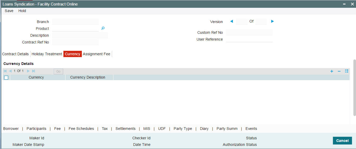

Specifying Allowable Currencies
You can specify the different currencies that are allowable for the borrower facility contract, for tranches and drawdowns created under it. It is mandatory to include the facility currency in this list. To specify the allowable currencies, click ‘Currency’ tab in the ‘Facility Contract Online’ screen. The ‘Currency Details’ sub-screen is displayed, where you can specify the required currency list.
To maintain the allowable list of currencies, do the following:
When you enter a tranche or a drawdown under the facility contract, the allowable currencies are those defined in this list.
Note
It is mandatory to maintain the allowable list of currencies for the facility before you invoke any of the other sub-screens. If not maintained, the system displays the following alert message when you attempt to invoke the other sub-screens:
Currencies are not entered.

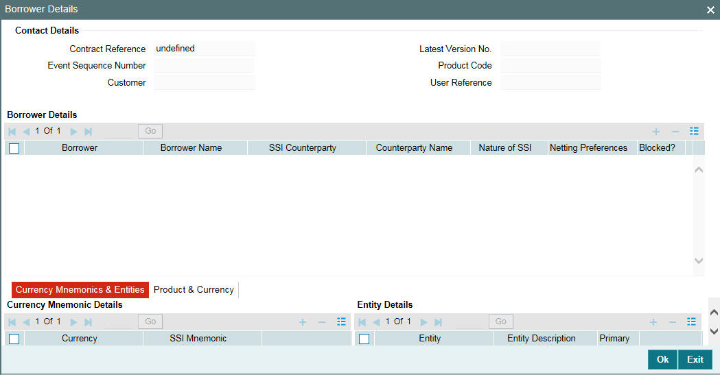

You must specify the borrowers for the facility contract, who actually avail the drawdown loans under the facility contract. Click the ‘Borrower’ tab to invoke the ‘Borrower Details’ sub-screen.
By default, the customer of the facility contract is the borrowing customer. The following details of this customer are displayed in this screen:
Note
You can specify more than one borrower for a facility contract.
To add another borrower, do the following:
Note
You can specify the SSI and Netting Preferences at the tranche level.
The details to be captured for a borrower of the facility contract are discussed below:
Specifying Currency Mnemonic Details
The list of allowable currencies maintained through the ‘Currency details’ screen are displayed in the ‘Currency’ column for each borrower. Here, you are not allowed to add a currency to the list. However, you may specify an SSI (Standard Settlement Instructions) Mnemonic for each of the allowable currency. The SSI selected for the facility contract becomes applicable to the tranches and drawdowns processed under it.
SSI Mnemonic
SSI Mnemonics are maintained in the ‘Settlement Instructions’ screen for a Counterparty, Module, Currency, Product and Branch combination. The same is available for the counterparty/borrower of the facility contract. The option list provided display the following details:
The Mnemonics selected here obtains the settlement details for the borrower of the contract.
Note
If you do not associate a Mnemonic with the currencies, the system defaults the SSI Mnemonic for the counterparty and contract currency when you exit the ‘Borrower Details’ screen. The settlement instructions maintained for the counterparty becomes applicable for all the borrowers of the contract.
To return to the ‘Borrower Details’ section of the screen, you have to click ‘Up Arrow’ button.

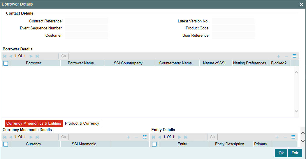

Maintaining Entity Details for a Borrower
The entities maintained for the counterparty through the ‘Customer Entity Details’ screen defaults to the contract.
Primary Entity
From the list of entities, you can designate one of them as the ‘Primary’ entity. The primary entity will be the recipient of notices and messages for the borrower.
Note
A primary entity must be designated for every customer who is allowed to be a borrower of the facility contract. If not specified, you are not allowed to save the details.
To return to the ‘Borrower Details’ section of the screen, you have to click ‘Up arrow’ button.

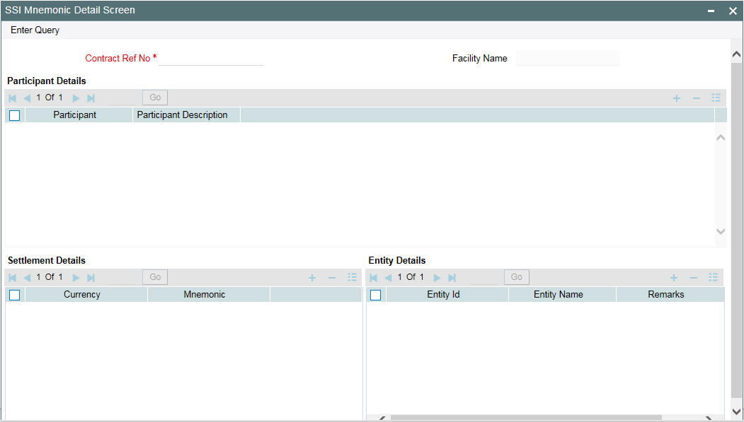

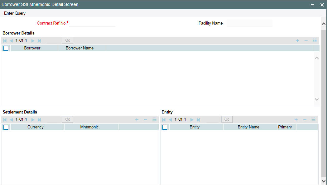

Oracle FLEXCUBE allows you to view the tranche details using the ‘SSI Mnemonic Detail’ screen. You can invoke the ‘SSI Mnemonic Detail’ screen by typing ‘LBDMENMC’ in the field at the top right corner of the Application tool bar and clicking the adjoining arrow button.
You can view the details of the participant in this screen.
You can view the details of the borrower in the ‘Borrower SSI Mnemonic Detail Screen’. You can invoke the ‘Borrower SSI Mnemonic Detail’ screen by typing ‘LBDBRMNC’ in the field at the top right corner of the Application tool bar and clicking the adjoining arrow button.
You can view the following details in the above screens:
Note
You can click the ’Unlock’ menu and edit the SSI Mnemonic details
In Oracle FLEXCUBE, you can amend the values of both borrower and participant sides made on Loan contracts through the ‘SSI Mnemonic Detail’ screen and then authorize the changes. On authorizing, the system displays the Change Log details along with the old values and new values.
Note
You can click on the ‘Unlock’ menu and edit the SSI Mnemonic details for a particular participant.
At the facility level, you can view the summary of the standard settlement instructions (SSI) maintained for the borrower and currency combination.
Select the borrower whose SSI details you want to view from Borrower
Details screen and click ‘Settlement
Instructions’ button.
You can invoke the ‘Settlement Instructions View’ screen by typing ‘LBDINSVW’ in the field at the top right corner of the Application tool bar and clicking the adjoining arrow button.
The details are displayed in the ‘Settlement Instructions’ screen as shown below:
You have to click ‘Exit’ button to exit and return to the ‘Borrower Details’ screen.
You must also identify the participants who contribute to the syndication agreement for the borrower facility contract. You can do this through the ‘Participant Ratio Details’ screen. To invoke this screen, click the ‘Participant’ tab in ‘Facility Contract Online’ screen.
The following details are displayed in this screen:
Each of the above procedures is discussed below:
You can select the participants for the contract in the ‘Participant Ratio Details’ screen using Participant Details tab.
You can select participants from the ‘Participant’ option-list.
Note
GFCID is specified at the time of maintaining customer details in the ‘Customer Maintenance’ screen.
In the ‘Participant Ration Details’ screen, you can specify the proportion of income from the interest, charge and ad-hoc fee components (if applicable), which is due to each participant. This is expressed in percentage. System displays the component wise ‘Total’ in the last row.
Note
The component wise total ratio should be 100%. The system displays an error message if the total exceeds or is less than this value.
Additionally, you have to specify the following details for each participant:
The following preferences can be defined for a participant:
Self Participant
Select this check box to indicate that the participant is a Self Participant. A self participant is one who is leading the loan contract.
Originator
Select this check box to indicate that the Self Participant is the originator. This is enabled only if the ‘Self Participant’ check box is selected.
You can mark only one self participant as the originator.
SSI Mnemonic
The SSI Mnemonics maintained in the ‘Settlement Instructions’ screen for the Counterparty, Module, Currency, Product, and Branch combination involved in the contract, is displayed in the option list provided. You can select the required value from this list. The value selected here obtains the settlement details for the participants of the contract.
If you do not specify the SSI Mnemonic for all the participants, system displays the following message:
SSI mnemonics for some/all participants have not been entered. It will be defaulted.
Note
You also have the option to select component wise SSI Mnemonic for each participant of the tranche.
For more details on selecting component wise SSIs, refer the heading ‘Changing the SSI for a component’ in this chapter.
Participant Type
Select the type of participant from the drop-down list. Following are the options available in the drop-down list:
Note
The participant type detail should be at the Tranche level.
Entity ID
For each participant, you have to associate an entity(s) to whom copies of the advices related to the contract will be sent. The entities maintained for the participants through the ‘Customer Entity Details’ screen defaults to the contract.
From the list of entities, you can designate one of them as the ‘Primary’ entity. The primary entity is the recipient of notices and messages for the participant.
Note
A primary entity must be designated for every customer who is allowed to be a participant of the facility contract. If not specified, you are not allowed to save the details.
Remarks
You can specify remarks for each entity associated with the participant here. A maximum of 105 characters is allowed.
To select the next participant, click ‘Add Row’ button.
The fee components defined for the underlying facility product becomes applicable to the contract. To view the fee details, click ‘Fee’.
The following details of the components are displayed based on the product used:
Note
The Fee Basis defaults from the product level. However, the system allows you to amend the default value on saving the contract for the first time. Once the contract is authorized, you cannot make any further amendments to the fee basis.
You can modify the following details only:
Start Date
By default, the start date is equal to the ‘Facility Start Date’. This is the date on which the ad-hoc fee component becomes applicable for the facility. You can change the date only if the ‘Allow Start Date Input’ is selected for the component (in the ‘Borrower Product – FEE Details’ screen). If allowed to modify, the new date should be:
End Date
By default, the end date will be equal to the ‘Facility End Date’. This date marks the end of the component association period for the facility. You can change this date only if the ‘Allow End Date Input’ is selected for the component (in the ‘Borrower Product – FEE Details’ screen). If allowed to modify, the new date should be:
For more information on ‘Borrower Product – FEE Details’ screen, refer the heading ‘Specifying fee components for a borrower product’ in the ‘Defining Products for Loan Syndication’ chapter of this User Manual.

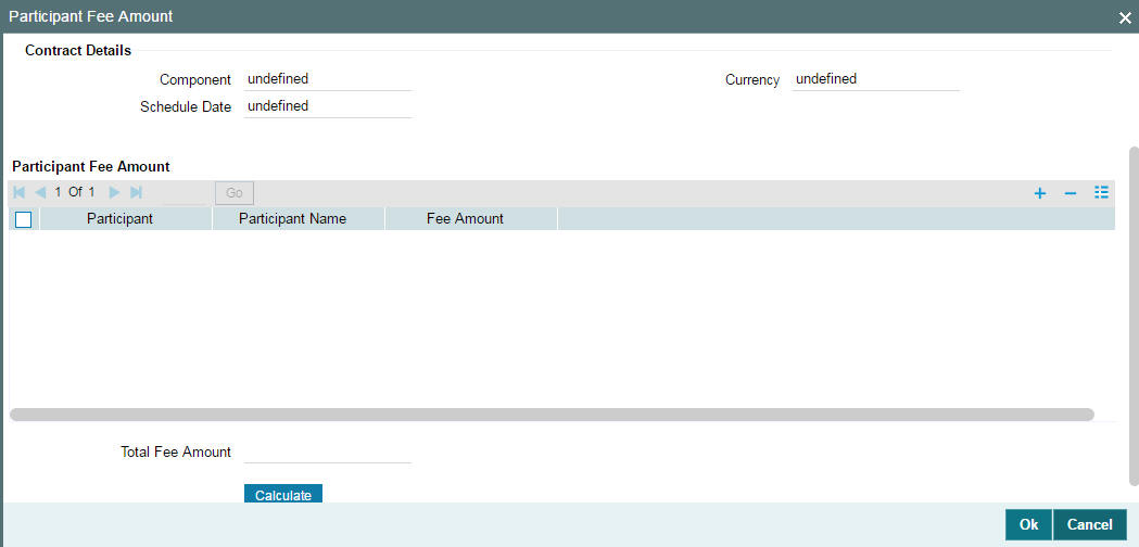

Click ‘P Fee’ in the Fee Components screen to define the fee amount for each participant. This button is enabled only if the fee class is Participant Driven. You can specify the participant fee in the ‘Participant Fee Amount’ screen.
In this screen, click the button to select the participants for whom you want to specify the fee amount. Once you select the participants, the names of the participant’s are displayed. You can specify the amount for each participant in the ‘Fee Amount’ field.
Based on the fee amount you specify here, the participant’s ratio is computed and displayed in the ‘Participant Ratio Details’ screen.
Note the following:
Note
After changing the details, click the ‘Ok’ to save and exit screen.

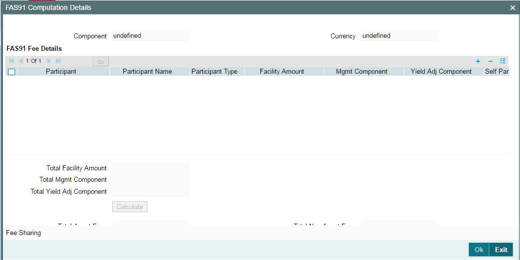

In the Fee Components screen, you can capture the FAS91 fee details.
Click ‘FAS91’ to specify information related to FAS91 in the ‘FAS91 Computation Details’ screen. This option is enabled only for components where the FAS91 check box is selected at the product level.
On invoking this screen, the following details are displayed:
Click to select the participants for whom you want to calculate FAS91 details. A ‘Participant Selection’ screen will pop up with a list of all customers maintained in the system. On selecting the participants, system will display the same under the FAS91 Fee Details section in the ‘FAS91 Computation Details’ screen.
The other details required to be maintained in this screen are as follows:
Participant Type
Select the appropriate participant type from the drop down list. Values in the drop down are:
It is mandatory to specify a type for each participant. However, no validation would be performed on the basis of the participant type.
Facility Amount
Specify the facility amount for each participant. This amount will be used to calculate the weighted average yield for each participant.
Mgmt Component
Specify the management component of the fees. The value you specify here will be used to calculate the Weighted Average Yield. If you do not specify any value, system will default it to zero.
Yield Adj Component
Specify the yield adjustment component of the fees. The value you specify here will be used to calculate the Weighted Average Yield. If you do not specify any value, system will default it to zero. System will validate to ensure that the sum of Mgmt Component and Yield Adj Component does not exceed the facility amount.
Self Participant
Check this box to indicate that a participant is a self participant.
Once you specify the above details, click in the ‘FAS91 Computation Details’ screen. System will compute and display values for the following fields:
Total Bank Fees
This is the sum of the Mgmt Component and Yield Adj Component for all participants for which the ‘Self Participant’ check box was not selected.
Weighted Avg Yield of Part
System displays the weighted average yield of the participant. This is calculated as follows:
Sum (Yield Adjustment Component across all Participants which are not Leaders/Co Leaders and not Self Participant) / Sum (Facility amount across all Participants which are not Leaders/Co Leaders and not Self Participant)
Fees to be Amortized
System displays the fees to be amortized. This is calculated as follows:
Sum (Facility Amount for all self participants) * Weighted Average Yield
Fees to be Recognized
System displays the fees to be realized. This is calculated as follows:
Sum (Mgmt Component + Yield Adj Component of self participants) – (Fees to be amortized)
Pass FAS91 Accounting Entry
Select this check box to indicate that you can pass accounting entries for FAS91.
Note
You can liquidate FAS91 fees with other fee components.
You can specify the income sharing between the legal entities for each FAS91 fee using the ‘FAS91 Fee Sharing Details’ screen. Using this screen, you can also capture the branch or legal entity details and the expense code for FAS91 fees.
To invoke the ‘FAS91 Fee Sharing Details’ screen, click ‘Fee Sharing’ in the ‘FAS91 Computation Details’ screen.
Fee Component
System displays the fee for which the fee sharing ratio is calculated. If there are more than one FAS91 fees, system captures the fee sharing ratio for each component.
Branch/Legal Entity
Select the branch or legal entity from the list of options. System displays a list of all the branches maintained in the system in the option list.
Account No.
Select the GL account into which you want to post an entry. System displays a list of all GL leaves for the branch code are displayed in the option list.
Expense Code
Specify the Expense code with which you want to post an entry. System displays a list of all valid MIS codes in the option list.
Ratio
This is the ratio in which the ‘Fee to be Recognized’ is to be split. For example, if the ‘Fee to be Recognized’ is 100,000 out of which 40,000 is to be posted to the Branch, GL, Expense Code, you need to specify 40 in this field.
System validates to ensure that the total ratio is always 100.

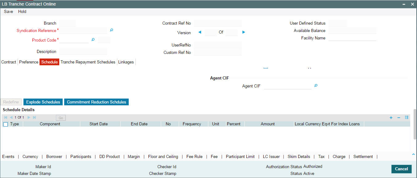

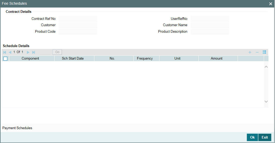

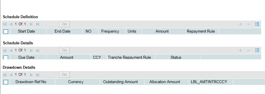

You can specify schedules for fee components through the ‘Fee Schedules’ screen. To invoke this screen, click the ‘Fee Schedules’ button in the ‘Facility Contract Online’ screen.
Capture the following details in this screen:
Component
The fee components that have been associated with the product are available in the option list. Select a component from this list. Upon selection of the component, the ‘Schedule Start Date, Frequency and Unit’ are also displayed. You can change the default values.
Sch Start Date
This is the date on which the schedule for the fee component for the borrower facility begins. By default, this is equal to the fee ‘Association Date’. The first schedule would fall due on this date. You can change the date to any date that falls between the ‘Association Date’ and the ‘Facility End Date’.
No.
You must specify the number of schedules that would apply to the fee component of the borrower contract.
If you define a single schedule (that is, the number of schedules is one), Oracle FLEXCUBE initiates one schedule on the start date mentioned, not taking into account the frequency and the frequency unit.
Note
The Start Date for a single schedule is as follows:
If you define more than one schedule, Oracle FLEXCUBE initiates the first schedule on the start date mentioned, and subsequent schedules based on the frequency and the frequency unit specified.
Frequency
Select the periodicity at which the schedules must be initiated, with the first schedule on the start date mentioned. The options available are
Unit
You can specify the units in which the specified frequency are reckoned. For instance, consider a contract with the following details:
This means that the contract will have two schedules, initiated once in five months.
Amount
If the ‘Basis Amount Tag’ of the fee component is ‘User Input’ (as specified in the Borrower Product – Fee Details’ screen), you can capture the amount to be liquidated towards the fee component on the schedule date.
For all other ‘Basis Amount Tags’, the system computes the fee amount based on utilization.
For more details on defining fee components, refer the heading ‘Associating a Fee Class or Fee Rule with a product’ in the ‘Processing Charges and Fees’ chapter of this User Manual.
Note

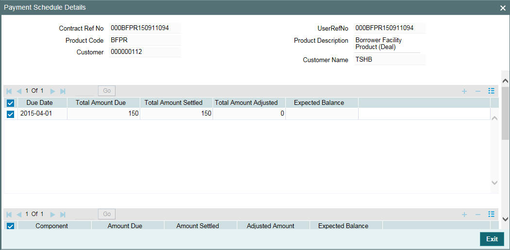

After capturing the schedules for the fee components, you can view the payment schedule details for the contract. To view the details, click the ‘Payment Schedules’ button.
The ‘Schedule Payment Details’ screen is displayed as shown below:
For each component, it updates the following details:
In the ‘Payment Schedule Details’ screen you can view the schedule date changes and schedule history details.
You can collect withholding tax from participants on fee components.
If you have associated tax rules with the participant product linked
with the underlying facility product, the same becomes applicable to
the facility. You can view the tax details for the contract in the ‘Participant
Tax Details’ screen. Click the ‘Tax’ to invoke the screen.
This screen l displays the list of participants for the contract and the tax rules associated the contract, if any. This defaults from the facility product. If required, you may cancel the application of tax rule(s) for a participant. To do this, check the ‘Waive’ option against the selected tax rule.
The system passes the entries for tax based on the event you specify in the ‘Product Tax Linkage’ screen. Typically, tax on fee is calculated upon liquidation of the fee (event ‘FLIQ’ will be associated with the rule)
You can view the position identifier description in case the participant is Self Participant.
For details on associating tax with a product, refer the heading titled ‘Specifying tax details for a participant product’ in the ‘Defining Products for Loan Syndication’ chapter of this User Manual.
For more information on the Tax sub-system of Oracle FLEXCUBE, refer the Tax User Manual.

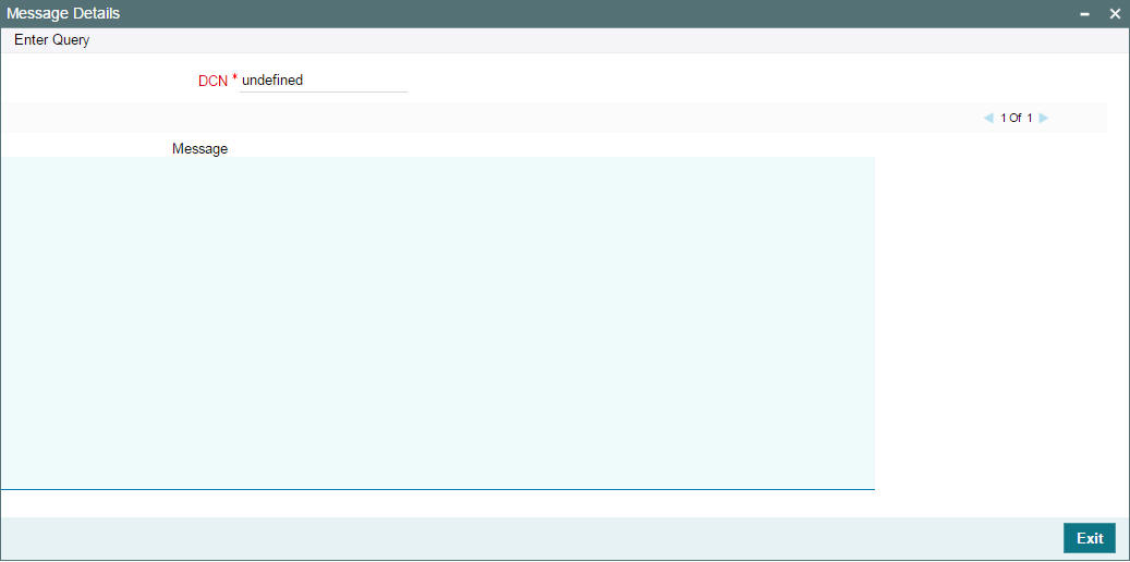

You can view the settlement instructions for each borrower of the contract. You can use the ‘Settlement Message Details’ screen to do this. Click ‘Settlements’ in the ‘Facility Contract Online’ screen to access it.
The system obtains the settlement details based on the SSI Mnemonic for each borrower.
Note
When you are entering a contract in the ‘Facility
Contract Online’ screen, and you click the ‘Settlements’ tab to invoke the ‘Settlement
Message Details’ screen, the first line in Field 72 of the message
generated will be replaced by the name of the customer (or borrower)
involved in the contract. The second line will be replaced by the ‘User
Reference Number’ of the tranche contract. Once the SWIFT message
is generated, the customer name and the user reference number will be
displayed in the section titled ’72: Sender to Receiver Information’
in the second ‘Msg Details’ tab. This is shown below:

You can view the MIS (Management Information System) details in the ‘MIS Details’ screen. To invoke this screen, click the ‘MIS’ in the ‘Facility Contract Online’ screen.
For details on the ‘Transaction MIS Details’ screen, refer the MIS User Manual.
While booking a new facility, upon selection of named agent, the system defaults expense code and proof code in Transaction MIS maintenance sub-screen in facility contract online screen.
While booking a new tranche, Expense code and proof code from facility contract are defaulted in MIS sub-screen in tranche online screen.
Similarly, while booking a new Drawdown, Expense code and proof code from tranche contract are defaulted in MIS sub-screen in Drawdown online screen
System allows you to change the values of the expense code and proof code in the MIS screen, while booking a facility, tranche, or a drawdown. However, if the validation fails, system displays appropriate error messages if the following validations are not met:

You can view the diary events defined for the contract in the ‘Diary Contracts – Summary’ screen. To invoke this screen, click ‘Diary’.
Diary events are user defined events which are maintained at a module level through the ‘Diary Event Maintenance’ screen. You can associate the required diary events with a product in the ‘Diary Event Association’ screen.
The system allows you to perform a case-independent query (upper, lower, or mixed case) using the following fields:
Note
You can perform a case independent search only if the parameter, ‘CASE_SENSITIVITY’ in cstb_param, is set to ‘Y’
For more details on this screen, refer the heading ‘Maintaining diary events’ in the ‘Reference Information for Loan Syndication’ chapter of this User Manual.
For a borrower facility, tranche or drawdown contract, you can specify diary events that needs to be processed through the ‘Contract Diary Events’ screen.
Refer the heading ‘Specifying diary events for a borrower syndication contract’ in this chapter for details on the ‘Contract Diary Events’ screen.

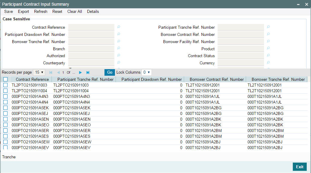

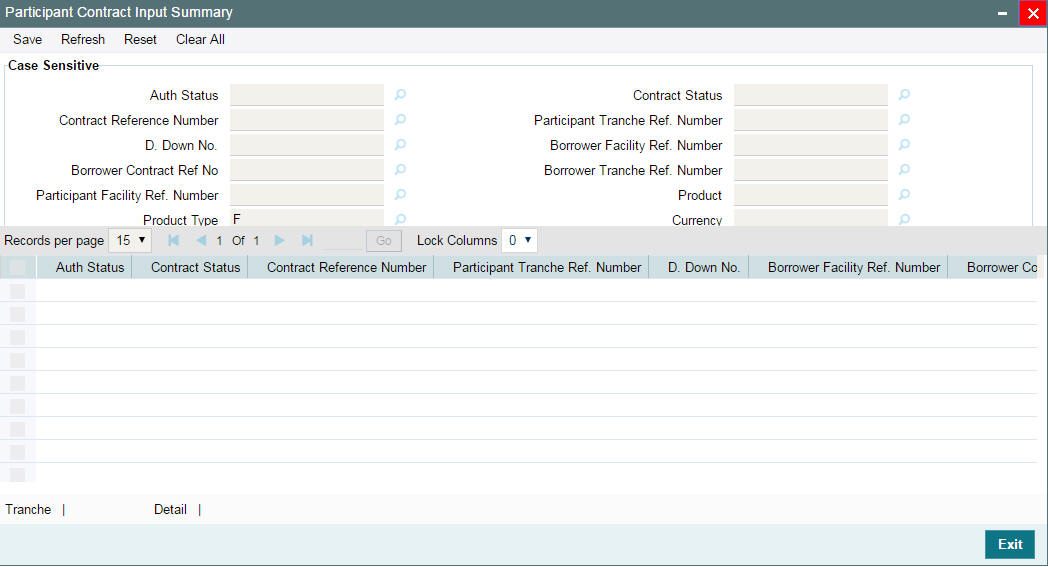

The ‘Participant Facility Contract Summary’ screen will give you a summary of the participant facility contracts created under a facility contract. To view the details, click the ‘Part Sum’.
In this screen, the following details are displayed:
From the ‘Participant Facility Contract Summary’ screen, you can also view the participant tranches created under a participant facility contract.
To view a participant facility contract go to ‘Loans Syndication – Participant Contract Input (LPDCOMNT)’ screen. .
For more details on this screen, refer the heading ‘Viewing Participant Contracts’ in this chapter.
You can view the events triggered during the contract life cycle in
the ‘Event Log Details’ screen. To invoke this screen, click
the ‘Events’ in the ‘Facility
Contract Online’ screen. The events defined for the facility product
are triggered for the contract.
To view the event wise accounting entries, select the event and click ‘Accounting Entires’ .
This screen displays the details of accounting entries passed for the selected event and the overrides encountered during the event, if any.
Click ‘Cancel’ button to exit the screen. You return to the ‘Event Log Details’ screen.

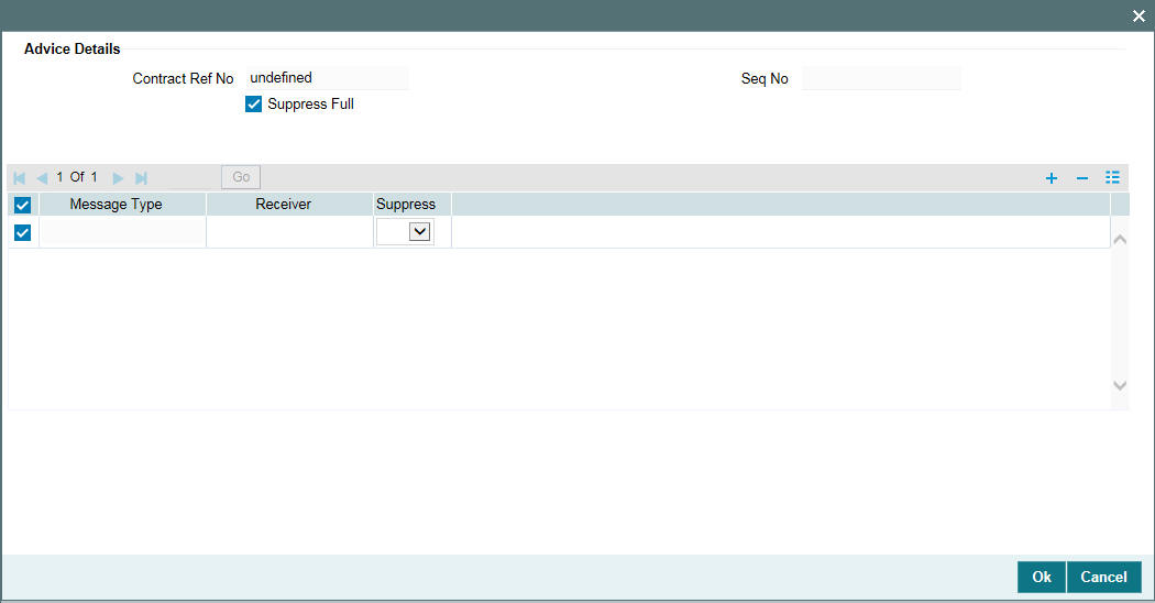

You also have the option to view the messages/advices received (IN) or fired (OUT) during the event.
The Advice Message screen appears. It displays all the messages which are generated against that event.
The name, location, address of the customer and the media used for sending the message get displayed in this screen along with the message details.
For FpML messages, the value of ‘Media’ gets displayed as ‘FPML’.

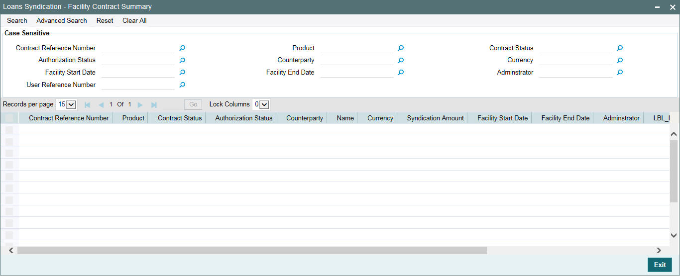

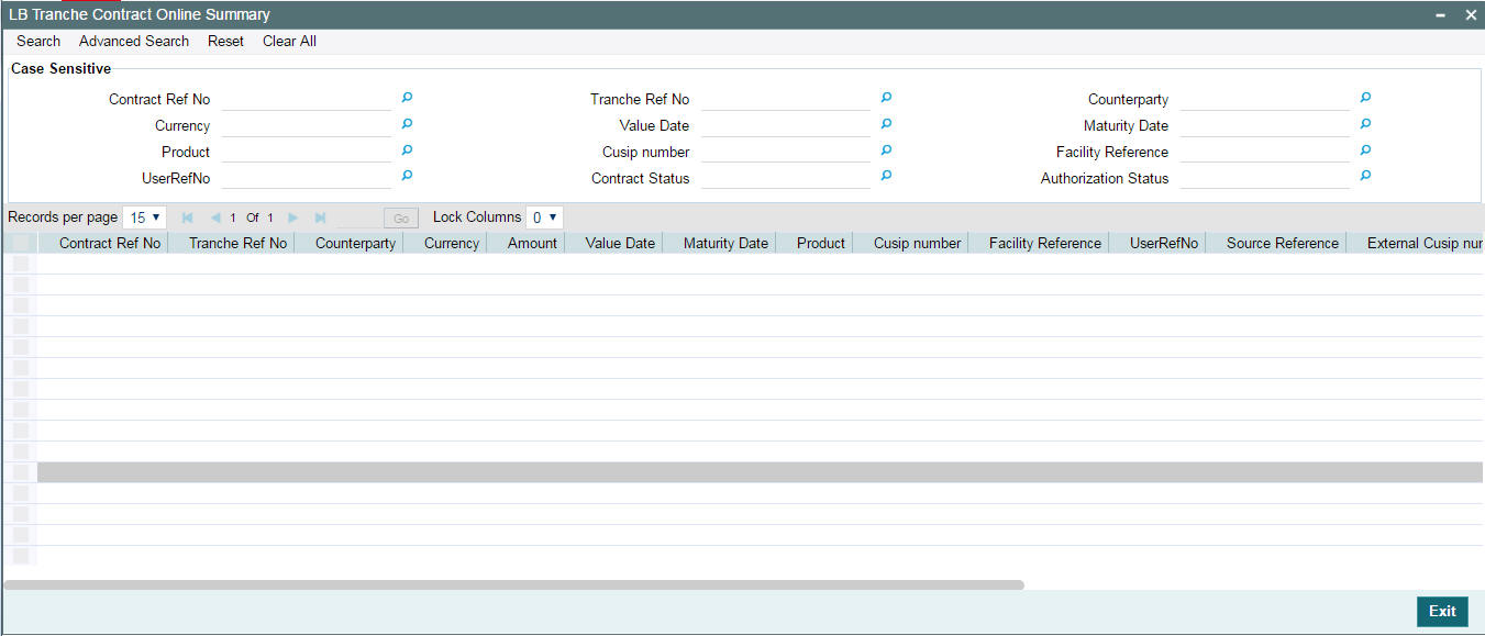

You can view the Facility details summary on the ‘Loans Syndication - Facility Contract Summary’ screen. You can invoke the ‘Loans Syndication - Facility Contract Summary’ screen by typing ‘FCSTRONL’ in the field at the top right corner of the Application tool bar and clicking the adjoining arrow button.
Note
You can perform a case independent search only if the parameter, ‘CASE_SENSITIVITY’ in cstb_param, is set to ‘Y’.

You must also specify schedules for drawdowns under the tranche. The system generates a Reference Number for the borrower commitment contract.

Participant contracts initiated by the system can be viewed and amended using the Participant Contract screen, which is discussed later in this chapter.

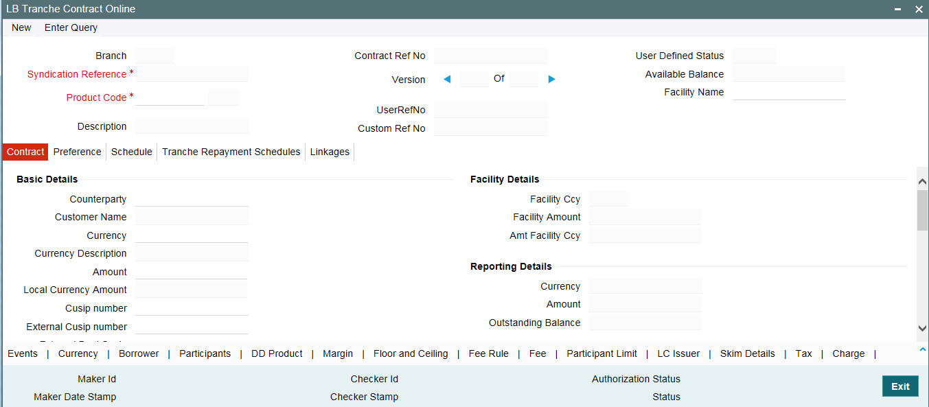

You can process a tranche contract in the ‘LS Tranche Contract Online’ (LBDTRONL) screen.
Similar to capturing a facility contract, you can capture a tranche contract either by:
The CUSIP and SSI Counterparty (Settlement Party) are unique across tranche contracts under the same CUSIP. The system validates the SSI Counterparty and CUSIP while saving the tranche contract and displays the following error message In case of duplicate tranche booking.
Tranche with the same SSI Counterparty and CUSIP Number already exists.
For more details, refer the heading ‘Entering the facility details’ in this chapter.
Note that you can add a CUSIP to an existing tranche. Similarly, you can associate an existing CUSIP with a new tranche.
In the ‘LS Tranche Contract Online’ screen, you can capture the following details:
In addition, a vertical toolbar provided in the screen, may be used to invoke other sub-systems meant to capture important information for the tranche contract. These buttons have been described briefly below:

Click this tab to invoke the ‘Currency Details’ screen. In this screen, you can maintain the holiday currencies for various events and exchange rate fixing and interest rate fixing details.
Borrower |
Click this tab to specify the details pertaining to the borrowers of the tranche contract.
Participant |

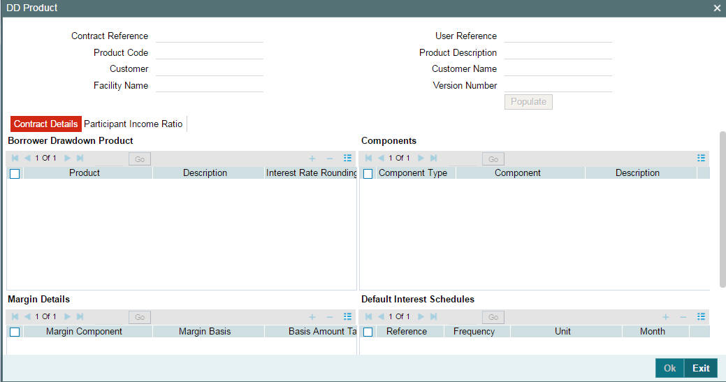

DD Product |
This tab displays the ‘DrawDown Products’ screen. |

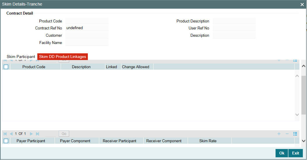

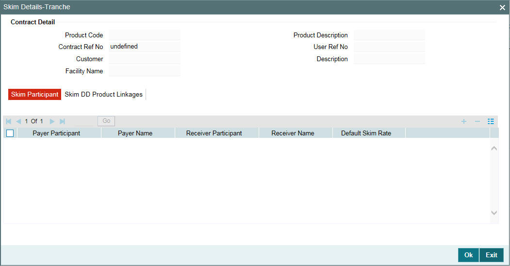

Skim Details |
Click this tab to maintain the Skim details for participants of the tranche. |

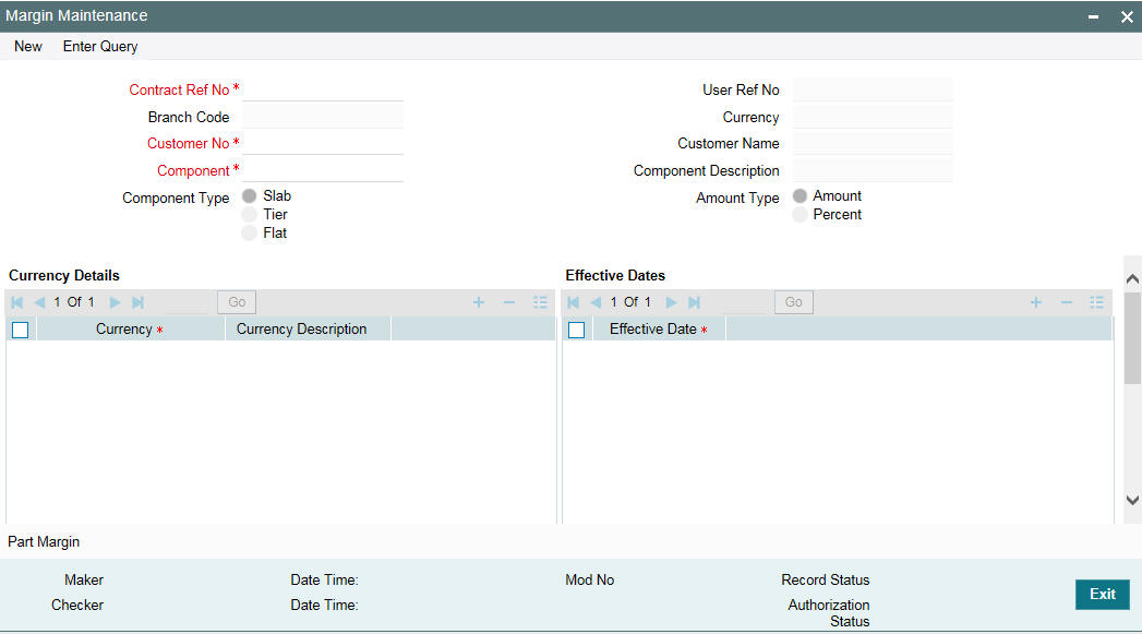

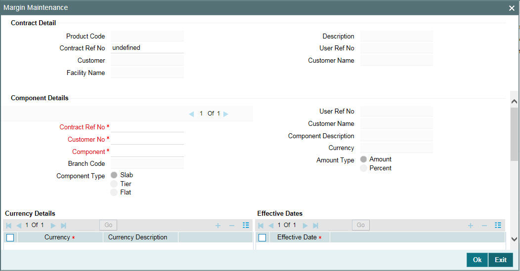

Margin |
Click this tab to maintain the margin Slab/Tier structure. |

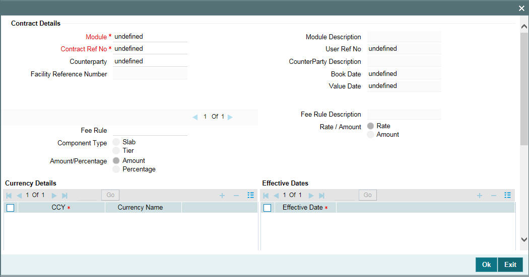

Fee Rule |
Click this tab to associate fee rules with the contract. |

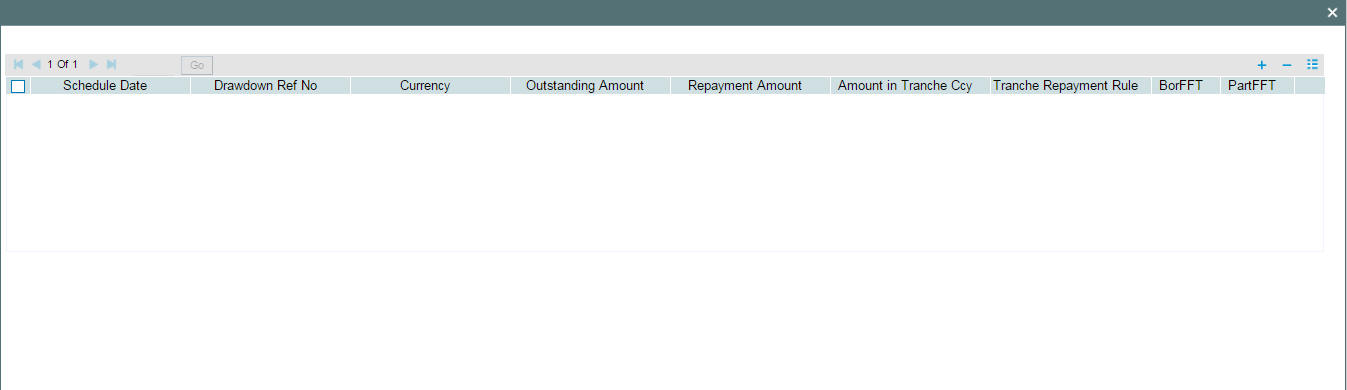

Tranche Repayment Schedules |
Click this tab to define repayment schedules for tranche |

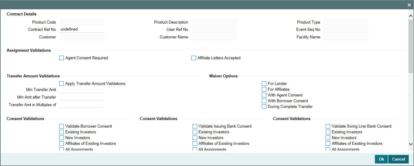

Assignment’ |
Click this tab to invoke ‘Assignment Validations’ screen. |

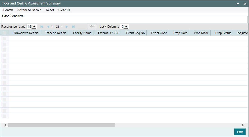

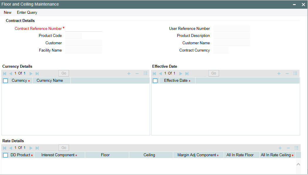

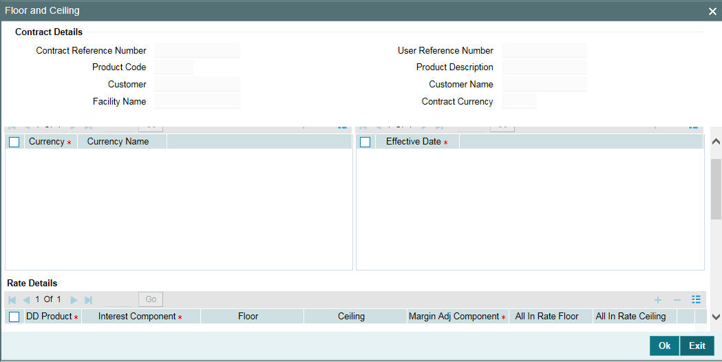

Floor and Ceiling |
Click this tab to invoke ‘Floor and Ceiling’ screen. |

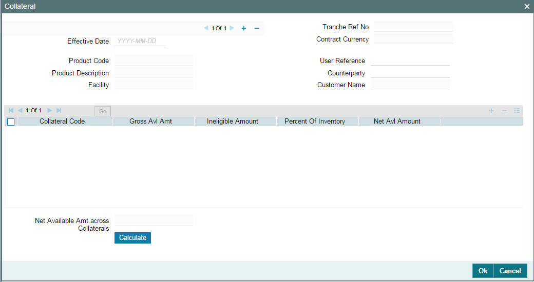

Collaterals |
Click this tab to invoke the ‘Collateral’ screen. |

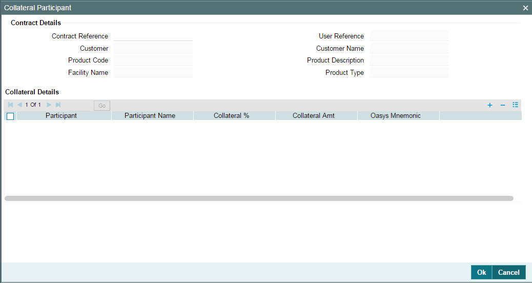

Collateral Participant |
Click this tab to invoke the ‘Participant Collateral Detail’ screen. |

Agent CIF |
Click this tab to invoke ‘Origination Agent CIF/Mnemonic Maintenance’ screen. |
To capture a new tranche contract, select ‘New’ from the menu.. In ‘LB Tranche Contract Online’ screen, enter Syndication Reference and Product code. The following information defaults to the ‘Contract’ tab of the screen:
In the header section of the screen, you have to specify the following:
The reference number is the identification that you specify for the borrower tranche. You can specify any identification number. In addition to the ‘Contract Reference Number’ that the system generates, this number is also used to retrieve information about the tranche.
By default, the ‘Contract Reference Number’ is considered to be the User Reference Number for the tranche.
Custom Ref No
You can capture a unique reference number for the tranche contract. This number is used to identify the tranche in the system. You can also query the tranche based on this number. The reference number can consist of a maximum of 16 alphanumeric characters. You have to capture the custom reference number as mandatory information for the tranche.
Facility Name
You can provide a name to the tranche being processed. The facility name is available for querying the contract. This name is also displayed for all the drawdowns processed under the tranche. At the drawdown level, you cannot change the facility name.
The name can consist of a maximum of 35 alphanumeric characters and you are allowed to amend the name anytime during the tranche life cycle. This results in change of the facility name in all the linked drawdown contracts.

Amount
You have to specify the total amount that should be committed under the tranche (for borrower tranche contracts). The amount you enter must be:
If the amount is below this minimum, the following error message is displayed:
Amount must be more than the minimum defined at the facility contract level
Amount must be less than the maximum defined at the facility level
The value you enter here is taken to be in the currency specified for the facility contract. You can specify T or M to signify thousand or million, respectively. For instance, 10T would mean ten thousand and 5M, five million.
Note
Ext CUSIP/ISIN
The external CUSIP/ISIN number is captured here. It is modifiable as part of contract amendment (CAMD).The external CUSIP number is not used for internal processing, but it is used in non-processing areas such as faxes, payment messages, reports and interfaces.
The FpML messages for the participants at tranche and drawdown level are generated only if you have specified the External CUSIP/ISIN number. Otherwise, it is systematically suppressed.
After authorization of the contact amendment, which triggers the CUAD (CUSIP Amendment) event, the external CUSIP/ISIN is propagated to all the underlying drawdowns, linked commitment, its underlying loans, linked trades if any.
External CUSIP/ISIN gets defaulted to all the drawdowns processed under the tranche and cannot be changed at the drawdown level.
Whenever there is a change in the External CUSIP/ISIN, the system sends the following FpML messages to Markit (a financial system that acts as an inventory for all agency activities)
Refer the chapter ‘FpML Messaging’ for more details on the update process
Ext Deal CUSIP/ISIN
Specify the external deal CUSIP/ISIN.
It is not mandatory to specify the Ext Deal CUSIP/ISIN. System does not perform any validation for the uniqueness of the Ext Deal CUSIP/ISIN. Multiple tranches can have same Ext Deal CUSIP/ISIN. However, system validates that the maximum permissible length for the value you specify for ‘Ext Deal CUSIP/ISIN’ does not exceed 16 characters.
Ext Deal CUSIP/ISIN is captured during Tranche booking. However it can be amended during Tranche amendment, from the 'Tranche Contract Online' screen. During Tranche booking, the value for ‘Ext Deal CUSIP/ISIN’ is defaulted from the ‘CUSIP No’ of the Facility (Deal). The defaulted value can be changed, if required. However, any amendment of ‘CUSIP No’ at Facility (Deal) level will not propagate to the ‘Ext Deal CUSIP/ISIN’ value at Tranche level.
Note
The following reports display the value captured for ‘Ext Deal CUSIP/ISIN’ for the tranche:
Tranche specific details will include the following:
Booking Date
This is the date on which the contract is captured in the system. The current system date (today’s date) will be displayed here. You cannot change this date. This date is only for information purposes and the actual accounting entries are passed only as of the ‘Value Date’ of the contract.
Value Date
This is the date on which the contract comes into effect in the system. The tenor of the contract begins on this date, and accounting entries with respect to the contract are passed as of this date. You can specify any date as the Value Date. However, it must be:
Note
The system displays an override if the specified Value Date falls on a holiday of the local currency.
You can amend the value date as part of Contract Amendment:
The amended value date gets defaulted to effective date in ‘Fee Rule’ screen and ‘Margin Maintenance’ screen with an override message asking for your confirmation. Select yes to continue or no to change the effective date manually. In addition, you can redefine the fee and repayment schedules manually.
If the new value date is less than or equal to application date then contract initiation (INIT) happens as part of save of amendment.
Value Dated Balances are repopulated when there is amendment of value date. You can define multiple adhoc fee components based on the requirement. In addition, pro rata type of participant FFT to facilitate the display of the adhoc FEE and its amount. Margin rate field and values are provided in future dated Borrower rate setting fax.
Example
For instance, when you open a tranche under the main borrower facility contract 000SNEW000010001 with Mr. Robert Carr, you can enter 15th January 2000 as the Value Date for the borrower tranche. If you do so, on any date including and following 15th January, a drawdown can be entered for Mr. Robert Carr, if requested by him.
The application date on the day you enter the contract (which is the booking date) could be earlier, later or the same as this value date. For backdated contracts, you can enter backdated borrower tranches. For future dated contracts, you cannot enter tranches before the contract actually comes into effect (that is, before the value date).
Similarly, when you enter the first drawdown under the first tranche, you would enter 31st January 2000 as the Value Date for the drawdown, according to the drawdown schedule requested by Mr. Carr. Again, the application date on the day you enter the contract (which is the booking date) could be earlier, later or the same as this value date.
Original Start Date
This displays the date on which the contract was originally initiated. If the contract has been rolled over more than once, this is the date on which the first loan was initiated. By default the current system date is displayed.
If you are entering a contract that has already been initiated, enter the date on which the same began. In this case, the date is for information purposes only and for all accounting purposes the Value Date is considered as the date on which the contract was initiated. The original start date cannot be greater than the value date of the contract.
Maturity Date
If the tranche product has a standard tenor, the maturity date is default based on the tenor maintained and the start date of the contract. You can change this default date, if necessary. However, the maturity date of the tranche should be between the facility start date and the end date.
If the maturity date is known at the time of capturing the tranche (fixed maturity), you can specify it for the contract.
DD Expiry Date
You must specify the date beyond which further drawdowns under the tranche contract will not be allowed. The system does not calculate any commitment fee beyond this date.
By default, the expiry date of the drawdowns processed under the tranche will be equal to the tranche maturity date. You can change it to any date between the (Value Date + 1) and the Maturity Date of the tranche contract.
Limit Line
You can associate a limit line to track the loan availed by the customer, if required. The credit lines defined for the selected tranche customer is available in the option list. The exposure is tracked against the line selected here.
Clearing Line
Specify the clearing line that should be linked to the tranche. The adjoining option list displays all available clearing lines based on the GFCID/customer of the tranche contract, if the box ‘NAM Limit Confirmation’ is selected in the ‘Loan Parameters’ screen. If the box ‘NAM Limit Confirmation’ is not selected in the ‘Loan Parameters’ screen, this list displays all available clearing lines based on the GFCID/Customers maintained in the ‘Tranche Borrower Details’ screen. You can also select the appropriate one from it.
You can update this value at the time of contract booking and amendment. On copying an existing contract, this value is not copied.
The system displays an override message for Tranche and Drawdown in the following cases:
Note
The details specific to the drawdowns processed under the tranche include the following:
Minimum DD Amount and Maximum DD Amount
Specify the minimum and maximum amounts that can be disbursed through borrower drawdowns under the borrower tranche contract. This amount is considered in the borrower facility contract currency.
When you capture the drawdown amounts, the system ensures that the amount is within the range of minimum amount or maximum amount specified here.
Note
Maximum No of DDs
You have to capture the maximum number of borrower drawdowns under the tranche being processed. When you enter a borrower tranche contract under the borrower facility contract, you specify the drawdown schedules. The system validates that the total number of outstanding drawdowns (also taking into account future drawdown schedules) does not exceed the maximum number of drawdowns specified here. Similarly, when a disbursement is made on initiation of a drawdown, the system validates that the total number of outstanding drawdowns including the drawdown being initiated does not exceed the maximum number of drawdowns specified.
Note
In the ‘Liquidation’ section of the screen, specify the following:
Liquidation Mode
The mode of liquidation of components default from the tranche product associated with the contract.
At the tranche level, you can change the mode to any one of the following methods:
For more details on this screen, refer the heading ‘Forward processing of events’ in this chapter.
For more details on ‘Contract Payment’ screen, refer the heading ‘Processing Repayments Manually’ in the ‘Processing Repayments’ chapter of this User Manual.
For more details on ‘Fee Liquidation’ screen, refer the heading ‘Liquidating Fee Components’ in the ‘Processing Charges and Fees’ chapter of this User Manual.
Billing Notice Days

Part. SSI Pick Up
You can specify the basis for picking up the SSI (Standard Settlement Instructions) Mnemonic for participants of the tranche contract. The options are given below:
For more details on this screen, refer the heading ‘Specifying participant details for the tranche’ in this chapter.

Floor/Ceiling Restricted to Base Rate
This is defaulted from the product maintenance whenever a new tranche is created. You can edit this before authorization or before any floor/ceiling is maintained for the tranche, After authorization you cannot edit this field.
If this check box is selected for the tranche contract it indicates that floor/ceiling can be maintained only for base rate. If this check box is not selected it indicates that floor/ceiling can be maintained for any of the components like base rate, margin and all-in rate.
Floor and Ceiling maintenance for base rate is done at tranche level for each currency, effective date, drawdown product and the associated interest component combination. If this check box is selected for the tranche, for each of this combination, the floor and ceiling maintenance is allowed only for base rate.

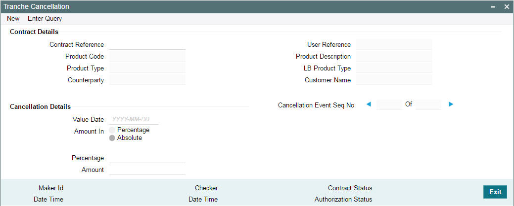

Cancellation
At the tranche level, you can define a rule for tranche cancellation processing also. This is similar to the drawdown expiry date processing discussed above. The only difference being that, while the later is triggered automatically on the drawdown expiry date, the cancellation processing has to be initiated manually.
The cancellation rule defaults from the product. You can override the default rule and choose a different rule at the tranche level. The options are:
For more details on the above rules, refer the heading ‘Specifying Additional Preferences for Loan Syndication’ in the ‘Defining Products for Loan Syndication’ chapter of this User Manual.
You have to use the ‘Tranche Cancellation’ screen to initiate the cancellation processing.
For more details on this screen, refer the heading ‘Cancelling a tranche’ in this chapter.

You can define reduction schedules in the ‘Schedules Details’ section of the screen. You can also define payment schedules for fee components, if attached to the tranche. The schedules defined for the tranche product will default here but you can modify the default values.
Select the Schedule Details and click 'Add Row' button and add the schedule details.
Schedule Type
You have to identity the schedule type being defined. For defining reduction schedules, select ‘C’. If you want to define payment schedules for fee components, select the option ‘P’.
Component
Select the component for which you are defining the schedule details. All the fee components associated with the contract are available in the option list provided. If you are defining reduction schedules, select the ‘PRINCIPAL’ component.
Note
For fee components of type ‘Advance’, the system does not allow you to define multiple schedules for the same fee component. However, you can define multiple instances if only bullet schedule exists for the component.
Start Date and End Date
This is the period for which selected fee component will be applied for the contract. This period should be within the tranche start date and end date. By default, the start date is equal to the tranche start date.
Frequency
This indicates the frequency/interval at which the schedules fall due. The available frequencies are:
Note
You can select the ‘Bullet’ frequency for defining reduction schedules.
Unit
Unit of frequency identifies the number of occurrences within a frequency . Unit ‘2’ and Frequency ‘Monthly’ means bimonthly frequency that is, the event occurs once in 2 months.
No
Based on the frequency and the unit of frequency you specify, the system displays the number of schedules for the period within the start date and end date. For instance, consider the following:
Then, the system displays the number as 9 since there are nine such schedules for the period.
Percent/Amount
You can specify a percentage or an amount for each payment/reduction schedule. If you specify the percentage, system computes equivalent amount and vice-versa. Based on this Oracle FLEXCUBE determines the available amount and then build the reduction schedule for the tranche.
Note
If you are not specifying the interest schedule details here, the system accepts the details maintained at the drawdown product level.
You can specify the amount due for each schedule for fee components of type ‘User Input’.
Specify the following details:
Collateral Settlement Mnemonic
Specify the collateral settlement mnemonic to the margin desk account. The adjoining option list displays all mnemonics that are maintained for the collateral settlement customer. You can select the appropriate one.
Collateral Online Mnemonic
Specify the collateral online mnemonic to the margin desk account. The adjoining option list displays all mnemonics that are maintained for the collateral online customer. You can select the appropriate one.
Based on the payment schedules captured for the components, Oracle FLEXCUBE computes the schedule and the amount payable for each schedule in the ‘ Schedule Details’ screen.
To view the details, click ‘Explode Schedules’ button from ‘Schedules’ tab.
You can select a due date to view the components and the amount settled on that date.
Similarly, based on the reduction schedule parameters captured, Oracle FLEXCUBE computes the reduction schedules. You can view the schedules in the ‘Tranche Reduction Schedules’ screen. Click ‘Commitment Reduction Schedules’ button from ‘Schedules’ tab.to view the details.
The following example explains a reduction schedule.
Example
Consider a tranche of USD 100,000.00 valid from 01-Jan-2004 to 31-Dec-2004. The schedule details for the same are given below:
Start Date |
End Date |
Number |
Frequency |
Unit |
Percentage |
31-Jan-04 |
31-Dec-04 |
11 |
Monthly |
1 |
8.5% |
31-Dec-04 |
31-Dec-04 |
1 |
Bullet |
1 |
6.5% |
Based on the above information, Oracle FLEXCUBE shows the below reduction schedule :

You can specify all details pertaining to the contract currencies (allowable currencies for the tranche) in the ‘Currency Details’ sub-screen. To invoke this screen, click ‘Currency’ tab in the ‘LB Tranche Contract Online’ screen.
The details include the following:
The details defined for the tranche product will default here. You can change the system defaulted details at the tranche level.
For a detailed explanation of the options available in this screen, refer the heading ‘Specifying Additional Preferences for Loan Syndication’ in the ‘Defining Products for Loan Syndication’ chapter of this User Manual.
You must specify the borrowers for the borrower tranche, who will actually be availing the drawdowns under the tranche. The borrowers defined for the borrower facility under which the tranche is being entered, will be defaulted to the tranche. You can view the borrower details in the ‘Borrower Details’ sub-screen. Click ‘Borrower’ tab to invoke the screen.
You cannot add a borrower at the tranche level. You may, however, remove a borrower from the tranche. You have to click ‘Delete Row’ button to do this. When you click on this button, the system displays a message to seek confirmation for the deletion.
The borrower details get defaulted along with the currency mnemonics and entities for each borrower.
For more details on the above details, refer the heading ‘Specifying borrowers for the facility’ in this chapter.
In addition, at the tranche level you can specify the following:
Nature of SSI
You can specify the nature of the SSI for each borrower. The available options are:
Note
The SSI selected for the borrowers get displayed in the settlement details screen for the tranche and all the drawdowns processed under it.

Just as at the facility level, at the tranche level too, you can view
for the borrower and currency combination. Select the borrower whose
SSI details you want to view from ‘Borrower Details’ screen
and click ‘Settlement Instructions’
button.
Click ‘Exit’ button to exit and return to the main screen.
You must also identify the participants who contribute to the amount being committed for disbursement under the borrower tranche contract, and specify the contribution details. The participants defined for the borrower facility contract under which the tranche is being entered, will default to the tranche, and you can change the participants, if required. You can capture the participant details in the ‘Participant Ratio Details’ screen.
Click ‘Participants’ tab in the ‘LB Tranche Contract Online’ screen.
In this screen, you can also view the various components (Interest, charge and fee) associated with the product if only if the ‘Participant Propagation Required’ option is selected for the component when associating the same with the product.
Note
You can only remove a participant from the tranche. Addition of a new participant can be done only at the facility level.
For more details on adding a participant to a facility, refer the heading ‘Adding a new participant’ in this chapter.
You can specify the following participant details:
Participant Name
Names of the participants involved in the tranche are displayed in the alphabetical order.
Note
If a participant name is too long, it is maintained in two different fields in the ‘Customer Information Maintenance’ screen. These two name fields will be concatenated while displaying in the above screen.
Refer the Core Entities user manual for more details on the ‘Customer Information Maintenance’ screen.
Participant Code
The IDs of all the participants selected for the borrower facility contract will be displayed here. To remove a participant from the tranche, select the same and then click the ‘Delete Row’ button. You can include the participants removed from the tranche through the ‘Participant Selection’ screen.
For more information on this screen, refer the heading ‘Selecting participants for the facility’ in this chapter.
Asset Amount/Asset Ratio
You have to specify the contribution of each participant to the tranche contract. You can specify the participant contributions either as an amount (Asset Amount) or a percentage (Asset Ratio). If specified as an amount, the sum of all contributions must not be greater than the tranche contract amount. If a percentage is specified, the sum of percentages for all participants must not exceed one hundred percent.
When you specify the asset amount, system will compute the equivalent ratio. Likewise, when you capture the asset ratio, its equivalent amount is also displayed. In addition, the income sharing ratio for interest, ad-hoc fee and charge components, if applicable, is displayed based on the asset amount/ratio. You can change the ratio for these components but the sum of percentages for all participants must not exceed one hundred percent.
Self Participant
Check this box to indicate that the participant is a Self Participant. A self participant is one who is leading the loan contract. This option is defaulted based on the self participant maintenance. You can check this option if it is maintained in the self participant maintenance. You can uncheck this option to proceed.
Originator
If you are entering a drawdown schedule, you can change this specification for a participant only if you have not checked the ‘Cascade Participants’ option for the tranche product used by the tranche contract.
Netting Preferences
You can specify netting preferences for tranche participants only if you check the ‘Net Across DD’ option (in the ‘CONTRACT’ tab of the ‘LS Tranche Contract Online’ screen). The available netting options are:
If you do not check the ‘Net Across DD’ option, the netting preference will be set to ‘NONE’ and you will not be allowed to change the same.
SSI Mnemonic
The SSI Mnemonic selected for the facility contract defaults for each participant of the tranche. However, you can change it at the tranche level. The option list displays the SSI Mnemonics maintained for the Counterparty, Module, Currency, Product and Branch combination involved in the tranche.
You also have the option to select component wise or currency wise SSI Mnemonics for each participant of the tranche. This is discussed below:
Currency wise Mnemonic details can be given in Pariticpant Ratio Details screen.
If the basis of SSI pick up is ‘Currency’, you can select the SSI Mnemonic for each allowable currency for each participant. Follow the steps given below:
You can link the L&D commitment contract (created by means of
Rapid updates) to Self participant and block the commitment booking as
part of tranche contract booking. To do this click ‘Linkages’
tab and the ‘Participant Commitment
Linkage’ section is displayed as follows:

Click ‘DD Product’ tab in the ‘LB Tranche Contract Online’ screen to specify the drawdown product details.
The details you can capture in this screen are discussed below:
To process drawdowns under the tranche, you have to select the drawdown product at the tranche level. The option list displays all drawdown products that you have associated with the facility product (under which the parent facility contract is processed) through the ‘Borrower Facility Product – Preferences’ screen.
When you select the product, the following details are displayed:
Interest Rate Rounding Rule
Select the interest rate rounding rule from the adjoining drop down list. Select one of them from the drop down list:
The rounding rules applied for the interest rate picked up automatically during Drawdown transactions are given below:
You have to associate an SSI Mnemonic for each participant and component combination. The system uses this information for component wise settlement of Income for each participant. The option list will display the following details about the SSIs:
Note
If you do not define the SSI Mnemonics, system will apply the default values and display an appropriate message to indicate the same.
Here you can specify the default interest schedules for each interest component of a drawdown product. The schedule maintained here gets defaulted to any new drawdown under the respective product.

SKIM refers to the additional interest that is paid or received between tranche participants. The payer, payee and SKIM rates have to captured for the tranche in the ‘Skim Details – Tranche’ screen. Click ‘Skim Details’ button to invoke this screen.
The Skim details to be captured in the screen above are discussed below:
You have to specify the following details in the ‘Skim Participants’ tab of the screen:
Payer Participant
You have to select the participant who makes the Skim payment. The participants associated with the tranche are available in the option list. You may select a participant from this list. When you select the participant, the name of the participant is also displayed.
Receiver Participant
Likewise, you have to select the participant who receives the Skim payment. The participants associated with the tranche are available in the option list. When you select the participant, the name of the receiver is also displayed.
Default Skim Rate
Here, you have to specify the rate applicable for calculating the Skim amount. This rate is applied on the participation amount contributed by the payer. Skim is paid or received as per the Interest schedule. The rate specified here is applied.
Click ‘Add Row’ button to select the next payer participant.
Note
For more details on maintaining Skim components, refer the heading ‘Maintaining Skim components for participants’ in the ‘Defining Products for Loan Syndication’ chapter of this User Manual.
You also have the option to specify the Skim rates separately for each DD product. This is done in the ‘Skim DD Product Linkages’ tab of the screen.
You have to indicate the following details here:
Product Code
The borrower DD products selected in the ‘DrawDown Products’ screen is available in the option list. Upon selection of the product, the following details are also displayed:
Linked/ Change Allowed
By default, the ‘Linked’ option is selected and you are not allowed to amend the ‘Default Skim Rate’ (as maintained in the ‘Skim Participants’ tab of the screen) for the drawdown products.
To facilitate rate amendment, you have to check the ‘Change Allowed’ option. When you check this option, the ‘Linked’ option is automatically unchecked and vice versa. You can then maintain product wise Skim rates for the tranche.
The Skim details captured at the tranche contract gets propagated to the drawdown contracts processed under it. However, you are allowed to amend the details at the drawdown level.
Click ‘Add Row’ button to select the next DD product from the list.
After making the required amendments, click ‘Ok’ to save the changes and return to the ‘LS Tranche Contract Online’ screen.

The margin components, if maintained for the interest components associated with the tranche product, will default to the ‘Margin’ tab of the ‘DrawDown Products’ screen. In the ‘Margin Maintenance’ screen you can define the Slab/Tier structures (for tranche utilization percentage) with different effective dates for margin types of ‘Tranche’ basis.
Click ‘Margin’ tab to invoke this screen. Margin of all drawdowns will be based on the percentage utilization of the tranche.
You have to specify the following details to maintain the Slab/Tier structure:
Contract Ref No
Select the contract reference number from the option list. The option list displays all the valid contract reference numbers.
Customer No
Select the borrower for whom the margin details have to be maintained. The option list displays the borrowers selected for the tranche. The margin details are applicable to drawdowns processed for the selected customer. You can also select the ‘ALL’ option to indicate that the margin details are applicable to all the borrowers of the tranche.
Component
The option list displays the margin types of ‘Tranche’ basis, if the same is applicable for the drawdown products selected for the tranche. When you select the component, the description and the component type are also displayed. You cannot amend these details.
Component Type
This field defaults based on you maintenance in the ‘Margin – Definition’ screen.
For more details on this screen, refer the section titled ‘Maintaining margin component details’ in the ‘Reference Information for Loan Syndication’ chapter of this User Manual.
Amount Type
You can define the Slab/Tier structure either in terms of amount or percentage of tranche utilization. Select the appropriate option.
Dept Code
Once the contract reference number is selected, the system displays the applicable department code.
Branch Code
Once the contract reference number is selected, the system displays the applicable branch code.
Treasury Source
Once the contract reference number is selected, the system displays the applicable treasury source.
CCY
Specify the currency details.
Currency Name
The system displays the name of the currency selected.
Effective Date
You must also specify an effective date on and beyond which the specified interest margin is valid in the system. For each effective date, you have to maintain the Slab/Tier structure in the ‘Margin Details’ section of the screen. Margin can also be maintained with an effective date in the past. If you amend the margin between the rate fixing date and the value date, the system will re-pick the margin at the time of drawdown initiation.
Capture the date in ‘DD-MMM-YYYY’ format.
From Amount/Percent
You can maintain different Slab/Tier structures for each effective date captured for the component. Depending on the ‘Amount Type’ you select, whether Amount or Percent, the system displays zero as the ‘From Amount’ or ‘From Percent’ for the first Slab/Tier. For subsequent slabs, the ‘To Amount’ or ‘To Percent’ of the previous slab is displayed.
To Amount/Percent
Capture the upper limit for the various Slabs/Tiers here. For type ‘Amount’, the maximum limit allowed is 999,999,999,999.99. The amount/percent specified here becomes the ‘From Amount/Percent’ for the next Slab/Tier.
Margin Rate
Specify the rate applicable for each Slab/Tier. The rate specified here is applicable on the tranche outstanding amount which varies based on the utilization of the tranche.
Use the navigation buttons - to move from one margin component to another.
For more details on negative rate processing, refer the title ‘Maintaining Loans Parameters Details’ in the chapter ‘Bank Parameters’ in Core Services User Manual.
If base rate is negative or borrower margin rate is negative then system does not allow user to maintain participant margin. If user has captured positive margin rate for borrower and participant then, the system does not allow user to amend the margin rate from positive to negative.
Click ‘Ok’ button to save the details and exit the screen.
You can capture margin rates for each participant of the tranche by
clicking the ‘Part populate’
button on the ‘Margin Maintenance’ screen. The system displays
the ‘Participant Margin Maintenance’ screen. Note that you
will be able to capture participant margin only if the box ‘Margin
for Lender’ is checked in the ‘Loan Parameters’ screen.
All details captured in the ‘Margin Maintenance’ screen are defaulted here.
For a given effective date and currency, you can view the margin maintained for the borrowers and participants.
To add a new participant, click the ‘List of Values’ button. The system displays all participants linked to the tranche. You can specify the margin rate applicable for the required participants from the required effective date.
Note that you can maintain margin rates for participants only for margin components of the main interest components of the Tranche’s Drawdown products.
Place your cursor on a participant and click the ‘Delete Row’ button to delete that participant.
The system ensures that the total margin rate of all the participants is the same as the borrower margin rate for the effective date for which margin rate is captured/ amended. It l also check the rates for each participant, margin component, currency, effective date and amount slab combination. You should have computed the required margin rates prior to capturing or amending the margin rate using this screen. If the validation for margin rates fails, the system displays an error message and will abort the transaction. You have to correct the margin rates and then proceed.

You can define the fee structure and the applicable rate at the tranche level in the ‘Fee Rule Maintenance’ screen. Click ‘Fee Rule’ tab to invoke this screen.
You have to capture the following details in this screen:
Counterparty
Select the borrower for whom the fee details have to be maintained. The option list displays the borrowers selected for the tranche. The fee details are applicable to drawdowns processed for the selected counterparty. You can also select the ‘ALL’ option to indicate that fee will be applicable to all the borrowers of the tranche.
Fee Rule
Associate a fee rule based on which the system computes the fee applicable on the tranche outstanding amount. The option list displays the fee rules associated with the borrower tranche product. Upon selection of the rule, the following details are displayed:
You cannot change the above parameters for the fee rule.
For information on the other fields in the screen, refer the heading ‘Maintaining Fee Rule details’ in the ‘Processing Charges and Fees’ chapter of this User Manual.
You can associate multiple fee rules with the tranche. To define the
next rule for the tranche, you have to click ‘Add Row’ button
in the ‘Contract Details’ section of the screen. You can
view the various fee components associated with a tranche by clicking
on the navigation buttons -

In the ‘Fee Components’ screen, you can define the start date and an end date for both utilization and non-utilization types of fee components. Click ‘Fee’ tab to access this screen.
The above details defaults from the tranche product used to process the tranche. You can modify the following details in this screen:
You can change the period for fee application provided the fee start date is not later than the maturity date of the tranche and the fee end date is not beyond the maturity date of the tranche.
Liquidation Mode
The liquidation mode specified in the ‘CONTRACT’ tab defaults here. Here, you can opt for a different mode for each component. The available options are:
For more details on ‘Events for Forward Processing’ screen refer the heading ‘Forward processing of events’ in this chapter.
Fee Basis
The fee basis defaults from the product level. However, you can change the default value anytime during the lifecycle of the contract. When you change the day basis, the system re-computes the schedule fee amount from the start date of the fee component. The amendment becomes applicable from the value date of the contract.
Note
Billing Notice Reqd
If the ‘Billing Notice Required’ option is selected for the tranche product (in the ‘Borrower Product – Fee Details’ screen), the same is applicable for the contract. Based on the number of days defined for billing notice generation for the product, system triggers the NOTC event for the fee component. However, you have the option to suppress the generation of billing notice for fee components. To suppress, choose the ‘NO’ option.
If the ‘Billing Notice Required’ option is not checked for the product, you cannot opt for the same at the contract level. Billing notice is not generated for such contracts.
Note
Oracle FLEXCUBE does not allow manual generation of billing notice.
Billing Notice Days
The billing notice days defaults from the product level. However, you can amend the default value.
For details on fee schedule amendment, refer the heading ‘Amending Fee Component Details’ in the ‘Processing Charges and Fees’ chapter of this User Manual.
After making the required changes, click ‘Ok’ button to save and exit the screen.

The tax details defaults from the facility contract if a tax rule
is associated with the participant product linked to the facility product.
‘Tax’ tab to invoke the screen.
At the tranche level, tax is applicable only on the fee component. This screen displays the tax rule details associated with the tranche product. You have the option to waive the subsequent tax to be applied for a participant and tax rule combination.
The system passes the entries for tax based on the event you specify in the ‘Product Tax Linkage’ screen. Typically, tax on fee is calculated upon liquidation of the fee (event ‘FLIQ’ will be associated with the rule) while tax on interest is computed on interest liquidation (event ‘LIQD).

Click ‘Overwrite Default SI’in the ‘LB Tranche Contract Online’ screen to invoke the following:
Specify the required details as given below:

To view the settlement instructions for the tranche borrowers, click the ‘Settlement Instructions’ button from ‘Borrowers Details’ screen.
If the ‘Chinese Characters in Payment’ box is selected in the ‘Loan syndication- Branch Parameters’ screen, then only you can enter the Chinese characters in the field 57, 59, and 70 for foreign currency and local currency settlement instructions / accounts and there are no validations in the system. You need to operationally control it.
You are allowed to enter the information in Chinese or English or a combination of both in this field. If it is a combination, then the system considers it as Chinese and allow up to 35 characters.
Note
This is applicable only for ASPAC region.
For more details about the ‘Settlement Message Details’ screen, refer the Settlements User Manual.
You can capture the schedule date and schedule amount for drawdown
repayments at tranche level in the ‘Tranche Repayment Schedules’
section. Click the ‘Tranche Repayment
Schedules’ tab to access this screen.
The tranche repayment schedule screen displays the all the schedules from the value date to the maturity date of the tranche. You can specify the following in this screen:
Start Date
Specify the start date for the tranche repayment schedule.
End Date
Specify the end date for the tranche repayment schedule.
Schedules
Specify the number of schedules applicable for each tranche repayment.
Frequency
Select the frequency for the tranche repayment schedule from the adjoining drop-down list. You can select one of the following values:
Unit
Specify the unit for the tranche prepayment schedule.
Amount prepayment Rule
Select the amount prepayment rule applicable for the tranche repayment from the adjoining drop-down list. You can select one of the following values:
Date
You have to specify the repayment date in ‘DD-MMM-YYYY’ format. The schedule date should not be later than the tranche maturity date.
Schedule Amount
Specify the repayment amount for each schedule. The sum of the schedule amount should be equal to the tranche amount.
Tranche Repayment Rule
Select the repayment rule for each schedule date. The possible options are LIFO, FIFO, and PRO-RATA.
Status
Indicates the status of the schedule. All the past schedules show the status as ‘Processed’ and all the future schedules show the status as ‘Unprocessed’. You can not modify ‘Processed’ schedules.
Drawdown Ref No.
Select the drawdown to be liquidated/partially rolled over, from the list of drawdowns maturing on the same date as the tranche repayment schedule date.
Note
Against a tranche schedule, you can select only those drawdowns maturing on the given tranche repayment schedule.
Allocation Amount
Specify the liquidation amount against each drawdown. The allocation amount for each drawdown can be greater than or equal to zero.
Sum
System displays a sum of all allocation amount provided.
Note
Redefinition of tranche repayment schedule happens as part of end of day process after the liquidation. Based on the repayment rule specified during the actual liquidation across drawdowns, the future schedules get adjusted against the respective schedule date.

You can capture the rules for the unscheduled drawdowns in the ‘Unscheduled Repayment Details’ screen. To invoke this screen, click the ‘Unscheduled Repayments’ button in ‘Tranche Repayment Schedules’ tab. This button is enabled only for non-revolving tranches.
In this screen, the following details of the drawdowns with maturity dates not matching with tranche repayment schedule dates get displayed:
You can also capture the following details related to the drawdowns:
Repayment Amount
Specify the liquidation amount for the drawdown.
Note
You can not specify an amount greater than the outstanding amount for that drawdown.

You can specify the MIS (Management Information System) details for
the tranche in the ‘ MIS ’ screen. To invoke this screen,
click the ‘MIS’ tab.

The advices associated with the product default to the contract. You can view the advice details in the ‘Advices’ screen. Click the ’Advice’ tab to invoke this screen.
For a contract, you can change the following advice details only:
Suppress All
Select this check box to indicate that the system can suppress all the messages.
Suppress
You can choose between ‘Yes’ and ‘No’. Risk E-mail events can be suppressed.
Priority
You can change the priority to any one of the following
After capturing the required details, you have to save the contract and have it authorized by your supervisor.

You can view the diary events defined for the contract in the ‘Diary Contracts – Summary’ screen. To invoke this screen, click ‘Diary’ tab.
This screen displays the various dairy events fired for the main facility contract as will as for the drawdowns processed under it. Dairy events include events like Contract Amendment (CAMT), Interest Rate Fixing (IRFG), and Exchange Rate Fixing (EXFG) etc.
For more details on the ‘Dairy Events Maintenance’ screen, refer the heading ‘Maintaining diary events’ in the ‘Reference Information for Loan Syndication’ chapter of this User Manual.

You can view messages generated for the contract using ‘Message
Preview’ screenTo view the messages click Events > Messages>Message Details button. The ‘Message
Preview’ is displayed.
Note
This button is enabled only if the latest event, with a payment message associated with it, is unauthorized.
Select the option:
Click the ‘Message Details’ button to view the messages generated, if any.
If messages are not available, the following message will be displayed:
No messages for preview

The ‘Participant Contract Summary’ screen will give you
a summary of the participant facility/tranche contracts created for the
borrower facility/tranche contracts. To view the details, click ‘Participant Summary’ button.
Additionally, you can also query the contracts using the fields available in the screen, individually or in combination with one another.
You can view the events triggered during the tranche life cycle in the ‘Event Log Details’ screen. To invoke this screen, click ‘Events’. The events defined for the tranche product are triggered for the contract
For more details on this screen, refer the heading ‘Viewing Events for the facility’ in this chapter.

You can view floor and ceiling details for base rate, margin and all-in-rate
in the ‘Floor and Ceiling’ screen. Click on ‘Floor and Ceiling’ to access
this screen.
However, you can amend this screen before first authorization.
For more details on capturing the floor and ceiling details, refer the heading ‘Maintaining Floor and Ceiling Details’ in this chapter.
You can capture the assignment validations for a tranche in the ‘Assignment Validation’ screen. Click ’Assignment’ tab to access this screen.
You can specify the following details in this screen:
Product Code
The system displays the product code.
Contract Ref No
The system displays the contract reference number.
Customer
The system displays the customer name.
Facility Name
The system displays the facility name.
Agent Consent Required
Select this check box if agent consent is required.
Affiliate Letters Accepted
Select this check box if affiliate letters are accepted.
Apply Transfer Amt Validations
Select this check box if transfer amount validation is required.
Min Transfer Amt
Specify the minimum transfer amount in tranche currency. During the participant transfer for the tranche, the system will check if the transfer amount is greater than the minimum transfer amount captured. If the transfer amount is less than the minimum transfer amount, then the system will display the following override message:
Transfer amount is less than the minimum transfer amount.
Note
If the transfer amount is zero or not captured, then the system will not check for any validations.
Min Amt after Transfer
Specify the minimum amount after transfer in tranche currency. The system will validate if the transfer balance after assignment for the assignment value date is greater than or equal to the Minimum amount after transfer. If the transfer balance is less than the minimum amount after transfer, then the system displays the following override message.
Transfer balance is less than the minimum retention amount.
If the transfer amount is zero, then the system does not check for any validations.
Transfer Amt in Multiples of
Specify the multiple of transfer amount in the tranche currency. During the participant transfer for the tranche, the system checks if the transfer amount is in the multiples of amount specified. If the transfer amount is not in the multiples of the amount captured, then the system displays the following override message:
Transfer amount is not in Multiple of <Multiple amount for Transfer>
Note
If the transfer amount is zero or not captured, then the system does not check for any validations.
The system waives the transfer amount validations based on the transferor or transferee type.
For Lender
Select this check box if the system waives the transfer amount for a Lender type.
For Affiliates
Select this check box if the system waives the transfer amount for an Affiliate type.
With Agent Consent
Select this check box if the system waives the transfer amount for an Agent Consent.
Note
This check box is enabled only if you have checked the ‘Agent Consent Required’ box.
With Borrower Consent
Select this check box if the system waives the transfer amount for a Borrower Consent.
During Complete Transfer
Select this check box to waive the complete transfer amount.
Validate Borrower Consent
Select this check box to validate the borrower consent.
Required For
Selecting ‘Validate Borrower Consent’ box, the ‘Required For’ options will be enabled.
Existing Investors
Select this check box to validate the borrower consent for existing investors.
New Investors
Select this check box to validate the borrower consent for new investors.
Existing Investors of Affiliate Type
Select this check box to validate the borrower consent for existing investors of Affiliate type.
Note
This check box is enabled only if you have checked ‘Affiliate Letters Accepted’ box.
All Assignments
Select this check box to validate the borrower consent for all the above parameters.
Note
If ‘Agent Consent Required’ box is checked, then the system will display the following override message for all assignments:
Agent Consent is required for Participant <Investor Number>
Validate Issuing Bank Consent
Select this check box to validate the issuing bank consent.
Note
All the participants defined in the ‘LC Issuer’ sub screen of ‘Tranche Online’ are considered as Issuing Bank.
Required For
Selecting ‘Validate Issuing Bank Consent’ box, the ‘Required For’ options will be enabled.
Existing Investors
Select this check box to validate the issuing bank consent for existing investors.
New Investors
Select this check box to validate the issuing bank consent for new investors.
Select this check box to validate the issuing bank consent for existing investors of Affiliate type.
Note
All Assignments
Select this check box to validate the issuing bank consent for all the above parameters.
Note
Validate Swing Line Bank Consent
Select this check box to validate the swing line bank consent.
Note
All the participants defined in the ‘Part Limit’ sub screen of ‘Tranche Online’ with Limit type as ‘Swing Line’ are considered as Swing Line bank.
Required For
Checking ‘Validate Swing Line Bank Consent’ box, the ‘Required For’ options will be enabled.
Existing Investors
Select this check box to validate the issuing swing line bank consent for existing investors.
New Investors
Select this check box to validate the issuing swing line bank consent for new investors.
Select this check box to validate the issuing swing line bank consent for existing investors of Affiliate type.
Note
All Assignments
Select this check box to validate the swing line bank consent for all the above parameters.
Note
Tranches with Min Trade Amt
Specify the tranches with minimum trade amount.
Tranches to be traded together
Specify the tranches that needs to be traded together.
Remarks
Specify the remarks, if any.
Issuing Bank
Select the issuing bank for new tranche booking or tranche amendment, from the adjoining option list. This list displays all allowed active authorized banks that are allowed at the tranche product level.
Swingline Lenders
Select the swingline lender for new tranche booking or tranche amendment, from the adjoining option list. This list displays all allowed active authorized customers that are allowed at the tranche product level.
Simultaneous Transfer Tranches
Select the simultaneous transfer tranches from the adjoining option list. This list displays all active authorized tranches.
Tranches Covered Under Lender Status
Select the tranches covered under the lender status from the adjoining option list. this list displays all active authorized tranches.
Issuing Bank Sublimit
Specify the issuing bank sublimit amount. For lead tranches, this amount should not be greater than the tranche amount. For non-lead tranches, this amount should not be greater than the tranche global amount.
Swingline Sublimit
Specify the swingline sublimit amount.
Special Cases
Specify the applicability of special cases for the tranche.
Section Number
Specify the section number.
Default Lender Language
Select the applicability of the default lender language from the adjoining drop-down list. This list displays the following values:
Borrower Consent Days
Specify the borrower consent days.
Assignment Fee
System displays the latest assignment fee for the facility/product in the tranche currency if it is maintained at the facility/deal level.
Requires Simultaneous Transfer of Deal
Select this check box to indicate that simultaneous transfer of the deal is required for the tranche.
Notify Borrower of Assignment
Select this check box to indicate that the borrower should be notified about the fee assignment,

You can maintain the collateral details for a tranche in the ‘LB Tranche Collateral Online’ screen. Click ‘Collaterals’ tab to access this screen.
For more information on maintaining collateral details for a tranche, refer the section ‘Maintaining Tranche Collateral Details’ in the chapter titled ‘Maintaining Collateral Details’ in this User Manual.
You can maintain the tranche account details for collateral in the
‘ Collateral Account ’ screen. Click ‘Collateral Account’
For more information on maintaining tranche account details for collateral, refer the section ‘Maintaining Tranche Collateral Account Details’ in the chapter titled ‘Maintaining Collateral Details’ in this User Manual.

You can maintain the collateral percentage details for the participants in the ‘Participant Collateral Detail’ screen. Click on ‘Collateral Participant’ to access this screen.
You can access this screen only during tranche booking.
For more information on maintaining collateral percentage details, refer the section ‘Maintaining Collateral Percentage Details’ in the chapter titled ‘Maintaining Collateral Details’ in this User Manual.

You can maintain the Agent CIF and Mnemonic details using the ‘Origination Agent CIF and Mnemonic Maintenance’ screen. Click the ‘Agent CIF’ in the ‘LB Tranche Contract Online’ screen to access this screen.
The following contract details are displayed from the contract screen here:
You can specify the following details:
Agent
Select the agent from the list of valid customer numbers provided. The name of the selected agent number gets displayed.
The currency belonged to the selected agent gets displayed and you can map the mnemonic against it.
SSI Mnemonic
Specify the mnemonic for the selected currency from the list of valid mnemonic provided.
Agent CIF or Mnemonic maintenance done as part of tranche amendment have no effect in any of the existing origination contract and is applicable only for the new origination booking through STP. Maintaining the appropriate Agent CIF depending on whether the tranche is a Lead or Non-Lead is completely have no validations.
You can add new currency and mnemonic for that currency and applicable only for new originations booking through STP. While copying the tranche contract, system does not copy the Agent CIF details from the previous contract. Maintaining the appropriate Agent CIF depending on whether the tranche is a Lead or Non-Lead is completely operationally controlled and the system does not perform any validations here.
If the Agency branch is different from the Self participant branch and if Agent CIF/Currency/Mnemonic maintenance is not available then the system will continue to book the origination contract without Agent CIF and mnemonic will be picked up by normal settlement pickup logic based on the settlement maintenance for the customer and the same can be amended at a later stage by doing the origination contract amendment.
You can cancel a tranche through the ‘Tranche Cancellation’ screen.
You can invoke the ‘Tranche Cancellation’ screen by typing ‘LBDCANCL’ in the field at the top right corner of the Application tool bar and clicking the adjoining arrow button.
The cancellation basis is defined at the tranche level. You can capture the ‘Cancellation Rule’ in the ‘SCHEDULE’ tab of the ‘LB Tranche Contract Online screen’. The valid rules are:
For more details refer the section titled ‘Specifying processing rules for the tranche’ in this chapter.
Note
To do a cancellation, select the tranche that needs to be cancelled and select New from the menu. Specify the following in the ‘Cancellation Details’ section of the screen:
Value Date
Specify the value date when the cancellation should be processed. The value date can be equal to the system date or a date in the past. However, if it is past dated, it should not be earlier than the latest drawdown’s value date or the last fee liquidation date of utilization/non-utilization fee.
Note
Oracle FLEXCUBE does not allow future dated cancellations.
Amount In
You have to capture the tranche amount to be cancelled. As mentioned, you can cancel a tranche fully or partially. You can capture the amount either as a percentage or an absolute. If you enter the percentage, system computes the equivalent amount and vice versa.
After capturing the required details in the ‘Tranche Cancellation’ screen, you have to save the same. The system displays a confirmation message upon successful save and also updates the ‘Cancellation Event Sequence No’ accordingly. This display the total cancellations processed for a contract. The event ‘CANC’ also be triggered when you save the cancellation details.
On cancellation of a tranche, the system performs the following activities online:

You can invoke the ‘Margin Maintenance’ screen by typing ‘FCDRCMNT’ in the field at the top right corner of the Application tool bar and clicking the adjoining arrow button.
To maintain/amend the details, select New from the menu. Then, select the following in this screen:
Contract Ref No
You have to select the tranche for which margin details have to be maintained or amended, as the case may be. The option list displays all the authorized tranches processed in the system. When you select the tranche, system displays the following:
Customer No
Select the customer for whom you want to maintain the margin details. The option list displays the names of the borrowers associated with the selected contract and also the ‘ALL’ option. If you want to apply the margin details to all the borrowers, select the ‘ALL’ option.
Component
Select the margin component for which you want to capture the details. All margin components associated with the selected contract will be available in the option list. When you select the component, system will default the ‘Component Type’, whether ‘Slab’ or ‘Tier’. This is based on your maintenance in the ‘Margin – Definition’ screen. You cannot change this parameter.
Amount Type
For details on the other fields required to capture a Slab/Tier structure, refer the heading titled ‘Maintaining Margin Slab/Tier structure’ in this chapter.

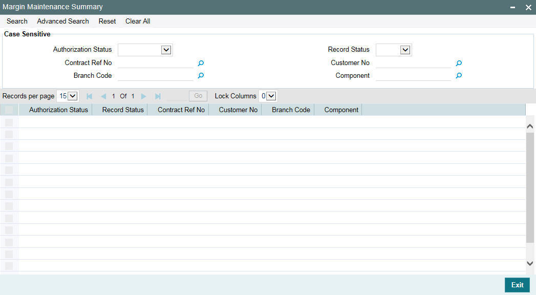

You can view the Margin Maintenance summary in the ‘Margin Maintenance Summary’ screen. You can invoke the ‘Margin Maintenance Summary’ screen by typing ‘FCSRCMNT’ in the field at the top right corner of the Application tool bar and clicking the adjoining arrow button.
Note

You can capture floor and ceiling details for base rate, margin and all-in rate. The floor and ceiling values can be maintained separately for each interest components associated with various Drawdown products mapped to the tranche for each drawdown currency. For Floor, the base rate should be more than the specified rate, and for Ceiling, the base rate should be less than the specified rate.
You can invoke the ‘Floor and Ceiling Maintenance’ screen by typing ‘LBDFLRCL’ in the field at the top right corner of the Application tool bar and clicking the adjoining arrow button.
Contract Ref No
The system displays contract reference number.
Product Code
Customer
Facility Name
CCY
Currency Name
Effective Date
Specify the effective date for each currency you select.
DD Product
The system displays the DD product details.
Interest Component
Specify the interest component details.
Floor
Specify the floor base rate.
Ceiling
Specify the ceiling base rate.
Margin Adj Comp
Select the margin adjustment component from the adjoining option list. You can select any drawdown basis margin component associated with the drawdown interest component.
You can maintain only one adjustment margin component for each tranche floor and ceiling maintenance for a combination of Tranche ref no, currency, effective date, drawdown product and Interest component. System validates whether the base rate of the associated drawdown is within the limit of floor and ceiling maintained for the base rate, otherwise the system adjusts the rate to the margin adjustment component accordingly.
Note
Floor
Specify the floor all-in rate.
Ceiling
Specify the ceiling all-in rate.
Margin Component
Specify the margin component.
Basis Amount Tag
The system displays the basis amount tag.
Margin Floor
Specify the floor margin.
Margin Ceiling
Specify the ceiling margin.

You can view or query the floor and ceiling adjustments on the drawdown contract by accessing the ‘Floor and Ceiling Adjustment Summary’ screen.
You can invoke the ‘Floor and Ceiling Adjustment Summary’ screen by typing ‘LBSFCADJ’ in the field at the top right corner of the Application tool bar and clicking the adjoining arrow button.
Note
This screen is applicable for floor and ceiling for base rate only.
You can view the following details for each record:
