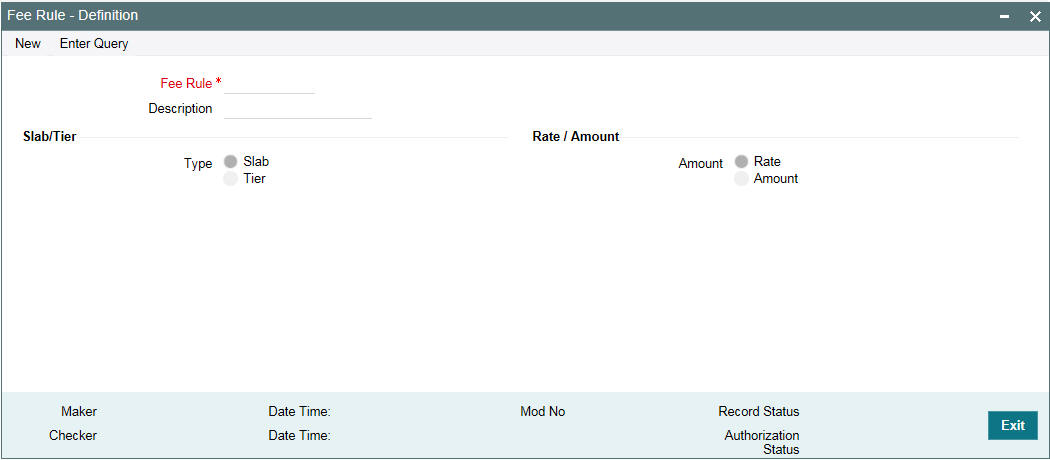

8.0.1 Defining a Fee Rule
You can define a fee rule though the ‘Fee Rule – Definition’ screen. You can attach the fee rule to a Fee Class or directly to a syndication product.
You can invoke the ‘Fee Rule - Definition’ screen by typing ‘LFDFEMNT’ in the field at the top right corner of the Application tool bar and clicking the adjoining arrow button.
Specify the following details in this screen:
Fee Rule
Every fee rule you define in Oracle FLEXCUBE must be identified by a unique code. Assign a unique code to the rule you are creating. You can define a code comprising of a maximum of nine alphanumeric characters.
Description
Briefly describe the rule you are creating to facilitate identification from a list of similar rules. The description can consist of a maximum of 30-alphanumeric characters.
Slab/Tier
When defining a fee rule, you can specify whether the rule should have a Slab or Tier structure. However, the actual Slab or Tier structure should be maintained in the ‘Fee Rule Maintenance’ screen.
Rate/Amount
You can indicate the basis on which the rule being defined to calculate the applicable fee for the fee component – as a percentage or amount. Accordingly, you can capture the fee rate or fee amount applicable for the various Slabs/Tiers defined for the rule in the ‘Fee Rule Maintenance’ screen.
For more details on this screen, refer the heading ‘Maintaining Fee Rule details’ in this chapter.

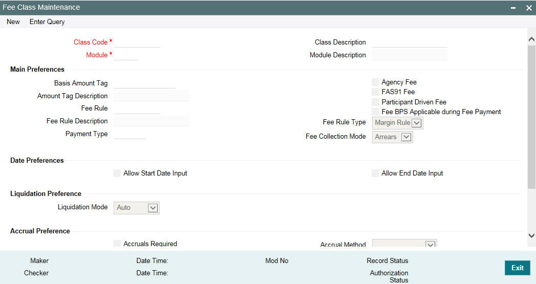

You can invoke the ‘Fee Class Maintenance’ screen by typing ‘LFDFEECL’ in the field at the top right corner of the Application tool bar and clicking the adjoining arrow button.
The details to be captured in this screen are explained below
Specify Basic Details of the Fee Class
The basic details include the following:
Class Code
When defining a fee class, identify it with a unique code. The code helps you identifying the fee class in the system. You can devise a code consisting of a maximum of 10-alphanumeric characters.
Description
Briefly describe the fee class you are creating to facilitate identification of the same. The description can consist of a maximum of 30-alphanumeric characters.
Module
You have to select the module for which the fee class details are being maintained. Choose LB to indicate that the details are specific to the Loans Syndication (LB) module.
When you select the module, the description associated with it is displayed alongside.
Specifying Class Preferences
In the ‘Main Preferences’ section of the screen, you have to specify the following:
Agency Fee
You may select this option to indicate that the fee income received on a contract is meant for the leading agent alone. It does not get propagated to the other participants of the syndication contract.
If you select this option, you are not allowed to select the ‘Participant Propagation Required’ option.
FAS91
Select this check box to perform FAS91 computations. System validates if:
Participant Driven Fee
If you select this check box, system allows you to define an individual fee amount for each participant.
Note
Basis Amount Tag
When defining a fee class, select the basis amount tag on which the fee amount should be calculated. The applicable amount tags are displayed in the option list provided. The description of the tag is displayed when you select the amount tag.
System computes a fee for issuing a letter of credit. This amount is paid only to the banks that have issued the LC. You can define a maximum of 10 such issuer fee components for 10 different issuers. You can associate each fee component with the corresponding basis amount tag.
The following table illustrates the amount tags used at the facility, tranche, and drawdown levels.
Basis Amount Tag
Facility
Tranche
Drawdown
Utilized
No
Yes
No
UNUTIL
No
Yes
No
DD count
No
Yes
No
User input
Yes
Yes
Yes
Principal
No
No
No
Principal-Outstanding
No
No
No
Tranche-Current-Limit
No
Yes
No
Tranche Outstanding
No
Yes
No
ISSUER1_LCOS
No
Yes
No
ISSUER2_LCOS
No
Yes
No
ISSUER3_LCOS
No
Yes
No
ISSUER4_LCOS
No
Yes
No
ISSUER5_LCOS
No
Yes
No
ISSUER6_LCOS
No
Yes
No
ISSUER7_LCOS
No
Yes
No
ISSUER8_LCOS
No
Yes
No
ISSUER9_LCOS
No
Yes
No
ISSUER10_LCOS
No
Yes
No
COMMERCIAL_LCOS
No
Yes
No
STANDBY_LCOS
No
Yes
No
COMPONENT_AMOT
Yes
Yes
No
COMPONENT_SPLT
Yes
Yes
No
TRANSFER_AVL
No
Yes
No
OUTSTANDING
No
Yes
No
AVAILABLE
No
Yes
No
Example
For an ‘Advance’ fee component, the following amount tags can be used:
Fee Rule Type
While defining a class, you can specify the rule type for the fee component. The available options are:
For calculating fee on contracts, you have to select ‘Margin Rule’ as the rule type.
Fee Rule
Select the applicable fee rule from the option list. The option list includes the rules that you have maintained through the ‘Fee Rule – Definition’ screen. When you select the rule, the description of the rule is also displayed.
Fee Collection Mode
Select the mode of collecting the fee. The available options are:
Note
Fee rate maintenance is done for ‘Advance’ and ‘Arrear’ fee components.

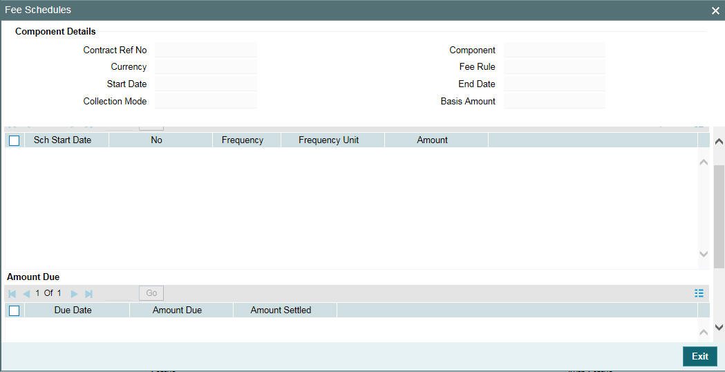

8.0.6 Entering Schedules for Fee Components
You can capture the fee schedules for a contract in the respective contract screen

For a borrower facility, you can specify schedules for fee components through the ‘Fee Schedules’ screen. To invoke this screen from the ‘Facility Contract Online’ screen, click the ‘Schedules’ button.
For details on this screen, refer the heading ‘Maintaining facility fee schedules’ in the ‘Loan Syndication Contracts’ chapter of this User Manual.
For a Tranche
For a borrower tranche, you can capture the fee schedules in the ‘Schedule Details’ section of the ‘Schedule’ tab of the ‘LB Tranche Contract Online’ screen.
Schedules are defined for fee components like ‘Advance’ and ‘Arrears’ for tranche using this screen’.

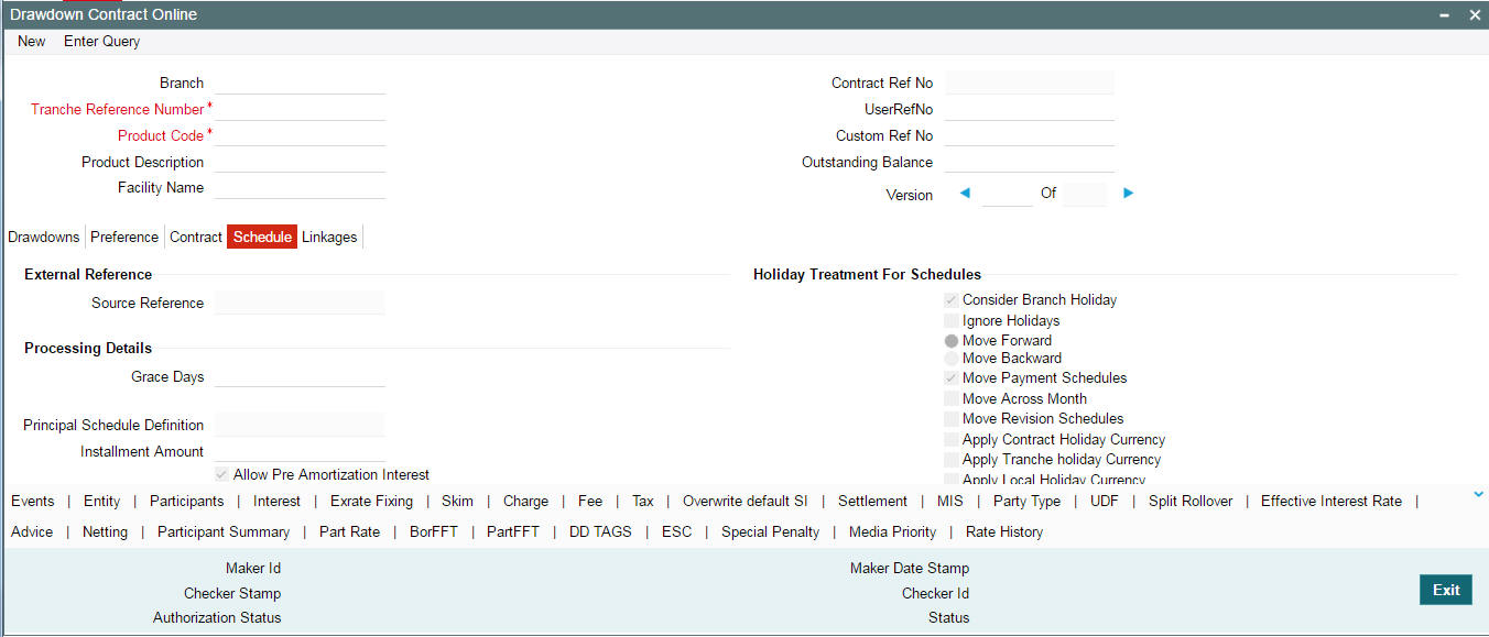

For a Drawdown
For a borrower drawdown, you can capture the fee schedules in the ‘Schedule Details’ section of the ‘SCHEDULE’ tab of the ‘Drawdown Contract Online’ screen.
For details on this, refer the heading titled ‘Specifying repayment schedule details’ in the ‘Loan Syndication Contracts’ chapter of this User Manual.

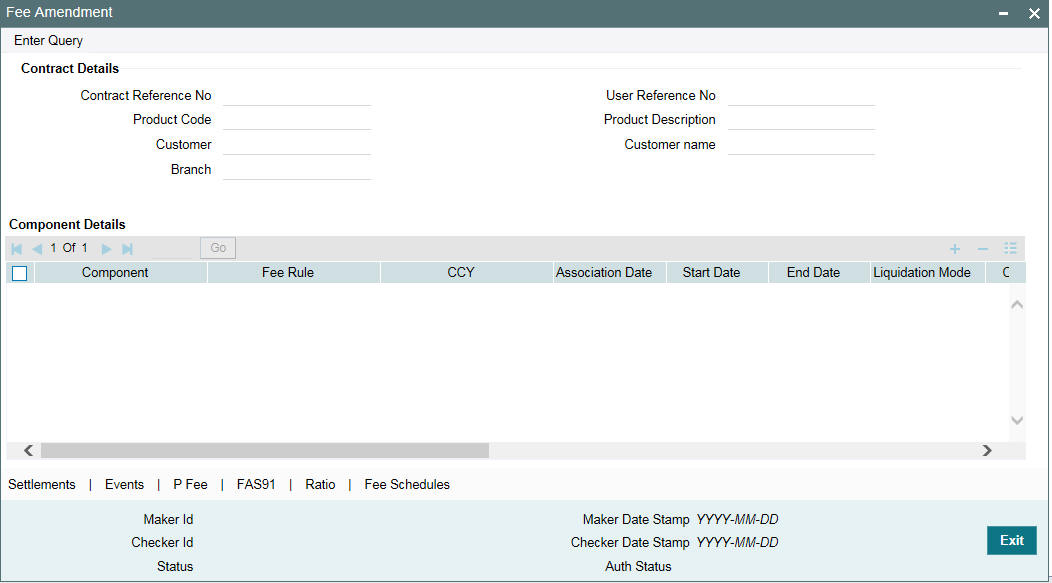

8.0.7 Amending fee Component Details
You may want to amend certain details of a fee component or reverse the fee of a component for a syndication contract (facility, tranche or drawdown). This can be done through the ‘Fee Amendment’ screen. For a fee component which has not been liquidated, is active and future dated, you can:
You can invoke the ‘Fee Amendment’ screen by typing ‘LBDFEAMD’ in the field at the top right corner of the Application tool bar and clicking the adjoining arrow button.
This screen displays the fee component details associated with the selected contract. The following details are displayed:
To make an amendment, you have to unlock the contract. To do this, click the ‘Unlock’ option from the menu.
Note
You can amend the fee for FAS91 fee components by clicking ‘FAS91’ in the ‘Fee Amendment’ screen. However, this is applicable only if the ‘Pass FAS91 Accounting Entry’ check box was not checked at the time of booking a contract.
For more details on FAS91 computation, refer the section ‘Computing FAS91 fee details’ in the Loan Syndication Contracts chapter.
In the Fee Amendment screen, you can also change the settlement account of the borrower by clicking the ‘Settlements’ tab.
To amend the fee schedules defined for a component, select the component and then click the ‘Fees Schedules’ button in the ‘Fee Amendment’ screen. The schedules maintained for the selected component is displayed in the ‘Fee Schedules’ screen.
The following details will default to the ‘Component Details’ section of the screen:
In the ‘Schedule Details’ section of the screen, you can amend the following for an ‘Active’ component:
In the ‘Amount Due’ section of the screen, the system displays the ‘Due Date’ and the ‘Amount Due’ for each schedule.
After making the required amendments, click the ‘ok’ button to save and exit the screen.
Similarly, select the next component and change the schedule details, if required.

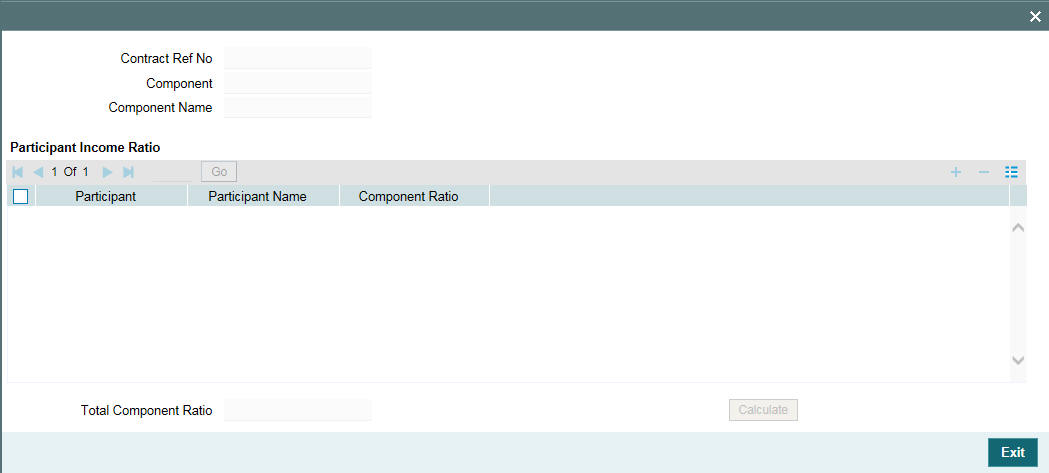

8.1.7.2 Viewing Participant Ratio Details
You can view the ratio in which a fee component is shared among the participants of the contract. To do this, select the fee component and then click the ‘Ratio’ tab .
The ‘Fee Component Sharing Ratio’ screen is displayed, as shown below:
In this screen, you can view the following:

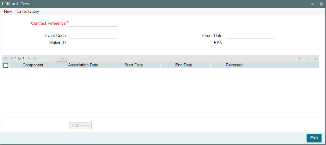

8.0.7.1 Reversing a Fee Component
You can reverse a fee component through the ‘Fee Reverse’ screen. To do a reversal, select the contract for which you want to reverse a fee component in the ‘Fee Amendment Reversal’ (LFDFCAUT)screen. Then, click the ‘Reverse’ from the menu.
The ‘Fee Amendment Reverse ’ screen is displayed.
The following details will be displayed in the ‘Component Details’ section of the screen:
Select the component you want to reverse and check the ‘Reverse’ option. Then, click the ‘Ok’ button. Oracle FLEXCUBE reverses all the liquidation entries posted for the component.
Note
You cannot reverse an ‘Active’ component. A component will move to the ‘Liquidated’ sta­tus only after all the schedules of the component are liquidated.

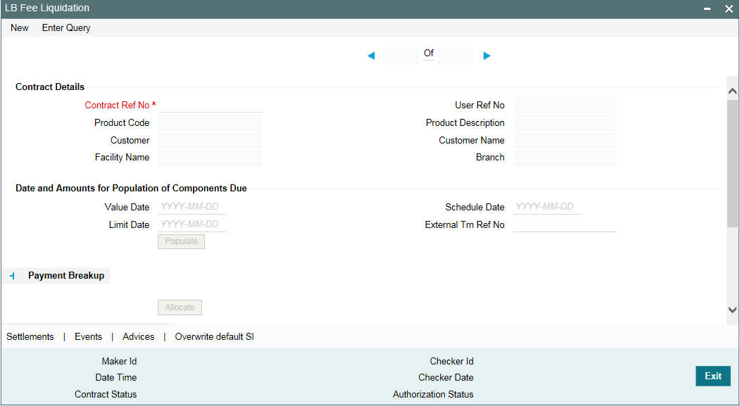

8.0.8 Liquidating Fee Components
You can manually liquidate the fee schedules defined for fee components in the ‘Fee Liquidation’ screen. You can liquidate even future dated schedules through this screen. You can invoke the ‘Fee Liquidation’ screen by typing ‘LBDFEELQ’ in the field at the top right corner of the Application tool bar and clicking the adjoining arrow button.
To liquidate a fee component schedule, do the following:
  1. Select the contract for manual liquidation
  2. Click on the new button - Click ‘New’ from the menu. The ‘Value Date’ and ‘Limit Date’ displays the current system date. The accounting entries for liquidation will be passed as of the value date.
  3. You can change the value date, if required. However, if you specify a back valued date, it cannot be earlier than the last schedule that was paid. The date you capture here is the date on which liquidation occurs.
  4. You can also change the limit date. This date indicates the date upto which you want to make the payment. This may include future schedules as well as unpaid past schedules. Again, a back valued limit date should not be earlier than the last liquidation date. Also, you can specify a limit date beyond the contract maturity date.
  5. After capturing the value date and the limit date, click the ‘Populate’ button. The system will display all the components which are due till the limit date (both unpaid past and future schedules till the limit date). The following details are displayed in the ‘Payment Breakup’ section of the screen:
  1. The ‘Payment Breakup For –‘section of the screen will display the component-wise schedule breakup. The following details are displayed here:
  2. Due Date of each schedule defined for the component (upto the limit date)
  3. Amount Due for each due date
  4. Pending Amount Due (= Amount Due)
  5. Select ‘Cash Prop’ box to indicate that the below component is for cash payment during fee liquidation:
  1. Commercial LC fee You can check the ‘Cash Prop’ flag only if the fee component which is getting liquidated is maintained in the static table. Otherwise the flag is not allowed to be selected.
  2. Capture the amount you want to pay for a component in the ‘Amount Paid’ field. This amount may be less than or equal to the ‘Amount Due’.
  3. After capturing the ‘Amount Paid’, click the ‘Allocate’ button. The system allocates the amount against each schedule and update the ‘Amount Paid’ against each schedule in the ‘Payment Breakup For – (Component Name)’ section of the screen.
  4. For fee components of ‘User Input’ type (Basis Amount Tag = User Input), you can capture the component-wise sharing ratio for each participant. Click the ‘Fee Ratio’ button to do this. The system will display the names of the participants in the ‘Participant Ratio’ details screen.
  5. Specify the ‘Component Ratio’ for each participant. The sum of the sharing ratio for each component should be equal to 100%. The system computes the amount for each participant based on the ratio mentioned and also display the total amount shared amongst the participants.
  6. In the case of system calculated fee components (Util Fee and Un-util Fee etc), you can only view the component sharing ratio. You cannot amend the same.
  7. Specify the ‘Fee BPS Rate’.
  8. Specify ‘Remarks’ about the Fee BPS Rate, if any.
  9. Click ‘Populate’ to default Fee BPS Rate for participants.
  10. Check the ‘Fee BPS Rate Applicable’ check box for the respective participant.
NoteClick the ‘Save’ from the menu.
You can perform selective liquidation of the fee components as the payment happens, if required. For this, you need to specify the amount in the Amount Paid field for the fee component which needs to be liquidated. The System liquidates only those components for which Amount Paid value is the same as Amount Due. You cannot perform partial payments here.
For those components which are not part of the current fee liquidation, you need to specify the Amount Paid as zero.

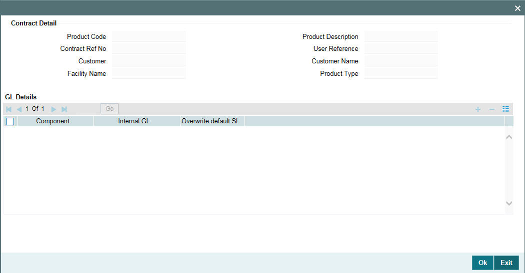

8.0.9 Viewing Overwrite Settlement Instruction Details
You can maintain settlement instructions for various components such as fees, charges, tax, principal, interest, and so on, using the ‘Overwrite Settlement Instruction Details’ screen. Using this screen, you can post liquidation entries into an Internal GL account instead of the customer account at the time of rollover. Click ‘Overwrite SI’ in the Fee Liquidation screen to invoke the following:
Enter the details specified below:
Component
This screen displays all the components displayed in the Settlement Message Details screen.
Internal GL
Specify the Internal GL accounts into which you want to post the liquidation entries for the components.
Overwrite default settlement instruction
Check the ‘Overwrite default settlement instruction’ box to confirm that the liquidation entries should be posted into the Internal GL account. System will post the entries to the Internal GLs only if you check this box. Otherwise, system will post the entries as per the settlement instructions specified for the component of the contract.

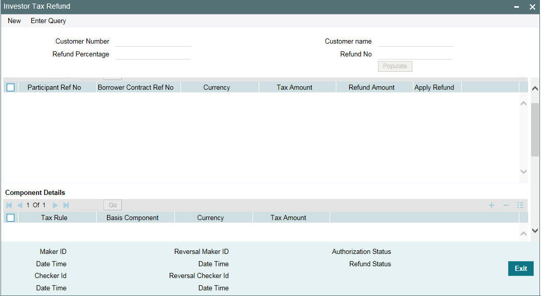

8.0.10 Refunding Tax for Interest and Fees
In the product tax linkage of Tranche and Facility maintenance, you can add tax components for various Fee components. And the contract level, you can either withheld or waive of the tax for these components. You can maintain tax rate for a combination of individual tax component and a investor or for the combination of individual tax component which is common for all investors.
Oracle FLEXCUBE enables you to refund tax for a specific investor for all contracts or specific contract using ‘Investor Tax Refund’ screen. You can invoke the ‘Investor Tax Refund’ screen by typing ‘LBDTXRFC’ in the field at the top right corner of the Application tool bar and clicking the adjoining arrow button.
You can specify the following details here:
Customer No
Select the customer for whom you want to refund the tax from the investor list provided.
The name of the customer gets displayed in the adjacent field. The investor refund generates a unique refund number for the investor.
Note
Tax refund can be processed only for those contracts for which the ‘Tax Remittance’ is yet to be processed.
Refund Percentage
Specify the percentage of tax refund for the withheld Tax Amount. This percentage gets applied on the tax amount eligible for refund and displays the refundable amount from all the contracts of the investor.
Apply Refund
Select this check box to specify tax refund for the displayed contract of the investor.
Note
You cannot amend the refund amount, component and the tax schedules.
8.1.11.1 Reversal of Investor Tax Refund
You can do the reversal of refund against each refund number. To query a specific refund record of an investor you have to provide the customer number and refund number. The two events which are triggered for Investor Tax Refund and Investor Tax Refund Reversal are:
