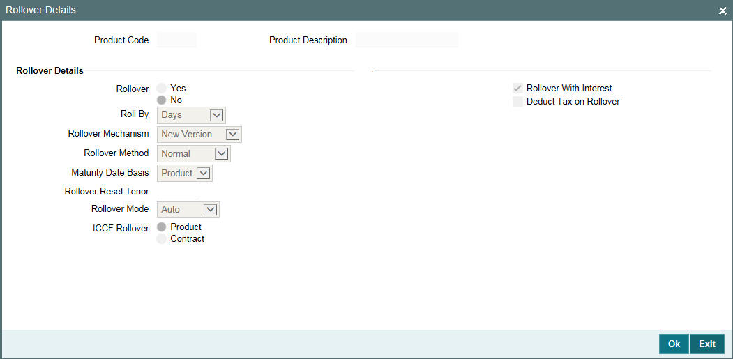

The rollover details for the borrower drawdown product that you are
defining can be specified in the ‘Rollover Details’ screen.
To invoke this screen, you have to click ‘Rollover
Details’ button in the ‘Borrower Product Preferences’
screen.

You can capture the following details in this screen:
Rollover Mechanism
When defining rollover mechanism for a loans syndication product, the default rollover mechanism will be ‘Spawn Contract’ and you cannot change this specification. This creates a new drawdown on rollover.
Rollover Method
You have to indicate the method that you want to employ to rollover the drawdown. You can choose from the following methods:

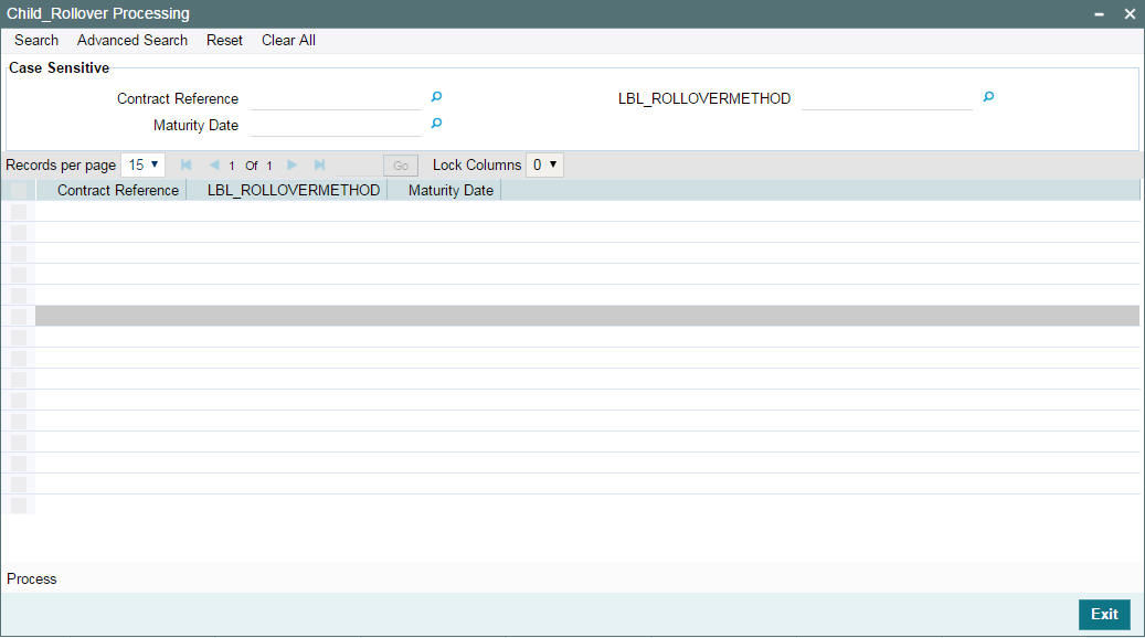

After the system rolls over the drawdown on the maturity date of the original drawdown, a new drawdown is created in the system. After the successful creation of the new drawdown, the system displays the reference number of the rolled over drawdown in the ‘Rollover Contract Reference No’ field (in the ‘ROLLOVER’ tab) of the original drawdown.
In case of any failure in the system while generating the rollover drawdowns due to exceptions like excess utilization of the borrower and participant limit, system logs an exception and stop the rollover processing. In this case, you have to capture the child drawdowns manually after adjusting the limits.
You can view the errors message details in the ’ROLLOVER ERROR’ screen. Click “View Error’ button to invoke this screen.
The following details are displayed in this screen:

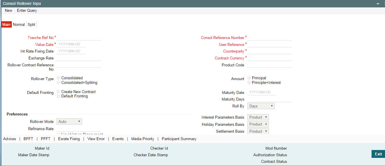

You can capture instructions for a split rollover in the ‘Split Rollover Details’ screen (LBCSPROL) . Click ‘Spilt Roll’ in the ‘Drawdown Contract Online’ screen to invoke this screen.
Note
This section explains only those features that are specific to split rollover. The preference applicable for ‘Normal’ rollover will be applicable for ‘Split’ rollover as well.
When you indicate the rollover method as ‘Split’, the system creates multiple drawdowns out of the original drawdown. For each rolled over contract, the system generates a split number. After specifying the details for the first split drawdown, click ‘Add Row’ button to specify details for the next drawdown.
The defaulted value for the Netting Option will be No Netting.

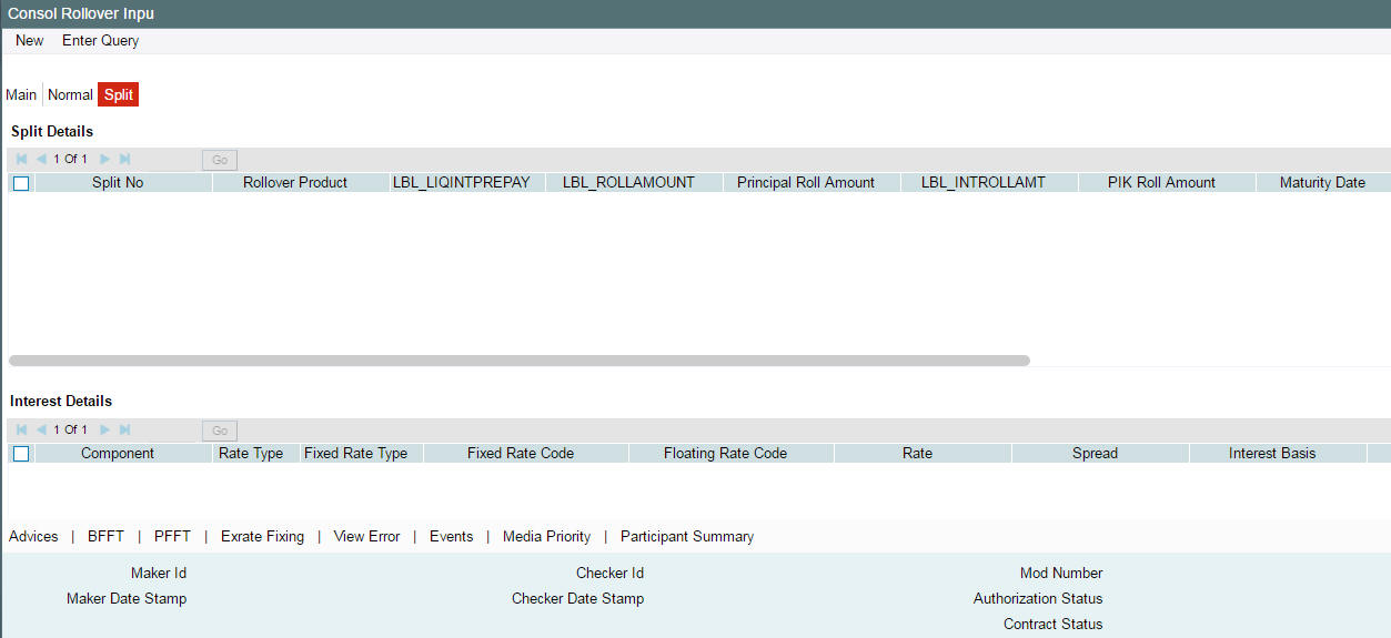

You have to specify the following split in the ‘Split Details’ section of the screen:
Amount
You have to specify the amount that can be rolled over to create each of the multiple drawdowns as part of the rollover split. This amount depends on the ‘Rollover Amount Type’ you select. The rollover amount type can be any one of the following:
Note
In the case of split renewals, the system apportions the interest amount against each split contract in the same ratio as the principal split break up.
PIK Roll amount gets updated if the PIK Rollover with capitalization is checked for parent contract.

You can capture instructions for a consolidation rollover in the ‘Consolidation Rollover’ screen. You can also define split instructions as part of capturing normal consolidation instructions. You can invoke the ‘Consolidation Rollover’ screen by typing ‘LBDCOROL’ in the field at the top right corner of the Application tool bar and clicking the adjoining arrow button.
Note
This section explains only those features that are specific to consolidation rollover.
To specify consolidation details for a new drawdown, select New from the menu.
Rollover Netting allows you to capture the netting option for Consol Rollover. The available options are:
Note
The consolidation details to be captured in this screen are explained below:

Value Date
Another parameter for selecting the drawdowns for consolidation is the value date. In effect, this date refers to the maturity date of the child drawdowns that have to be consolidated as part of rollover. In addition to the same combination of counterparty, product, and currency, the child drawdowns should also have the same maturity date for consolidation to occur.
Rollover Type
You have to indicate the type of rollover you wish to perform. The available options are:
Default Fronting
Indicate if the fronting detail has to be defaulted for the increase in amount during rollover / reprice. You can select one of the following options:
In consolidation rollover, if ‘Create New Contract’ option is selected, then the system will internally treat it as consol + split and do the rollover processing.
After selecting the combination of counterparty, product, currency and value date for drawdown selection, you have to capture the following in the ‘Consol Details’ section of the screen:

You can define split instructions for a consolidation rollover only if you select the ‘Rollover Type’ as ‘Consolidation + Split’. You can specify the split instructions in the ‘Split’ tab of the ‘Consolidation Rollover’ screen.
For more details on this screen, refer the section titled ‘Specifying details for ‘Split’ rollover’ in this chapter.
If you capture split instructions as part of consolidation rollover, the system first consolidates the selected child drawdowns and then splits the same as per the split instructions you define. The system further ensures that the sum of the split is equal to the consolidated amount.

In the case of future dated rollovers, ORACLE FLEXCUBE allows you to create the rollover child contracts in advance i.e. before the rollover date. You can use the ‘Rollover Child Processing’ (LBSPAROL)screen to generate the child contracts.
In this screen, the system displays all future dated rollover contracts for which child contracts are yet to be created. You can select the contracts for which you wish to create the child contracts in advance. Check the box against each record to select a contract.
Click ‘Ok’ to generate the child contracts for the selected parent contracts.
