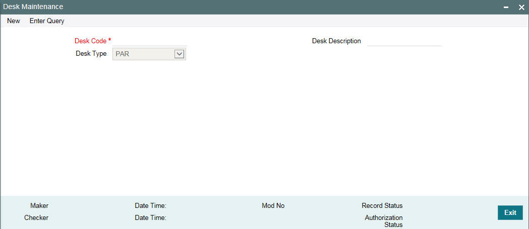

11.2 Maintaining Desk Codes
You can maintain different types of desks (loan desk, credit desk, and so on) used in your bank in the ‘Desk Code Maintenance’ screen. You can invoke the ‘Desk Maintenance’ summary screen by typing ‘LBDDKMNT’ in the field at the top right corner of the Application tool bar and clicking the adjoining arrow button.
For each desk type, you can capture the following information:
Desk Code
Specify a unique code to identify the desk in the system. You can use a maximum of 12 alphanumeric characters to define a code. You also have to capture a brief description of the desk in the adjacent box. The description can comprise of a maximum of 30-alphanumeric characters. Both, the code and description are mandatory information.
Desk Type
You can select the type of desk being maintained. The available options are:
Note
For STP, you have to specify the desk type as ‘Origination’.
In order to process transfer of portfolio from HFI to HFS, you need to maintain a desk of the type ‘ORIGINATION-HFS.’

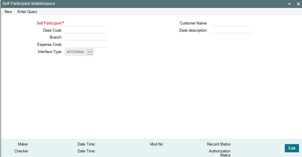

11.3 Identifying Self Participant
To identify bank participation in a syndicated loan, you have to define it as a self participant. Prior to this, you have to maintain the entity as a customer in Oracle FLEXCUBE (in the ‘Customer Information Maintenance’ screen).
For details on ‘Customer Information Maintenance’ screen, refer the ‘Maintaining Customer Information File’ chapter of the Core Entities (CE) User Manual.
After defining the entity as a customer in Oracle FLEXCUBE, you identify it as a self participant in the ‘Self Participant Maintenance’ screen.You can invoke the ‘Self Participant Maintenance’ summary screen by typing ‘LPDSPMNT’ in the field at the top right corner of the Application tool bar and clicking the adjoining arrow button.
You have to capture the following details in this screen:
Self Participant
Select the code of the self participant from the option list available. The codes of all valid customers (maintained in the ‘Customer Information Maintenance’ screen) are available in this list. Upon selection of the code, the participant’s name is also displayed in the adjacent box.
Branch
Select the branch, applicable for the self participant, from the option list available. All valid branch codes maintained in Oracle FLEXCUBE are available in the option list provided. The branch selected here is designated as the transaction branch for the participant that is, the system creates the corresponding commitment/loan contract in this branch.
Desk Code
Select the desk code applicable for the self participant. The option list displays the desk codes maintained through the ‘Desk Code Maintenance’ screen. Upon selection of the code, the associated description is also displayed in the adjacent box.
Expense Code
Select the expense code applicable for the self participant. The option list displays the expense codes maintained through the ‘MIS Cost Codes’ screen. The system tracks the expenses pertaining to the self participant against the expense code you select here. It also uses this code in the MIS reports generated for the participant.
For details on maintaining cost codes, refer the MIS User Manual.
Note
All the fields are mandatory to save the record.
You can view the mapping between the self participant, branch code, desk code, and expense code in the ‘Participant Ratio Details’ sub-screen of the following screens:

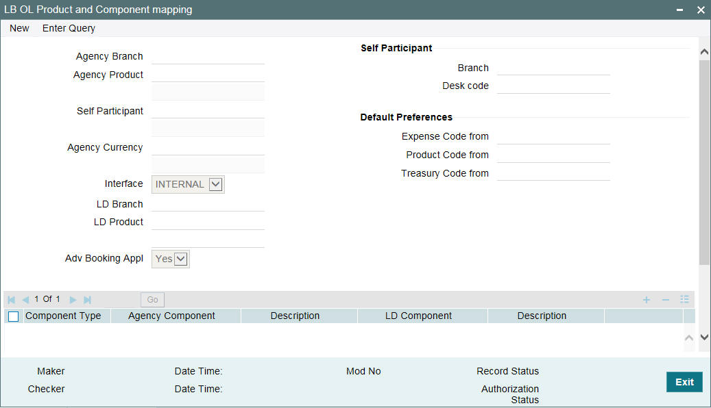

11.4 Mapping LB and OL Products and Components
In order to facilitate the creation of the corresponding commitment/loan contract for a tranche/drawdown, you have to map the LB products and their components to the relevant OL products. You can do this mapping in the ‘LB OL Product and Component Mapping’ screen. You can invoke the ‘LB OL Product and Component mapping’ summary screen by typing ‘LBDPCMAP’ in the field at the top right corner of the Application tool bar and clicking the adjoining arrow button.
You have to specify the following details as part of product and component mapping:
Agency Branch
Select the transaction branch for initiating the LS contract on the agency side. All valid branch codes are displayed in the option list provided.
Agency Product
Select the LS product to be used for creating the LS contract. All valid drawdown products defined in the system are displayed in the option list provided. When you select the DD product, the system displays the description of the product in the adjacent box.
Self Participant
Select the self participant for the combination of agency branch and agency product selected in the previous fields. All self participants maintained in the ‘Self Participant Maintenance’ screen are displayed in the option list. Upon selection of the code, the system displays the name in the adjacent box.
In addition, the system also displays the branch code and desk code associated with the selected self participant (as per your mapping in the ‘Self Participant Maintenance’ screen).
Note
If you select the self participant as ‘ALL’, the system displays ‘ALL’ in the Branch Code and Desk Code fields also (in the ‘Self Participant details’ section of the screen).
Default Preferences
In case of STP, you can choose the appropriate expense code for the commitment created from RAPID before it is being mapped to a Position Identifier while creating a new Tranche. The system does not perform any validations in this regard.
Expense Code From
For loans that are booked through STP, the system defaults the expense code from the commitment. But for the FCY loans you can choose to default the expense code from the following options:
Product Code From
For loans that are booked through STP, the system defaults the product code from the commitment. But for the FCY loans you can choose to default the product code from the following options:
The system does not perform any cross validations to enforce the same expense code for the SLT and Origination contracts for the given CUSIP and position Identifier combinations.
Interface
Select the type of interface for STP from LB to OL. The available options are:
OL Branch
If the interface type is ‘Internal’, the system displays the branch code of the selected self participant (as per your mapping in the ‘Self Participant Maintenance’ screen).
For an ‘External’ type of Interface, you have to key-in the branch code.
OL Product
Similarly, for an ‘Internal’ type of interface, you can select the applicable loan product from the available option list. The system displays all loan products applicable for creating agency contracts on the originations side (in the ‘Loans – Product Preferences’ screen, the ‘Agency Contract’ box is checked for such products). Upon selection of the product, the system also displays the associated description in the adjacent box.
For an ‘External’ type of Interface, you have to key-in both the product code and the description for the same.
Adv Booking Appl
Select ‘YES’ to if you wish to process the corresponding commitment/loan contract in advance for future dated drawdowns. The default value is ‘YES’. However, you can change it. If you select ‘No’, the system creates the commitment/loan contract only after the INIT (Initiation) event is triggered for the corresponding drawdown.
When you tab out of this field, the system takes you to the component mapping section of the screen. To modify the fields explained above, click ‘Up arrow’ icon. You can then select the value you want to amend.
New check box
Select this check box to indicate if you wish to copy all the details for LB OL Product and Component mapping with only the self-participant being different.
Note
11.4.1 Mapping Product Components
You can map the components of the selected LB and OL products in the component section of the screen.
As part of mapping, you have to specify the following:
Component Type
Select the type of component for the mapping. The available options are:
Agency Component
The components associated with the selected ‘Agency Product’ are displayed in the option list. When you select the code of the component, the system also displays the associated description in the adjacent field.
OL Component
Likewise, the system displays the components associated with the selected ‘OL Product’ in the option list provided. When you select the code of the component, the system also displays the associated description in the adjacent field.
For an ‘External’ type of interface, you have to key-in both the component code and the description for the same.

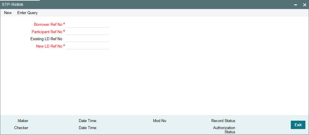

11.5 Mapping LB OL Contract Details
You can manually map LB to OL contract details while booking the tranche level contract by clicking the COMM link button at the tranche level. Once tranche contract is authorized, linking commitment contracts to the tranche is done by using the STP - Relink screen.
You can invoke the ‘STP-Relink’ screen by typing ‘OLDRLINK’ in the field at the top right corner of the Application tool bar and clicking the adjoining arrow button.
Specify the following details:
Borrower Ref No
Specify the borrower reference number. The adjoining option list displays all the borrower reference numbers maintained in the system.
Participant Ref No
Specify the participant reference number. The adjoining option list displays all the participant reference numbers maintained in the system.
Existing OL Ref No
Specify the existing OL reference number here.
New OL Ref No
Specify the new OL reference number here.
If RAPID Enabled is ‘Y’, then commitment contract is not automatically created. It has to be mapped to OL using the ‘STP Relink’ screen.
Validate value date availability
Select this check box to validate the value date availability.
You are allowed to check or uncheck the flag with the following conditions:
When this flag is checked, position validation will be performed for the linked commitment contract’s available amount with the latest Transfer AVL balance as of the value date (PRAM value date when the participant is added to the tranche) of the Participant contract.
After STP is successfully processed for the commitment linkage, for all the underlying drawdown contracts linked with the commitment in STP interface browser, processing status for the failed events are updated as Handoff automatically(after necessary validation and also if the status is failed). Once the status is updated as ‘Handoff’, the STP of all events of the underlying Drawdown contracts will be automatically processed by the existing STP job.
If the status is ‘Enrich’ for the associated Drawdown events, then the system processes the records once the status is marked as Handoff if the following conditions taken place:

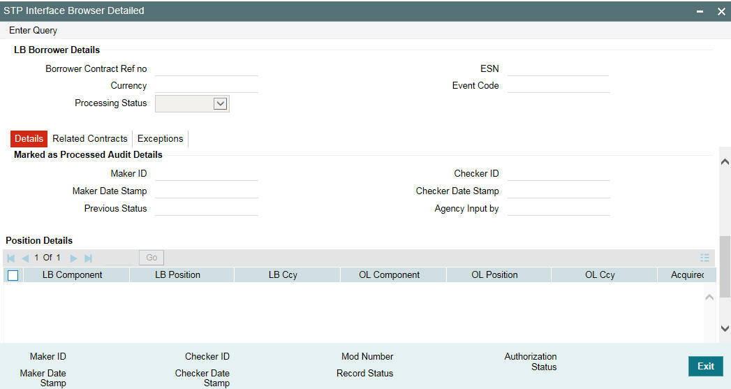

You can view the records in the ‘Straight Through Processing Interface Browser’ available in the Application Browser. You can invoke the ‘STP Interface Browser Detailed’ screen by typing ‘LBDSTPIB’ in the field at the top right corner of the Application tool bar and clicking the adjoining arrow button.
You can view the ‘Processing Status’ and other associated details of the record in the above browser. The following statuses are applicable for the records:
Note
If the interface type is ‘External’, you have to unlock the record, key-in the commitment/loan details and then save and authorize the record.
Note
While processing the specific event, the negative base rate or margin rate is considered during interest calculation on loan contracts if base rate or margin rate is in negative at the drawdown level.
You can unlock a record by clicking a specific record. And you cannot navigate to other records until the record is saved.
You can also authorize the record by clicking specific record. And manually mark the process status as ‘Processed’, if the process status of the record is in ‘Enrich’. The system does not validate the position during the transaction.

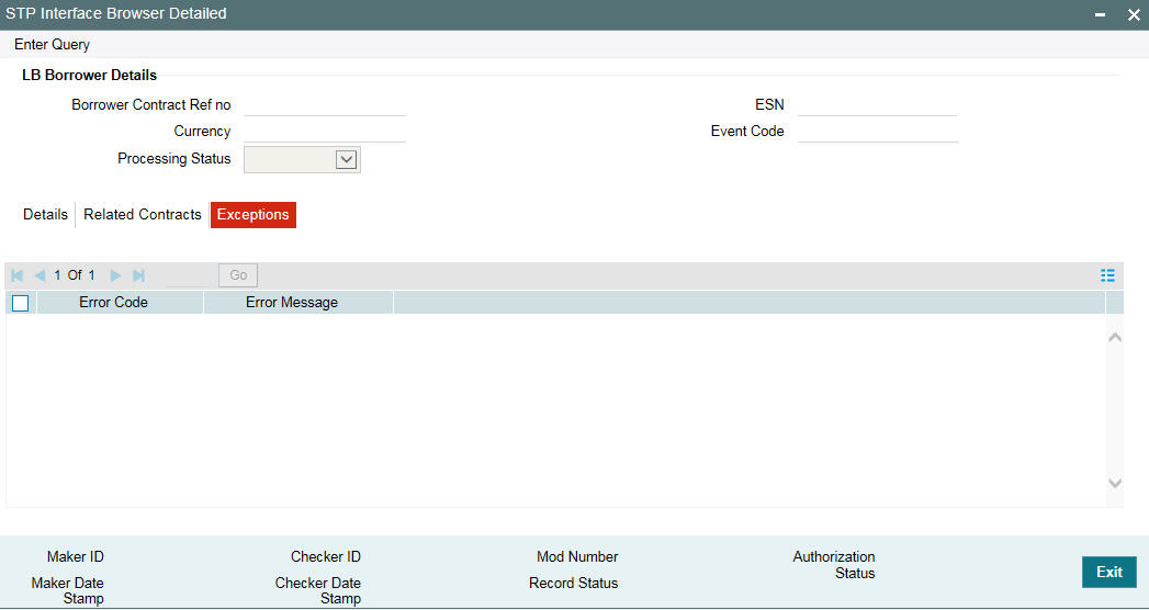

11.7.2 Viewing and Reprocessing Failed Records
The straight through processing may fail due to the following reasons:
If the processing fails, the record moves to the ‘Failed’ status. You can view the reason of failure in the ‘Exception Log’ screen. Click ‘Exceptions’ tab in the ‘STP Interface Browser Detailed’ to view the exceptions.

If the HFS participant is new to the tranche, then you have to manually link the HFS commitment with the HFS participant using the ‘STP Relink’ screen. Upon authorization of re-link, the processing status is updated as ‘Processed’ for the HFS participant.
You l have to manually mark the processing status as ‘Processed’ for the HFI Participant. Balance for the HFI commitment in origination module is reduced based on the updated file sent from RAPID,
If the PRAM is reversed and rebooked then both the reversed and rebooked PRAMs are in ‘Failed’ status in the STP browser for both the participants. You have to manually mark the process status as ‘Processed.’

11.13.0.1 STP support for Amortization contracts
STP is supported only for Amortization contracts having Principal and Main Interest component amount as part of Amortization constant along with servicer fee.
However, for products with Escrow components as additional amortization constant components, in LB-OL Product and component mapping, Agency Amortization type of Product should be mapped to OL ‘Normal Bearing’ type of Product. This needs to be done as Escrow components are not propagated to participants in agency and hence not be handed off to Origination.
Mapping is done for below components:
Main Interest component – This supports the STP of the agency contract that has both pre-Amortization Interest schedule and Amortization schedule
LB-OL STP Product and Component mapping maintenance should be done for the same kind of LB and OL ‘Amort’ products matching the attributes like ‘Allow userinput installment’, ‘Allow re-amortization’.
