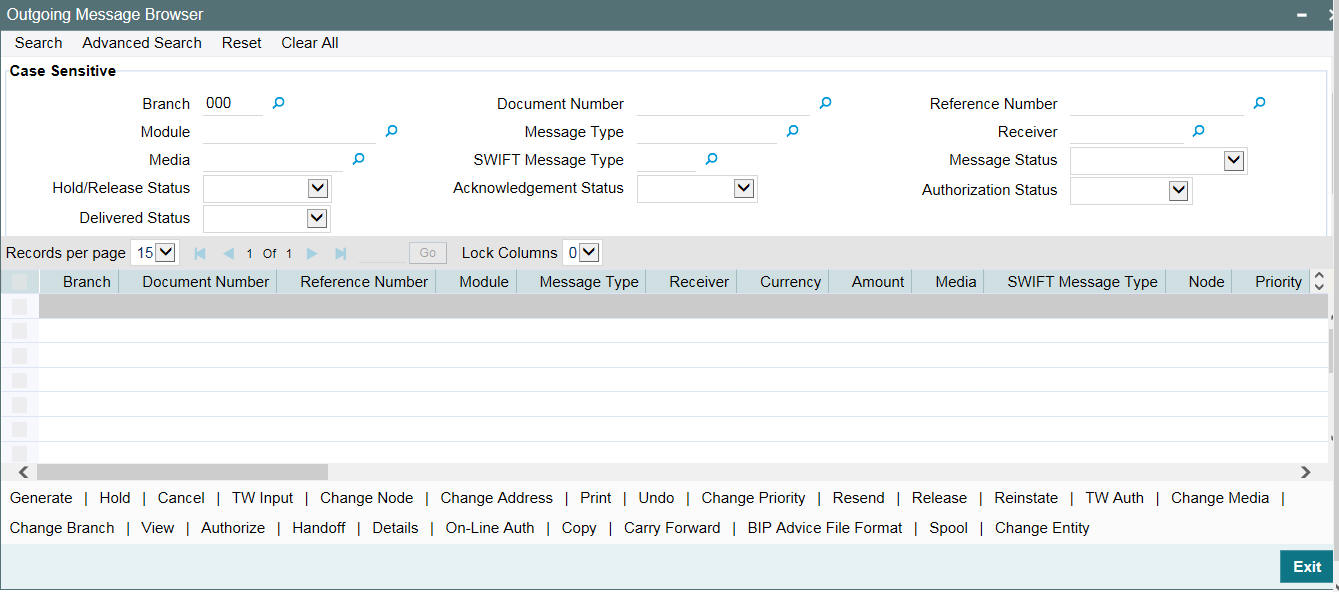

7.1.1 Manual Generation of Outgoing Messages
If the background message process is not running, all the messages that are triggered for generation will be displayed in the Outgoing Message Browser from where you can generate the message.
You can generate messages from the Outgoing Browser at any time in the day.
You can invoke the ‘Outgoing Message Browser Summary’ screen by typing ‘OLSOUTBR’ in the field at the top right corner of the Application tool bar and clicking on the adjoining arrow button.
7.1.2 Features of Outgoing Message Browser
The following details of a message will be displayed in the Outgoing Message Browser:
A message that is displayed on the Outgoing Message Browser can bear one of the following statuses:
For a message that was put into the repair status, the exception that occurred while the message was being processed will be shown. The following details of the message will also be displayed, and you have an option to change them. They are:
7.1.3 Viewing messages with different authorization status
You can choose to view the details of the outgoing messages on this Browser based on the status of a message. Oracle Lending offers you several options to choose from.
The options available are:
After indicating your preference, you can indicate the status for which you want to view message details. You can choose from these options:
Select the option(s) for which you would like to obtain details. You can choose to view details of the messages under one or all the options that are available.
Example
Case 1
You have specified that you want to view details of the ‘authorized’ messages. You have also ticked against ungenerated.
In this case, all the messages that are authorized and yet to be generated will be displayed.
Case 2
You have specified that you want to view details of the ‘unauthorized’ messages. You have also ticked against ‘Reinstated’ and ‘Canceled’ the details of all the unauthorized messages that have been reinstated will be displayed in a particular color and the unauthorized messages that were canceled will be displayed in a different color.
7.1.4 Operations you can perform on an outgoing message
The operations that you can perform on an outgoing message are determined by the rights that you have been assigned in the Security Management System (SMS) module of Oracle Lending. If a function in the Outgoing Browser is disabled, it means that the function is not allowed for the record.
Generate button
Click to generate an outgoing message. You can generate un-generated and repaired messages.
When you click ‘Generate’, the system checks the contract status for which the message is generated and will not generate a message in the following condition:
  • If the contract is reversed
  • If the message is on hold
  • If the message maintenance is not authorized and the message is moved to repair queue
Hold button
Click if you need to temporarily stop generating an outgoing message. Authorizing Supervisor can view details and then release the messages or change their status to Carry Forward, which in turn can be released on further authorization.
Messages with Hold status must either be carried forward or released, before you execute the EOD processes at the branch; else the system displays an error message. However, if the message is cancelled, then the system will not display error message, though the status is ‘Hold’.
Release button
Click if you need to release a message which is on hold.
Cancel button
Click if you need to cancel an outgoing message. You can cancel mes­sages with ‘Ungenerated’ and ‘Hold’ status.
Reinstate button
Click if you need to reinstate cancelled outgoing messages.
Testword Input button
Telex messages for which a testword is required will be put into the repair status. To enter the testword in order to remove a message from the repair status,
Highlight the message(s) then
Click the Test word Input button
The complete telex message will be displayed on the screen and you will be prompted to enter the testword.
The test word entry for a telex message will have to be authorized if you have indicated so in the Messaging Branch Preferences screen. If the testword entry requires authorization then on successfully entering the testword, the message will move from the repair status to an unauthor­ized status. In this case, the message can be generated only after the testword entry is authorized.
Authorize Test Word button
Click if you are provided rights to authorize testword entered for a Telex message. While authorizing you have to reenter the testword.
Change Priority button
Click if you need to change the priority, for sending a payment message which is yet to be generated.
Note: In the Background, Oracle Lending generates messages on the priority basis.
Change Media button
Click if you need to change the media through which a message is transmitted, before it would be generated. Media of transmission of a message is changed if there is a failure of the medium at the recipient’s end.
The selected media through which a message is transmitted should be available to the recipient.
Print Button
Click if you need to print an outgoing message. When you click ‘Print’, option will be provided to select spool or print on-line.
Messages that are transmitted through mail and those cancelled should be printed. You can also choose to print the details of messages trans­mitted through other media types.
The system provides an option to spool the advices in PDF format. When you click the ‘Print/Spool’ button, you can view the selected advice in PDF file. You can also view the SWIFT tag description.
Resend button
Click if you need to regenerate and resend a message which was gen­erated and sent.
View button
Click if you need to view the contents of a generated outgoing mes­sage. Viewing multiple messages is not supported.
Change Branch
Click if you need to send an outgoing message from another branch. Select the branch to which the message needs to be moved from the adjoining option list.
You change the branch of a message for the following reasons:
  • If there is a failure of a medium at the bank’s or the counterparty’s end
  • If the branch is located closer to the location of the customer’s address.
Change address button
Click if you need to change the address to which an outgoing message has to be sent. Enter the new address to which the message should be sent and click ’OK’ to save.
Change of address can be done only before a message is generated.
Change Node button
Click if you need to change the node from which an outgoing message is generated.
In a distributed environment, the database of one or more branches of your bank will be located at a node or a server. Hence a Media Control System will be installed and defined specifying the node at which it is installed.
When you click ‘Node’, the system displays the details of the individual message providing an option to change the ‘Node’. Select the node you need to change from the adjoining option list.
MCS status at the node in which the database of your bank is installed should be passive.
Handoff button
Click if you need to hand-off a generated message to MCS to save the date in an ASCII format.
Undo button
Click if you need to reverse the last action you performed on an outgo­ing message at ‘Outgoing Messages Browser’ level
Authorize button
Click to authorize, if you are provided authorization rights for an opera­tion at the Messaging Branch Preferences level. Messages should be authorized before sending them.
On-Line Auth button
Click to authorize online, if you are provided online authorization rights for an operation at the Messaging Branch Preferences level. Messages should be authorized before sending them.
Copy Button
Click if you need to send a copy of an outgoing message to another cus­tomer involved in a contract. You will provide the following to options:
  • Any–Select to implement the following changes:
  • Select media from an adjoining option list
  • Specify name of the recipient
  • Specify the location of the recipient
  • Specify the address of the recipient
  • Original–Select to copy the message in the original form

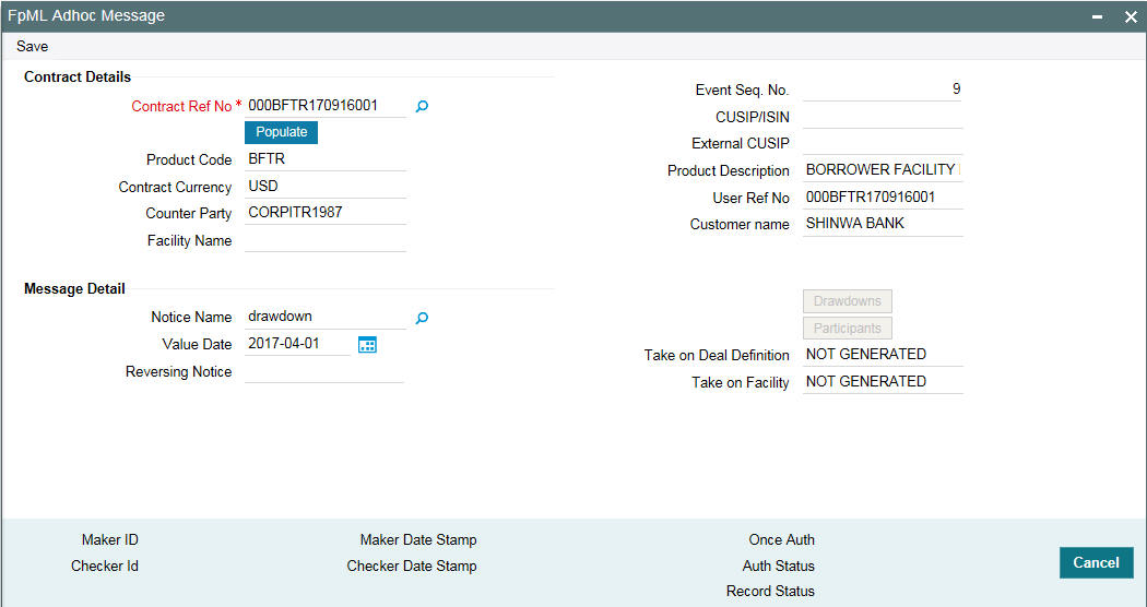

7.2 Generating Ad-hoc FpML Messages
FpML messages can be generated by the system when the event to which the messages are attached is triggered or on an ad-hoc basis manually. You can perform the latter operation for certain messages from the ‘Fpml Adhoc Message’ screen.
You can invoke the ‘FpML Adhoc Message’ screen by typing ‘LBDFPMLM’ in the field at the top right corner of the Application tool bar and clicking on the adjoining arrow button.
You can generate the following messages from this screen:
Each time any of the message specified above is generated for a tranche or a drawdown, the system will fire the event ‘ZAMG’.
In this screen, specify the following:
Contract Reference No.
Select the contract reference number for the contract for which you wish to generate messages from the adjoining option list. The list contains the reference numbers of all active and authorized tranche and drawdown contracts.
The system will display the following details:
CUSIP/ISIN
System displays the CUSIP/ISIN for the tranche. However, you can query the tranche details based on the ‘CUSIP/ISIN’.
External CUSIP
System displays the external CUSIP for the tranche. However, you can query the tranche details based on the ‘External CUSIP’.
Value Date
System defaults the ‘Value Date’ as the current application date. However, you can edit the ‘Value Date’ only when you select the ‘Notice Name’ as ‘positionUpdate’. Also, the value date cannot be a holiday and it should be less than or equal to the current application date.
Notice Name
Select the name of the message that you wish to generate from the adjoining option list. The list contains the messages that you can generate from this screen.
Note
7.2.1 Selecting Drawdowns
You can select the drawdowns corresponding to the tranche using ‘Drawdown Selection’ screen. You can invoke this screen by clicking the ‘Drawdown’ button in the ‘Fpml Adhoc Message’ screen.
System displays the following details from the main screen:
Drawdowns under Tranche
System displays the drawdowns corresponding to the tranche or CUSIP/ISIN only if the drowdown notice has been generated for the drawdown.
Drawdowns for Fpml Message
Select all or specific drawdowns from ‘Drawdowns under Tranche’ that are required in the ‘Position Update’ message of ‘Statement’ type by using the right arrow button (>) in the screen.
7.2.2 Selecting Participants
You can select the participants corresponding to the tranche or CUSIP/ISIN selected using ‘Participant Selection’ screen. You can invoke this screen by clicking the ‘Participant’ button in the ‘Fpml Adhoc Message’ screen.
Display By
Indicate the tranche participant mode of display. You can select one of the following options:
Tranche Participants
System displays the participants corresponding to the tranche or CUSIP/ISIN only if the UDF ‘MEICODE’ is maintained at the customer level.
Participants for Fpml Message
Select all or specific participants from the list of participants displayed in ‘Tranche Participants’ that are required in the ‘Position Update’ message of ‘Statement’ type by using the right arrow button (>) in the screen.
Note
‘Drawdown and/or Participant selection is already done for Position update notice, changing Notice name will delete these details’

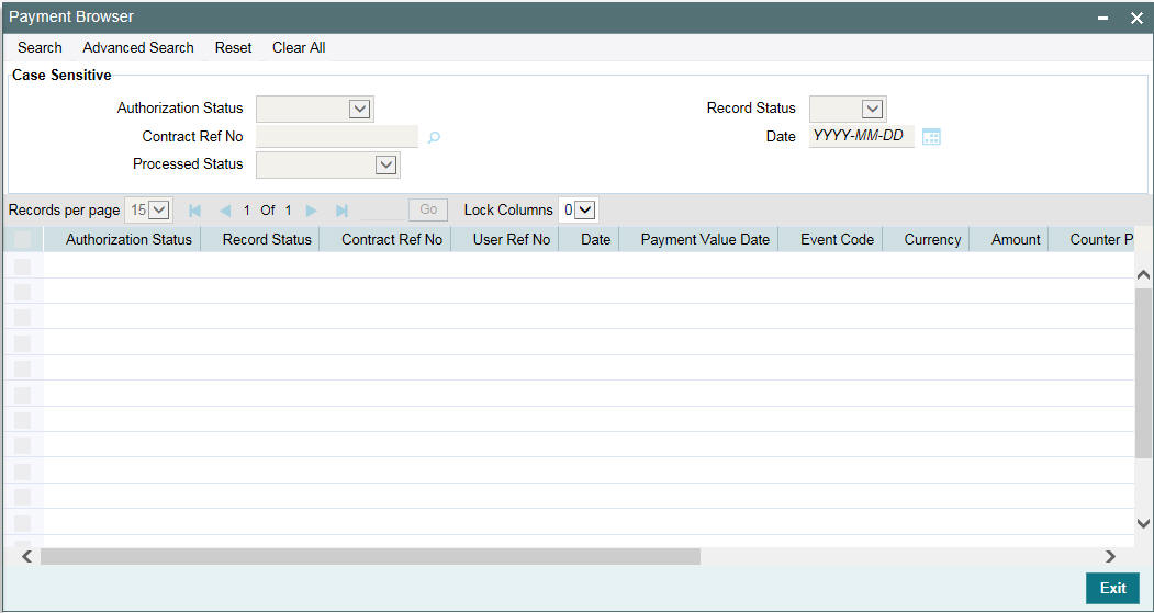

7.3 Forward Processing of Events
You can view the details of contracts marked for forward processing through the ‘Payment Browser’ screen.
You can invoke the ‘Payment Browser’ screen by typing ‘LBSFWDPR’ in the field at the top right corner of the Application tool bar and clicking on the adjoining arrow button.
Note
To carry out forward processing on an event, you will have to select the Rollover Mode, Liquidation Mode and Initiation Mode as ‘Semi-Auto’ for tranche and drawdown. Similarly, for forward processing of fee components, the fee liquidation mode should be ‘Semi-Auto’ (in the ‘Fee Components’ sub-screen of the ‘LS Tranche Contract Online’ screen and the ‘Drawdown Contract Online’ screen). The processing for the events ROLL, LIQD, INIT and FLIQ will be processed semi-automatically. LD rollover should have rollover mode as semi auto to reflect the payment messages in the forward processing browser.
7.3.1 Fetching the Contracts for Forward Processing
In this screen, you can filter the contracts required for forward processing based on the following parameters:
Date Range
The ‘From and ‘To’ dates consider Archive days and Limit days for forward processing. These dates will be automatically calculated by the system based on the application date considering the ‘Limit Days’ and ‘Archive Days’ maintained as part of branch parameters (in the ‘Syndication Loans and Commitments – Branch Parameters’ screen).
For more details on maintaining branch parameters, refer the heading titled ‘Indicating branch parameters for loan syndication’ in the ‘Reference Information for Loan Syndication’ chapter of this User Manual.
Processed Status
You can also filter the required contracts based on a processing status of the contracts. The available options are:
After specifying the filter criteria, click the ‘Refresh’ button to fetch the contracts. The following details will be displayed in the screen:
You need to check the ‘Hold Transaction’ option after the message generation and before the fee liquidation (FLIQ) of payment, if the payment has to be stopped.
During the batch, the system will verify if the payment is on hold. If so, it will not pass the accounting entry and the schedule will not get liquidated. If you check the ‘Hold Transaction’ box, the system will uncheck and disable the ‘Confirmed to Auto’ check box. It will also disable the ‘D’ button.
If the ‘Hold Transaction’ option is unchecked for the payment on/before the schedule date of the payment, then the FLIQ event will be triggered during the EOD batch of the payment schedule date and the new payment message will be generated with new payment value date. There will not be any change in participant ratio/SSI if there is no back valued activity impacting the schedule amount.
If the payment is closed manually, then the fee liquidation entries will be passed using the suspense GL and SSI propagation for amount tags till the next hold date/ latest SSI based on the components in next schedule is on hold on or before the current application date.
The ‘Sanction Checked’ box will be checked automatically once Sanction Check system confirms all the payment messages in detail block with value -1 (COMPLETE). If any of the payment messages in the detail block is not -1 (COMPLETE), then the system will not check the ‘Sanction Checked’ box.
The SC N/A box is checked systematically if sanction check is not applicable for a payment.
Depending on the module and payment type, the payments for which SC is not applicable will be handed off as soon as they are generated, or manual intervention will be required to release the payments
The system will display the payment messages for the below payments in the ‘Payment Browser’ screen:
The system will do sanction screening process for LS, LD, SLT, Adhoc Fee and FT modules, if the ‘Sanction Check Required’ box in Loans Parameter screen is checked. This will be done once the payment message is generated and displayed in the ‘Payment Browser’ screen with status code as ‘0 - TRANSMITTED TO SANCTIONS’.
If the status code received from Sanction Check system is ‘-1’, then:
If the status code received from Sanction Check is not ‘-1’, then system will not allow to confirm and manually release the payment messages for LS and SLT payments.
If the status code received from Sanction Check system is ‘03’ (Terminate), then the payment message can neither be released manually / systematically nor be resent to SC
If the status code received from Sanction Check system is 04, 05 or 06, then:
If the status code is 0, -1, 01, 02, 03 then you will not be allowed to resend the message for Sanction Check processing.
Payment cannot be released manually or systematically when the status is 0.The status can be systematically re-updated more than once for the payment messages that are re-sent from Oracle Lending. For example,

You can view the payments based on status code:
During end of day batch processing, the payment messages cannot be released from forward processing browser, though the status code received from Sanction Check system is -1. Once the batch is completed and online jobs are started, status code in the forward processing browser will get updated which was received during the batch.
The payment messages for FT and LD modules including Adhoc Fee will be systematically released if the status code is -1. However, the payment messages for LS and SLT modules will be allowed to be released manually through maker/checker process when the status code is -1
