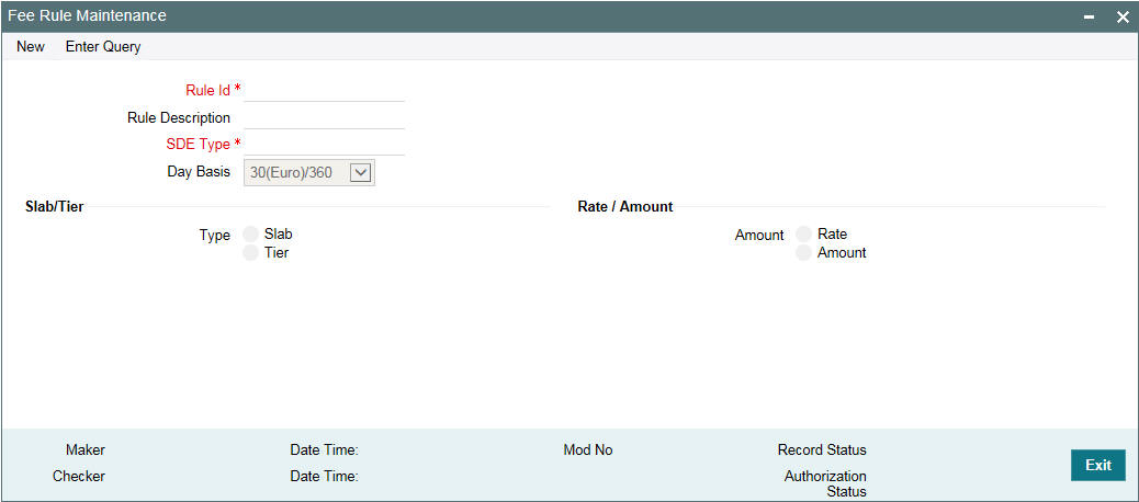

7.3.1 Maintaining Rule
You can invoke this screen by typing ‘GEDRULES’ in the field at the top right corner of the application tool bar and clicking the adjoining arrow button.
Rule ID
Every fee rule is identified by a unique code, called a Rule ID. You can link a valid fee Rule ID to the fee classes.Fees for a limit with which you associate a fee class is calculated on the basis of the Rule that is associated with the class.
Rule Description
For every rule that you define, you can enter a description. Specifying a description helps identify a rule.
SDE Type
Specify the System Data Elements (SDE). The adjoining option list displays a list of SDEs maintained in the system.
Day Basis
A day basis method is used for fee calculations.
Different values for the numerator basis are as explained below:
Different values for the denominator of the fee basis are as explained below.
Fee Component Type
Select the fee component type either as ‘Slab’ or ‘Tier’.
Fee Type
Select the fee type either as ‘Rate’ or ‘Amount’.

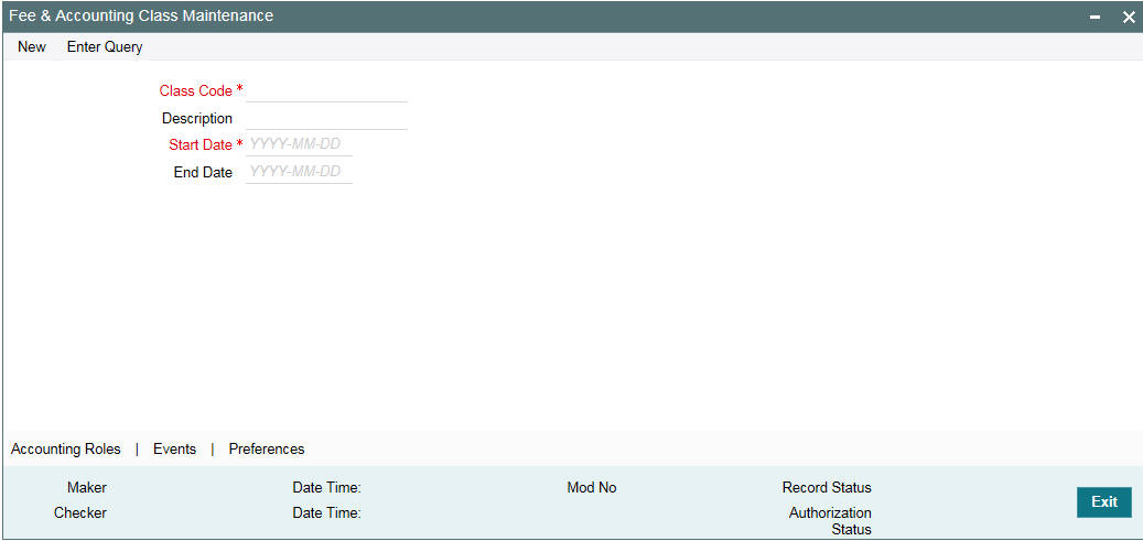

7.3.2 Maintaining Fee Class
You can invoke this screen by typing ‘GEDCLSMT’ in the field at the top right corner of the application tool bar and clicking the adjoining arrow button.
Class Code
Before defining the attributes of a fee class, you should assign the class a unique identifier, called the Class Code.
Description
A brief description about the class. A description helps you to easily identify the class.
Start Date
Specify the start date from which the fee calculation starts. The start date can only be a current date or the future and it cannot be a back dated date.
End Date
Specify the end date till which the fees will be calculated.
7.3.2.1 Accounting Roles tab
You can specify accounting roles details in ‘Accounting Roles’ screen. Click ‘Accounting Roles’ tab to open this screen.
Accounting Role
Accounting Roles are tags that identify the type of accounting entry that is posted to an accounting head.
Accounting Head
The different General Ledgers (GLs) and Sub-Ledgers (SLs) maintained in your Chart of Accounts are referred to as accounting heads or account heads.

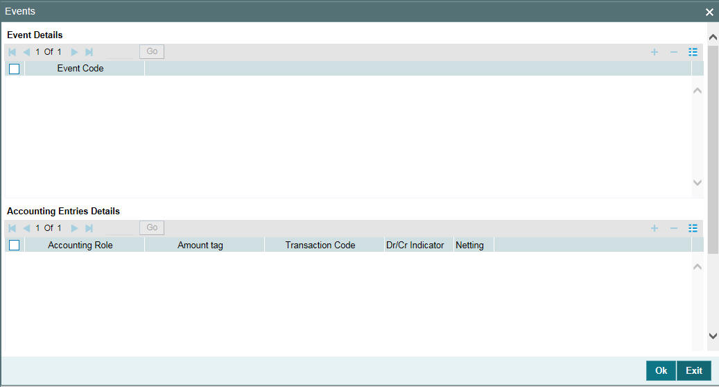

7.3.2.2 Events tab
You can specify event and accounting entries details in ‘Events’ screen. Click ‘Events’ tab to open this screen.
Event code
Specify the event code.
Accounting Role
Amount Tag
Specify the amount tag.
Transaction Code
Indicates the type of accounting entry associated with every accounting entry.
Dr/Cr Indicator
Indicates whether the amount was debited or credited to the ‘Net’ Account
Netting
Select this drop-down list if you need netting for fee liquidation.
