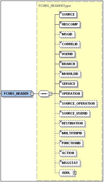

A standard gateway message in the Oracle FLEXCUBE Envelope contains two main components namely:
4.2.1 FCUBS HEADER
The tags under FCUBS HEADER have been described below:
SOURCE
This indicates the name of the External system that is the source of the message.
UBSCOMP
This indicates the Oracle FLEXCUBE component of the message - whether FCIS or FCUBS
MSGID
This unique ID identifies each message – incoming or outgoing in Oracle FLEXCUBE. Every message will have a distinct message ID.
CORRELID
This is the id using which any system which has sent a request to FC UBS can correlate to the response. In the External system maintenance, the Correlation Pattern can be configured for each external system. It can be maintained that either the ‘MSGID’ or the ‘CORRELID’ of the request message is returned back as the ‘CORRELID’ in the response message. Depending on this maintenance, Oracle FLEXCUBE sets either the ‘MSGID’ or the ‘CORRELID’ of the request message in the response message.
USERID
For request messages, this ID is used to submit message requests. Oracle FLEXCUBE processes this request using this id.
For response messages, the value of this is ‘null’.
BRANCH
This indicates the Oracle FLEXCUBE Branch Code where the request message needs to be processed. If the BRANCH is missing in the header, request message is transmitted and processed in Head Office branch.
MODULE ID
This indicates the module ID.
SERVICE
This provides details on the various services of Oracle FLEXCUBE. For every incoming message in Oracle FLEXCUBE, the service name is mandatory.
OPERATION
This indicates the functional operation.
SOURCE OPERATION
This indicates the functional operation as registered in Oracle FLEXCUBE.
SOURCE USERID
This is the User ID with which the request message was invoked from the SOURCE.
DESTINATION
For incoming messages, the destination is Oracle FLEXCUBE. For response messages, system will populate the SOURCE of the request message as DESTINATION.
MULTITRIPID
This is a unique id which indicates overrides.
FUNCTIONID
This indicates the Oracle FLEXCUBE Function ID
MSGSTAT
This indicates whether the transaction is a SUCCESS or FAILURE.
ADDL
This is used to send additional parameters, that is, parameters not available in Oracle FLEXCUBE.

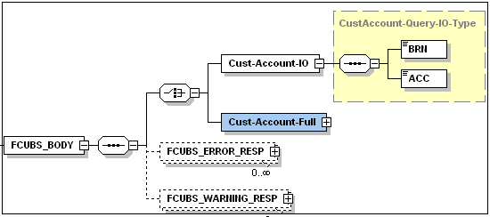

4.2.2 FCUBS_BODY
The FCUBS_BODY will contain the actual payload to perform the respective transaction. The contents of the payload will vary for each operation.
The following snapshot shows a sample FCUBS_BODY of QUERYCUSTACC operation.

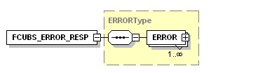

FCUBS_BODY will contain additional nodes for error response and warning response. A diagrammatic representation of the Error response is as shown below:
4.2.2.1 FCUBS_ERROR_RESP
The error response message is sent from Oracle FLEXCUBE when errors are raised in a transaction. The error response have another tag ‘ERROR’ within it.
ERROR
The ‘ERROR’ node have tags for error code and error description. The ‘ERROR’ node is generated for each error raised by FCUBS.

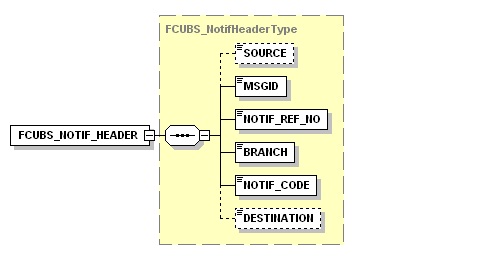

4.3 Oracle FLEXCUBE NOTIFICATION
The notification messages are generated in a standard format. The notification messages consist of two main components:
FCUBS_NOTIF_HEADER – This forms the header portion of a notification message. This contains a standard set of tags that can identify a notification. These tags are constant across all notification messages.
FCUBS_NOTIF_IDENTIFIER – This will identify the maintenance records based on the information provided under this node. The contents of this node will vary for each notification.
A diagrammatic representation of FCUBS NOTIFICATION is as shown below:
4.3.1 FCUBS NOTIFICATION HEADER
The tags under FCUBS NOTIFICATION HEADER have been described below:
SOURCE
This indicates the name of the External system or the source of the message.
MSGID
This is the unique reference number generated by Oracle FLEXCUBE.
NOTIF_REF_NO.
This unique reference number identifies each notification message generated in Oracle FLEXCUBE.
BRANCH
This indicates the branch in which notification has been triggered.
NOTIF_CODE
This indicates the code for the notification that has been triggered.
DESTINATION
For incoming messages, the DESTINATION should be Oracle FLEXCUBE. For response messages, system will populate the SOURCE of the request message as DESTINATION.
