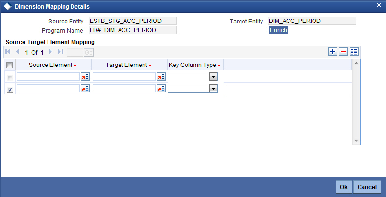

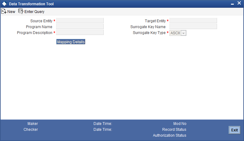

2.2.2 Maintaining Details of Data Transformation Tool
You need to map the source entities (staging tables) to the respective target entities (fact and dimension tables) using ‘Data Transformation Tool’ screen. To invoke this screen, type ‘RPDDTT’ in the field at the top right corner of the application toolbar and click the adjoining arrow button.
Specify the following details:
Source Entity
Select the source entity that you need to map to the target entity. The option list displays the existing staging tables available for selection. Select the appropriate one.
Target Entity
Select the target entity that you need to map to the selected source entity. The option list displays the existing fact and dimension tables available for selection. Select the appropriate one.
Program Name
Based on the target entity, the system displays the program name.
Program Description
Enter a brief description of the above program.
Surrogate Key Name
Based on the target entity, the system displays the surrogate name.
Surrogate Key Type
The surrogate key type is ASCII.
Once you have specified the above details, click ‘Mapping Details’ button to map the source and target elements. The system displays the ‘Dimension Mapping Details’ screen.
Click ‘Enrich’ button to populate the source elements. The system will populate the source elements in the screen.
You may also manually enter the source elements, In that case you need not click ‘Enrich’ button. You can directly specify the following details:
Source Element
Select the source element that you need to map to the target element.
Target Element
Select the target element to be mapped to the selected source element.
Key Column Type
Select the key column type. The drop-down list displays the following options:
You can add more rows to the list using add button. To delete a row, check the adjoining check-box and click delete button.
Note
The required dimension mapping details are available within Oracle FLEXCUBE. Howev­er, if you need to modify the mapping, you can do it using these screens.

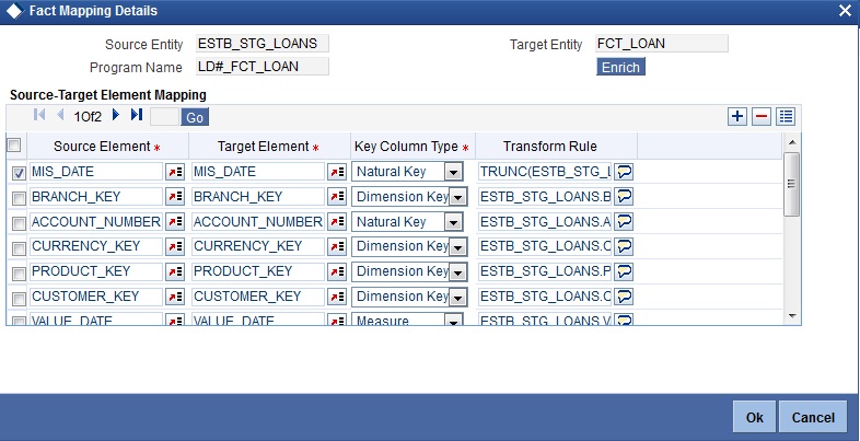

2.2.2.1 Mapping Facts
You can map the source and target elements and define the key column type and transform rules using ‘Fact Mapping Details’ screen.
Source Element
Target Element
Key Column Type
Transform Rule
Define the transform rule.

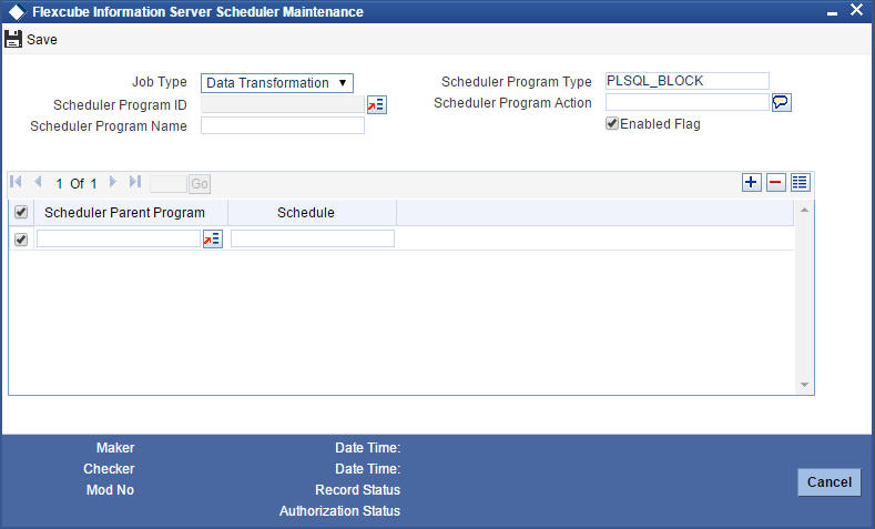

2.2.3 Maintaining FLEXCUBE Information Server Scheduler
You can maintain the Oracle FLEXCUBE Information Server jobs and their dependencies using ‘FLEXCUBE Information Server Scheduler Maintenance’ screen. To invoke this screen, type ‘RPDSCH’ in the field at the top right corner of the application toolbar and click the adjoining arrow button.
Job Type
Specify the job type ‘Data Transformation’.
Scheduler Program Type
Specify the program type. By default, the system displays ‘PLSQL_BLOCK’. However, you can modify this.
Scheduler Program ID
Select the program ID from the option list.
Scheduler Program Name
Based on the program ID, the system displays the name of the program.
Scheduler Program Action
Specify the program action.
Enable Flag
Check this box to enable the program action.
Scheduler Parent Program
Specify the scheduler parent program. You can select the appropriate program from the option list.
Schedule
Based on the selected scheduler parent program ID, the system displays the name of the schedule.
Note
The required scheduler maintenances are available in Oracle FLEXCUBE. However, if you need to modify the maintenances, you can do it using this screen.
Once you have specified the above details, save the maintenance.

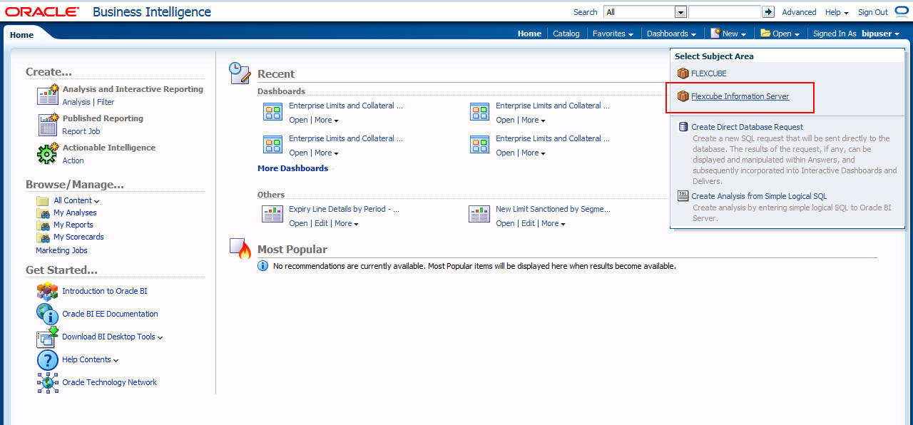

2.3 Generating Reports
You can generate the various preset reports from Oracle FLEXCUBE Information Server. Login to Oracle Business Intelligence Enterprise Edition. Go to Dashboards. The reports are organized as tabs under the dashboard. You can drill down to the account level by clicking the data.
Following reports are available under the dashboards:

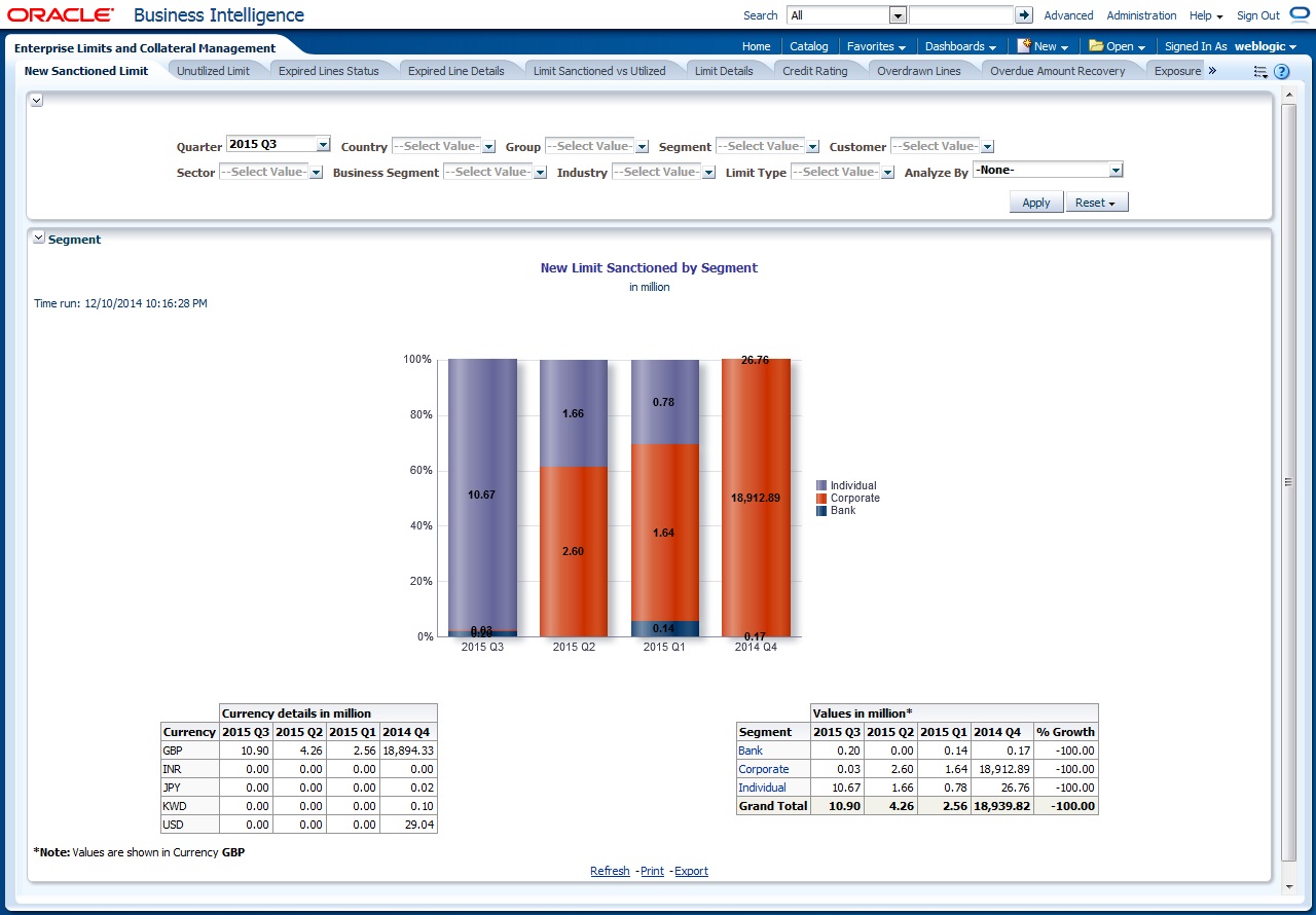

2.4.1 New Sanctioned Limit
The New Sanctioned Limit report shows the details of new limit amounts sanctioned by the bank.
Analyze By
You can analyse the report by the following parameters.
Select the appropriate dimension from the drop down list and click ‘Apply’ button. The system displays the details of the new sanctioned limits in graph and tables, analysed based on the selected dimension.
You can also filter the reports based on the following parameters:
You can drill down to further levels by clicking the respective links, as illustrated below.

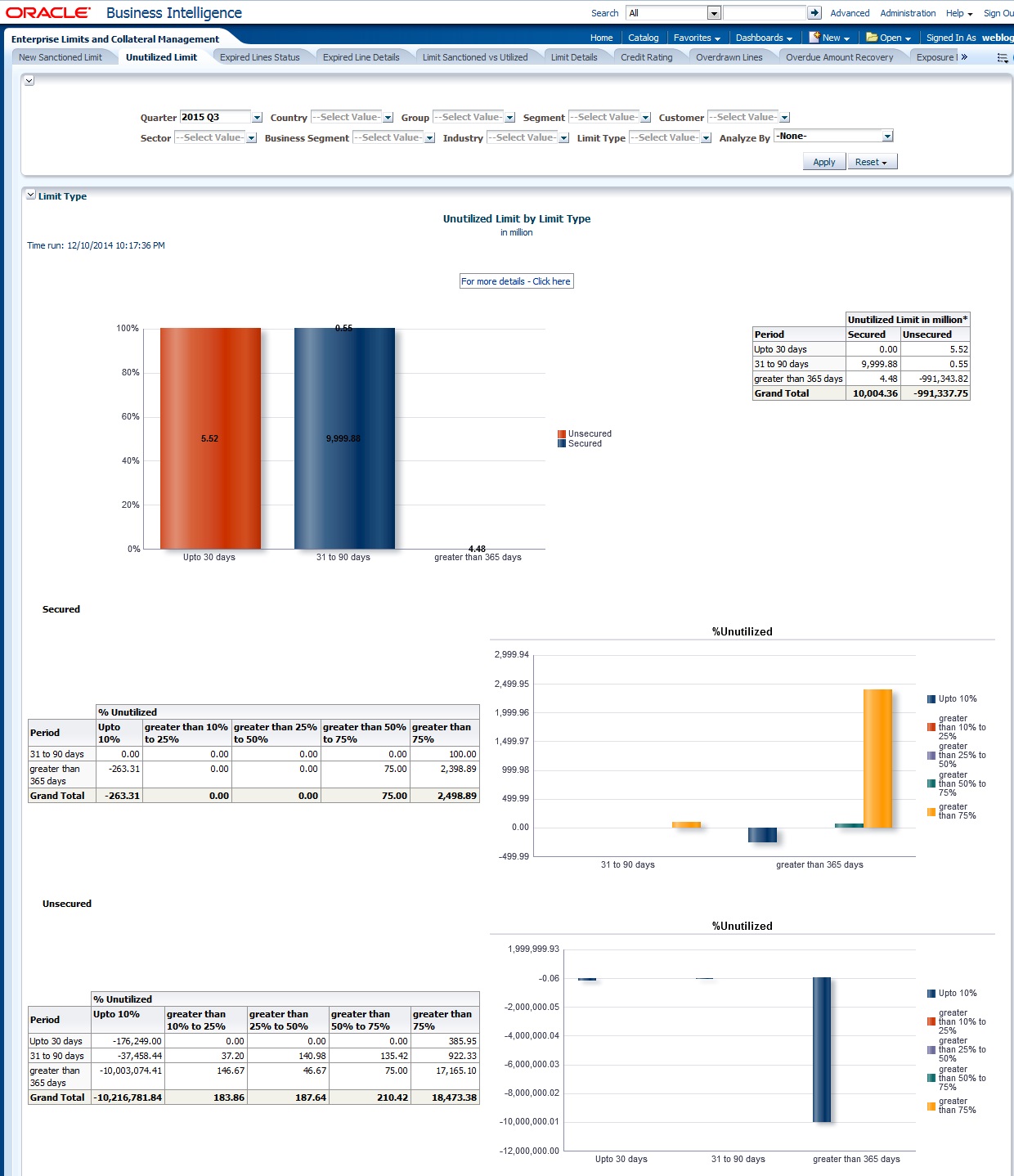

2.4.2 Unutilized Limit
The unutilized limit report shows the details of limits that are not utilised:
Analyze By
Select the appropriate dimension from the drop down list and click ‘Apply’ button. The system displays the details of the unutilised limits analysed based on the selected dimension.

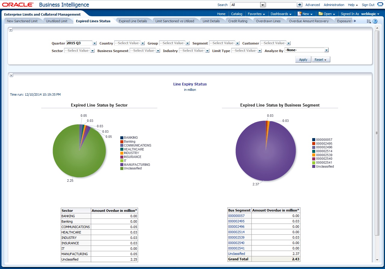

2.4.3 Expired Line Status
This report shows details of lines in expired status
Analyze By
Select the appropriate dimension from the drop down list and click ‘Apply’ button. The system displays the details of the expired lines analysed based on the selected dimension.
Analyze By Report
Drill Down values
Report
Drill Down Values
Report
Segment
NA
Country
NA
Business Segment
List of Busi­ness Segments and Unclassi­fied
Line Expiry Sta­tus by Busi­ness Segment - Details
For more details - Click here
Line Expiry Sta­tus by Busi­ness Segment - Limit - Details
Quarter
Line Expiry Sta­tus by Quarter Details
Sector
NA
Limit Type
NA
Group
NA
Liab No
NA
Industry
NA
The following actions are supported from this screen:

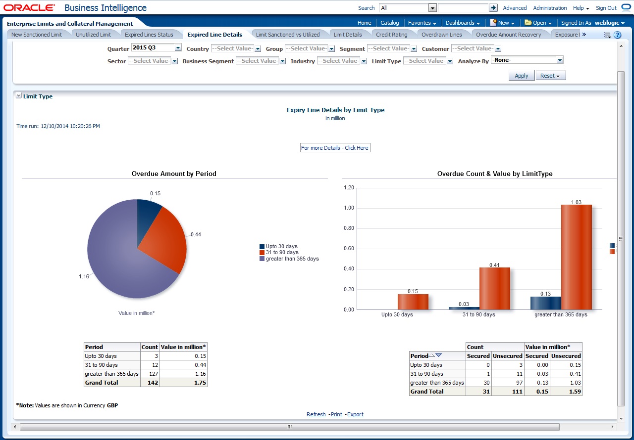

2.4.4 Expired Line Details
Expired line details report shows the details of expiry lines.
Analyze By

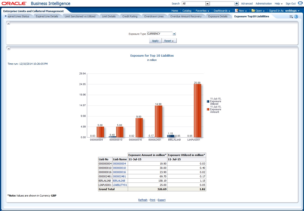

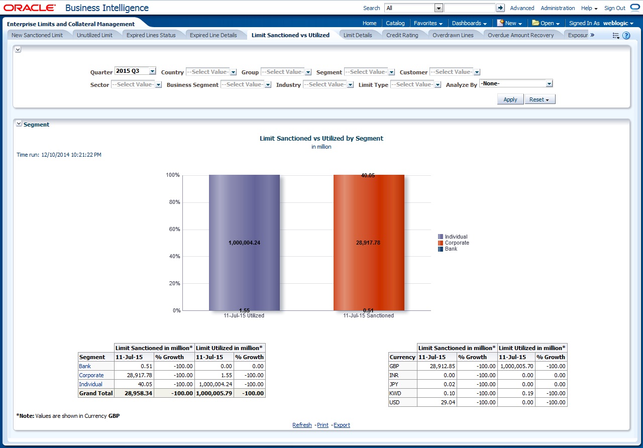

2.4.5 Limits Sanctioned Vs Utilized
This report shows the details of sanctioned limits and the utilized limits:
Analyze By
Select the appropriate dimension from the drop down list and click ‘Apply’ button. The system displays the details of the sanctioned and utilized limits based on the selected dimension.
Analyze By Report
Drill Down values
Report
Drill Down Values
Report
Drill Down Values
Report
Seg­ment
Bank
Segment - Group - Details
Group Codes and Unclassi­fied
Segment - Group - Customer Details
Corpo­rate
Individ­ual
Country
NA
Busi­ness Seg­ment
For more details Click Here
Business Seg wise Sanc - Uti­lized Details
Liab No and Unclassi­fied
Business Seg wise Sanc - Uti­lized Details Report
Quarter
NA
Sector
For more Sanc­tioned details Click here
Sector - Sanc­tioned Limit - Type Details

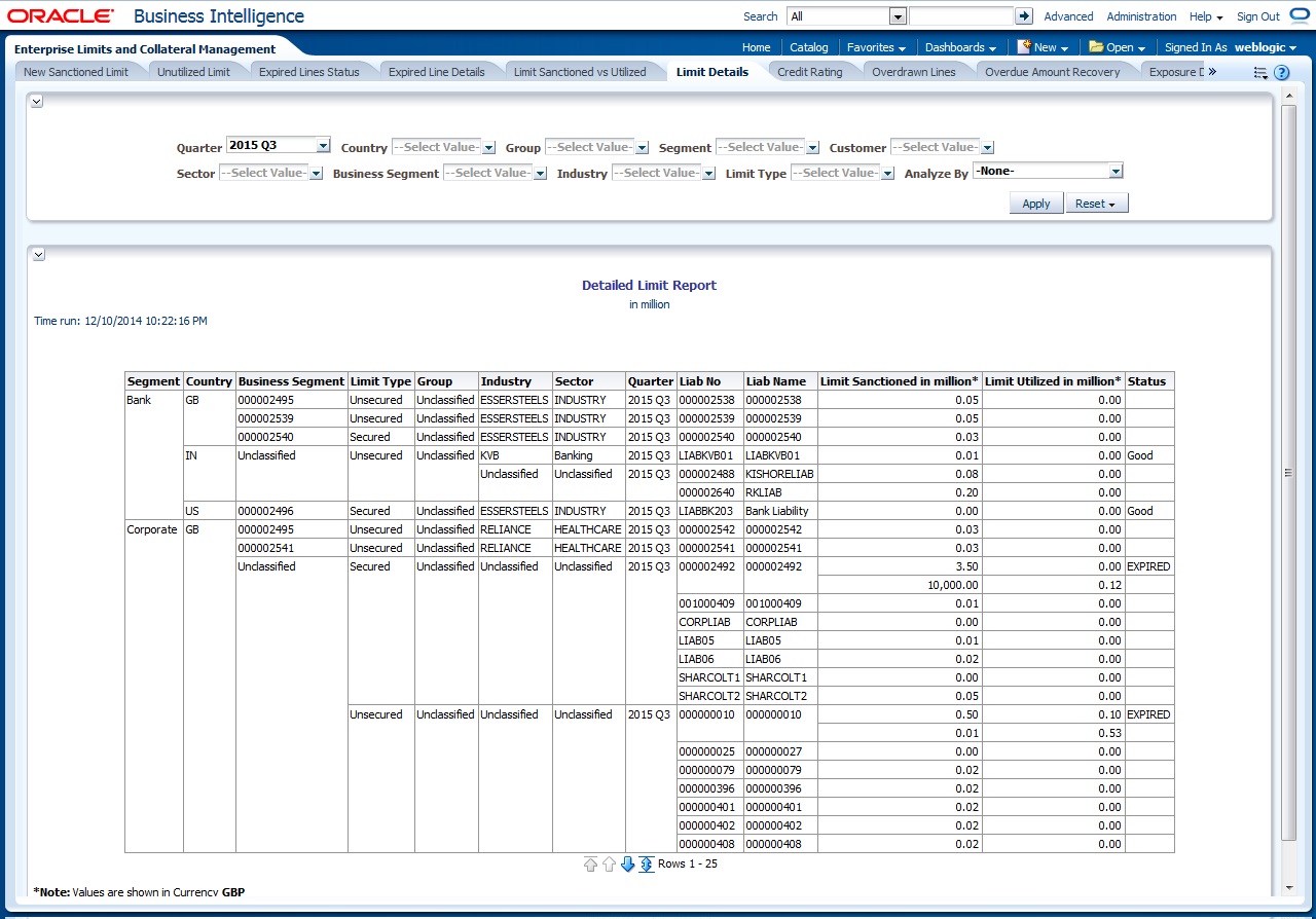

2.4.6 Limit Details
Limit details report shows the details of limits maintained in the system. This report is displayed in table format.
Analyze By
Select the appropriate dimension from the drop down list and click ‘Apply’ button. The system displays the details of limits based on the selected dimension.

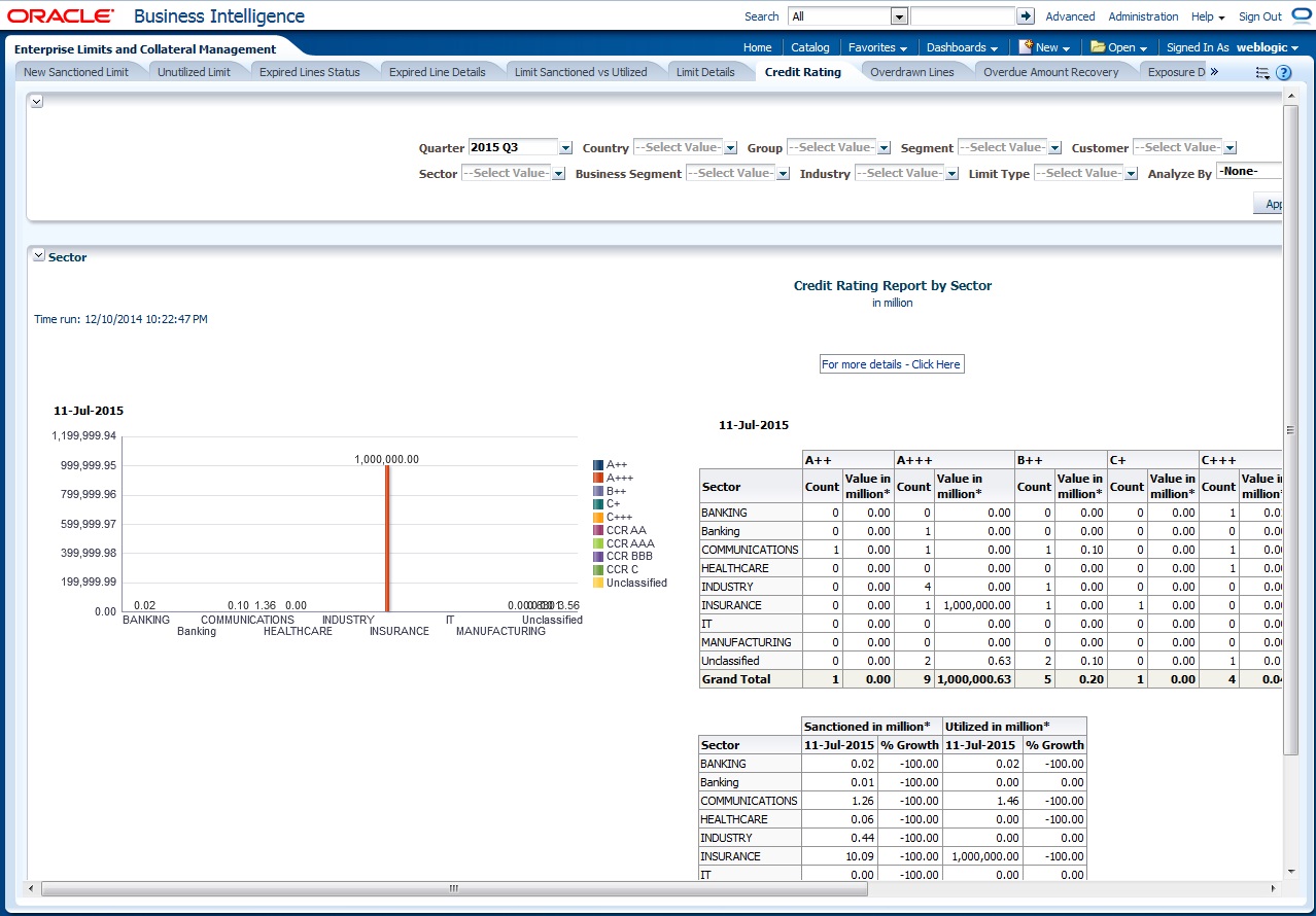

2.4.7 Credit Rating
Credit rating report shows the details of credits provided to various sectors classified based on the credit rating.
Analyze By
Select the appropriate dimension from the drop down list and click ‘Apply’ button. The system displays the details of the credit ratings based on the selected dimension.

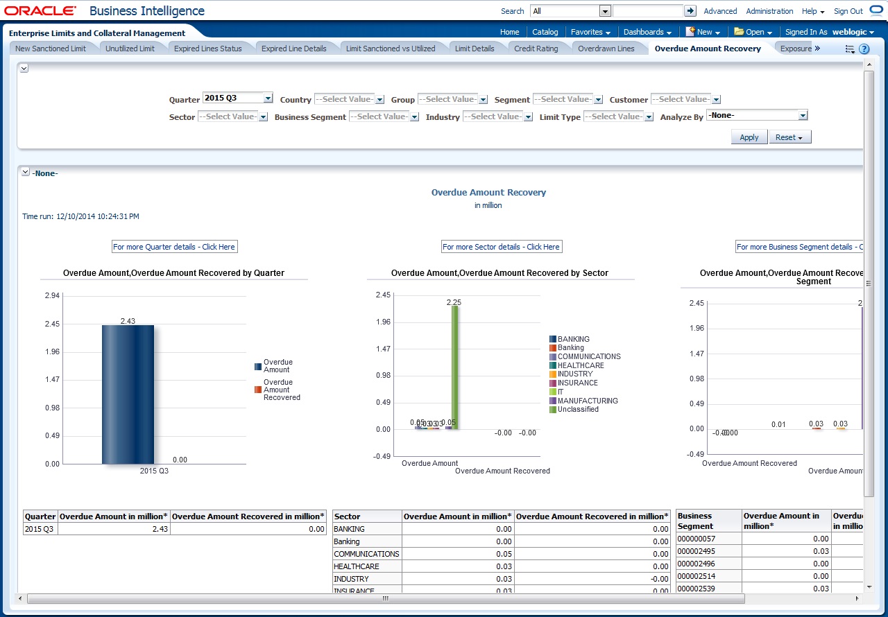

2.4.9 Overdue Amount Recovery
This report displays the details of overdue amounts and the recovery status.
Analyze By
Select the appropriate dimension from the drop down list and click ‘Apply’ button. The system displays the recovery details of the overdue amount based on the selected dimension.

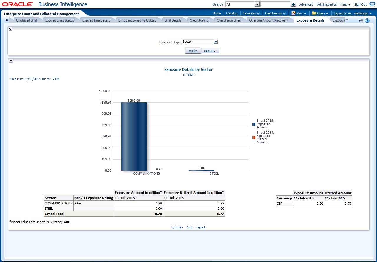

2.4.10 Exposure Details
This report displays the details of exposure.
You can view this report for the following exposure types:
2.4.11 Exposure Top 10 Liabilities
This report shows the exposure details for the top ten liabilities in the system.

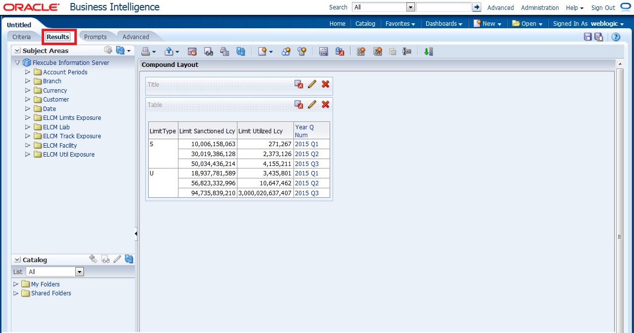

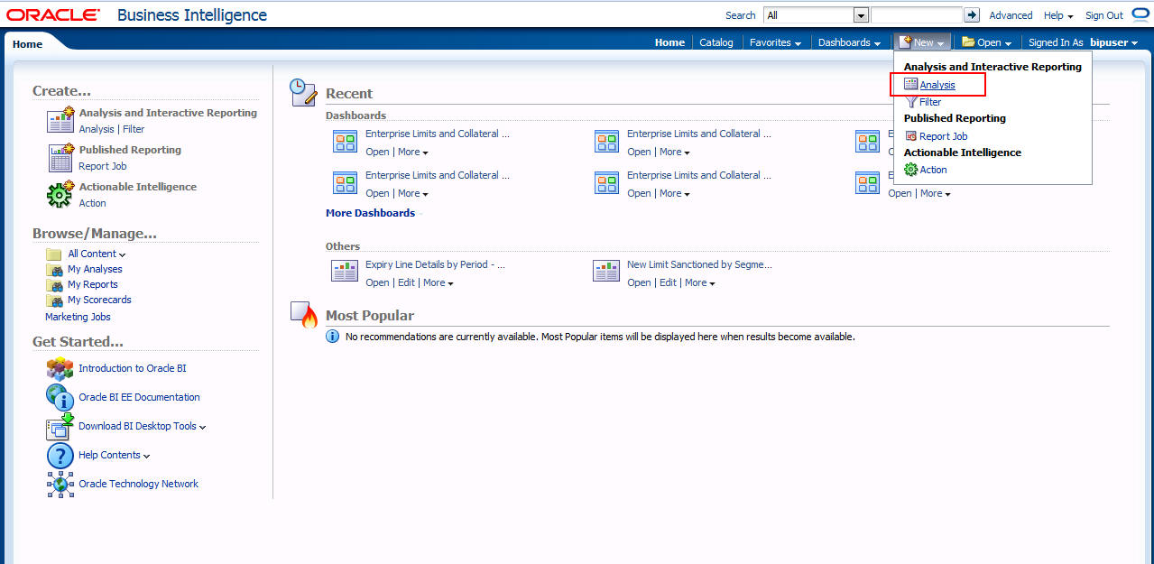

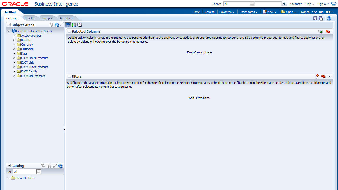

2.5 Creating Dynamic Reports

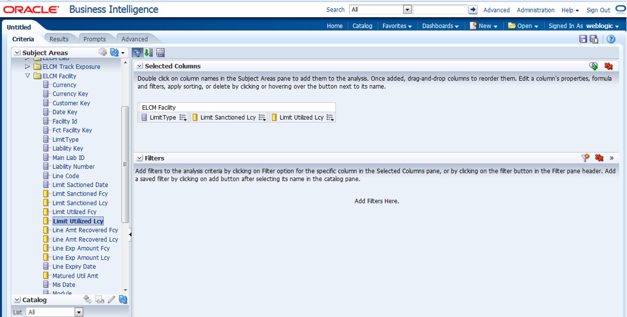

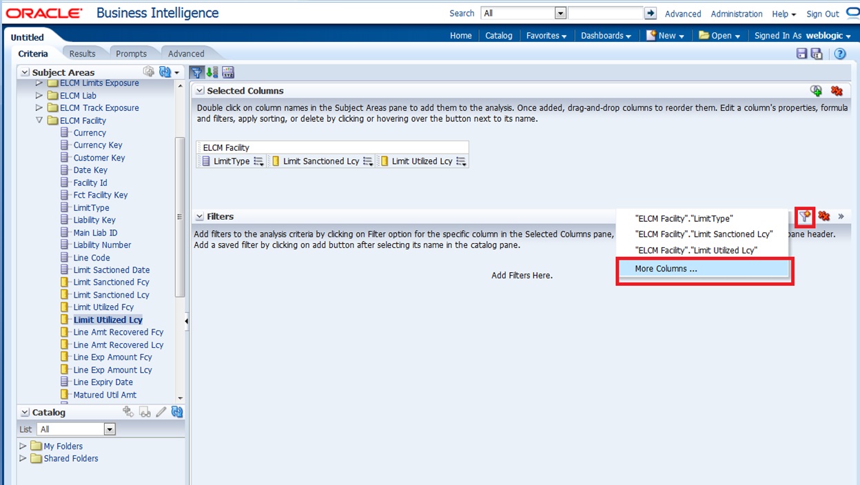

You can create dynamic reports using the Oracle FLEXCUBE Information Server RPD. In order to start with creation of a dynamic report, login to OBIEE system.
Click ‘New’ on the toolbar and select ‘Analysis’. You will be prompted to select the Subject Area.
Select ‘FLEXCUBE Information Server’ from the list.
Navigate to ‘Criteria’ tab.
On the left pane, expand the ‘FLEXCUBE Information Server’ subject area. You can find the following folders.
Folder
Data Type
Description

The subject areas that you select for a particular report decide the data that needs to be taken for generating the report. You can expand the folders mentioned above and select the columns that are required in the report.
Double-click a column name to add it to the report. The selected columns are displayed on the screen.
In order to add filters to the report, click the ‘Filter’ icon.
Click ‘Filter’ icon and select ‘More Columns’ to select the filters that you need to apply.
Select the required column and click ‘OK’ button. You will see the ‘New Filter’ window.
Select the operator and value. Click ‘OK’ button to add the filter. You can add more filters in the same manner.
The ‘Filters’ section of the screen displays all the selected filters.
Once you have added the filters and done the required edits, click ‘Results’ tab.
From this tab, you can add graphical representation of the data by using the new view button.
Select the type of graphical representation that you need to add.
OBIEE will display the graph in the result area.
You can drag and drop the items in the result and rearrange the display. If you wish to edit the properties of the graph, click Edit icon on the graph item toolbar.

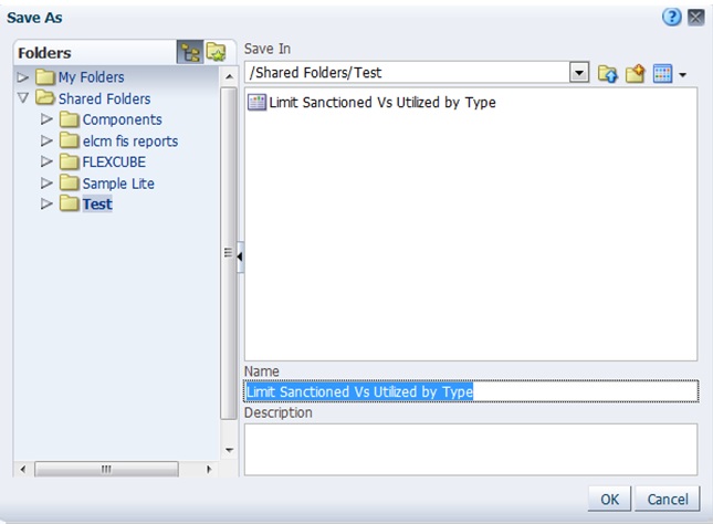

Once the changes are made, click Save icon to save the report that you have created. OBIEE prompts you to specify the name of the report to save
Give an appropriate name to the report and click ‘OK’ button to save it.
