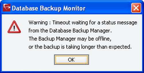

The following warning notification indicates that the DIVArchive Manager timed out waiting for a connection from the DIVArchive Backup Service because the Backup service failed to start. If the Metadata Database is enabled, Manager expects a connection from the Backup Service within 15 minutes (configurable) from the time that Manager started running.

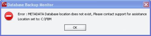

The following error notification is displayed when the Metadata Database Location is not configured or invalid.

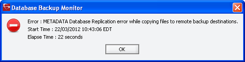

The following error notification is displayed when copying the Metadata Database Files to any of the remote backup destinations fails.

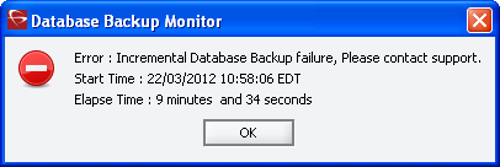

The following error notification is shown when the Oracle Database Backup fails or Copying Oracle Backups to a remote backup system fails.
