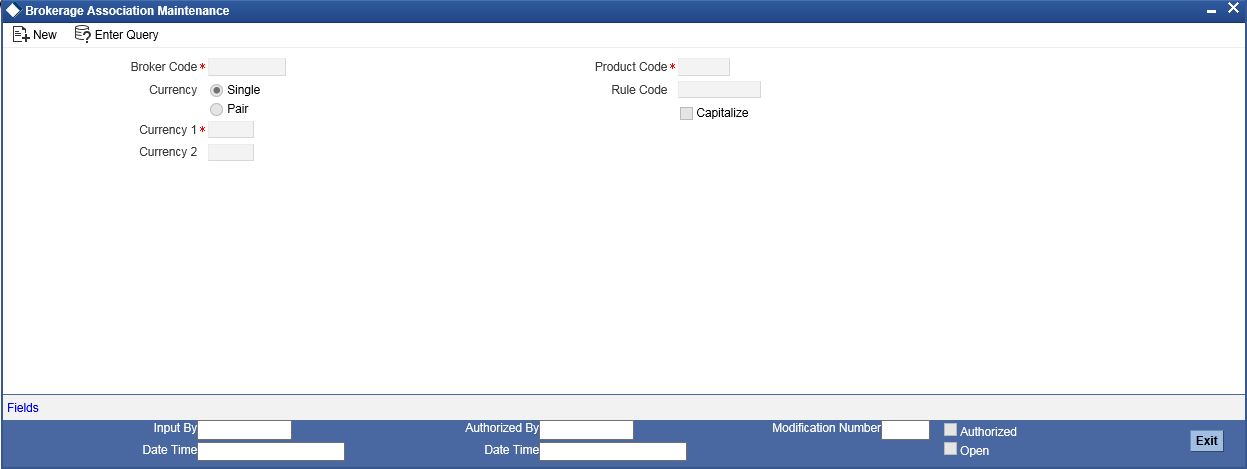

Associating a broker and a product with a rule is explained in the Products Manual.

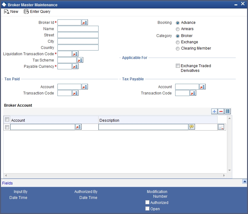

You can capture the basic details of brokers with whom your bank deals with in the ‘Broker Master Maintenance’ screen. In this screen, you can specify the following:
You can invoke the ‘Broker Master Maintenance’ screen by typing ‘BRDMAST’ in the field at the top right corner of the Application tool bar and clicking the adjoining arrow button.
Broker Identification
In the ‘Broker Master Maintenance’ screen, you should specify a (unique) Broker Identification for every broker with whom you deal. The Broker Identification has to be the same as the broker’s Customer Identification Number (since a broker will have an account with you − that is, will be a customer of your bank). The Customer Identification Number can be selected from a list that is displayed.
This Broker ID will be used to identify the broker. For example, when processing a deal on which you have to pay brokerage, or when generating reports for a broker, you need to enter the code of the broker involved.
Broker’s Address
When you select a Customer Identification Number to identify a broker, the system maps and displays the name and address of the broker .You cannot change the name which displays in this screen, but according to the defined details you can enter the changed address of the broker.
The fields to be entered are as follows:
Liquidation Transaction Code
A broker gets the brokerage amount only after liquidation through the brokerage liquidation function. You should specify a liquidation transaction code from the codes maintained in the Core Entities module of Oracle FLEXCUBE. The system passes accounting entries under the selected transaction code.
Tax Scheme
A tax scheme holds the tax rules for the tax applicable on the brokerage paid.
Payable Currency
The brokerage is booked into the Broker Account defined in this screen. If this account is either not specified or is not available when brokerage is being booked, the brokerage will be booked in any one of the broker’s savings or current accounts (in the currency specified here).
For every broker, you can specify the currency in which you would like to pay brokerage. If the currency that you specify is not the broker’s account currency, the standard exchange rate (for the day) will be used to convert the brokerage into the currency of the broker’s account.
Booking
You can opt to book the brokerage payable to a broker either in:
If you select:
Category
This defines the category of the entity whether a broker, an Exchange member or a Clearing member
Applicable For
Check or uncheck the box ‘Exchange Trade Derivatives’ accordingly.
If the flag is checked then it means that the broker defined is available for the Exchange trade derivative module.
Tax Paid
If any tax is to be paid on the brokerage, you have to specify the following details:
Under the ‘Broker Account’ table you can specify the following.
Account
Specify the account of the broker. The adjoining option list gives you a list of accounts. Choose the appropriate one. You cannot specify the same account number for another broker. Each broker should have account numbers unique to him.
Note
It is mandatory for you to specify at least one account number for the broker. If the broker is dealing with Exchange Traded Derivatives, his external accounts have to be maintained here. You cannot specify the same account numbers for different brokers. Each broker should have unique account numbers.
Description
Enter a brief description for the account.

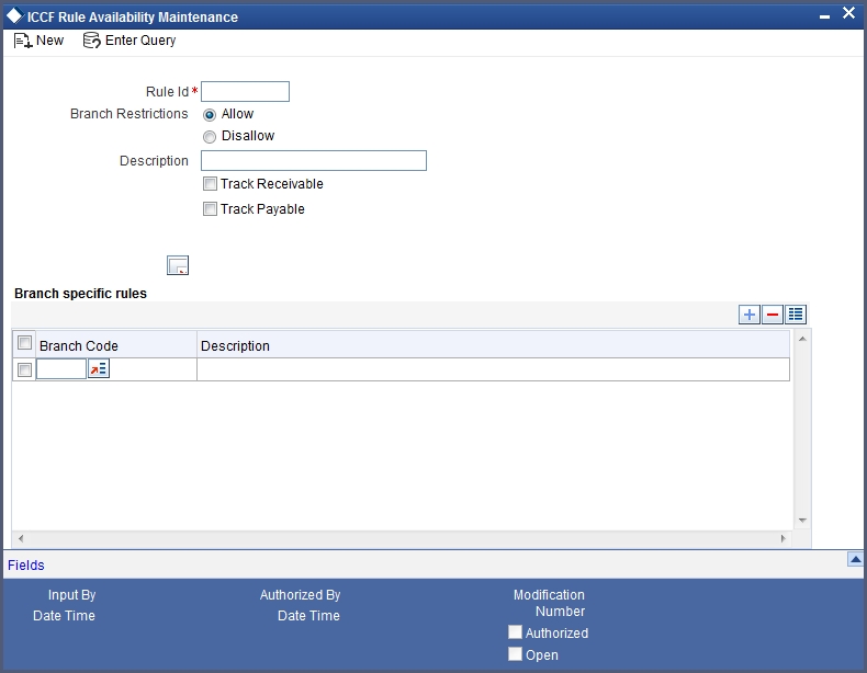

2.3.1 Invoking ICCF Rule Availability Maintenance
A brokerage rule identifies the basic nature of a brokerage component. Each brokerage rule is defined by a ten-character code, called the Rule ID. Attributes are defined for this Rule ID, which is then associated with a broker and product. When a deal is processed, the brokerage attributes defined for the Rule ID that is associated with a broker and product will be applied on the deal.
A brokerage rule is created in the same way that any Interest, Commission, Charge and Fee (ICCF) rule is created, as follows:
To recall, at the head office of your branch, you can create appropriate ICCF rules and make the rules available to the required branches.
In the ‘ICCF Rule Availability Maintenance’ screen, you can maintain ICCF rules, which you can make available to desired branches. You can do this by maintaining a list of branches for which the use of the rule is allowed, or disallowed. You can invoke this screen by typing ‘CFDICCFR’ in the field at the top right corner of the Application tool bar and clicking the adjoining arrow button.
In this screen, you must specify the following information:
Rule Identification and Description
You must specify a unique identification for the ICCF rule you are creating. If you are creating a brokerage rule, specify a unique identification for the brokerage rule. This is the identification that will be used as to identify for the rule, in all subsequent references to it. You must also specify a unique description for the rule.
Every brokerage rule is identified by a unique ten-character code, called a Rule ID. You can link a valid Brokerage Rule ID to the appropriate broker and product. When a deal is processed, the brokerage attributes defined for the Rule ID that is associated with a broker and product will be applied on the deal.
Note
After the rule has been created in the ICCF Rule Availability Maintenance screen, the at­tributes for the rule must be defined in the ICCF Rule Maintenance Screen.
Branch Restrictions
You can maintain a list of allowed branches (that is, the rule will be available for use in the allowed list of branches) or disallowed branches (the rule will not be available for use in the branches in the disallowed list).
To recall, the attributes for the rule are defined, in the ICCF Rule Maintenance Screen. Maintaining the attributes in this screen, for a branch, is subject to whether maintenance of ICCF rules is allowed for the branch, and also whether the rule for which attributes are being defined, is allowed for the branch.
For details about the Common Branch Restrictions, refer the Security Management System user manual.

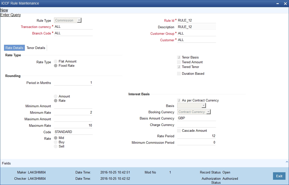

2.3.2 Building a Brokerage Rule
After a brokerage rule has been created in the ‘ICCF Rule Branch Availability Maintenance’ screen, the attributes of the brokerage rule are defined in the ‘ICCF Rule Maintenance’ screen. You can invoke this screen by typing ‘CFDRUMNE’ in the field at the top right corner of the Application tool bar and clicking on the adjoining arrow button. While indicating the rule type in this screen, choose Brokerage from the option list.
If you are defining a brokerage type of component, you need to specify the following details through the ICCF Rule Maintenance Screen.
Rule Type
Specify whether the Rule type for calculating brokerage is Aggregation Type or Individual Type.
Rule Identification
Enter the ID of the rule for which you are defining attributes. Every brokerage rule is identified by a unique ten-character code, called a Rule ID. You can link a valid Brokerage Rule ID to the appropriate broker and product. When a deal is processed, the brokerage attributes defined for the Rule ID that is associated with a broker and product will be applied on the deal.
To recall, the Rule ID for a brokerage rule is specified in the ICCF Rule Branch Availability maintenance. Accordingly, in the Rule ID field in this screen, you must select the ID of the brokerage rule that you wish to build by maintaining the attributes.
The option list in the Rule ID field is populated based on the following conditions:
If no Common Branch Restrictions have been maintained, and the restriction type ICCF RULE has not been maintained in the SMS Branch Restriction Type maintenance, the option list in the Rule ID field only displays those rules that are available for users in the current branch, according to the ICCF Rule Branch Availability maintenance.
Description
Enter a description for the brokerage rule. This description will be associated with the brokerage rule for information retrieval purposes.
Transaction Currency
If you wish to define the attributes for all currencies, you can select the ALL option in the Currency Code field to indicate this. If you are maintaining the attributes for the selected ICCF rule in specific currency other than the ALL, select the Transaction Currency on which the rule mapping maintenance is to be made applicable.
Customer Group
Select the customer group on which the rule mapping maintenance is to be made applicable. You can create a generalized brokerage rule mapping record by selecting the ALL option in the Customer Group field. This specification is defaulted to the Customer and Customer Account fields. You are forbid to change the specification.
Customer
Specify the Customer ID of the customer for whom you are maintaining the rule mapping.
Branch Code
If you are maintaining the attributes for the selected ICCF rule from the head office branch, you can select the branch for which the attributes are being defined. If you wish to define the attributes for all branches, you can select the ALL option in the Branch Code field to indicate this.
If you are maintaining the attributes for the selected ICCF rule from a branch other than the head office, you can only select those branches that are found in the allowed list of branches for:
In other words, the option list in the Branch Code field would display only those branches that are allowed both for the rule and the current branch.
Defining the brokerage rule application factors
You can apply a brokerage rule on any contract, irrespective of the currency of the contract, the customer and the branch involved.
In the ICCF Rule Details screen, rules to be applicable for contracts involving all branches, transaction currencies, customers and customer categories must be maintained at the head office branch. Subsequently, you can maintain the specific rules to be applicable for contracts involving for the following combinations:
Note
As mentioned earlier, the rules applicable for combinations involving all branches (the ALL option in the Branch Code field) can be maintained only from the head office branch.
Once an ICCF Rule has been defined, you should associate it with a broker and product through the Brokerage Association screen. Depending on the broker and product involved in a contract, the appropriate rule will be made applicable.
Rate Type
The Rate Type indicates whether the Brokerage to be applied for the Rule ID is a flat amount or a percentage of the basis amount.
Select the rate type from the following:
The specific rates and amounts applicable have to be specified subsequently through this screen.
Rounding
When rule type is brokerage no need to give value in this field.
Amount Limits for a Brokerage Calculation
If you indicated that brokerage should be calculated as a flat amount, you can specify the amount range (minimum and maximum amounts) within which the amount calculated using the brokerage rate should fall.
Rate Limits for a Brokerage for Brokerage Calculation
If you have chosen not to maintain the minimum and maximum amounts, you can specify the minimum and maximum rates for brokerage calculations. If the brokerage calculated using this Rule ID exceeds the amount calculated using the maximum rate specified here, the maximum rate amount will be applied as brokerage. Similarly, if the brokerage amount falls below the amount calculated using the minimum rate, the minimum rate amount will be considered as brokerage.
Note
If you have specified a flat amount as the Rule Type, then you need not specify the mini­mum and maximum amount/rate limits.
Tenor basis
You should specify whether the Rule ID you are defining is to be applied based on the tenor of the contract. The tenor of the contract is calculated as the difference between the Maturity Date and the Value Date of the contract. After the tenor is calculated, brokerage will be computed based on the tenor slabs defined in the ‘Tenor Based Rates’ section of the screen. The following sections will explain how brokerage is calculated using a tenor based structure.
Interest Basis
This specifies the calculation basis for the brokerage based on the Contract Currency or Rule Currency. Check this box if you wish to calculate the brokerage based on the contract currency. If you wish to calculate the brokerage based on the rule currency, then you have to choose the brokerage calculation value from dropdown list next to this field.
Tiered Amount
You can define the brokerage to be applied on contracts in any one of the following ways:
You should first indicate whether the Basis Amount that you specify subsequently should be considered as a Slab or a Tier. Check the ‘Tiered Amount’ option if you wish to maintain the Basis Amount structure as Tiers. Leave it blank if you are maintaining a slab structure.
The Basis Amount is the upper limit of the slab or tier to which a particular rate or amount should be applied as brokerage.
As per Contract Currency
This specifies whether the brokerage is paid in the charge currency or in the currency of the contract.
Tiered Tenor
Tiered tenor is applicable only for duration based (explained later) brokerage. You can indicate that brokerage is to be calculated on the basis of a tiered tenor structure, by choosing the Tiered Tenor option.
Rate
Code
For a contract, you can calculate brokerage in a currency other than the contract currency. The rate code specified here will be used to compute exchange rates between the currency pair involved in the contract.
Specify whether the currency rate for deal or slab currency from the following:
Booking Currency
You should indicate the currency in which the brokerage amount is to be calculated:
Bracket Tenor
You can create a Brokerage Rule which calculates brokerage charges on the basis of an amount structure. In this table you define the different attributes of amount structure based on which the brokerage charges would be calculated.
Basis Amount To
You should specify the upper limit of the slab or tier to which a particular rate or amount should be applied as brokerage. The brokerage rate or amount (depending on the rate type) is to be specified in the subsequent field.
Fixed Rate
If the brokerage is in the form of a percentage of the contract amount, you should specify the applicable rate. This rate will be applied for the Basis Amount To, depending on whether you have defined the application basis as a slab or a tier.
Charge Unit
The Charge Unit specifies the unit for rounding up a brokerage basis amount to the nearest amount. The brokerage will be calculated on the rounded basis amount.
Flat Amount
If the brokerage is in the form of a flat amount, the amount should be specified. This amount will be applied for the Basis Amount To, depending on whether you have defined the application basis as a slab or a tier.
Floor Basis Amount
You should specify this only if the amount basis is a Tier. This will be the upper limit of the previous tier limit. By default, the amount specified as the Basis Amount To for the previous tier limit will be displayed. For the first limit in the tier do not specify this.
This amount is used to calculate the brokerage, along with the Floor CCF Amount that is to be specified next.
Floor CCF Amount
You should specify this only if the Rule Type is a Commission.
This amount need not be the same as the amount calculated using the Basis Amount and rate for the previous slab.
Tenor Based Rates
Tenor From and Tenor To
You can define a tenor-based tier or slab structure for every amount slab that you have built.
The Tenor From refers to the start of the tenor period and the Tenor To refers to the end of the period. The rate or flat amount will be specified subsequently.
Note
Note that the Tenor From and Tenor To is defined in days.
Fixed rate
If the brokerage is to be calculated as a percentage, you should specify the applicable rate against each tenor. This rate will be applied on the transaction amount, based on the amount slab and on whether the application basis defined for the tenor based structure is a slab or a tier.
Flat Amount
To levy a flat charge, specify the flat amount. This amount will be applied on the Basis Amount, depending on whether you have defined the application basis as a slab or a tier.

2.3.5 Copying an ICCF Rule
In order to make the definition of ICCF rules easier, you can copy an existing rule and modify its attributes.
2.4 Broker Association
2.4.1 Associating a Broker and product with a Rule
Brokerage association enables you to link a product, a rule, a currency or a currency pair (in the case of foreign exchange products) and a broker.
Further, you can make a Brokerage Rule applicable for a broker, product and currency combination.
For a Foreign Exchange deal, you can make the brokerage applicable only when the contract involves a specific currency pair.
Invoke the ‘Brokerage Association Maintenance’ screen by typing ‘BRDASSOC’ in the field at the top right corner of the Application tool bar and clicking the adjoining arrow button.
Features of the screen
You have to give the following inputs in the Broker Association screen to define an association:
The attributes of the brokerage rule will be associated with contracts defined in this combination.
Rule Code: Select a Rule Code from the option list. This rule associates with the Broker + Product and currency or currency pair combination.
Note
While processing security deals you can choose to add the brokerage computed at the deal level to the cost of the asset, instead of being expensed while processing the SE deal.

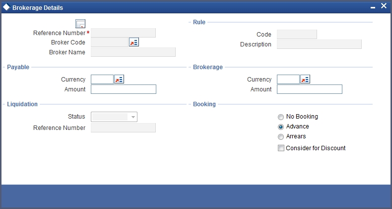

2.5 Brokerage on a Contract
2.5.1 Brokerage Details Maintenance
When capturing the details of a contract, you will have to specify the brokerage details applicable to the contract. By default, the brokerage details specified for the product apply to the contract as well. However, if you want to change some details, like the booking of brokerage — whether the brokerage should be booked in advance, in arrears, or waived altogether − or the currency of the contract, you will have to invoke the ‘Brokerage Details’ screen.
You can invoke this screen through the Contract Details screen by clicking ‘Brokerage’ button in the screen.
In case of a new contract, if brokerage already exists for the product, to which the contract is associated, the system will pick up the values and display them in this screen. However, if the product has not been associated with a brokerage rule, you will not see any values in this screen.
You can define brokerage for a specific contract, even if it has not been defined for the other contracts involving the product.
When you invoke the Contract Brokerage Details screen, you can change the values only if you have clicked the Modify option from the Action Menu.
You have to give the following inputs in the Brokerage Details screen to define the contract brokerage details:
Reference Number
This is a display field which displays the corresponding contract reference number.
Broker Code
This displays the broker code selected in the contracts main screen
Broker Name
This displays the description of the broker code.
The broker code displays along with the broker’s name in the screen. You cannot change the broker, through this screen, for the contract that you are processing.
Payable
If the brokerage Payable Currency is the same as the brokerage Paid Currency, then the same amounts (brokerage paid and brokerage payable) displays against the currencies. You can change these currencies if you wish to. While you cannot alter the brokerage payable amount which displays, you can change the ‘brokerage paid amount’ value.
Liquidation
This designates the status of the brokerage, whether the brokerage is liquidated or is still outstanding for the contract. If it is liquidated, it displays the liquidation reference number.
Rule
This indicates the brokerage rule code and description on the basis of which brokerage is calculated.
Brokerage
Booking
This indicates when the brokerage applicable to the transaction is booked. The preference that you specify for the broker becomes default. You have the option to change the default , that is ,from advance to arrears or from arrears to advance. To waive brokerage for the transaction, choose the 'No Booking' option.
The options available are as follows:
Consider for Discount
This option is defaulted from the deal product level. However, checkbox is unchecked if the booking method is other than ‘Advance’.

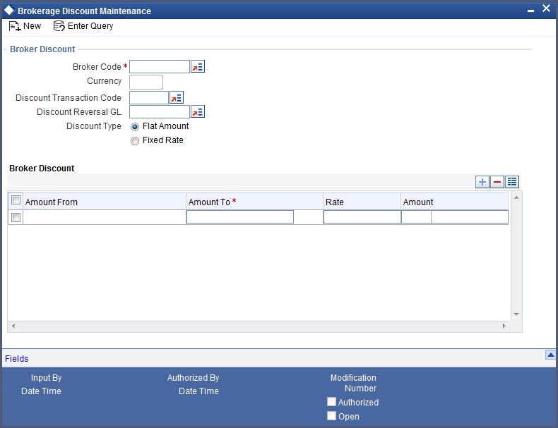

2.6 Brokerage Discount Maintenance
2.6.1 Maintaining Brokerage Discounts
A stockbroker who carries out buy and sell orders at a reduced commission compared to a full-service broker, but provides no investment advice is called as a Discount Broker.
It used to be that only the wealthy could afford a broker and access to the stock market. The internet has brought an explosion of discount brokers which let you trade at a smaller brokerage. However, it is important to remember that discount brokers don't provide personalized advice. Because of discount brokers, nearly anybody can afford to invest in the market.
We can maintain discount for a Broker through the ‘Brokerage Discount Maintenance’ screen. You can invoke this screen by typing ‘BRDDISCO’ in the field at the top right corner of the Application tool bar and clicking the adjoining arrow button. Amount Slabs can be maintained in this screen where a discount will be done on the brokerage amount that is due for the broker.

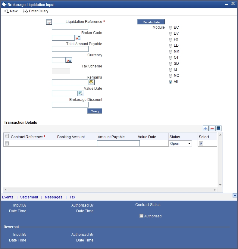

2.7 Brokerage Liquidation
2.7.1 Liquidating Brokerage Manually
You can liquidate brokerage payable on a contract through the ‘Brokerage Liquidation Input’ screen. You can invoke this screen by typing ‘BRDLIQD’ in the field at the top right corner of the Application tool bar and clicking the adjoining arrow button. In this screen, you can opt to liquidate the consolidated brokerage (due from more than one contract) that is due to a broker.
Broker Code
Select the broker code for which brokerage is liquidated from the option list. To manually pay brokerage for various contracts, involving a specific broker, you have to specify the Broker Code of the individual concerned.
Value Date
Contracts whose value date is same as that is mentioned here will be queried.
Currency
Select from the option list, the currency in which the brokerage has to be paid to the broker.
Module
Choose the module for which the brokerage is being calculated. If you wish to calculate brokerage for all the modules, choose the ‘ALL’ option. The date on which the brokerage is booked will also be displayed in this screen. Brokerage is calculated for the following modules:
Liquidation Reference Number
Each broker code associates a Liquidation reference number. The Liquidation Ref No is automatically generated by the system. This number is based on the event code (not on the product code) and is used to generate the transaction reference number for the liquidation. The particular broker code you have specified displays this number in this screen.
Tax Scheme
The tax scheme you have defined for the broker displays in this field. The tax scheme applicable on the brokerage would be the scheme specified in the Broker Master Detail screen.
Total Amount Payable
Select the check box against each Contract Reference number to populate the Total Amount Payable field in the screen. As and when you select a contract, the brokerage amount applicable to the contract gets added to the amount displayed in the Total Amount Payable field.
Brokerage Discount
This displays the discount amount if any discounting is attached at the broker level.
Remarks
You can enter some information about the broker confirmation which is internal to the bank. This is not printed on any correspondence with the counterparty.
Query
Click ‘Query’ button to see all the contracts for which brokerage is yet to be paid, after the required inputs are given.
Recalculate
On clicking ‘Query’ button, the system will fetch all contracts and by default the Select check box will be selected and the total amount payable will display the consolidated amount. If only a few contracts need to be liquidated then we can uncheck those contracts and recalculate the total amount field.
Transaction Details
The contract details displays in the Transaction Details section of the screen.
Tax
You can invoke the ‘Tax Details’ screen by clicking ‘Tax’ button in the ‘Brokerage Liquidation Input’ screen. In this screen you will see the tax details applicable on the contract.
Settlements
You can invoke the ‘Settlement Details’ screen by clicking ‘Settlement’ button in the ‘Brokerage Liquidation Input’ screen.
Events
You can invoke the ‘Event Details’ screen by clicking ‘Events’ button in the ‘Brokerage Liquidation Input’ screen to view the events associated with brokerage liquidation.
Advices
If any brokerage advices are present, they can be viewed from the ‘Contract Advices’ screen. Click ‘Advices’ button in the ‘Brokerage Liquidation Input’ screen.
2.7.2 Accounting Entries Button
The brokerage that is calculated on a contract is parked in a suspense account before it is paid to the broker. This account would be an internal account of the bank. It is specified at the time of defining the accounting roles and event-wise accounting entries for the product (which involves the contract on which brokerage is to be calculated). Accounting entries for brokerage liquidation are defined at the time of product definition, both, for booking, or, initiation and liquidation.
The brokerage payable account (the broker’s account into which the actual brokerage for a particular deal is to be paid) is defined in the brokerage liquidation screen in the Settlements module.
Although a broker may have to be paid brokerage on several deals, the manual liquidation function of the system consolidates these into a single settlement amount to be passed to the settlement account. The brokerage payment advice specified at the time of defining advices for a product will be triggered.
If you click ‘Accounting Entries’ button on the ‘Events’ screen invoked from the contract main screen, you will see the accounting entries screen for the particular Liquidation reference number. The event is ‘Liquidation’ and the transaction date is today’s date.
You will see the following in the ‘Accounting Entries’ screen:

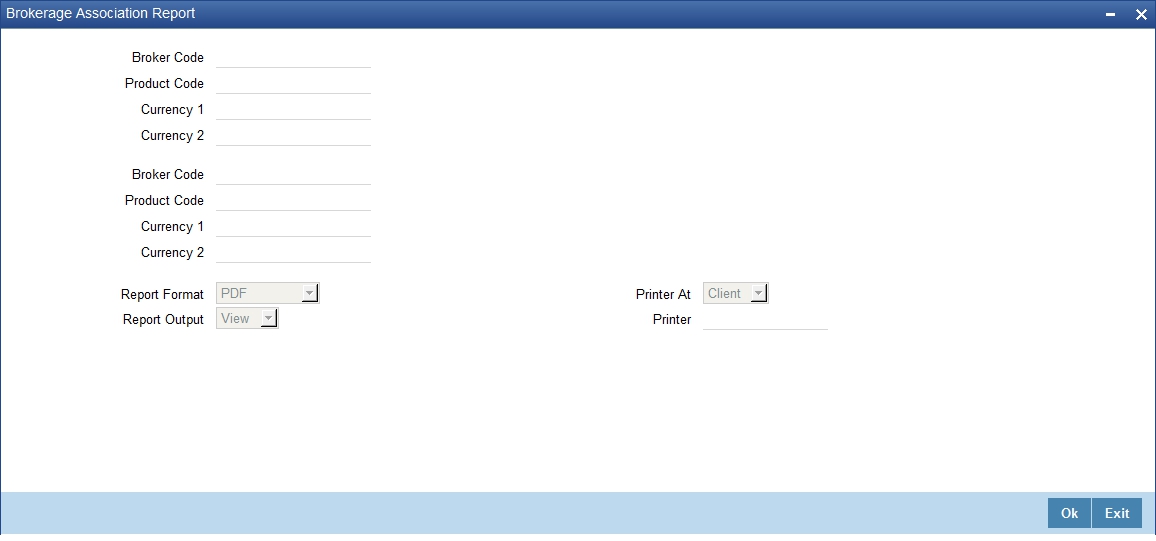

2.8 Brokerage Association Report
2.8.1 Generating Brokerage Association Report
This report gives details of all associated brokers. It is printed daily as part of the batch process. You can configure this report to display details of brokerage contract. You can generate the report based on the following criteria:
You can invoke this screen by typing ‘BRRASSOC’ in the field at the top right corner of the Application tool bar and clicking on the adjoining arrow button.
Specify the following details:
Broker Code
Specify the broker code from which you want to generate the report.
Product Code
Specify the product code for which you want to generate the report.
Currency 1
Specify the first currency from which you want to generate the report.
Currency 2
Specify the second currency from which you want to generate the report.
Broker Code
Specify the broker code until which you want to generate the report.
Product Code
Specify the product code until which you want to generate the report.
Currency 1
Specify the first currency to which you want to generate the report.
Currency 2
Specify the second currency to which you want to generate the report.
Once you have specified the details, click ‘OK’ button to generate the report.
2.8.2 Contents of the Report
The contents of the ‘Brokerage Association Report’ are discussed under the following heads:
Header of the Report
The Header carries the title of the Report, information on the branch code, the branch date, the user ID, the module name, the date and time at which the report was generated and the page number of the report.
Body of the Report
The details of the borrower that would be displayed in the report are as follows:
Field Name
Field Description
Record Number
This is the sequence number of the record
Broker Code
This is the code that identifies the broker
Product Code
This is the product code
Rule
This rule is made available for use in the required branches by maintaining an allowed/ disallowed list of branches.
Currency 1
This is the currency of booking associated to the broker
Currency 2
